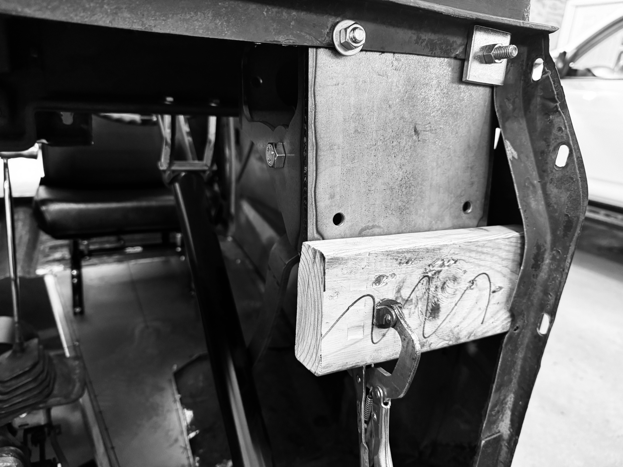

    Commercial carpenters may recognize the CRC, cold rolled channel (red arrow). I really like that material for adding strength. It’s 1.5” wide by .5” tall and made from 16 gauge. It’s normally used to strengthen metal stud walls. The blue arrows point to the duct tape that was used to transfer the required notches.

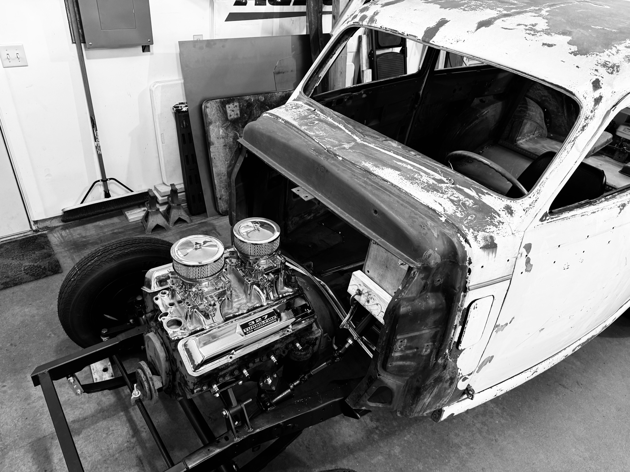

    Thanks for the comments and ‘likes’ everyone! The trunk is fully welded and I framed in the front section. I don’t need a hood, but I am missing 2 pieces of trim. Hopefully, French Lake auto parts will fix me up.

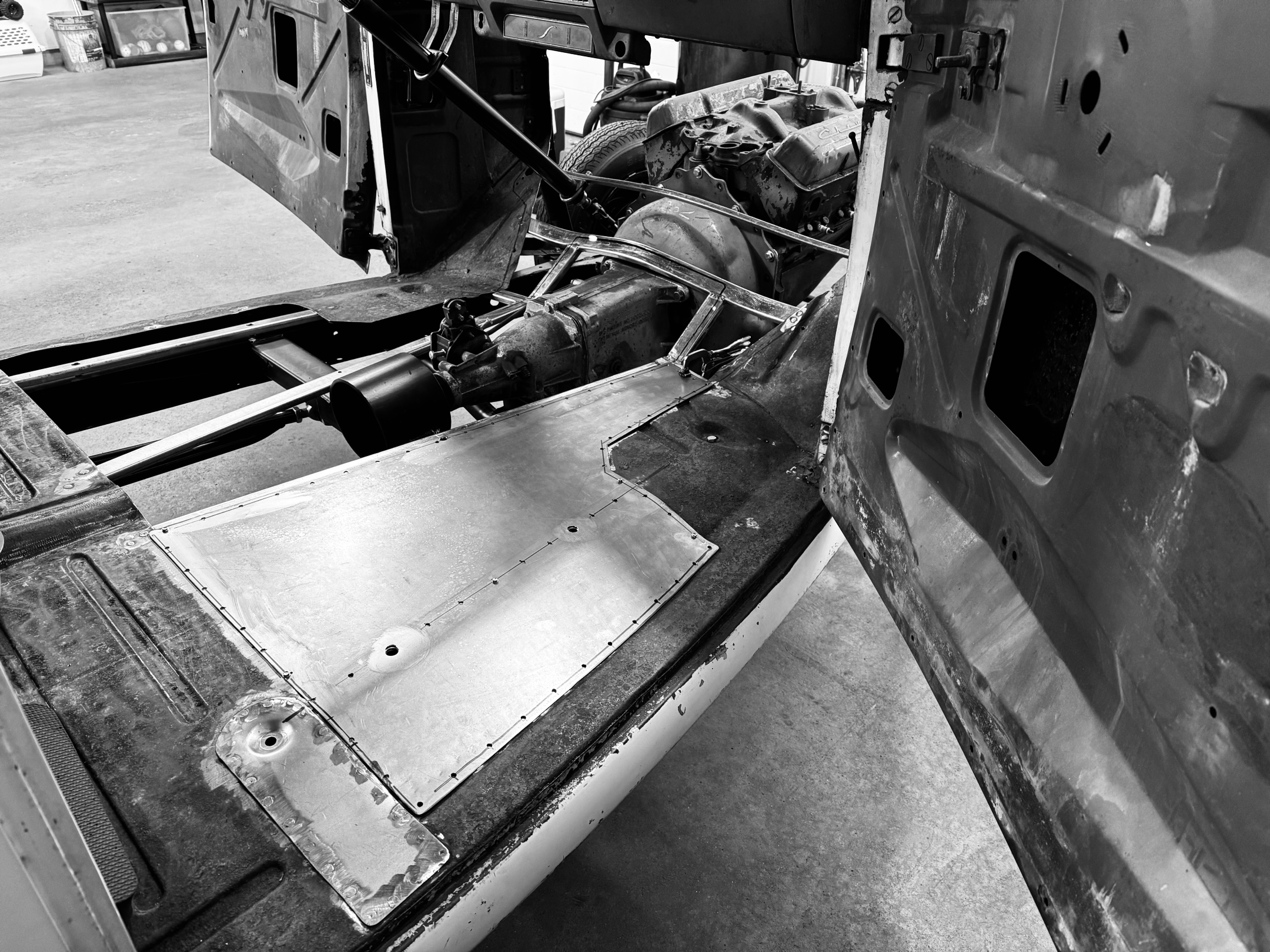

    My son and I did some repairs and mods to our 2014 Rubicon, and the whole family spent a week in California, so the Studebaker was put on the back burner. But, I did make some progress today. Unfortunately, now I need to go buy more sheet metal as my remaining chunks aren’t large enough to finish the floor.

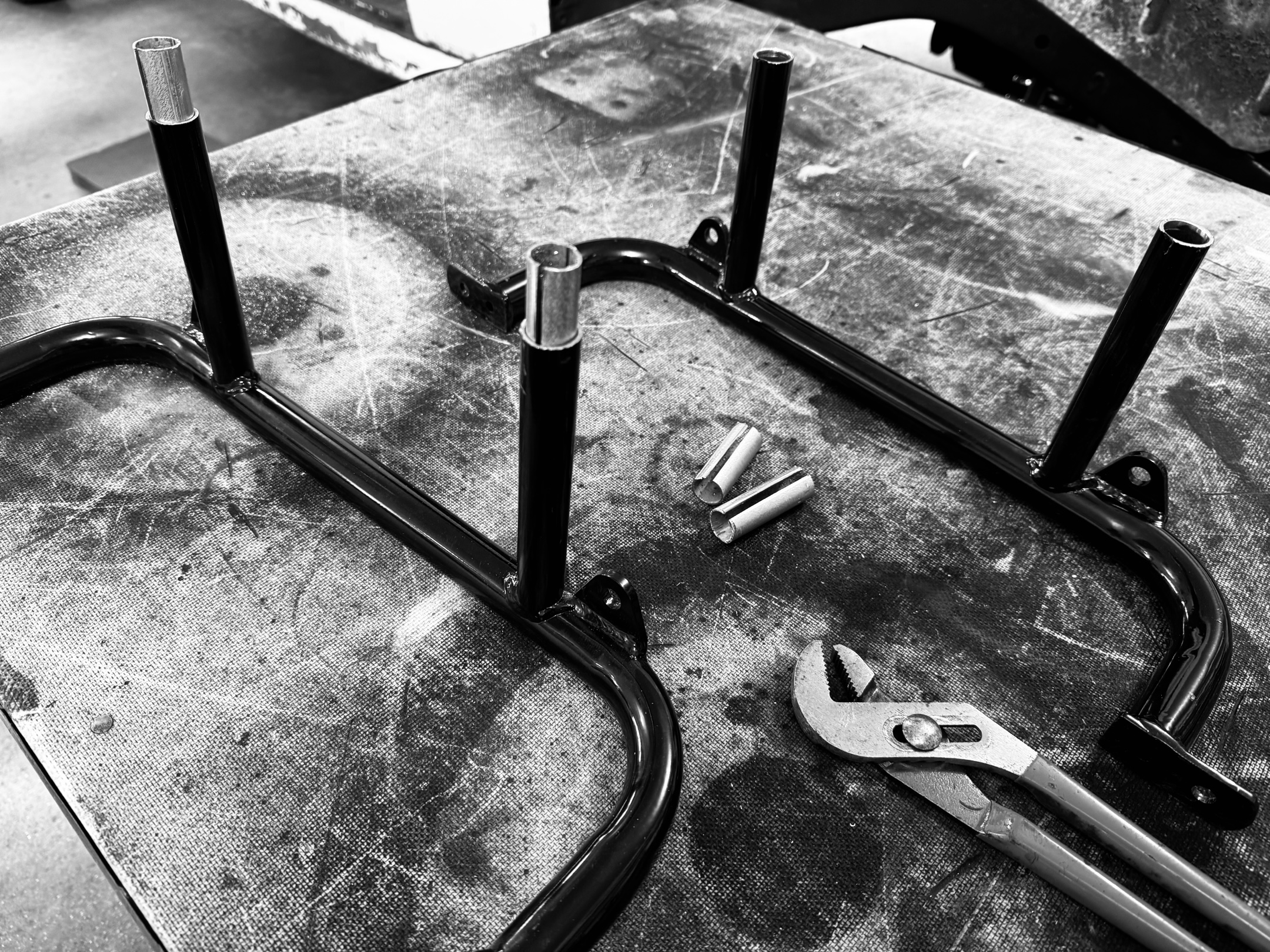

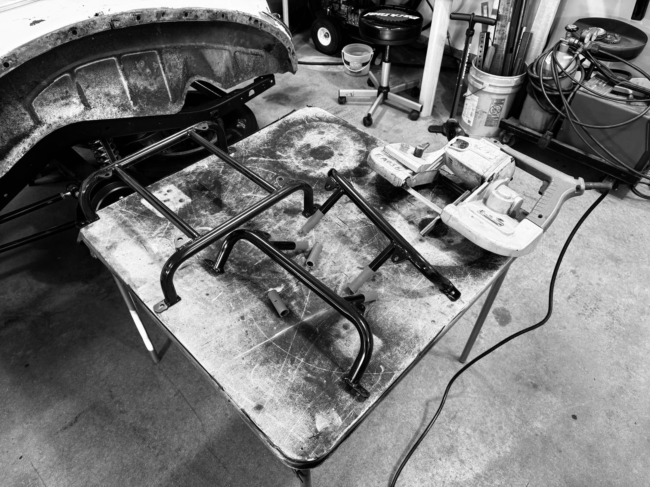

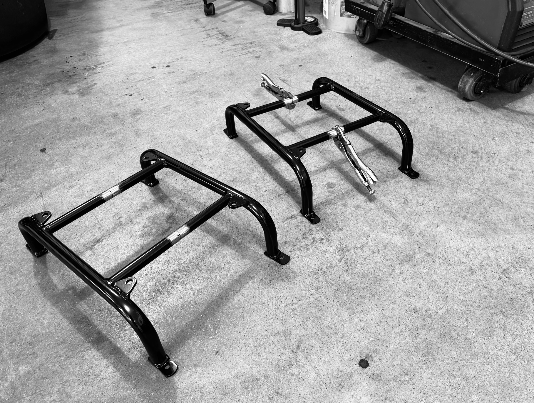

    In an attempt to save time, and because I don’t own a pipe bender, I ordered some Speedway seat mounting frames. I think they have a vintage race car look and they were rather inexpensive. The length was perfect, but they did require narrowing. I took 2.5” out of them.

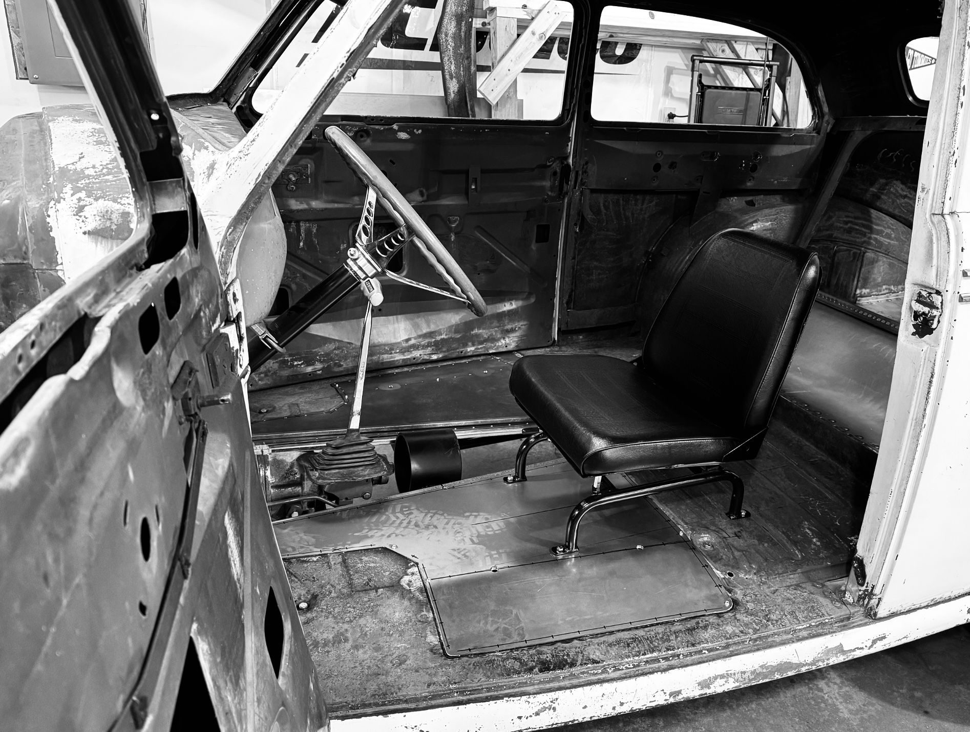

    The “fake” A100 seats are actually forklift seats from Northern Tool and Equipment. They come with the adjustable slide mechanism. Not vintage 60’s, but they look the part and don’t break the bank. On a side note - that’s not the shifter handle I’m using.

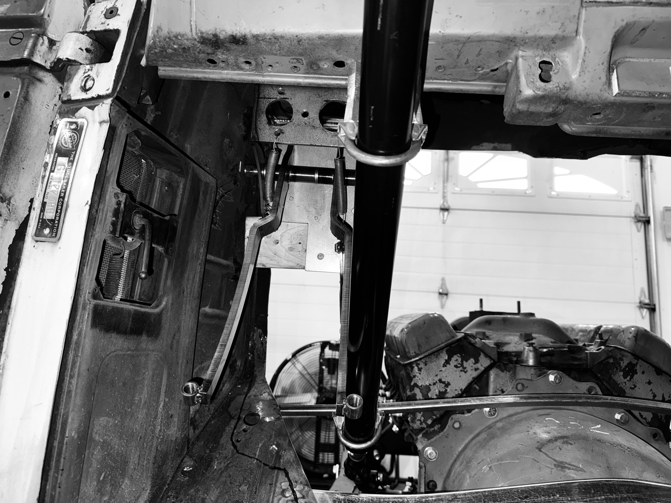

    After tossing on some return springs, I very roughly hung the pedal ***embly off an existing hole. It’s going to need significant tweaking, but it will work great. There’s the perfect amount of space for 3 pedals. In about 6 weeks, I’ll be putting our pontoon in the lake and progress will slow dramatically. Happy Easter!

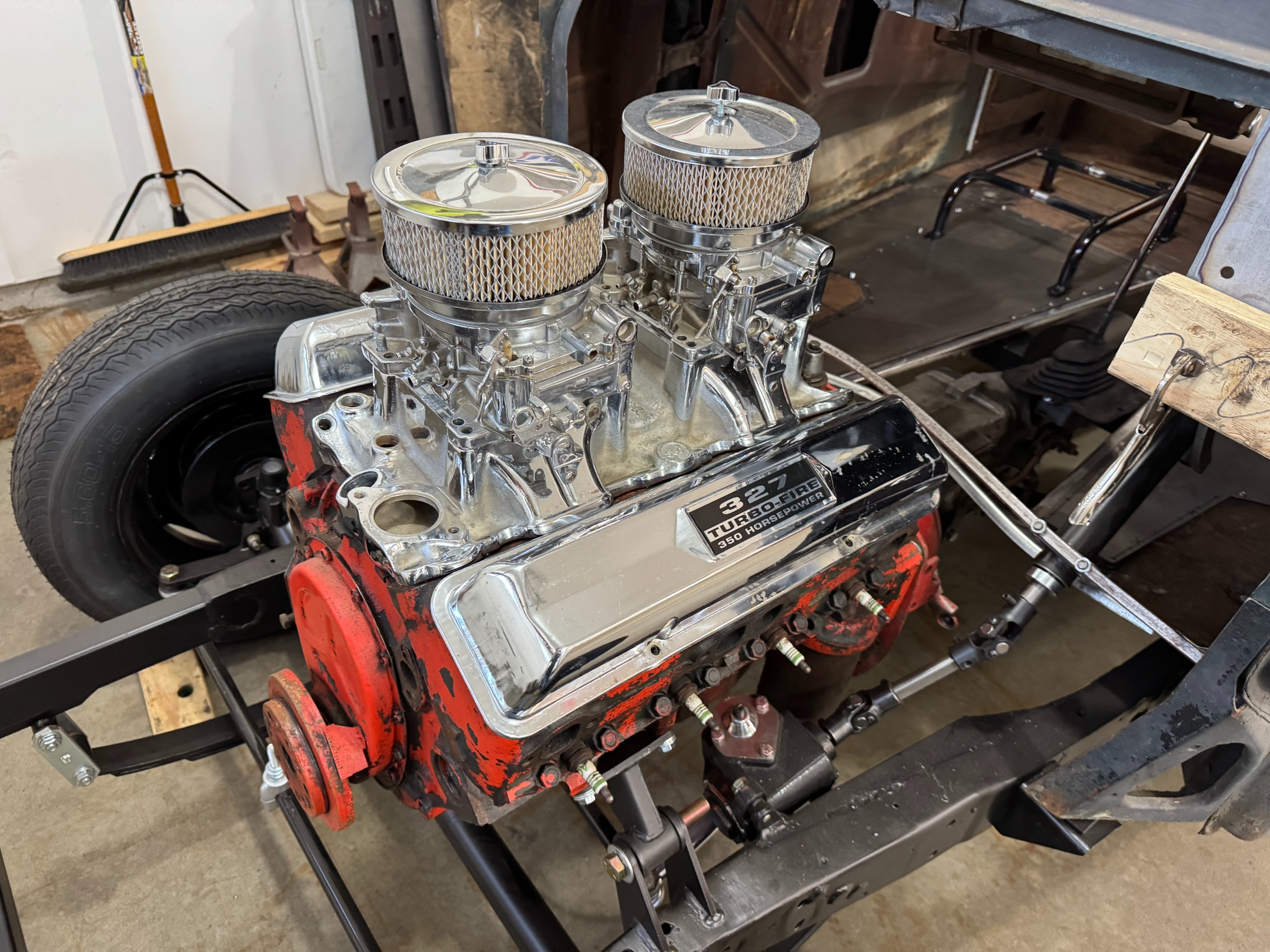

    I pried the old 2 bbl iron manifold off my mock-up engine tonight and tossed it in the trash. Yes, mice had set up camp in there a while ago. The floor replacement, which is still in process, is rewarding, but also a bit of a steep hill to climb. Sometimes, if you can’t see the light at the end of a tunnel, you need to take a step back and remind yourself of why you do this crazy ****. I ran the Chevrolet script valve covers on the ‘37 Plymouth and then the aluminum Corvette covers on “the Grinch”. There was really only one choice remaining. I grabbed these from a fellow HAMBER and couldn’t be happier with how they look. Thanks @lcfman ! We both have been members here since 2009.
