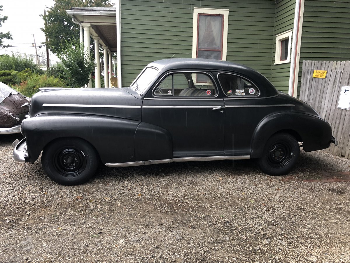

  25. Rillster
    Joined: Dec 5, 2020
    Posts: 4
    Rillster
    Here she is
