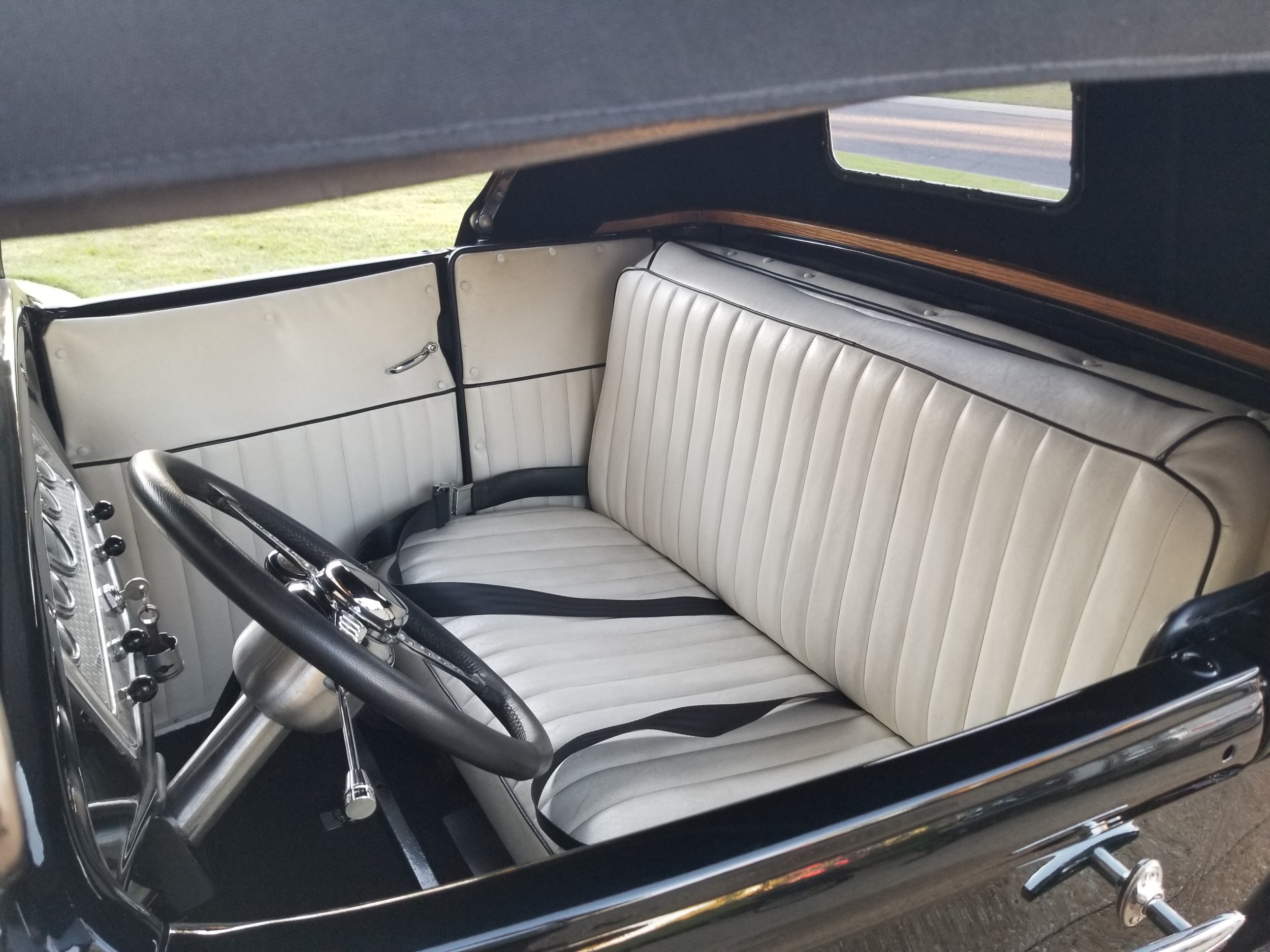

    I've used 1/8 inch ABS for door panels in the 38 Chevy, 53 Stude (both covered with upholstery) and just bare ABS in the T roadster (one side is gloss, the other side is "patterned"?) Note that the ABS can be heated and molded to some extent.
    I'm older than you and I ran black wheels in the early sixties.
    As suggested earlier, removing the upholstery from another car and installing it over your springs is another option. When I purchased this "kit" it came with a minivan?? seat, I pulled it off the original springs, used some seat foam from another project and attached it to plywood. It worked fine, just didn't look right.

    I pulled a seat from a min van and cut 6 inches out of the middle of it and then sewed up my own tuck and roll covers for it. All done at home in my garage. Came out ok for a first time effort. Now I know why upholstery work is so expensive!:)
