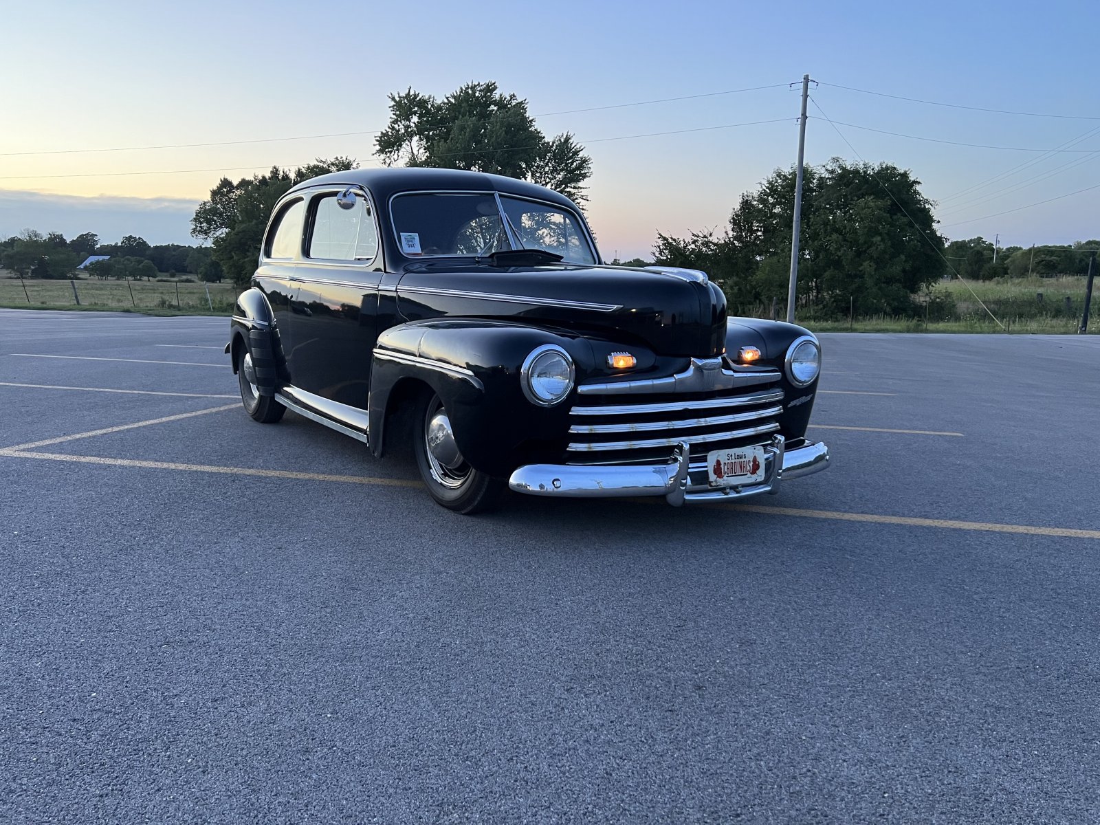

    After the day cooled down some and going and picking up the boy a new to him toy. (Every 4 year old needs a 4 wheeler right?) we came home and washed Dave and took it for evening spin. Then some photos before we put it in the garage for the night. 0EF90160-3203-44DA-8374-F4A13DC93578.jpeg F38DB1E2-8843-489D-8104-1DB5619E9C0A.jpeg FD3F9BFB-3659-464D-BF9A-CFA6BB952CDF.jpeg 42F8EFCD-0234-4F0C-83C5-4A34A2781C4C.jpeg
