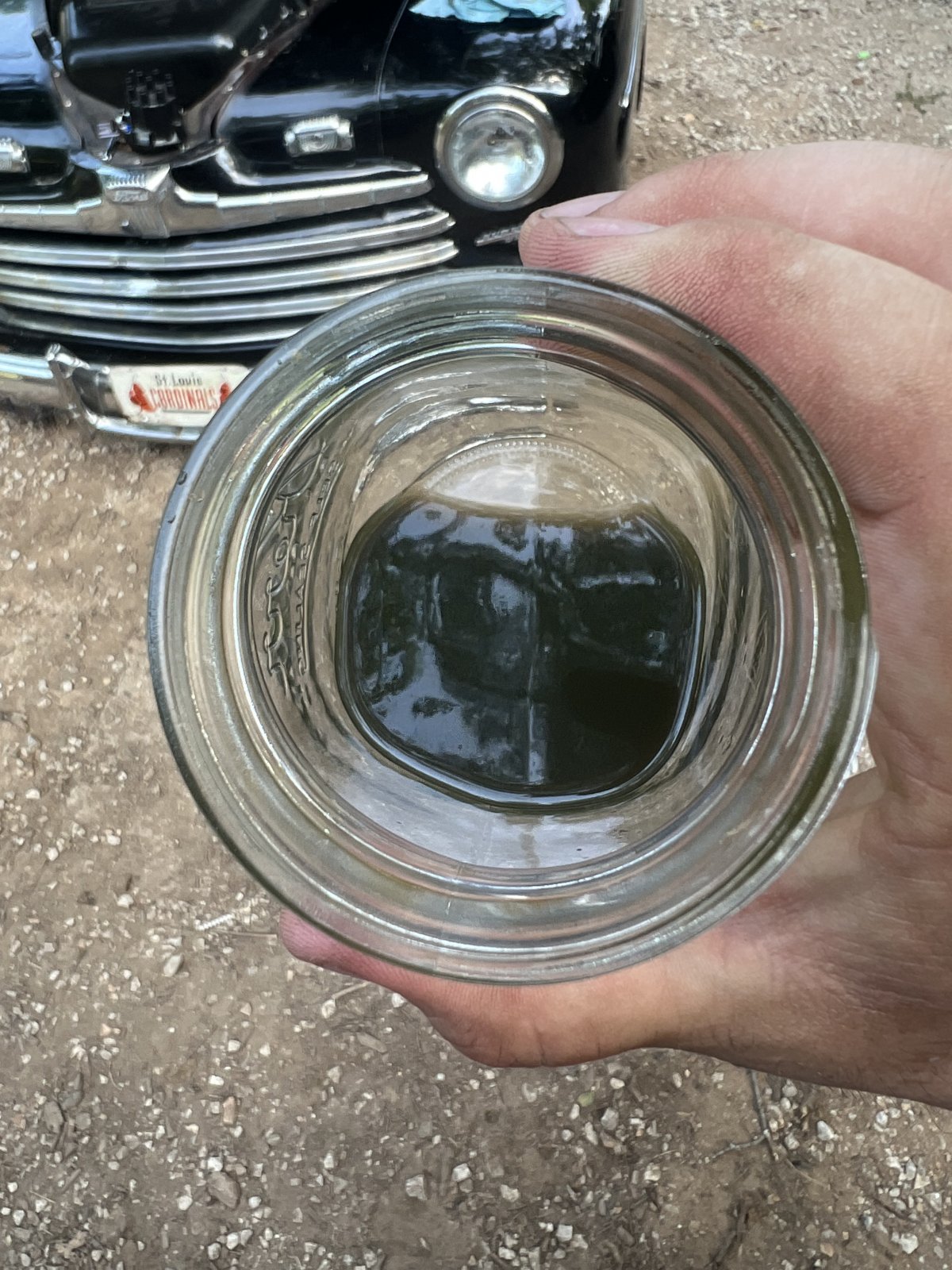

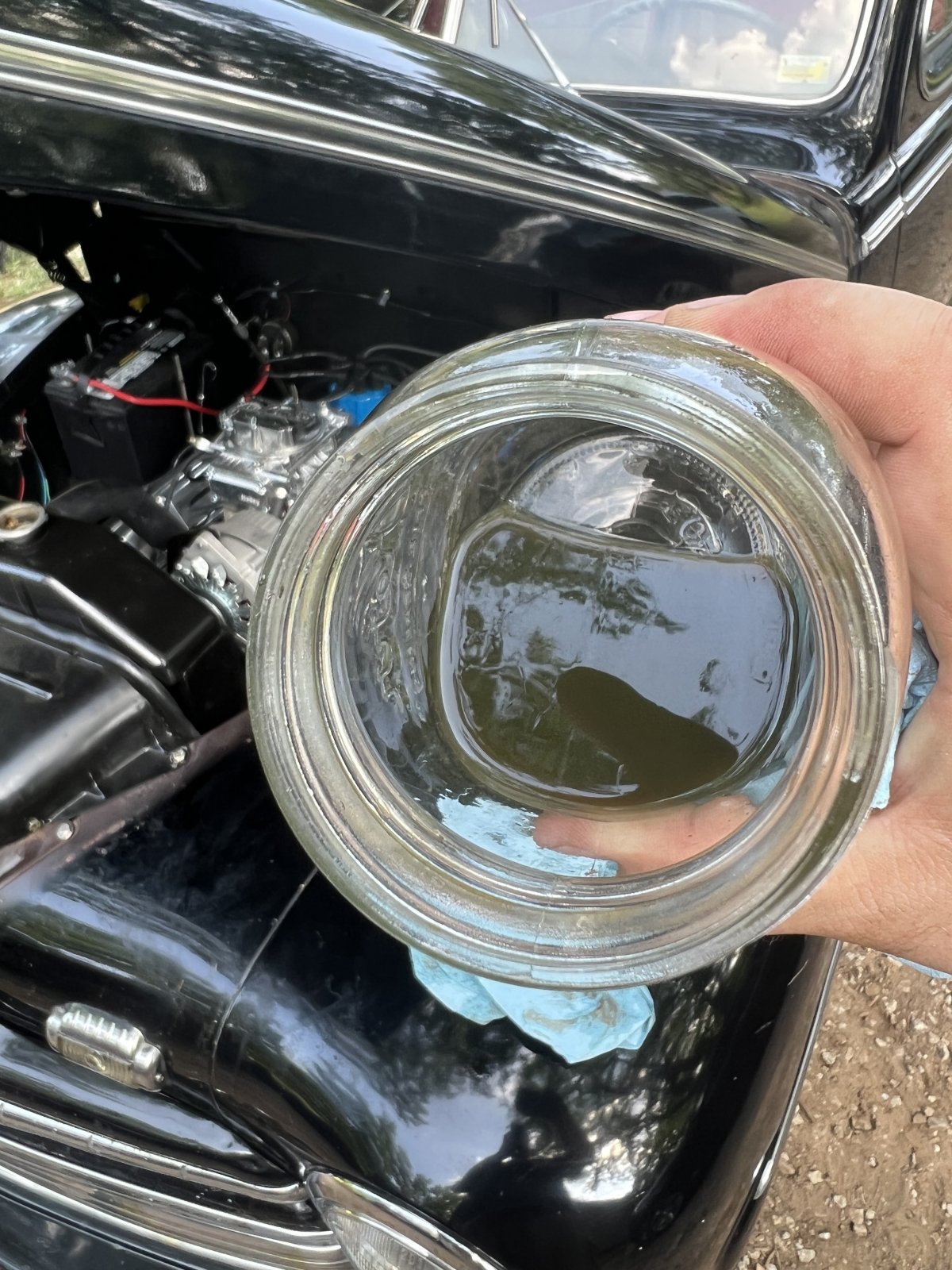

    Well some good news I think about the motor in the 46. My jar sample I took out of it and left on the shelf in the garage settled. And to my surprise it was all pure antifreeze on top and some silt and rust particles on the bottom. Drained the radiator and let it sit and no oil there either. We are thinking that after the motor sat the last two years in the shop after we pulled it from my dads 34 it flashed rusted or something sitting. It sat plugged up with rags and has less then 10k miles on it. We flushed it then but it was just cold water and no issues. I think with getting it up to temp has turned something loose and I just so happens to find it trying to chase my ignition problem.

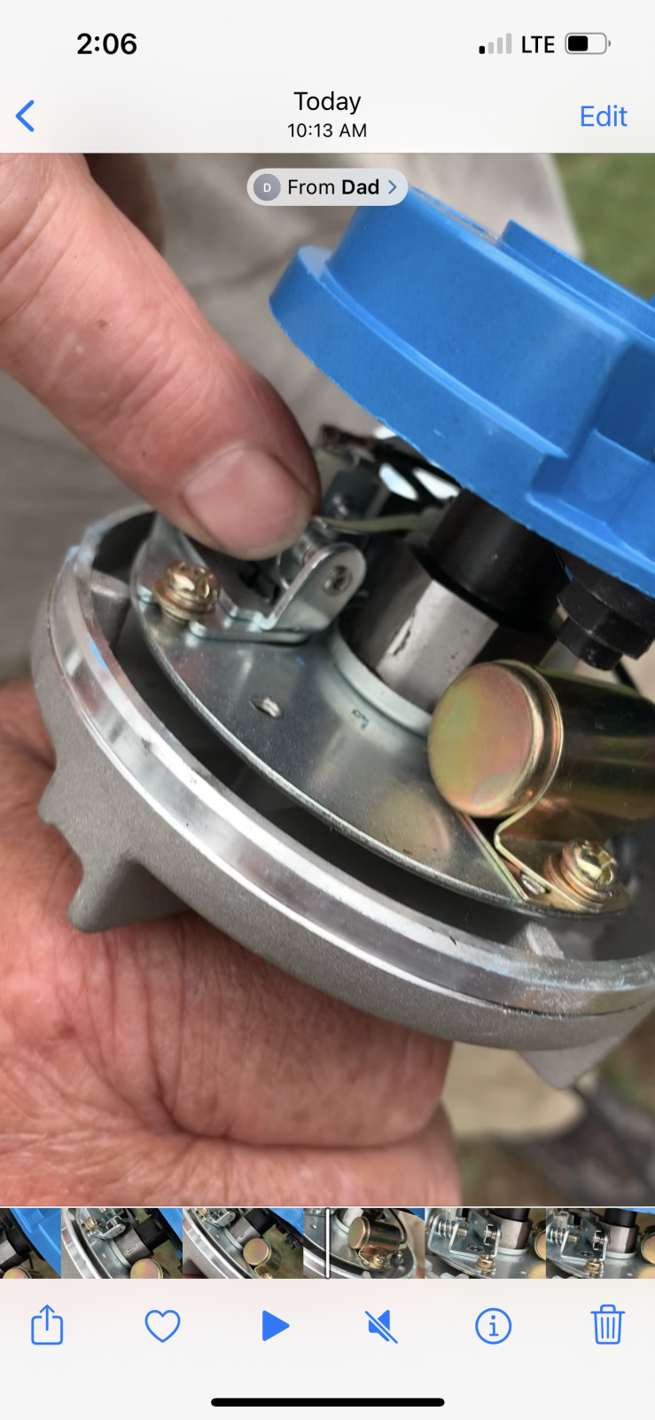

    The problem with the stumble and two dead cylinders turned out to be the new distributor went bad. The part that rotates on the points rounded off and quit opening the points like it was suppose to. Dropped a distributor in off the shelf and fired right up. On all 8 cylinders. A sigh of relief there.

    Are you saying that two lobes on the distributor shaft went flat after only 100 miles? You should have some grease on that surface, but that's typically for protecting the follower pad on the points from wearing out. That shaft must be made from some pretty soft steel.
  13. EV34
    Joined: Aug 29, 2008
    Posts: 1,200
    EV34
    That’s exactly what happened and it did have some grease on it out of the box. That’s what buffaloed me on what it could be as it was new and the car only had 100 miles or less. That’s new parts for ya I guess

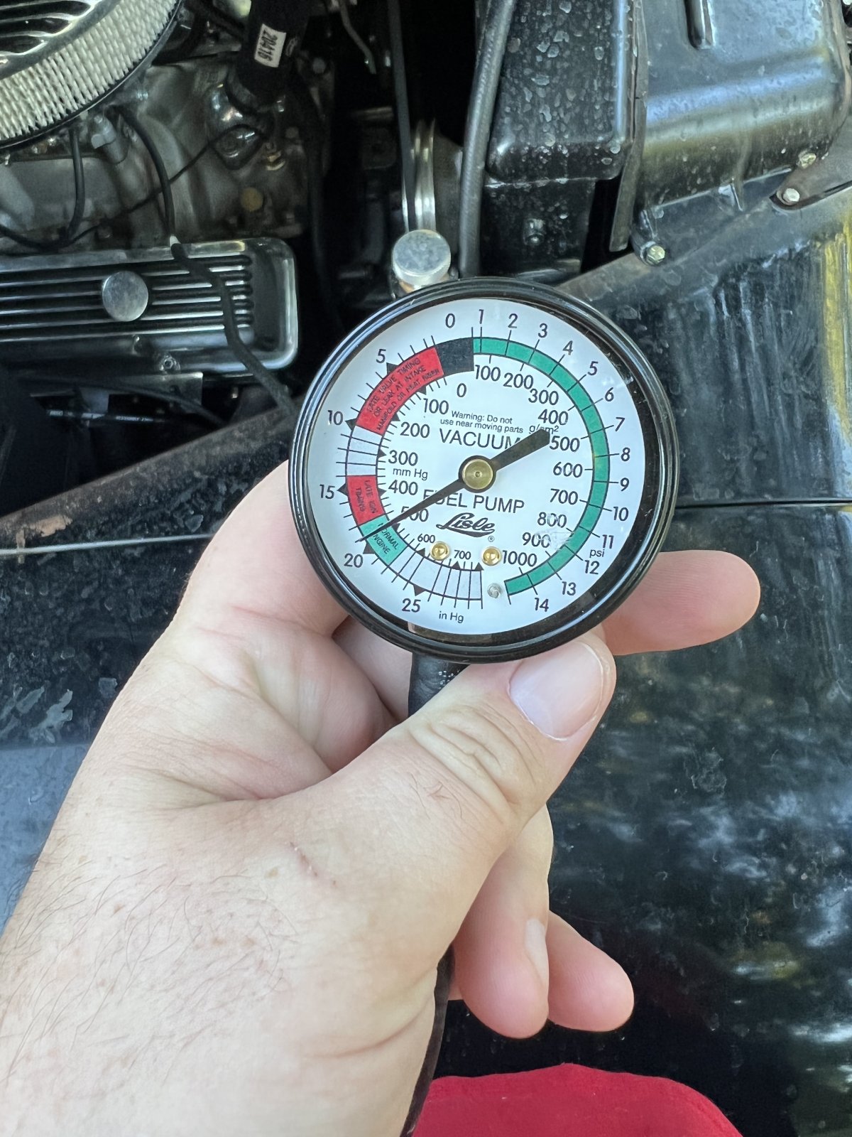

    Filled the tank up and went for a cruise tonight. Flushing the cooling system and the new distributor. I also tuned the carb with my vacuum gauge and ol Dave is running better then it has. Took the middle daughter and the boy with us. I think they enjoyed it just as much as we did!!

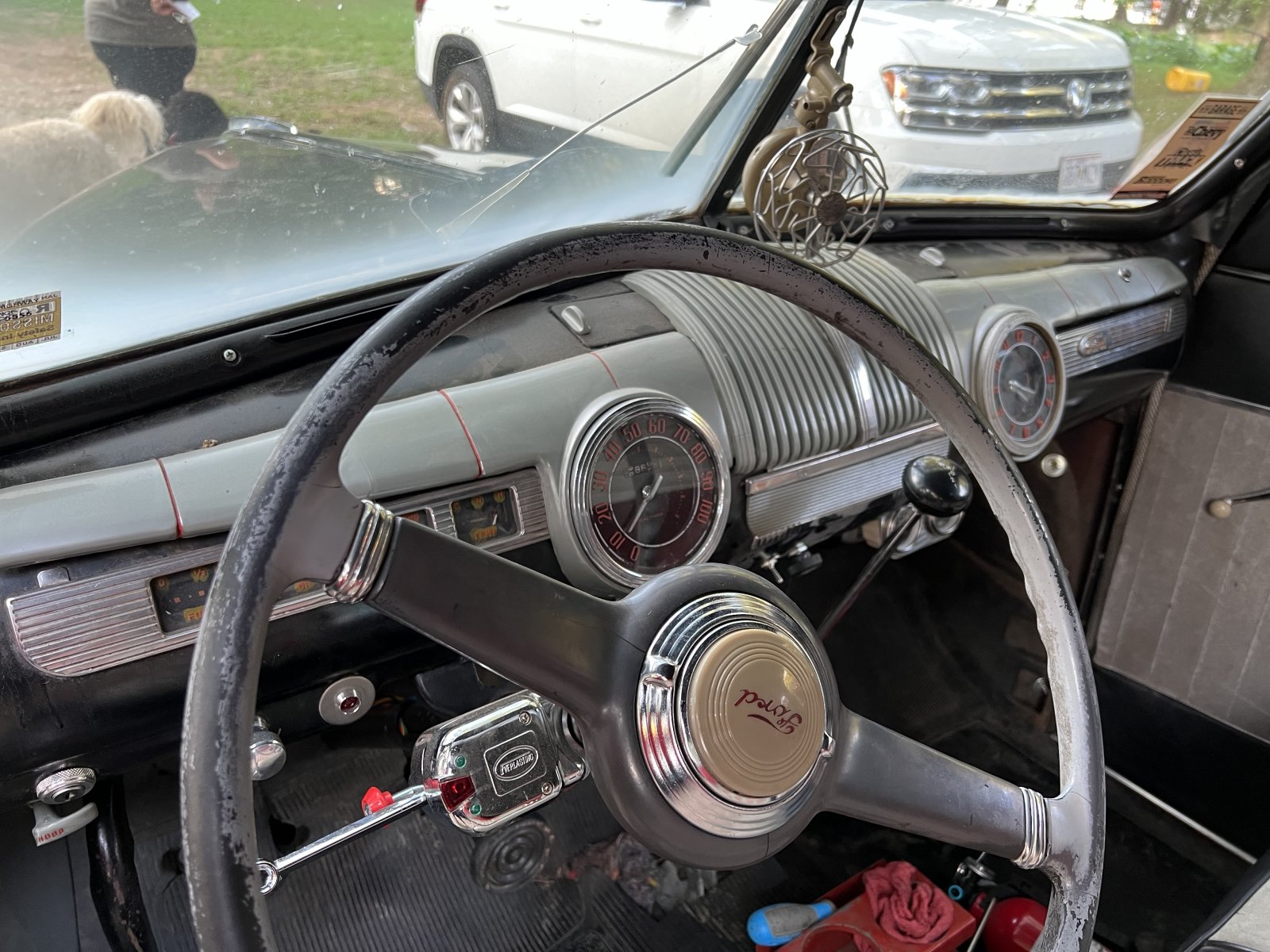

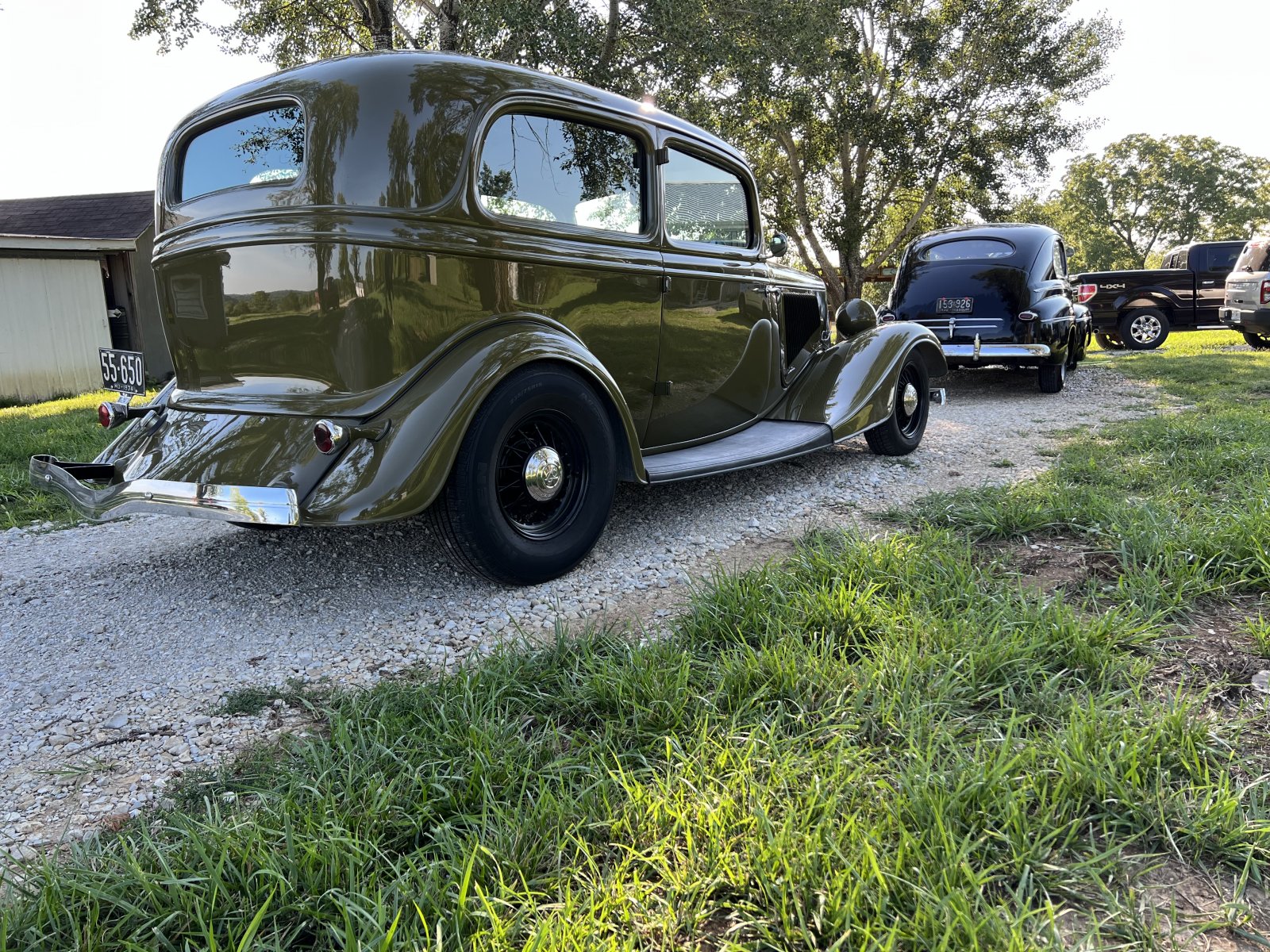

    Got it pretty much cleaned up the last two days. I spent last night taking the dash apart and getting it ready to put my old chrome dash parts I found for it on. While I had the dash trim off I polished up the old original paint. It cleaned up pretty well. The this morning I got up early and headed over to my dad house to have a wash party. We cleaned up his 34 ford and the 46 this morning. There’s a cruise about 45 mins from us in Marshfield tonight. It’s usually a pretty good time plus my sister lives there so it’s a good excuse to catch up with her and her family. And will be a good maiden voyage for Dave. 56D13E91-AC67-4C18-AFE9-5A2FBC96D7E2.jpeg
    Old dash plastics and before I polished the dash up a little bit. The old plastics was so brittle they fell apart when I in bolted them.
    The old chrome parts I found for the dash. Looks great I think!!
    Dads 34 and the 46 getting a bath before the sun gets to them.
