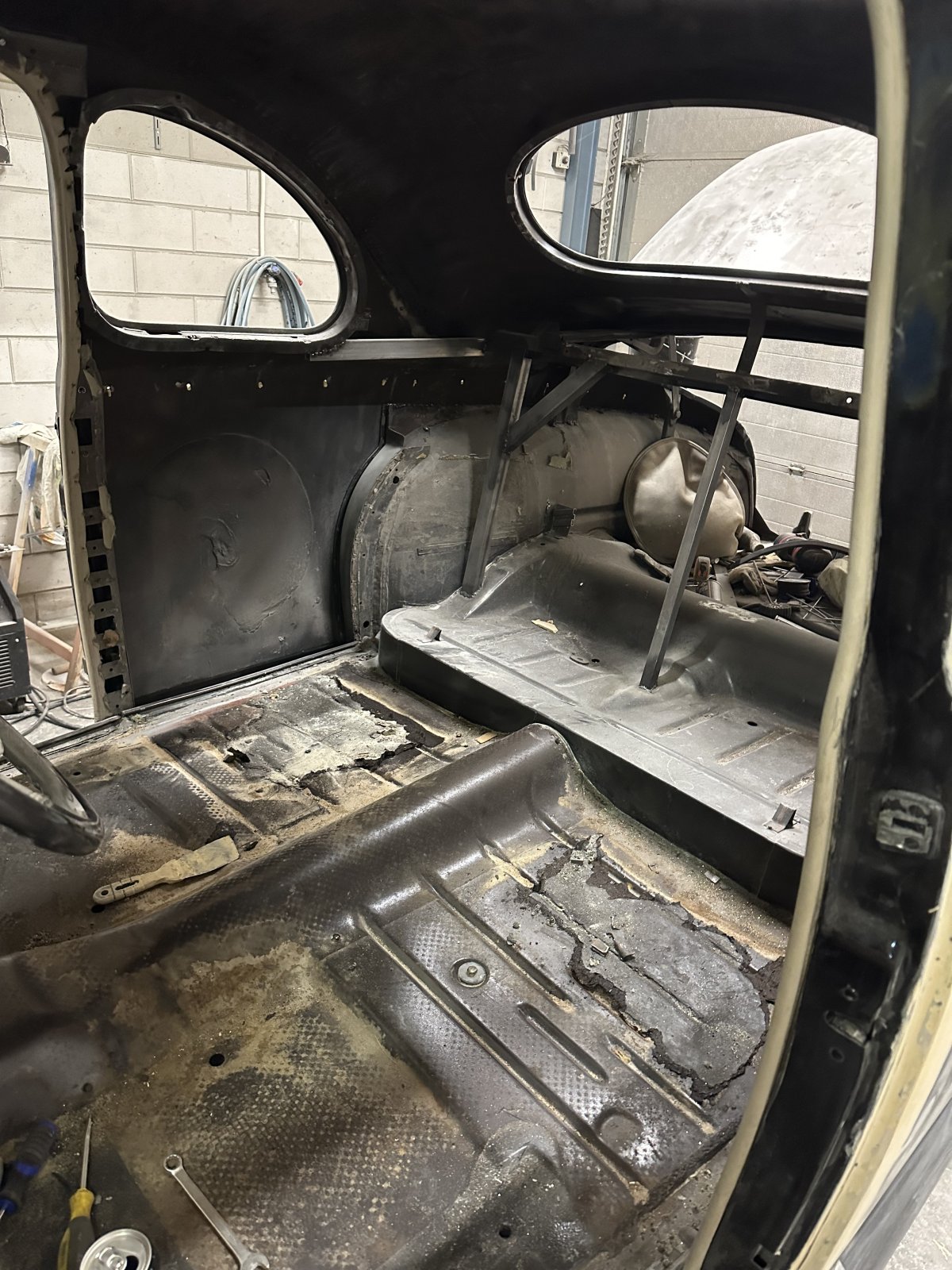

    Corners are in , next will be the inner structure and then try to fix the decklid.

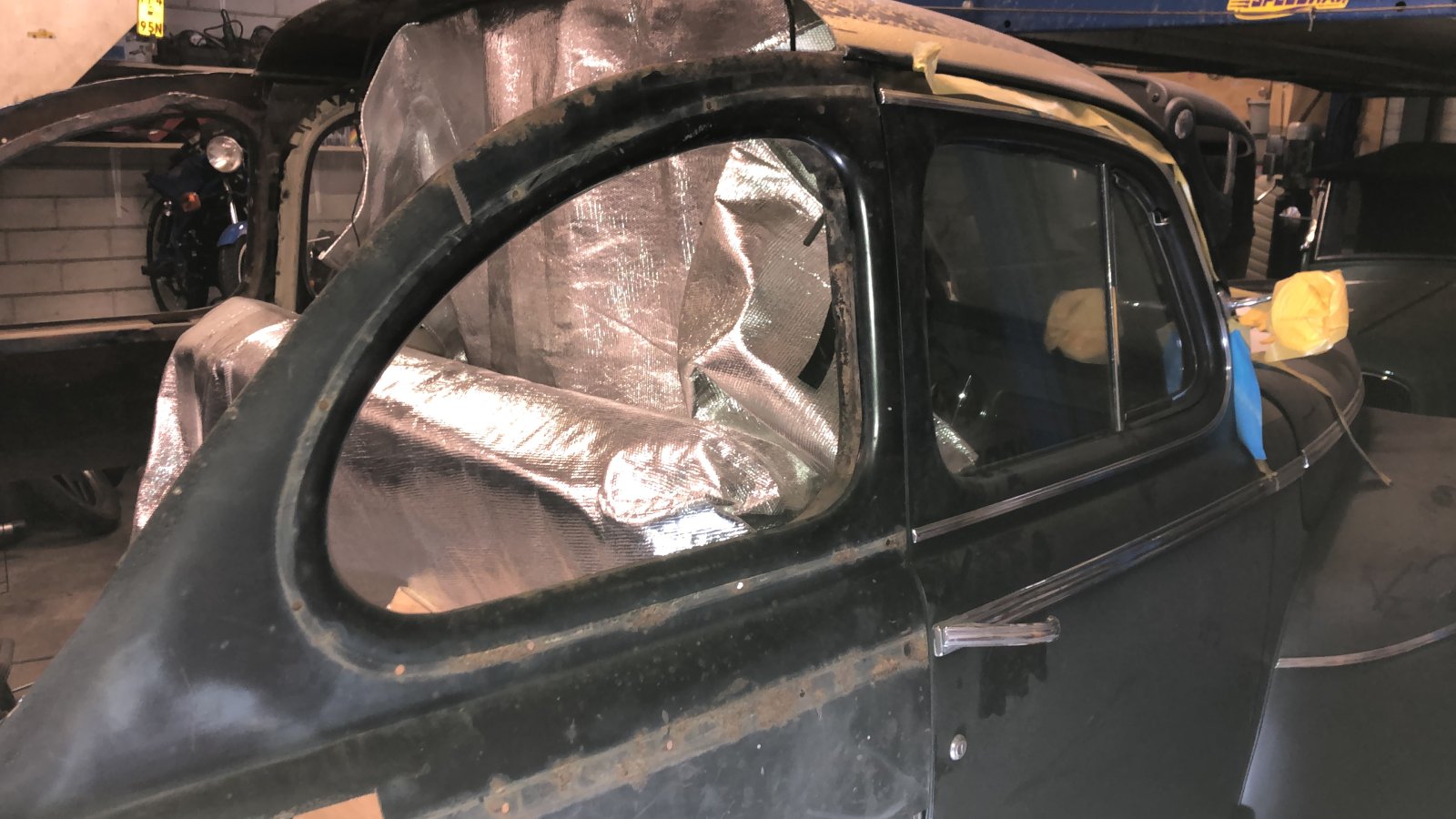

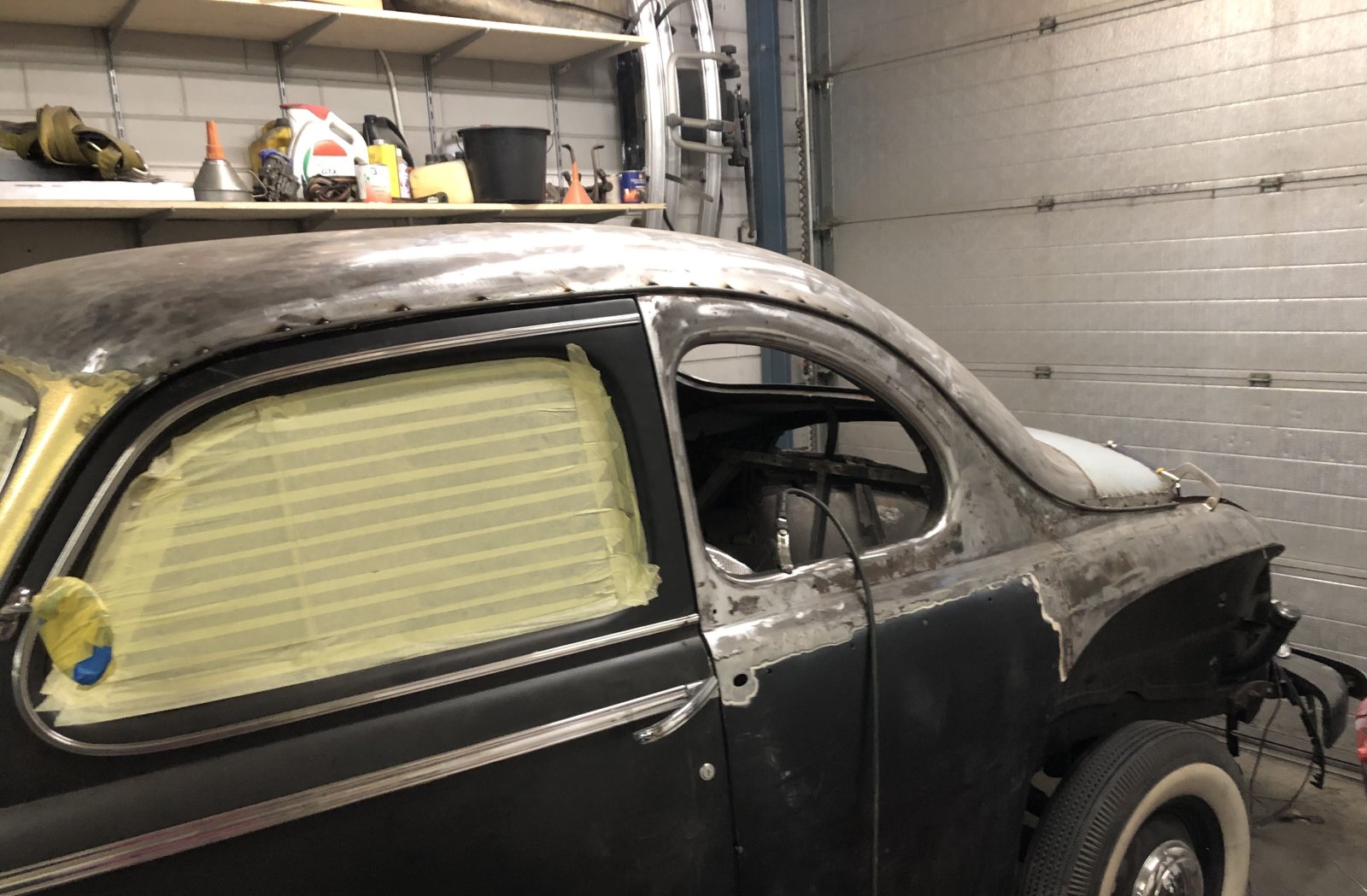

  5. dutchrod
    Joined: Feb 5, 2009
    Posts: 504
    dutchrod

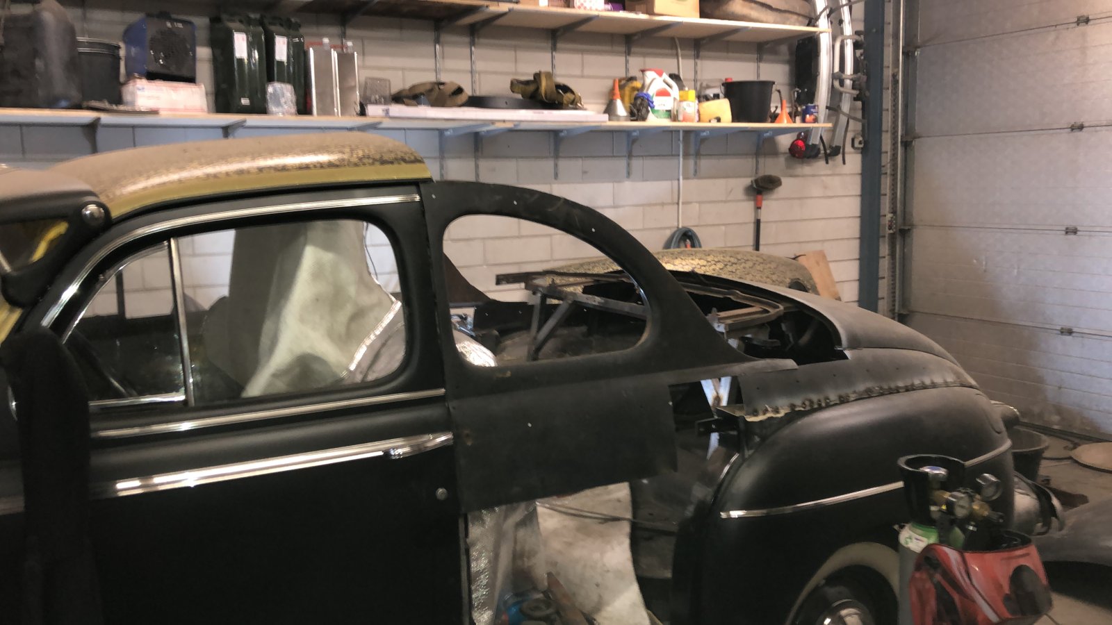

    Upper quarters tacked in place , now i can start working on the roof line.
    The roof i got is from a long door / sedan coupe and i want build a business coupe so that will be some slicing and hammering to get it right.
    But i’m having fun !
    6C7E16D1-7CE7-4D20-8E17-84E1A788DF53.jpeg 342F0A64-8DF0-411A-91CD-46DE8B7955D3.jpeg
    bschwoeble, Outback, EVL401 and 5 others like this.
  6. Squablow
    Joined: Apr 26, 2005
    Posts: 18,508
    Squablow
    Are the quarter windows the same between the long and short door coupes, or will this end up being a body style that never existed before? Either way I like it, but curious about possible differences.
    Outback likes this.
  7. dutchrod
    Joined: Feb 5, 2009
    Posts: 504
    dutchrod
    The quarter windows are exactly the same
    Outback likes this.
  8. Hamtown Al
    Joined: Jan 17, 2007
    Posts: 2,899
    Hamtown Al
    ^^I'm not sure I agree about the quarter windows being the same on the short door and long door coupes. I built a 47 short door coupe that comes with fixed rear quarter windows. I also had a pair of rear quarter windows from a long door coupe that would open. They didn't fit... at least not for me!;):D
    I ended up having to use the original fixed rear quarter windows. Anybody else try to change a short door coupe to use the swing out rear quarter windows?
    YRMV:D
    Uribe likes this.
  9. dutchrod
    Joined: Feb 5, 2009
    Posts: 504
    dutchrod
    I only know that long door coupe and fordor quarter windows are the same.
    The coupe parts i have are from a long door coupe.
    Business coupe quarters could be different.

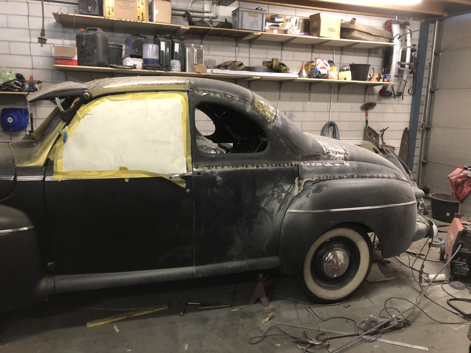

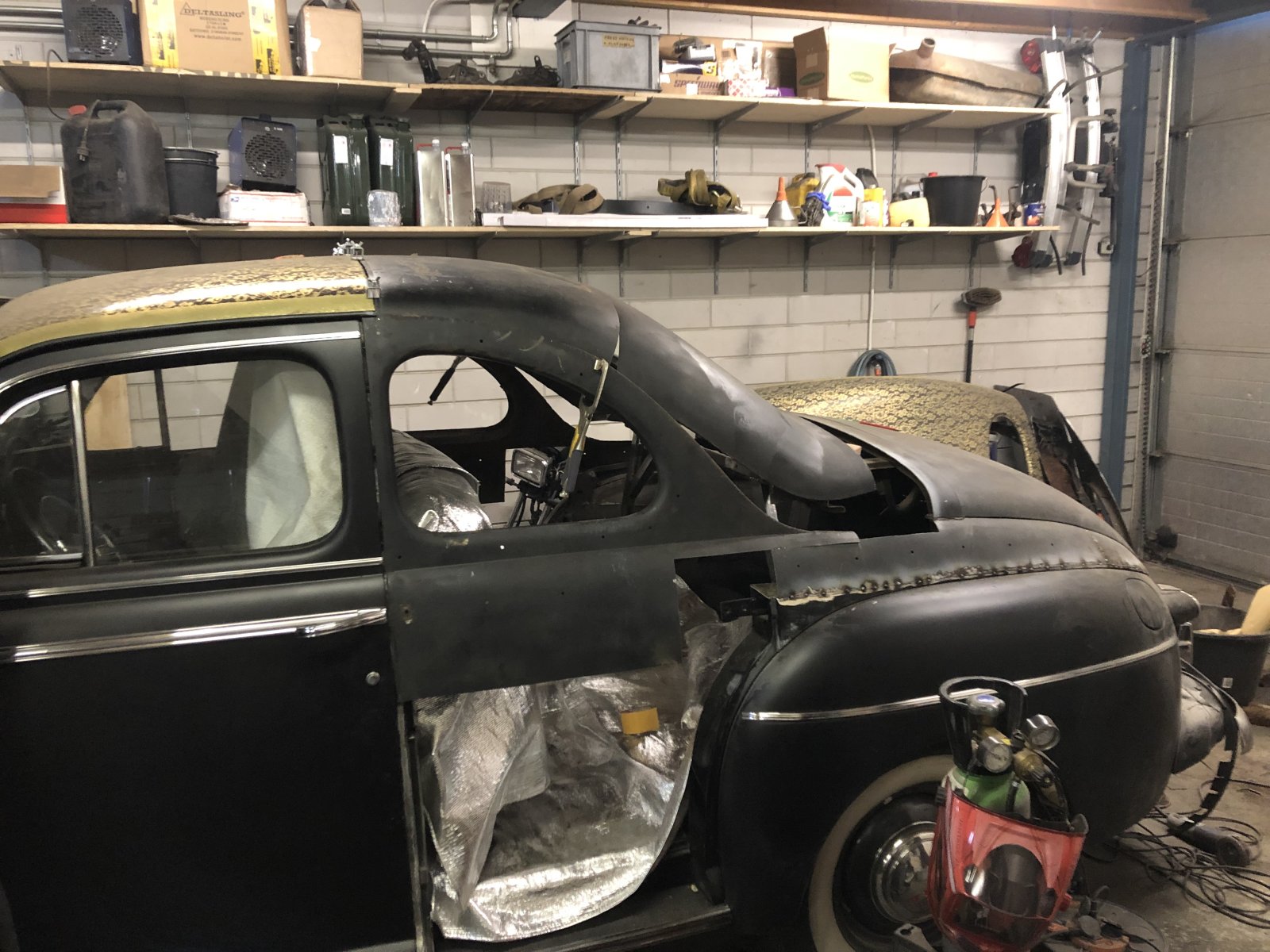

  10. dutchrod
    Joined: Feb 5, 2009
    Posts: 504
    dutchrod
    Flattened the roof to get the roofline how i like it.
    bschwoeble, Outback, EVL401 and 8 others like this.
  11. dutchrod
    Joined: Feb 5, 2009
    Posts: 504
    dutchrod
    Spent a whole day to square things up and to get left and right side the same.
    Now filling in the pieces using parts of the Fordor roof.
    Tomorrow the gap above decklid will be filled and then the quarters can be finished using parts of the old rear doors.
    bschwoeble, Outback, EVL401 and 6 others like this.

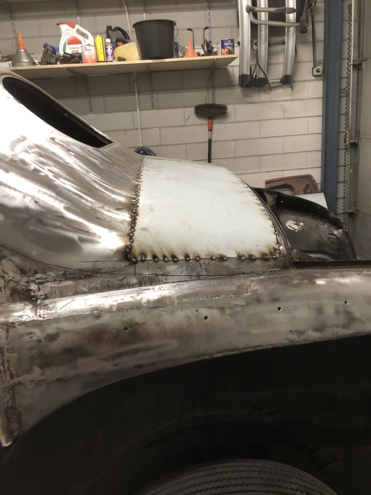

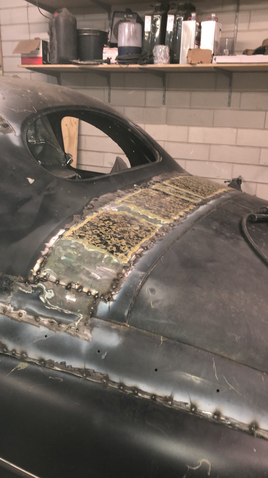

  14. dutchrod
    Joined: Feb 5, 2009
    Posts: 504
    dutchrod

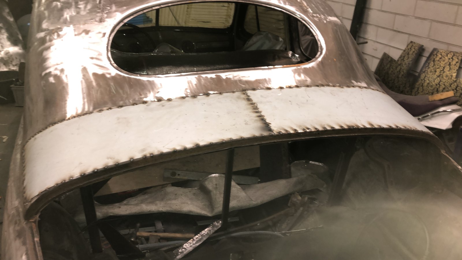

    Panel above decklid filled using roof parts.
    1F3042A5-6E70-465D-8B46-5AC904F97D58.jpg 92DE5312-6952-46F3-B0F0-86948D09EEAD.jpg

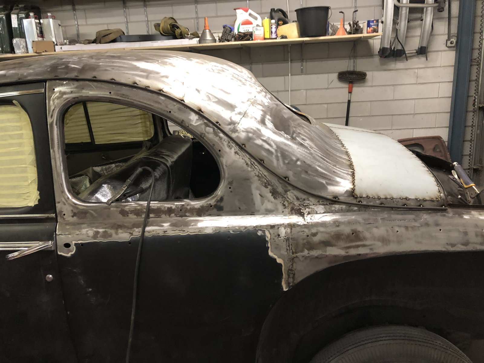

  18. dutchrod
    Joined: Feb 5, 2009
    Posts: 504
    dutchrod

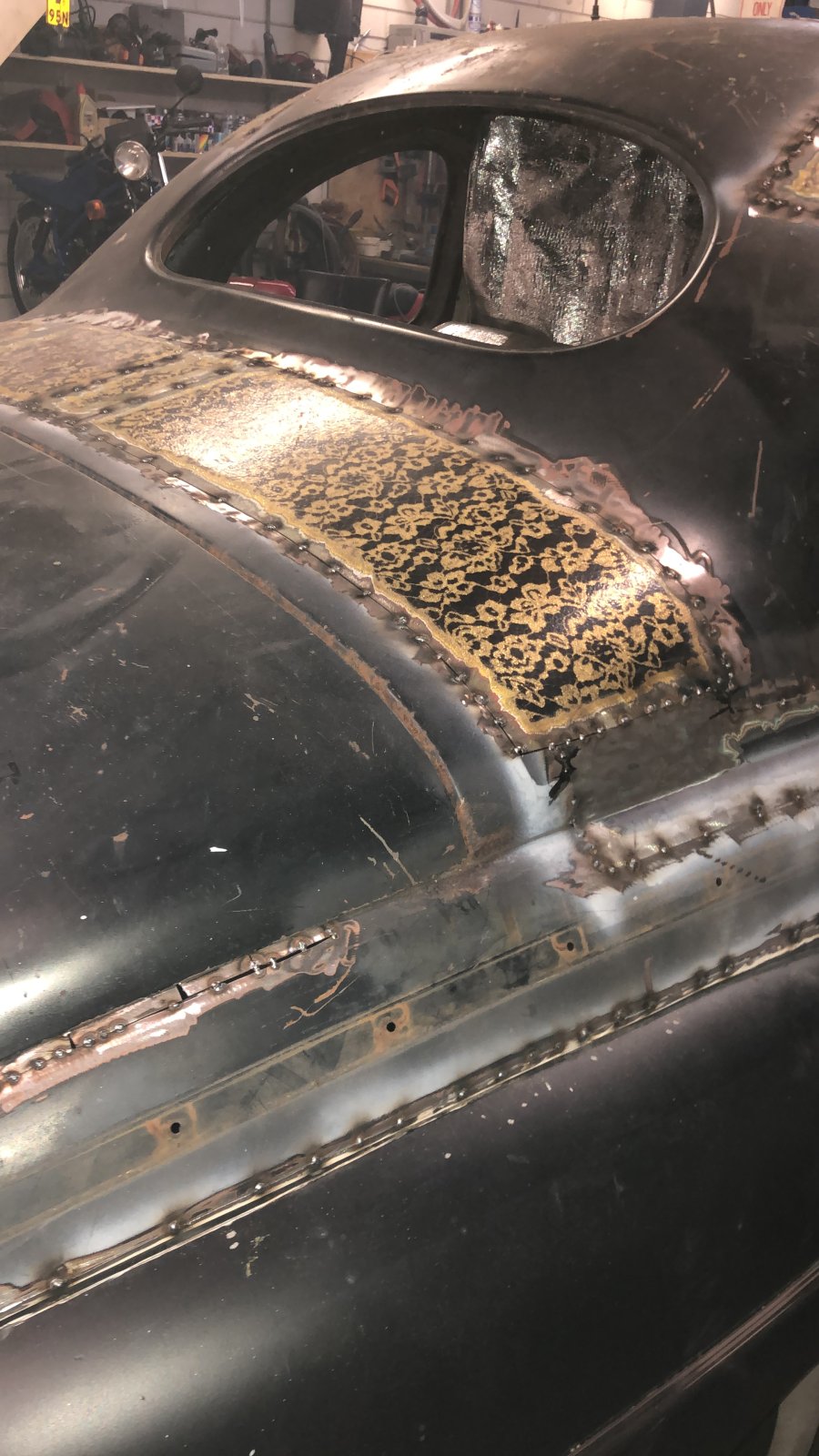

    Filled the quarters using the rear door skin, starting to look like a coupe.

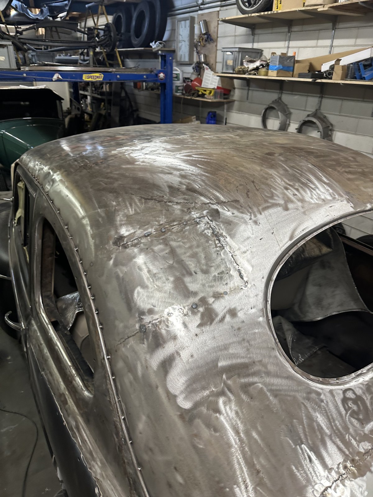

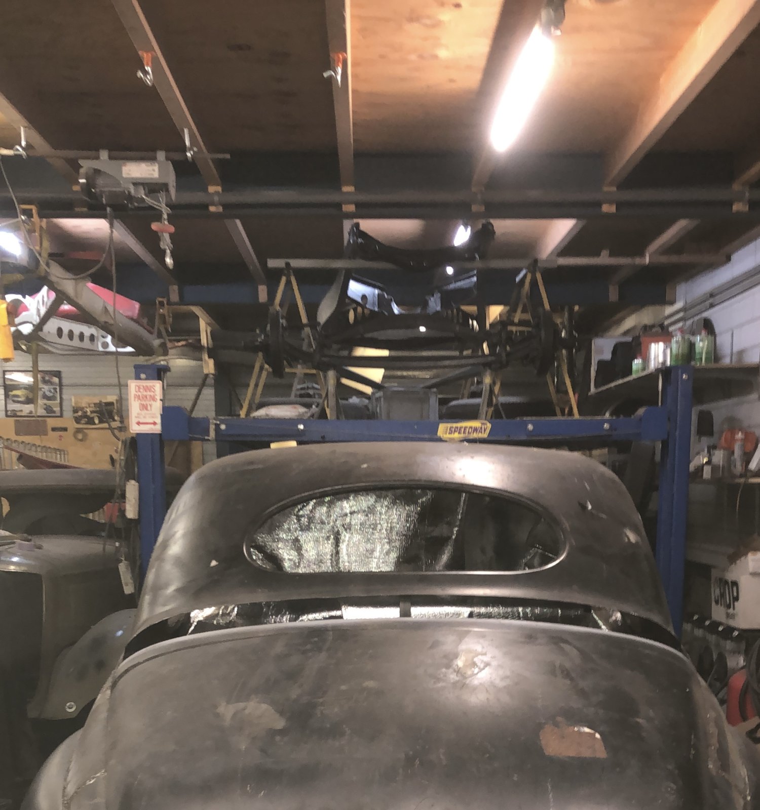

  20. dutchrod
    Joined: Feb 5, 2009
    Posts: 504
    dutchrod
    Had to do the panel between trunk and rear window over since it didn't look right, I used parts of the old roof but it had too much crown.
    A made a new panel and now it flows better.
    also made some driprails from round bar
    6603ADC2-2B23-4014-B0EA-B81317A86229.jpg IMG_0357.jpeg IMG_0360.jpeg IMG_0361.jpeg

  22. dutchrod
    Joined: Feb 5, 2009
    Posts: 504
    dutchrod
    Didn't had much time to work on it last summer but we are back at it !
    Close to finish the welding ,chasing pinholes and fight oil canning and a lot of grinding ...... IMG_2224.jpeg so soon I can start bodywork.

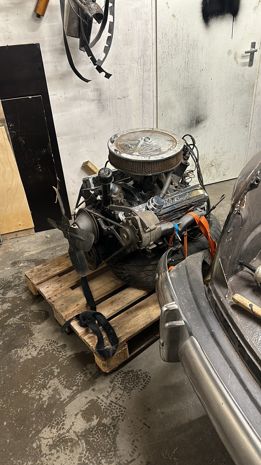

  23. dutchrod
    Joined: Feb 5, 2009
    Posts: 504
    dutchrod
    Bought a 283( I know chevy in a ford ) that I will put in with a adapter to mate it with the stock trans and driveline.
    Will get nice valve covers and air filter.
    bschwoeble, Outback, EVL401 and 4 others like this.

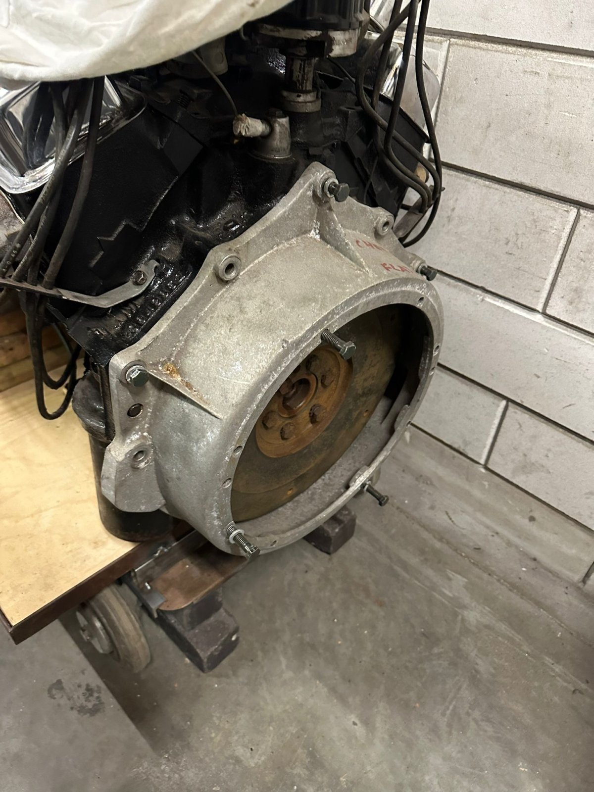

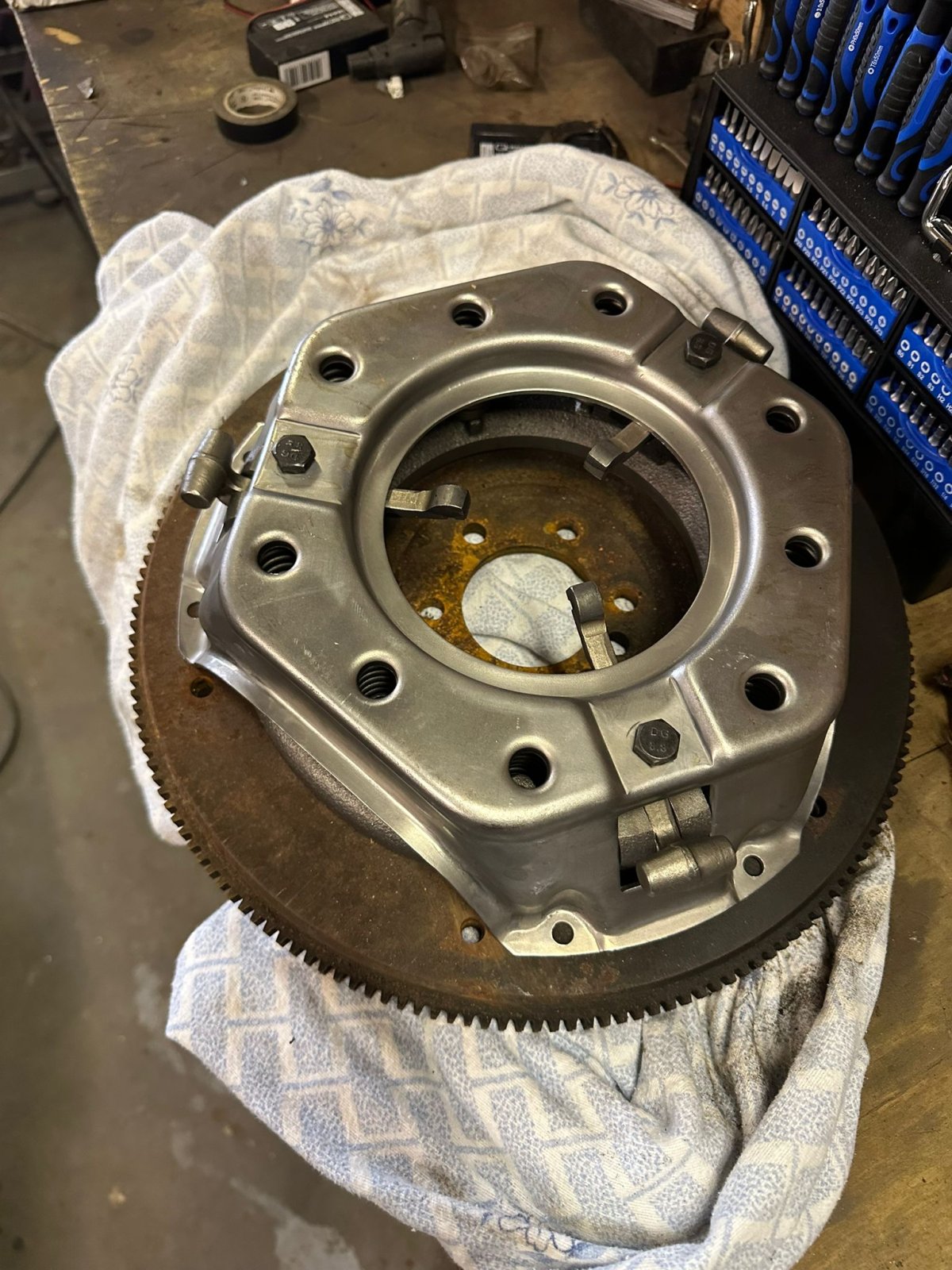

    Joined: Feb 5, 2009
    Posts: 504
    dutchrod
    I bougth a 168 tooth flywheel and test fitted the flywheel and adapter that I kept in storage for years.
    I could not find a 51 borg beck mercury clutch that would bolt right up this flywheel , I have a new 10" ford clutch and clutch plate so I will have my flywheel re-drilled.
