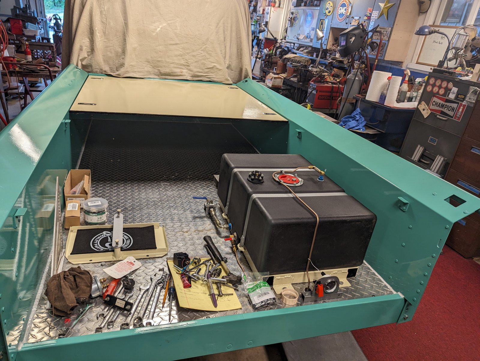

    PXL_20240522_004702959.jpg The gas gauge is installed.

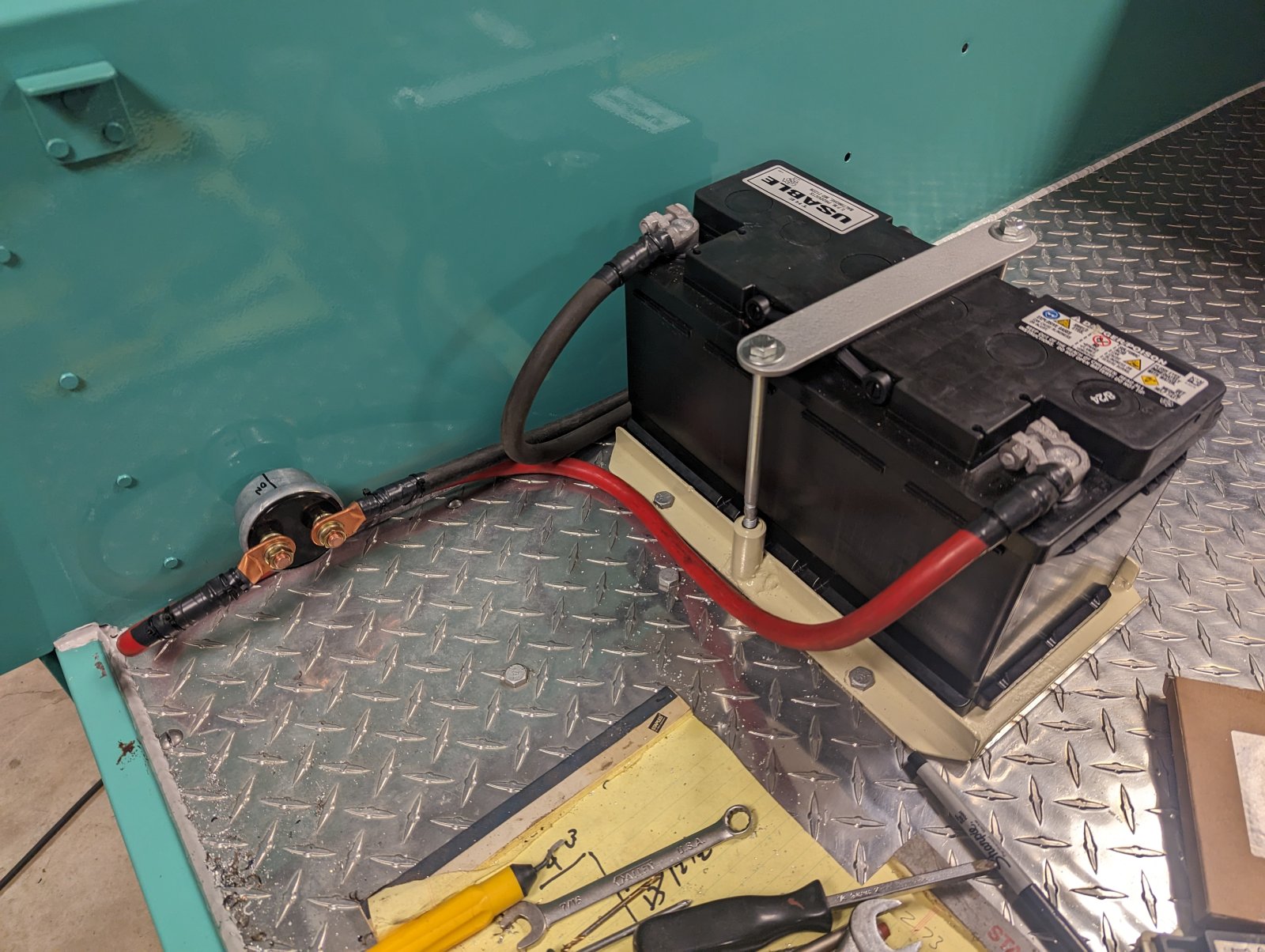

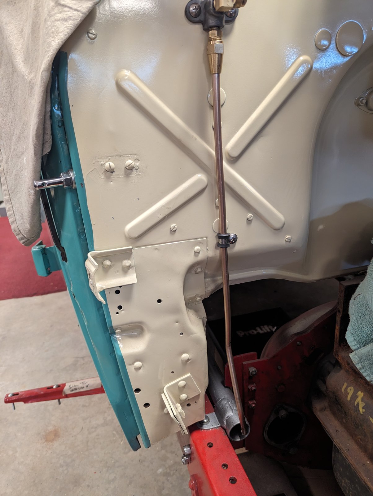

    PXL_20240710_210555787.jpg PXL_20240710_210519037.jpg PXL_20240710_210541334.jpg We got the fuel line run up to the firewall. The electrical shut off is beside the battery.
    swade41, Okie Pete, LAROKE and 7 others like this.
