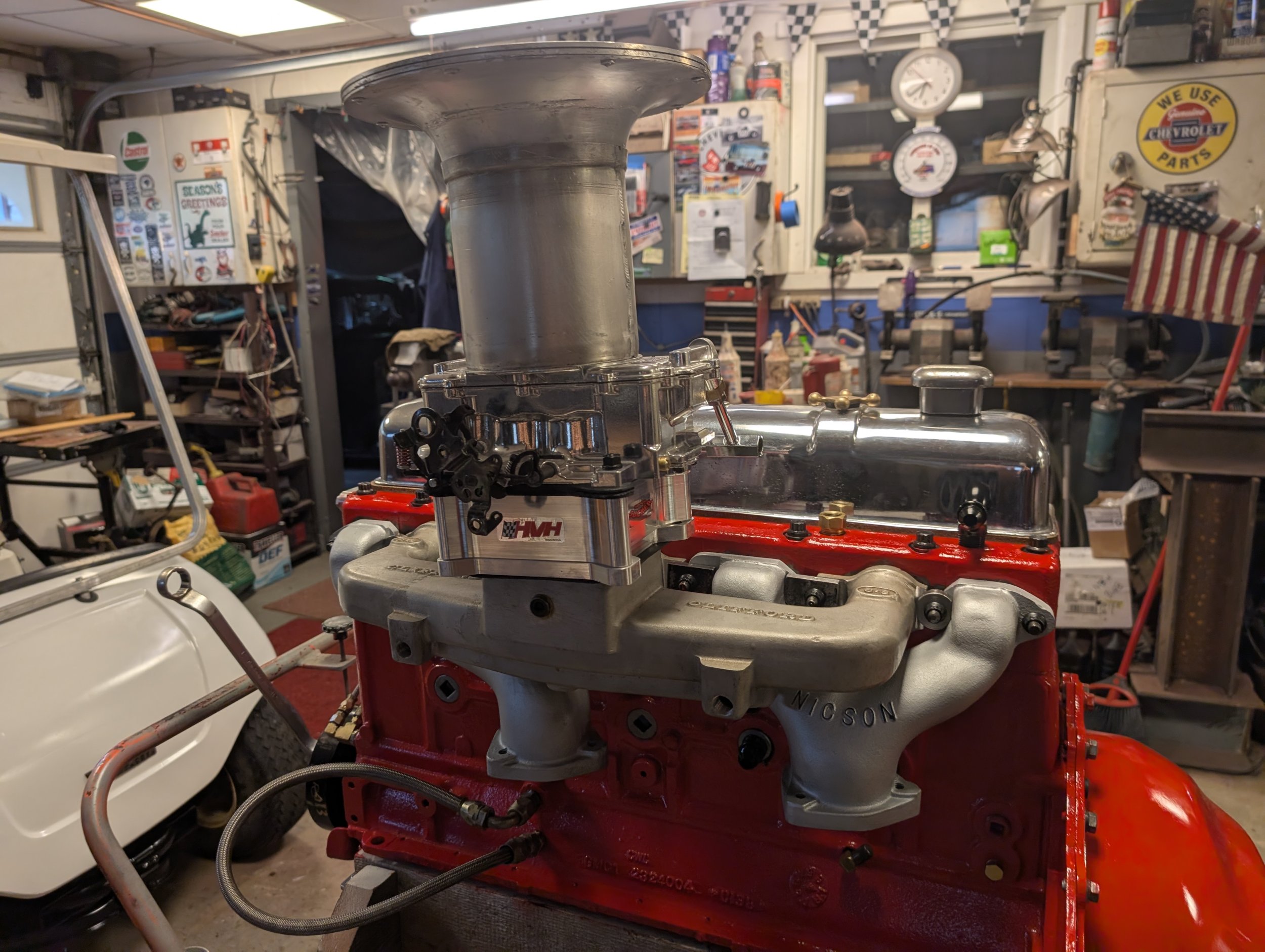

    Marcia
    PXL_20250427_164617093.jpg Preparing the head. 302 GMC.

    Hotwyr
    Where did the midplate come from? Great looking work on the entire truck.

    Marcia
    Frank made it. He's clever like that.
    Thank you.

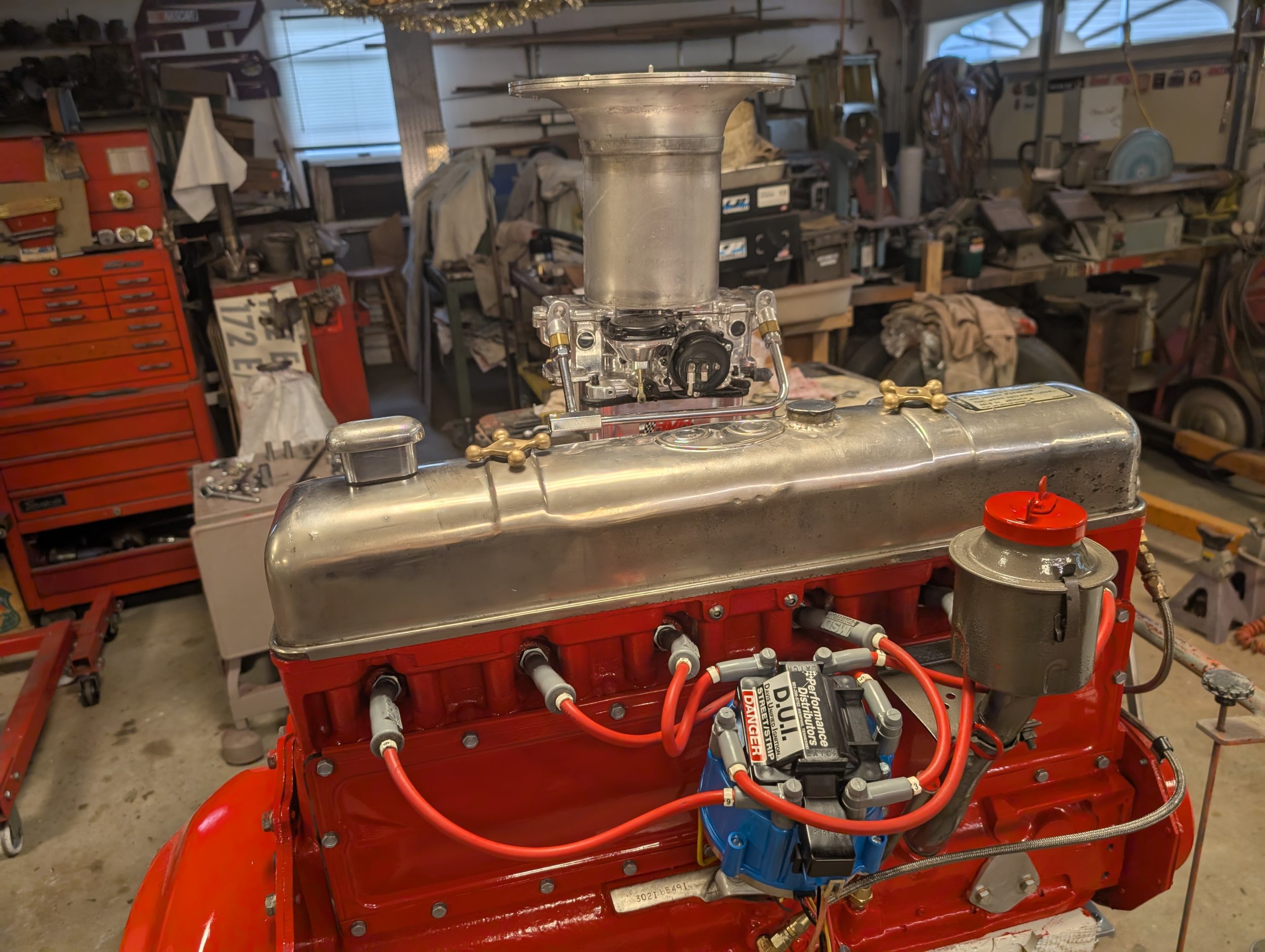

  12. Marcia
    Joined: Feb 27, 2009
    Posts: 1,052
    Marcia

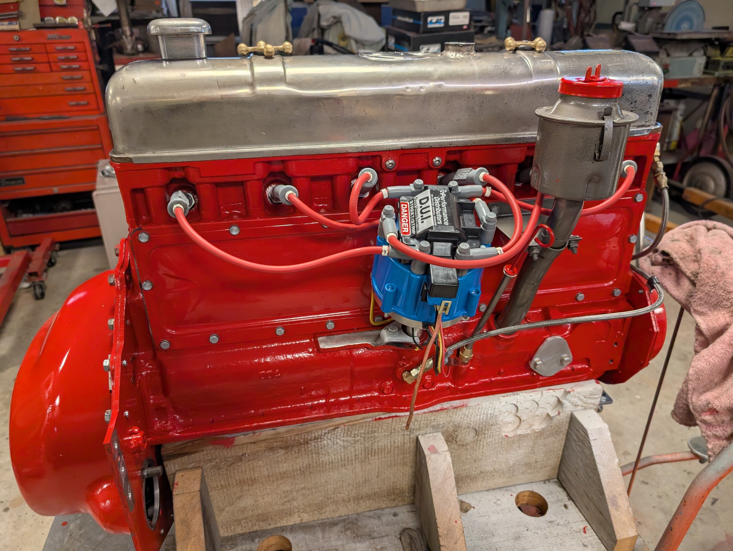

    from Nevada
    Very nice! Like the valve cover hold downs. What distributer is that, a GM HEI ? Do you gave a source for the cap on the oil filler/breather? I lost mine and with all the GMCs sitting around here I don't have another. Looked on eBay till I gave up.
    Stogy, chryslerfan55 and 41 GMC K-18 like this.
  16. Marcia
    Posts: 1,052
    Marcia
    The distributor is a Summit copy of a late 6 cylinder Chevy HEMI. Frank modified it to fit.It has Davis Unified Ignition cap rotor coil module.
    The oil filler came on another engine. I don't have another.

  18. jimmy six
    Joined: Mar 21, 2006
    Posts: 17,146

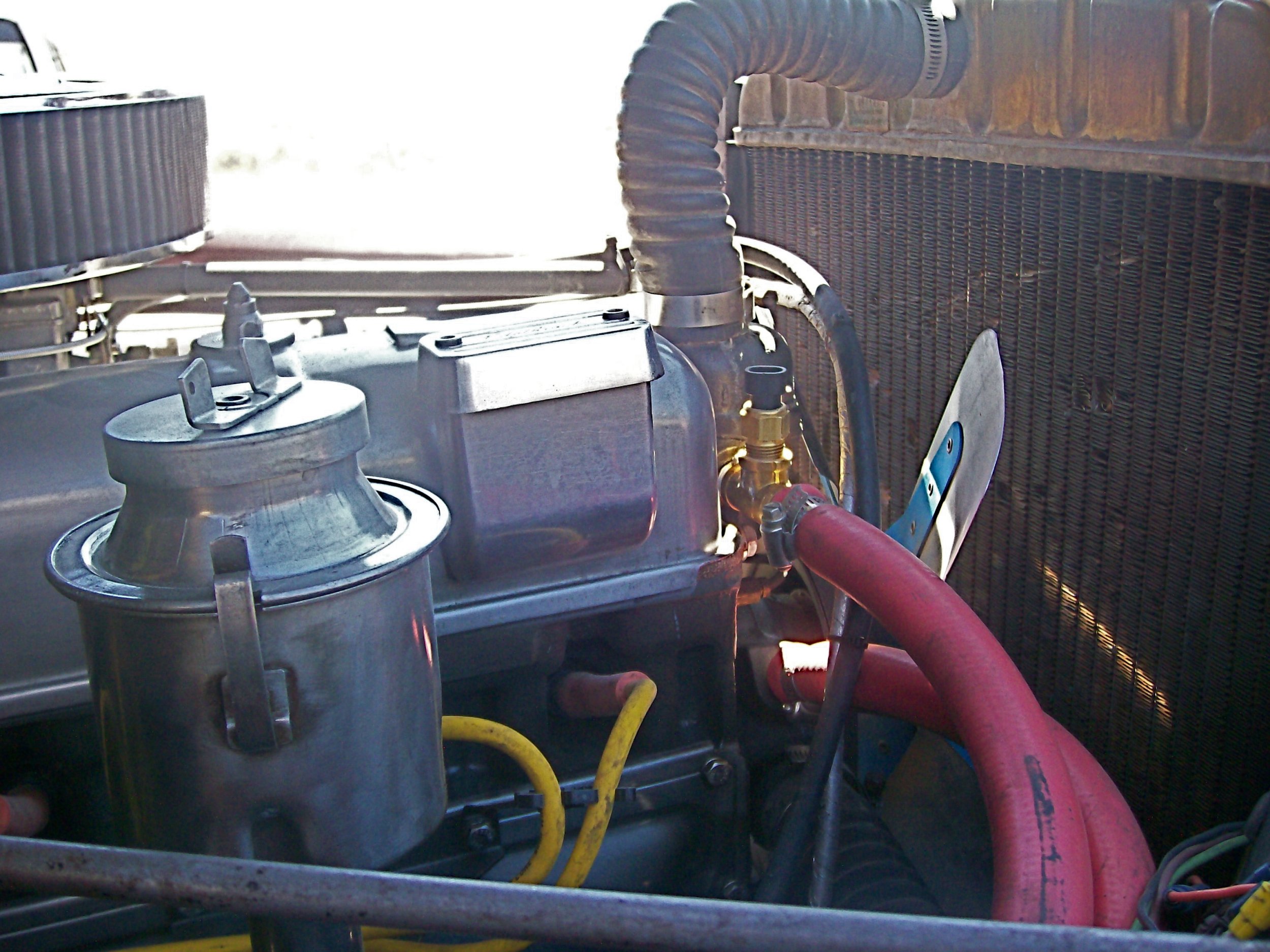

    jimmy six
    Oil filler is standard military even though that’s a civilian block. I see you have the deflector that mounts on the block on the inside. Every thing looks great!

    from Nevada
    Here's mine before I lost it. It was on the civilian 270 when I pulled it from a '57 pickup. They shouldn't be hard to find.

  20. Marcia
    Posts: 1,052

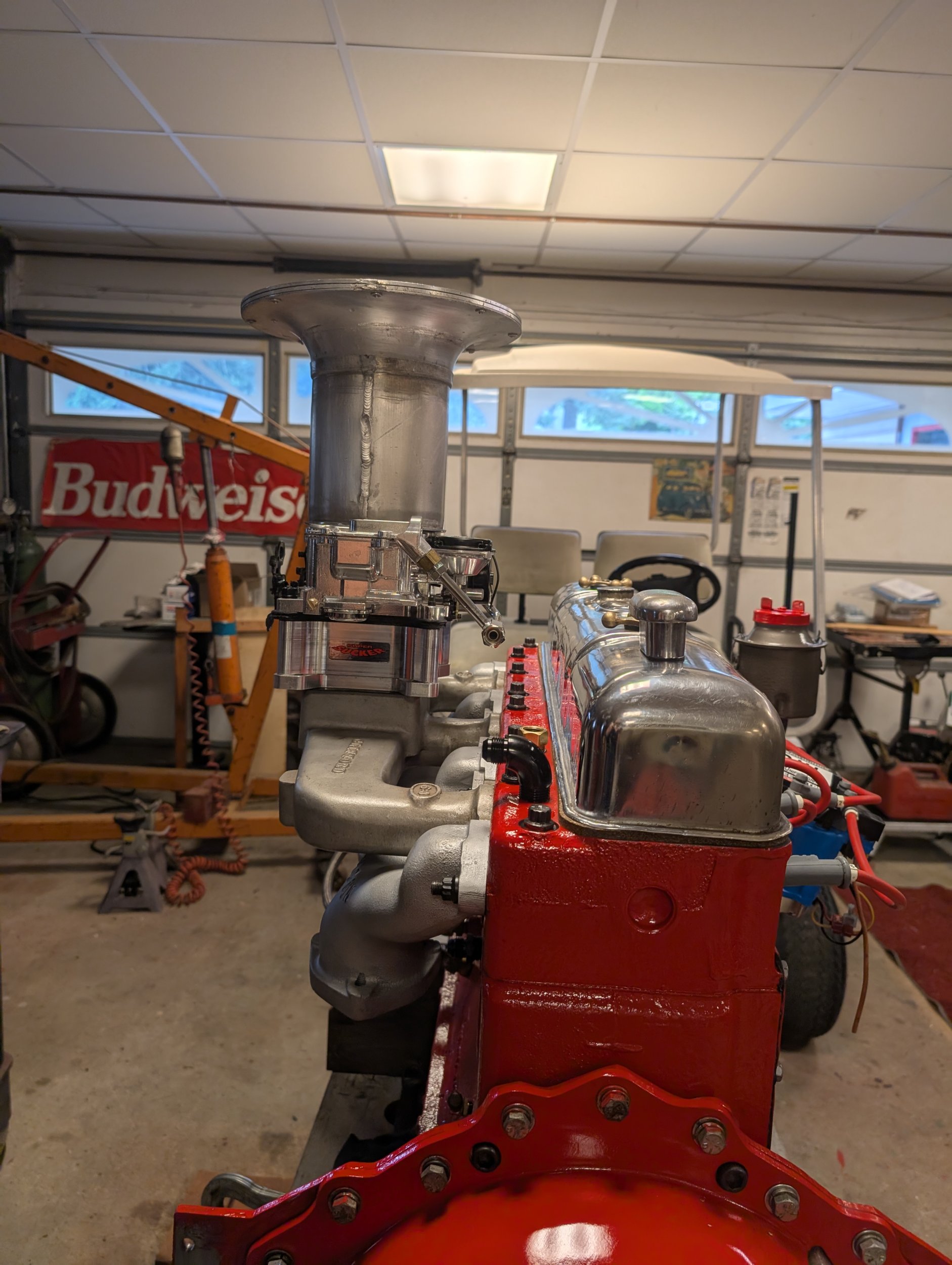

    Marcia
    The final version, maybe. PXL_20250512_224007850.jpg PXL_20250512_223957331.jpg PXL_20250512_223949152.jpg

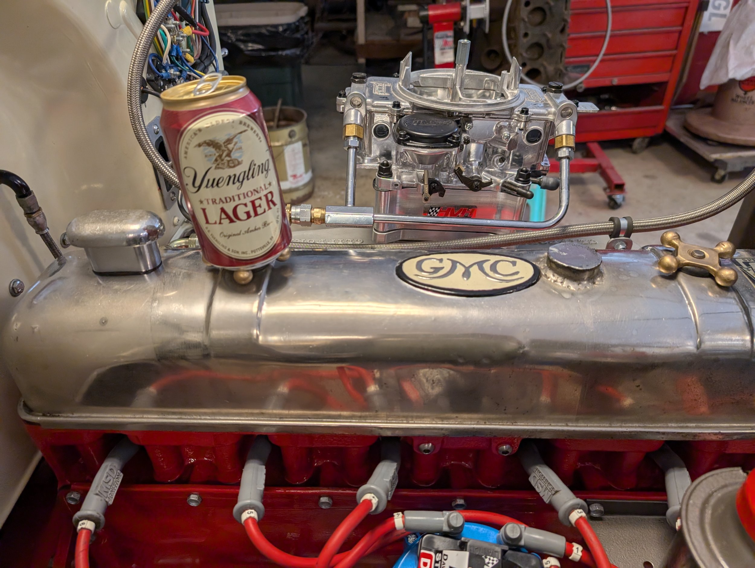

    Marcia
    PXL_20250523_134556988.jpg PXL_20250523_192143020.jpg PXL_20250523_204550066.jpg We ran the motor in yesterday. The Video is on Facebook, the Flying Seven. We'll replace the fuel pressure sensor and the tach. It sounds good. We're very happy!
