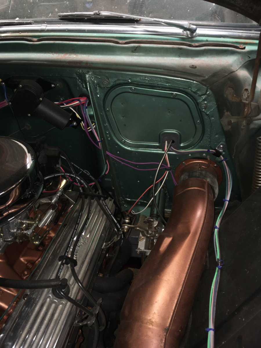

    if I HAD to have power brakes in one of these cars I would use a firewall mounted set up. Walton Fabrications makes one that utilizes the stock hole in the firewall in 49-52's. you can not check the fluid level or add fluid with these crazy things without going through a bunch of trouble.
    I had discs with no power ***ist on my last 49, they stop just as well, just a harder pedal.

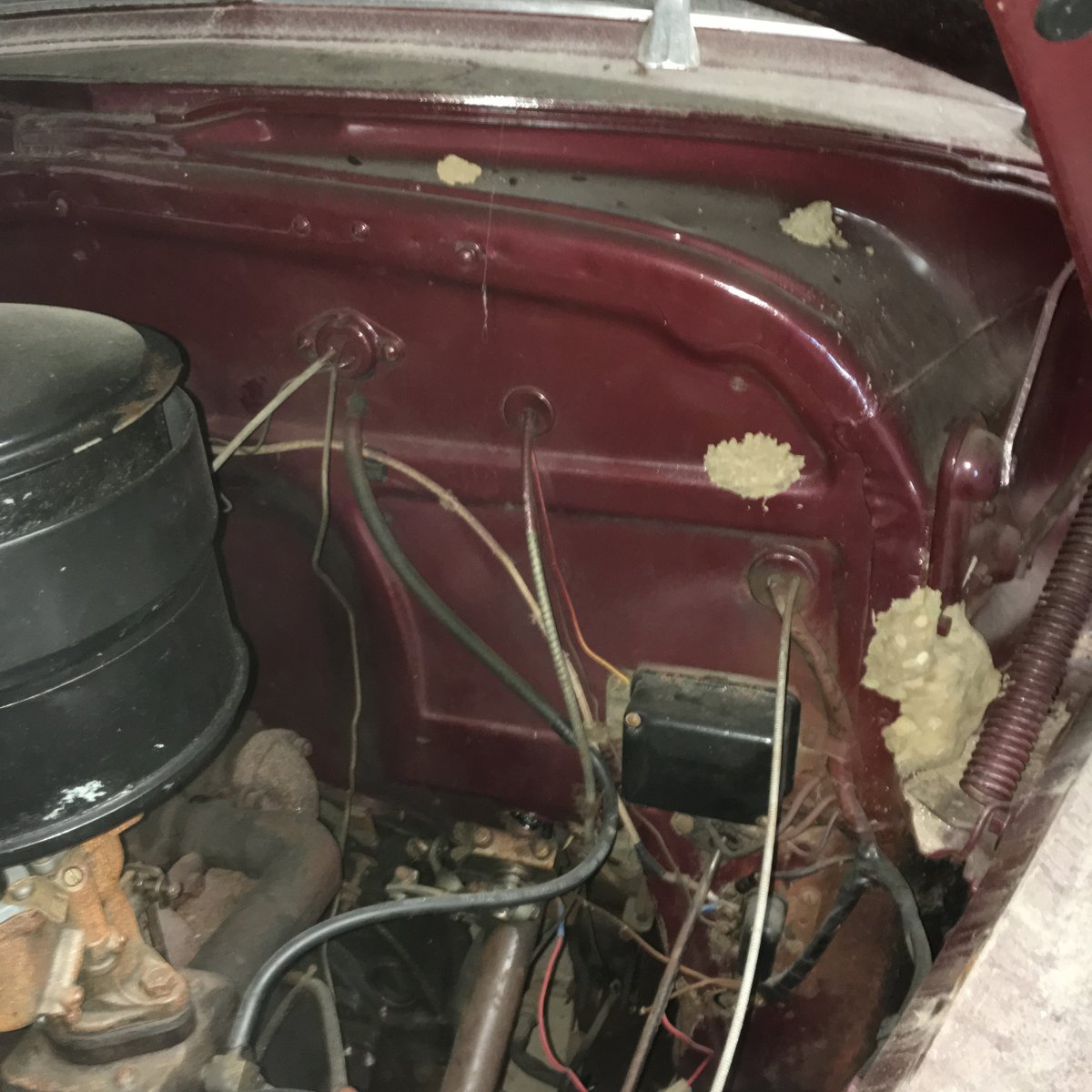

    '47s don't have that panel that the Walton swing pedal/master mounts to, so that's not an option. On my '47 Aerosedan the plan is to use a universal type swing pedal like is available from Kugal Komponents or even Wilwood. But I need a hydraulic clutch too and don't fancy having to crawl under the car with a mirror to check fluid level.
