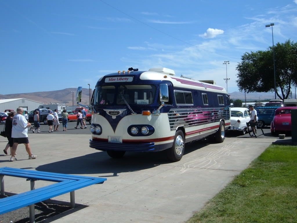

    A local couple redid this one a few years ago. [​IMG]
    My buddy has a 59 that is an older conversion that will end up being someone's barn find bus one of these days. He has it stashed in the oversize garage he built for it and it hasn't been out for several years.

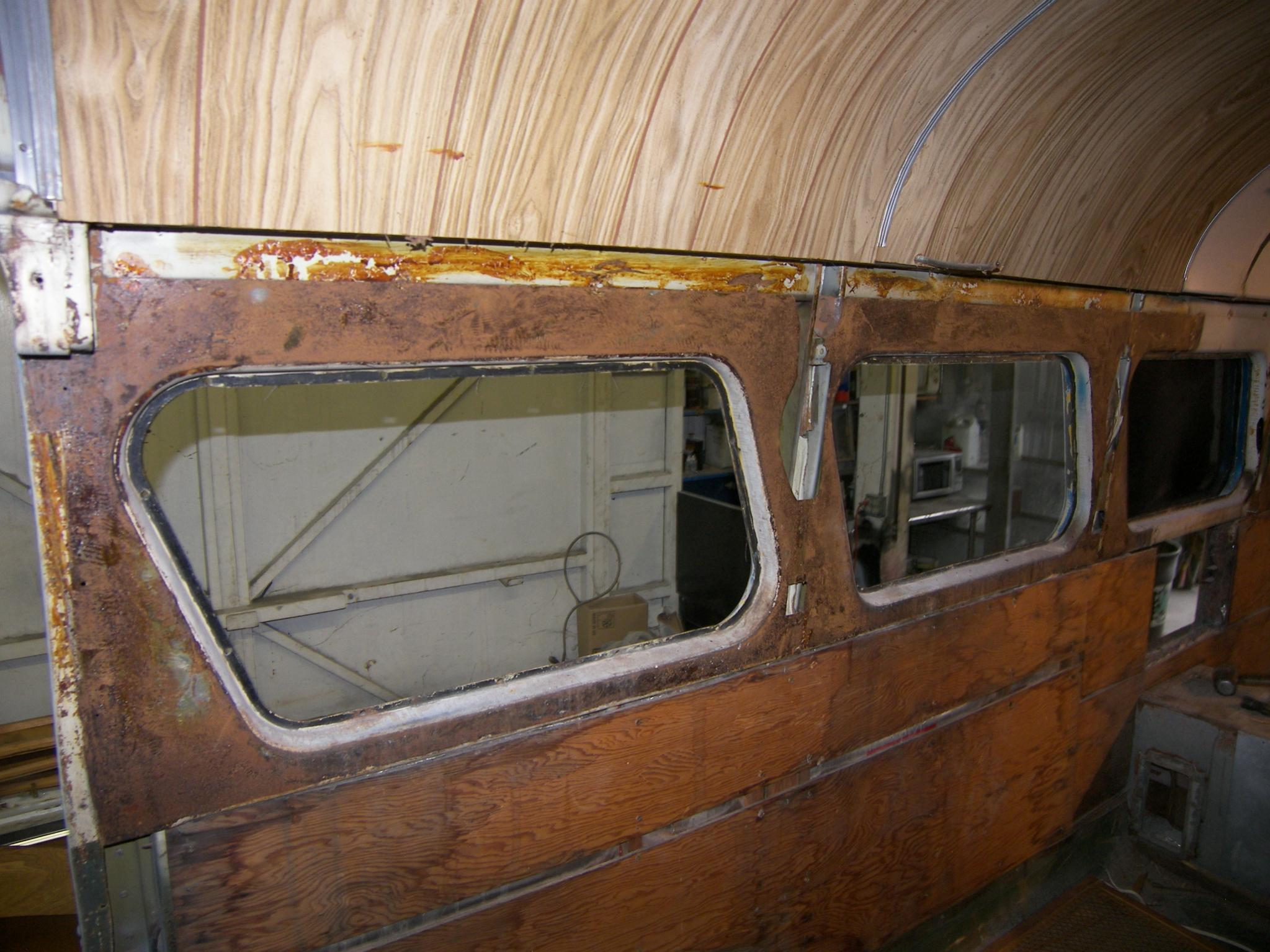

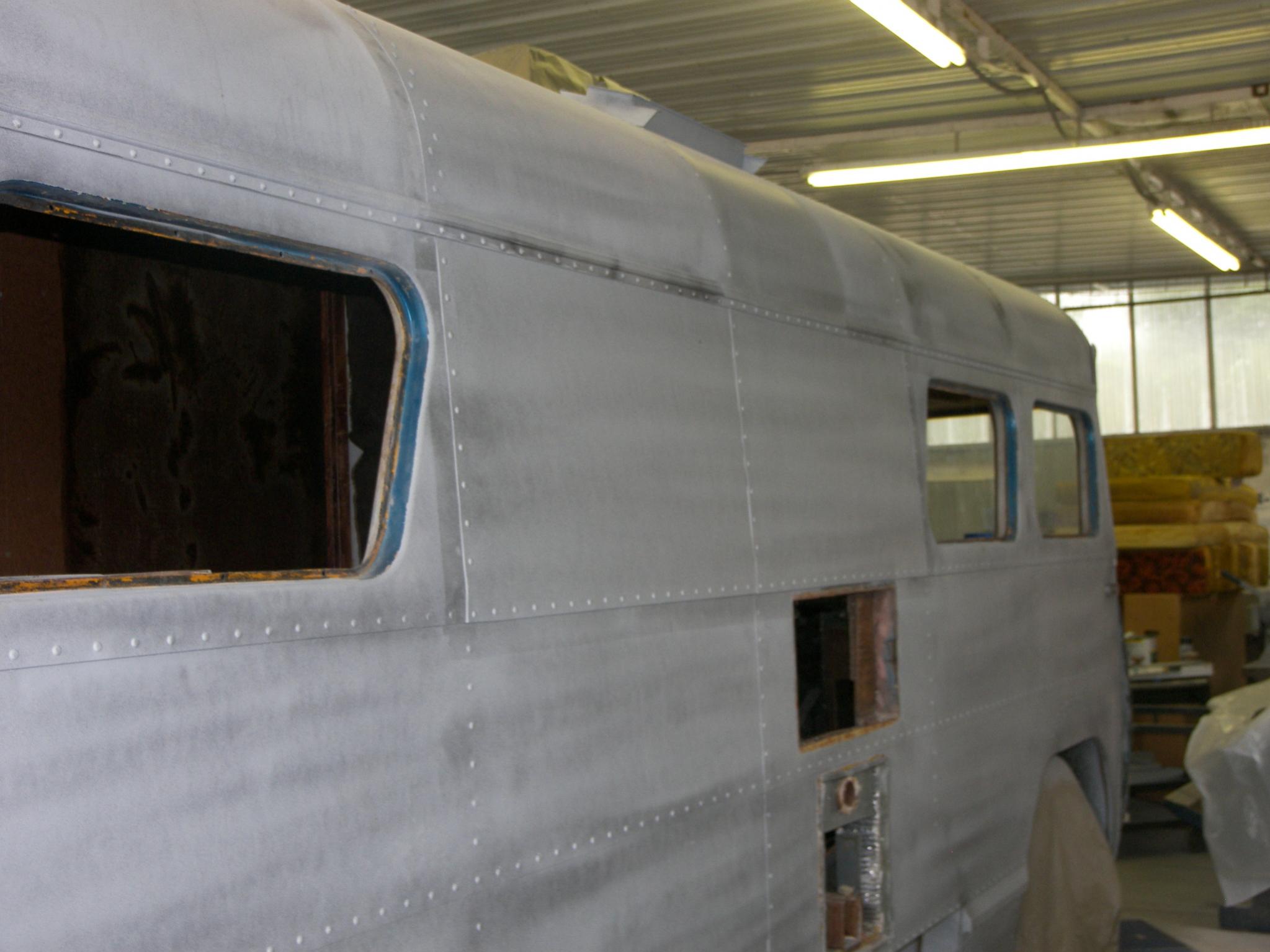

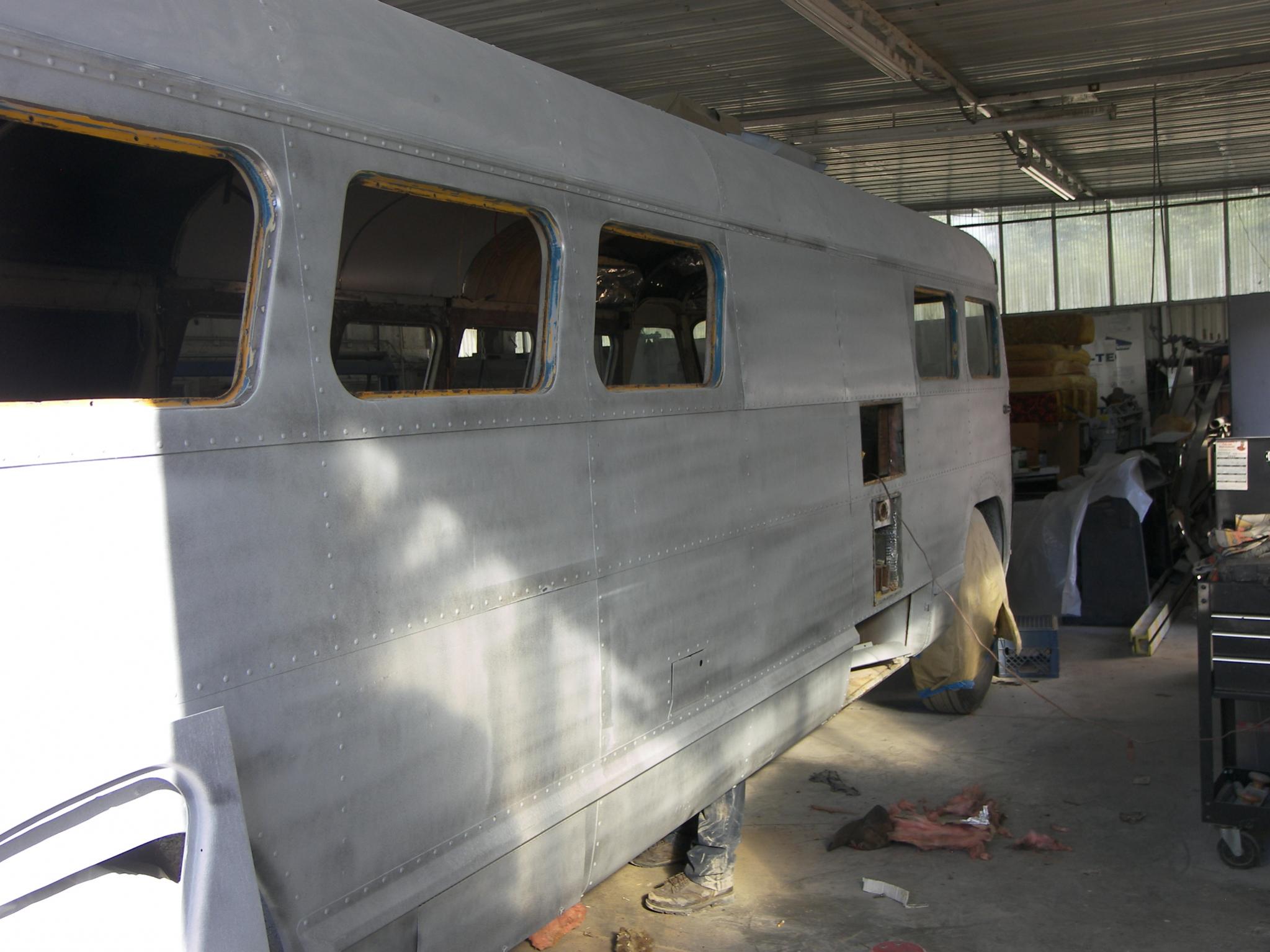

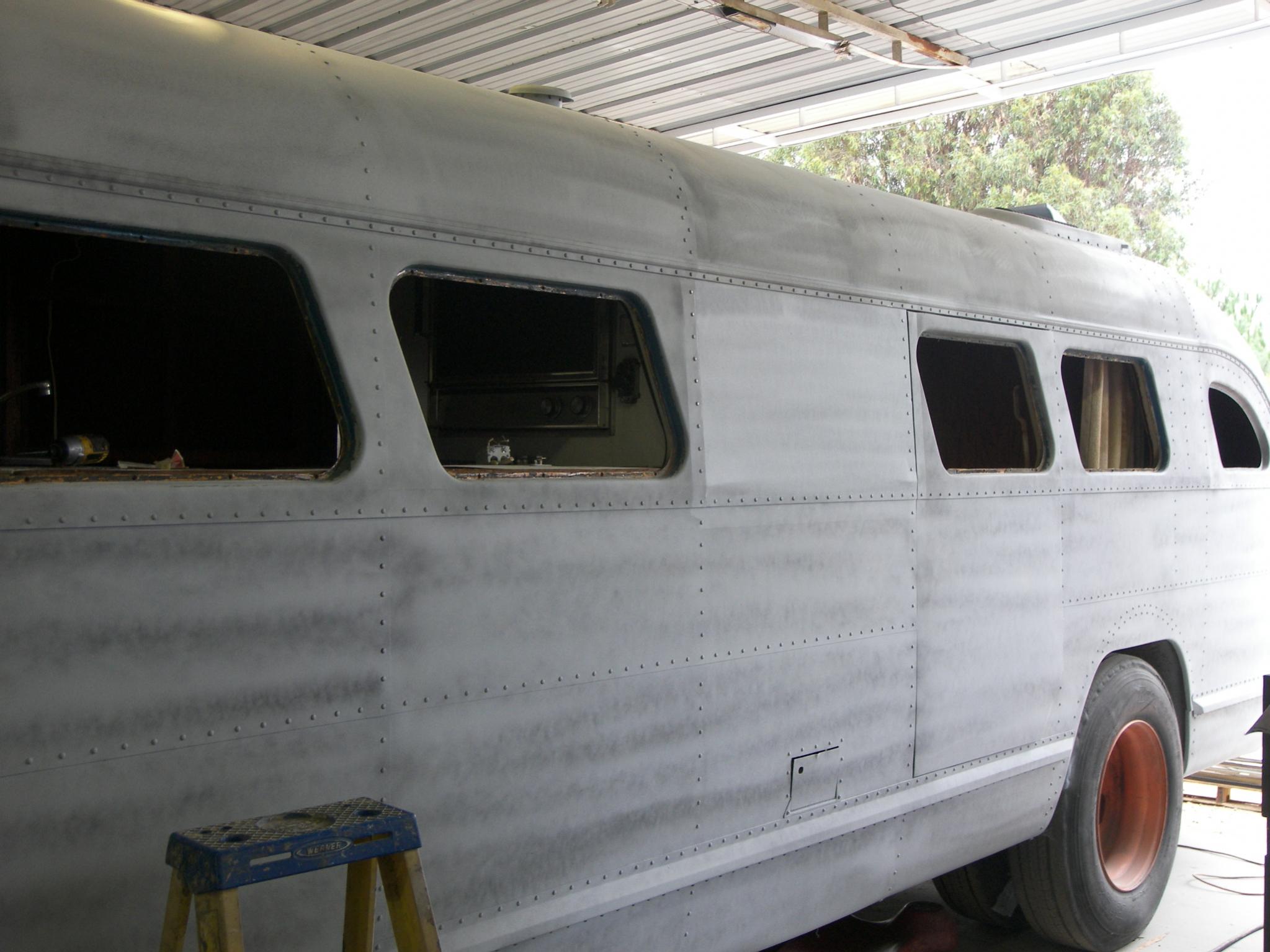

    Although I didn't really want to, some of the windows have been skinned over where appliances and cupboards are behind them. If the gl*** get broken or there is a leak on the window seal, the interior may need to come out and I didn't want that!
    Also the body shop has done a great job on repairing a ripple in the roof that needed the outside and inside skin taking off:(

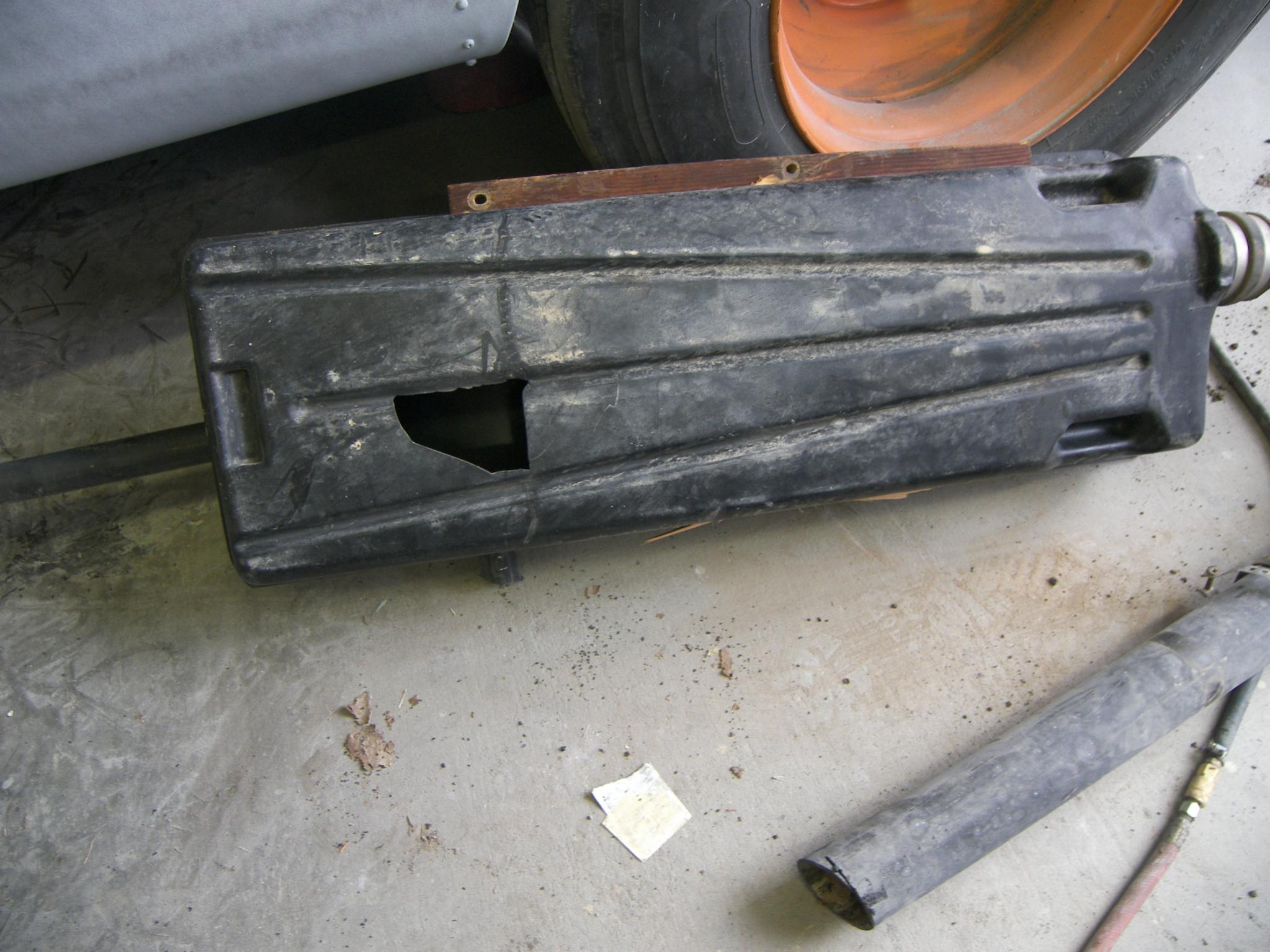

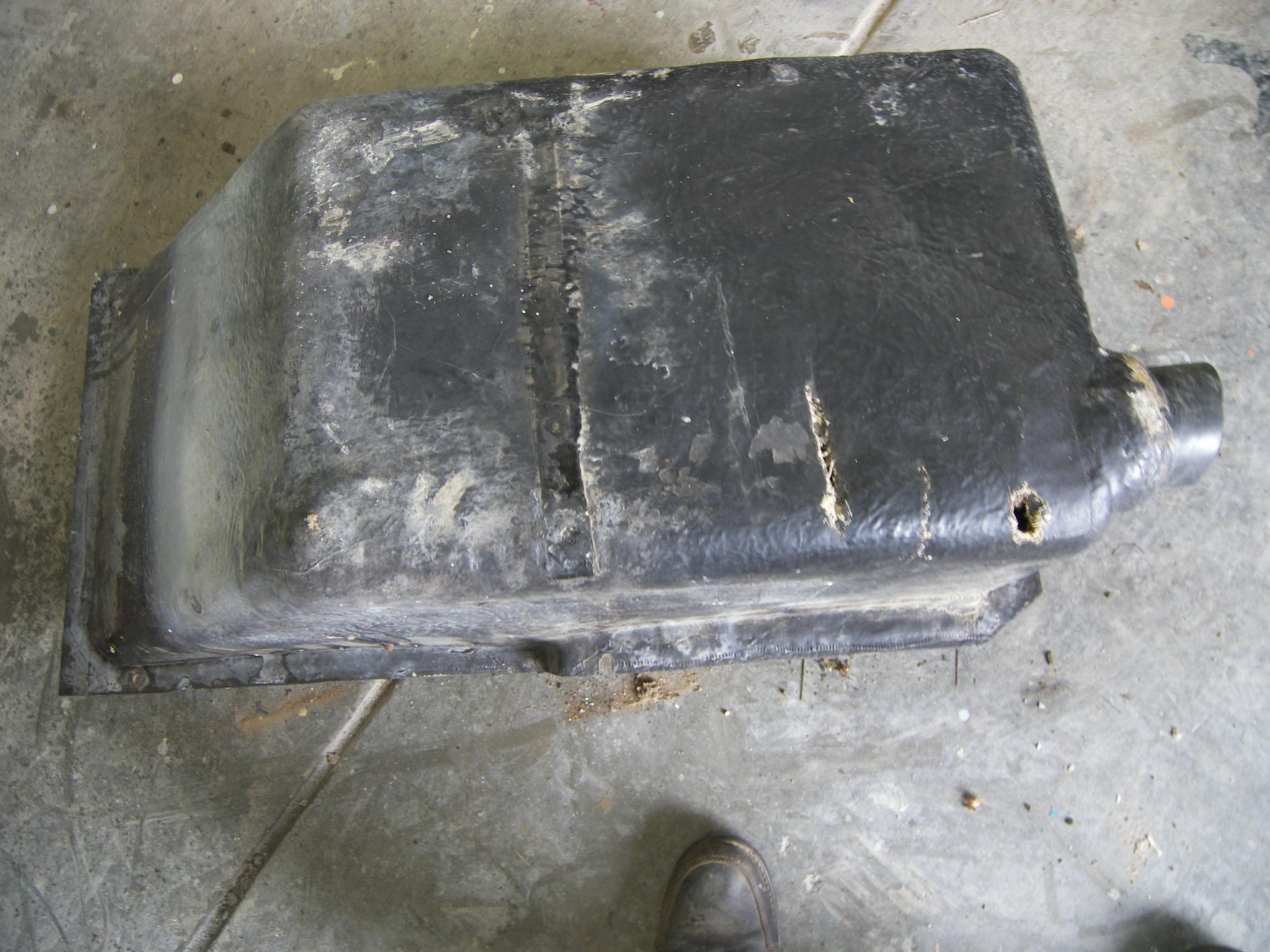

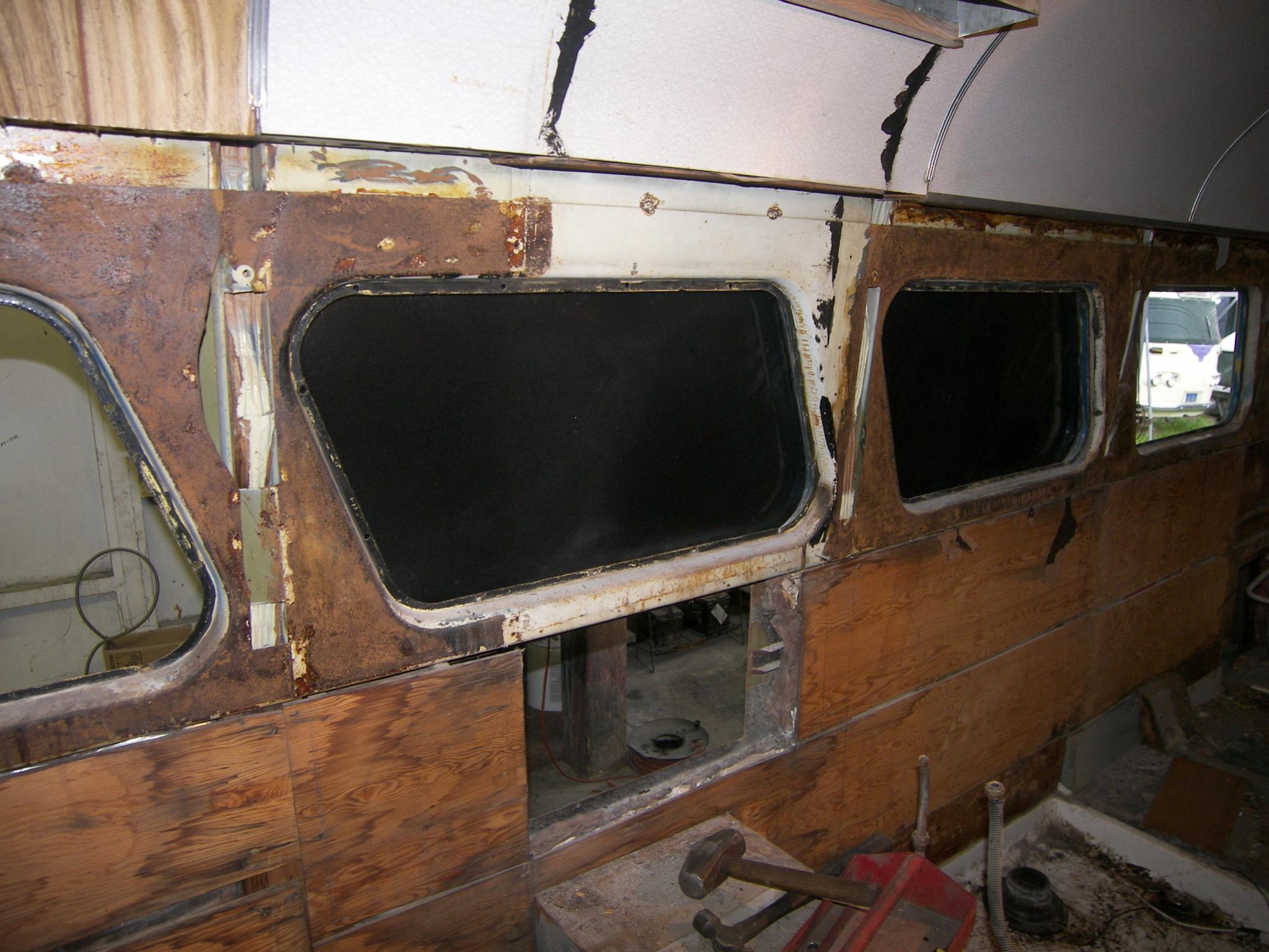

    The interior is about 90% stripped now. The restorer has found some serious rust issues around two windows but should be replaced with new metal by the end of next week. The old black and grey tanks are shot so new ones will have to be fabricated as there isn't a lot of room under the bus.

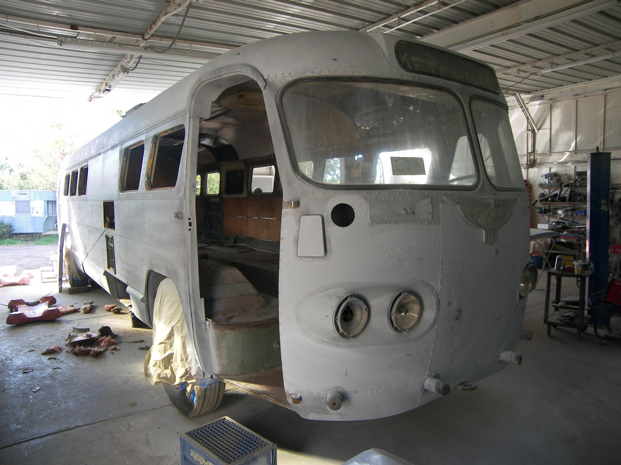

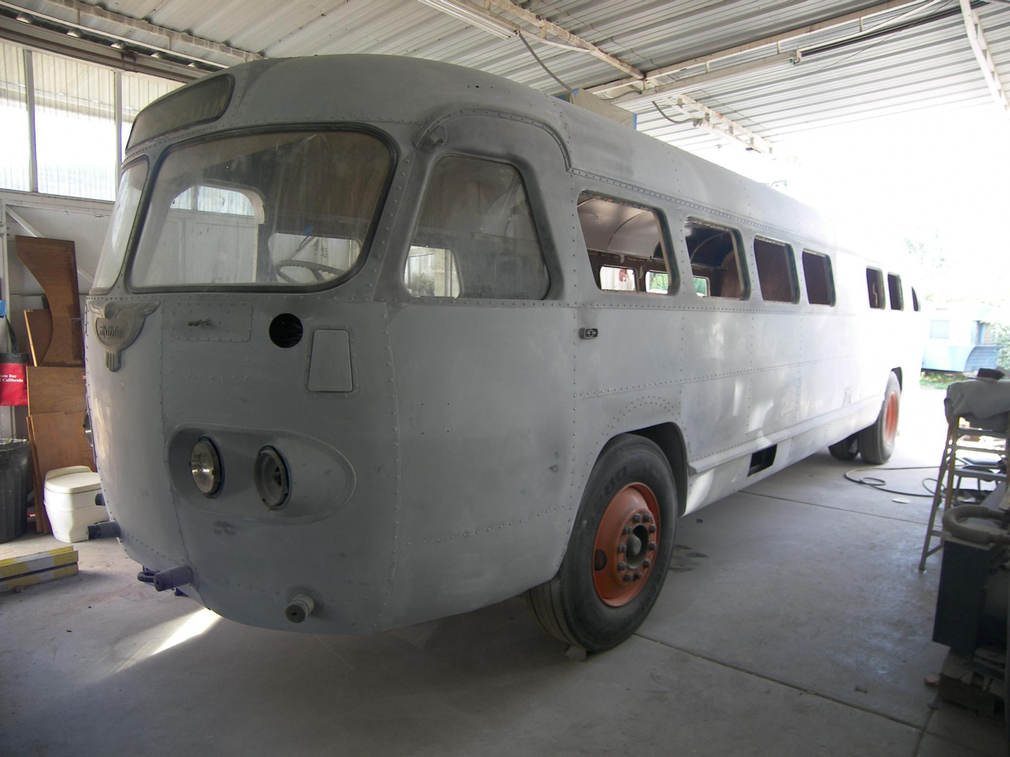

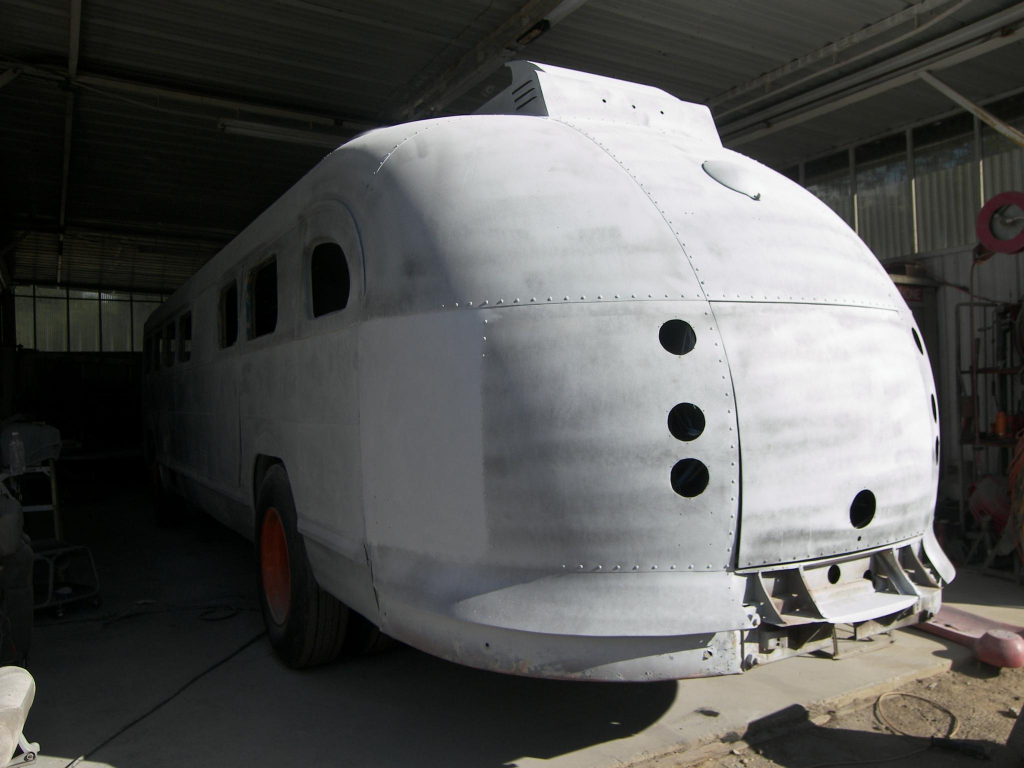

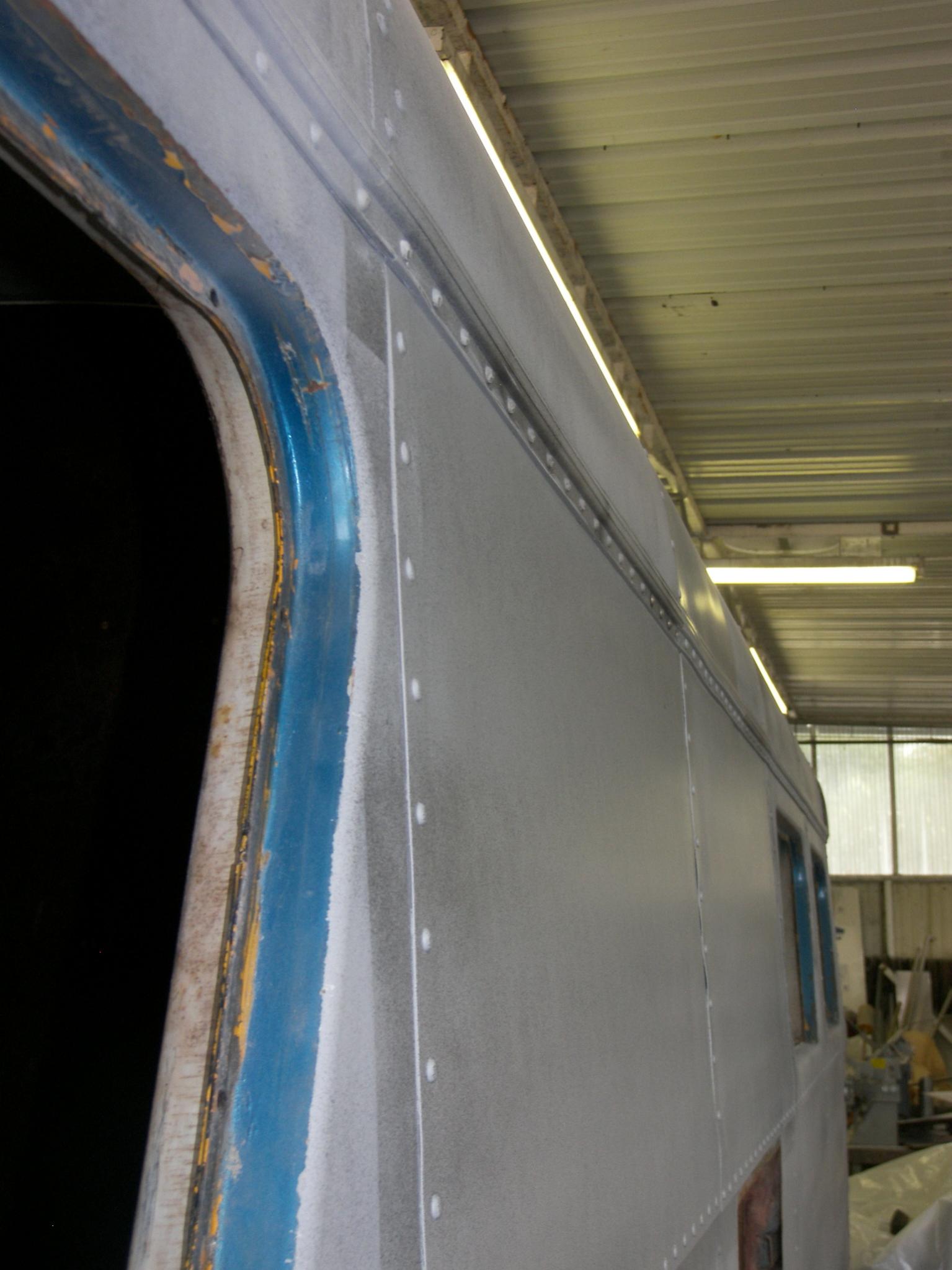

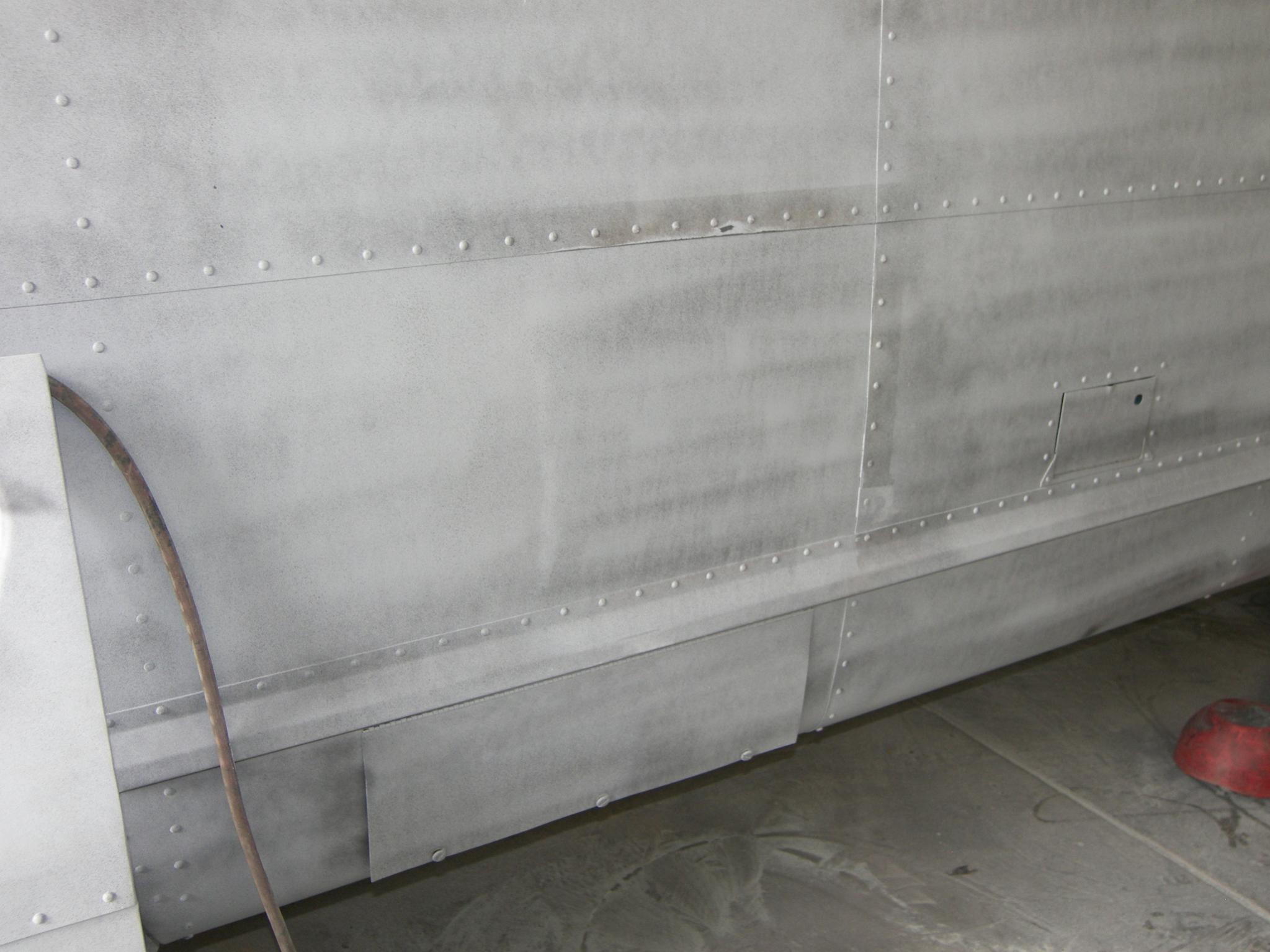

    The Flxible is getting it's final sanding before paint. I'm glad someone else is doing the work, don't think I would have the will power!!

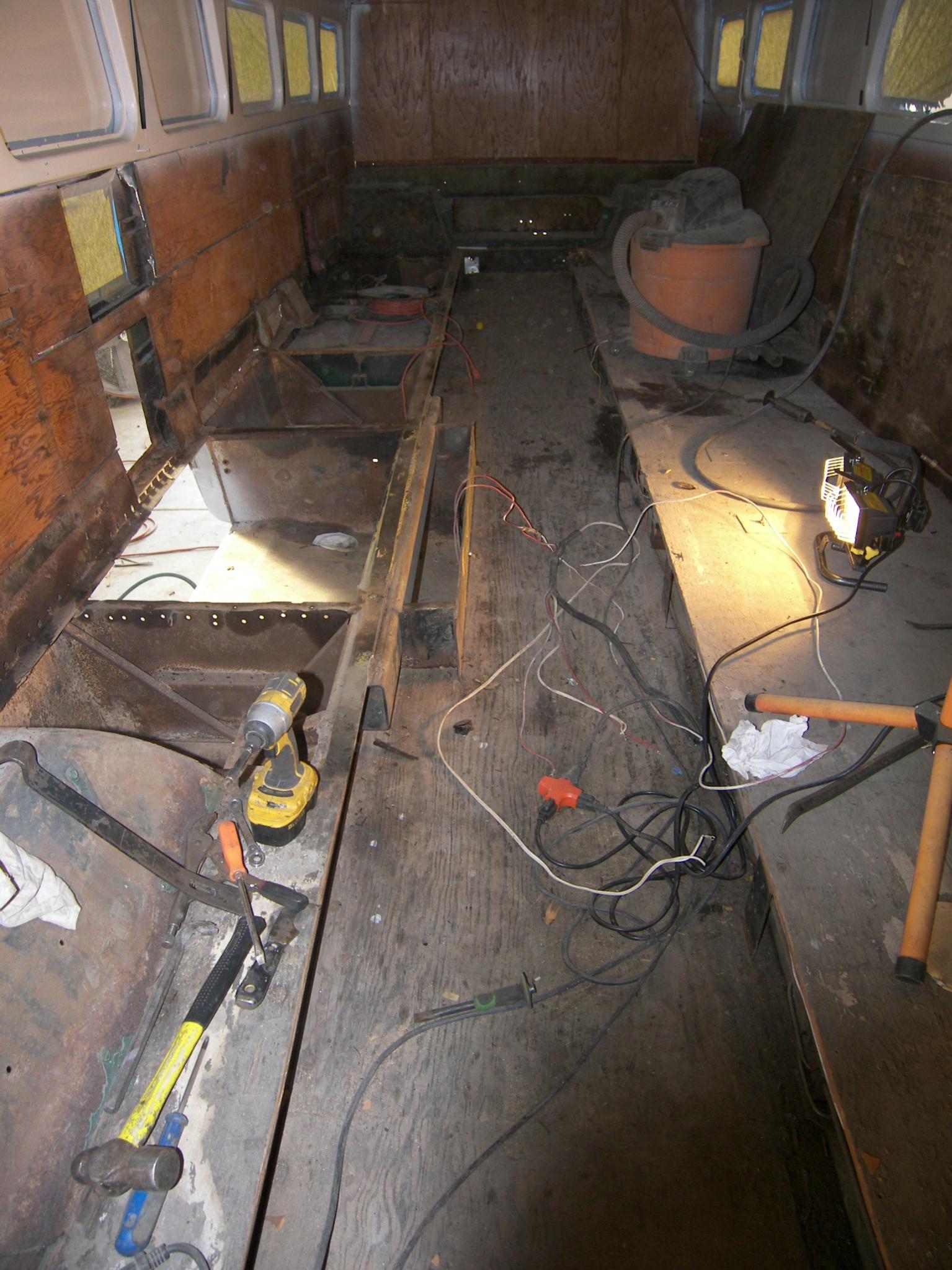

    Interior metal has been treated and primed. The walkway down the centre of the bus has been widened by removing a channel on one side of the raised floor that is no longer used.

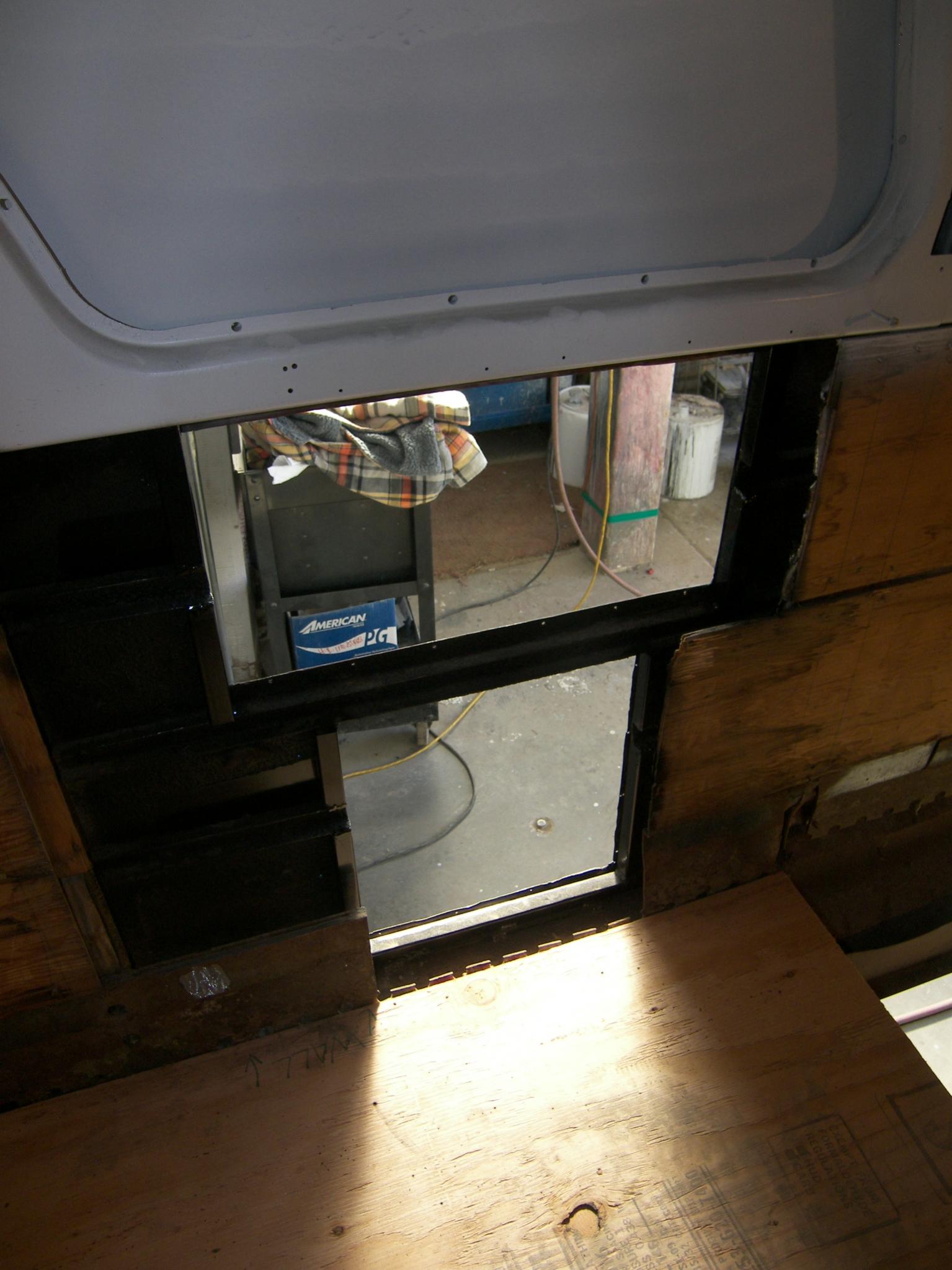

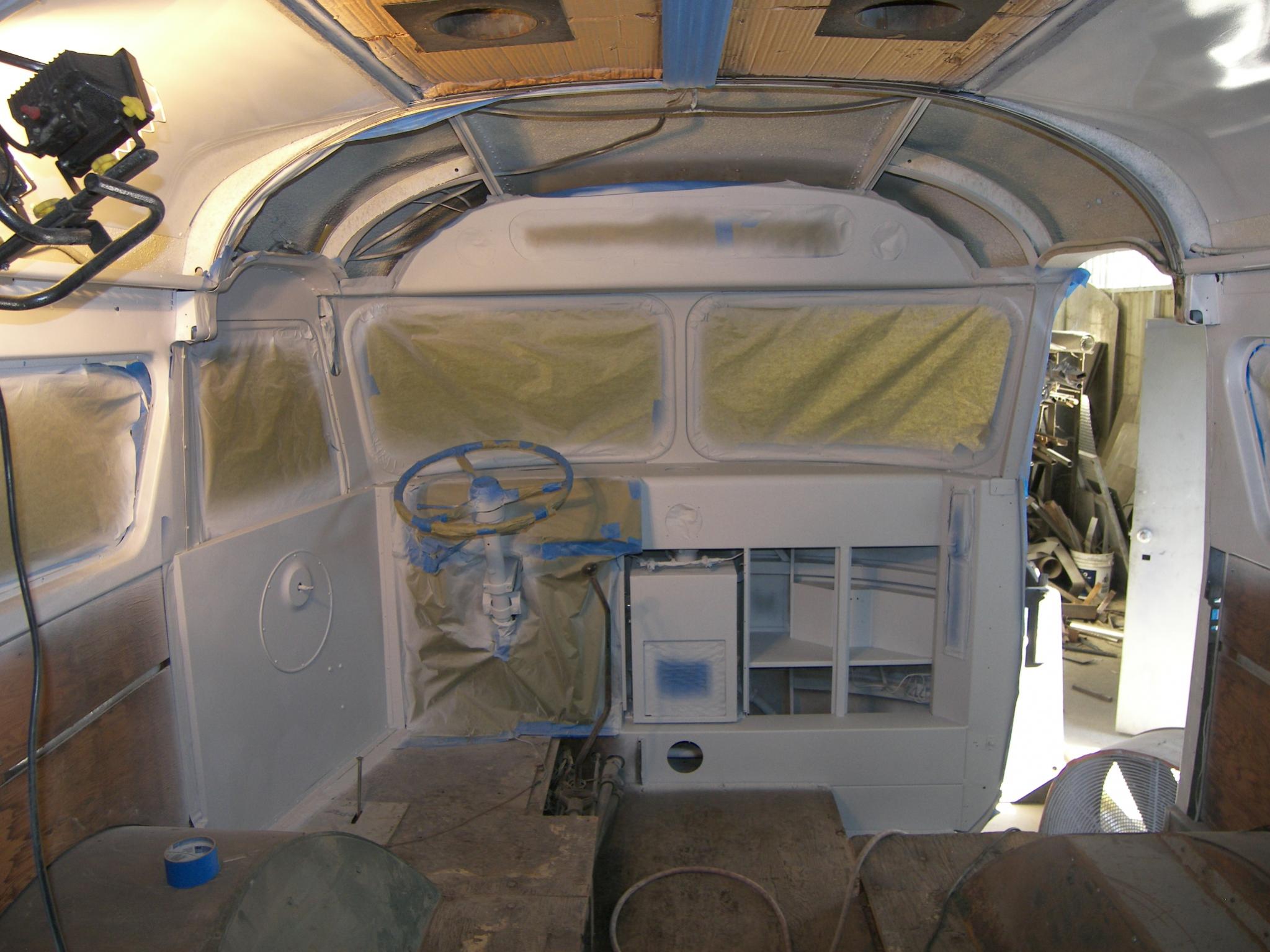

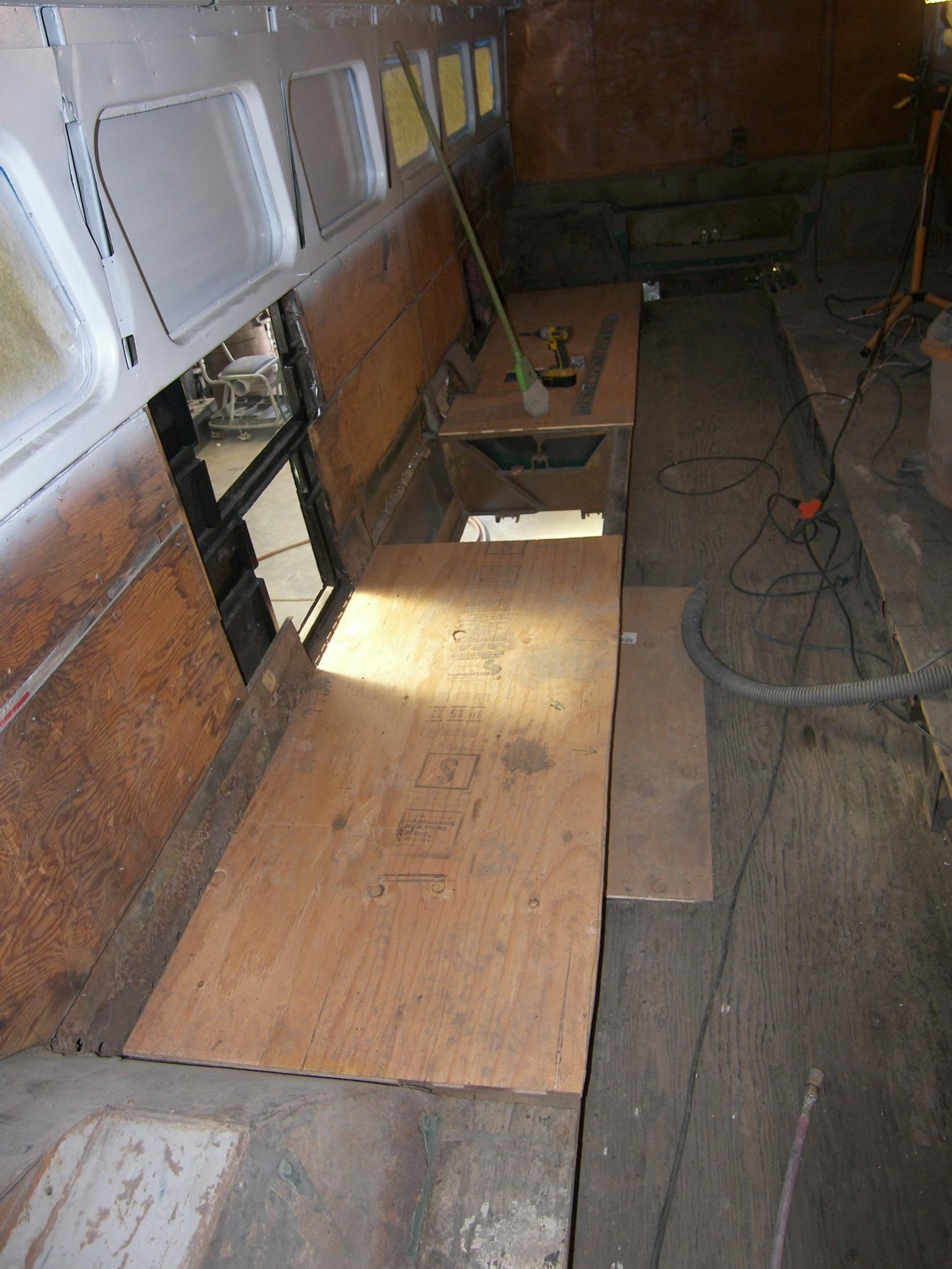

    Work continues on the Clipper this week. Widening the walkway has proved to be a very expensive alteration (and probably why previous RV conversions on Clippers have left the walkway as a narrow channel). The sub floor and structure of the ch***is have been altered to make a wide isle possible (image 1). This has loaded the bill quite considerably but makes our Clipper quite unique as it's probably the only one with this modification (I'm trying to see the positive here but I'm struggling!!)

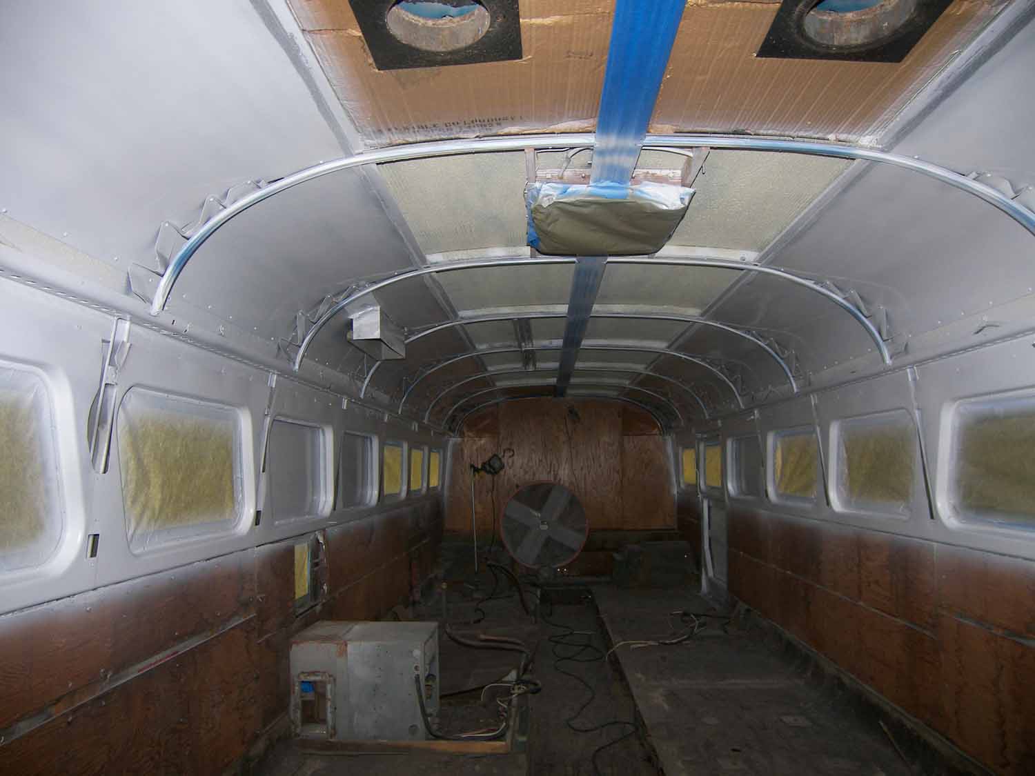

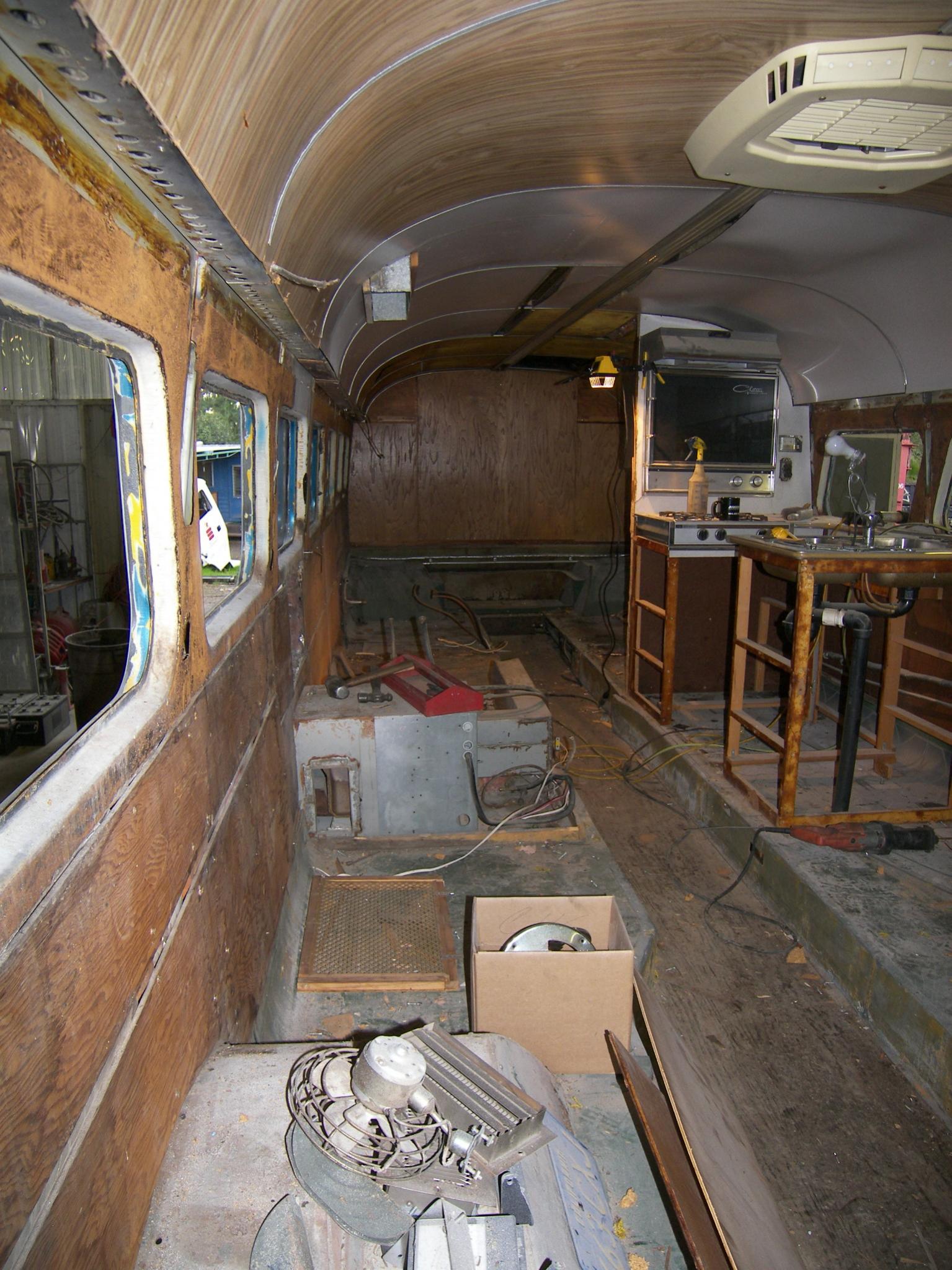

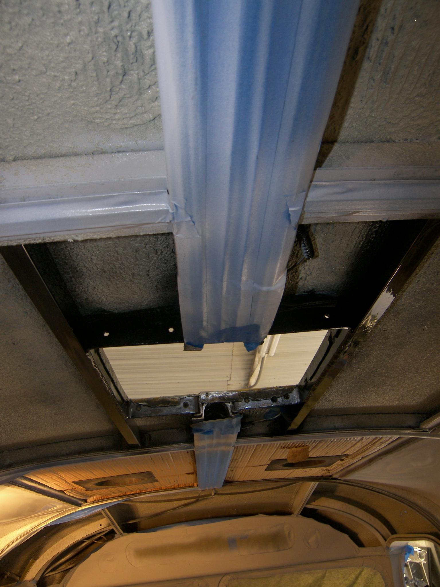

    The next problem has been the way the heater and A/C were fitted when the Flxible was first converted to an RV. The only thing that was holding the units in place was the outside and inside skin of the vehicle. The restoration shop has fabricated and welded in place supporting structures that tie everything to the actual structure of the vehicle (image 2,3. Not very clear in the images but it's everything in black).
    Finally, the dashboard has been stripped and primed ready for final paint (last image)

  29. In the last picture, (of the dash) what is the small lever sticking up out of the floor in front of the left wheel tub? I don't recall seeing that on mine.
    Also IIRC, the sidewalls of the center walkway are the tops of the main frame rails, I worry about modifying them, I certainly hope your builder knows what he is doing.
