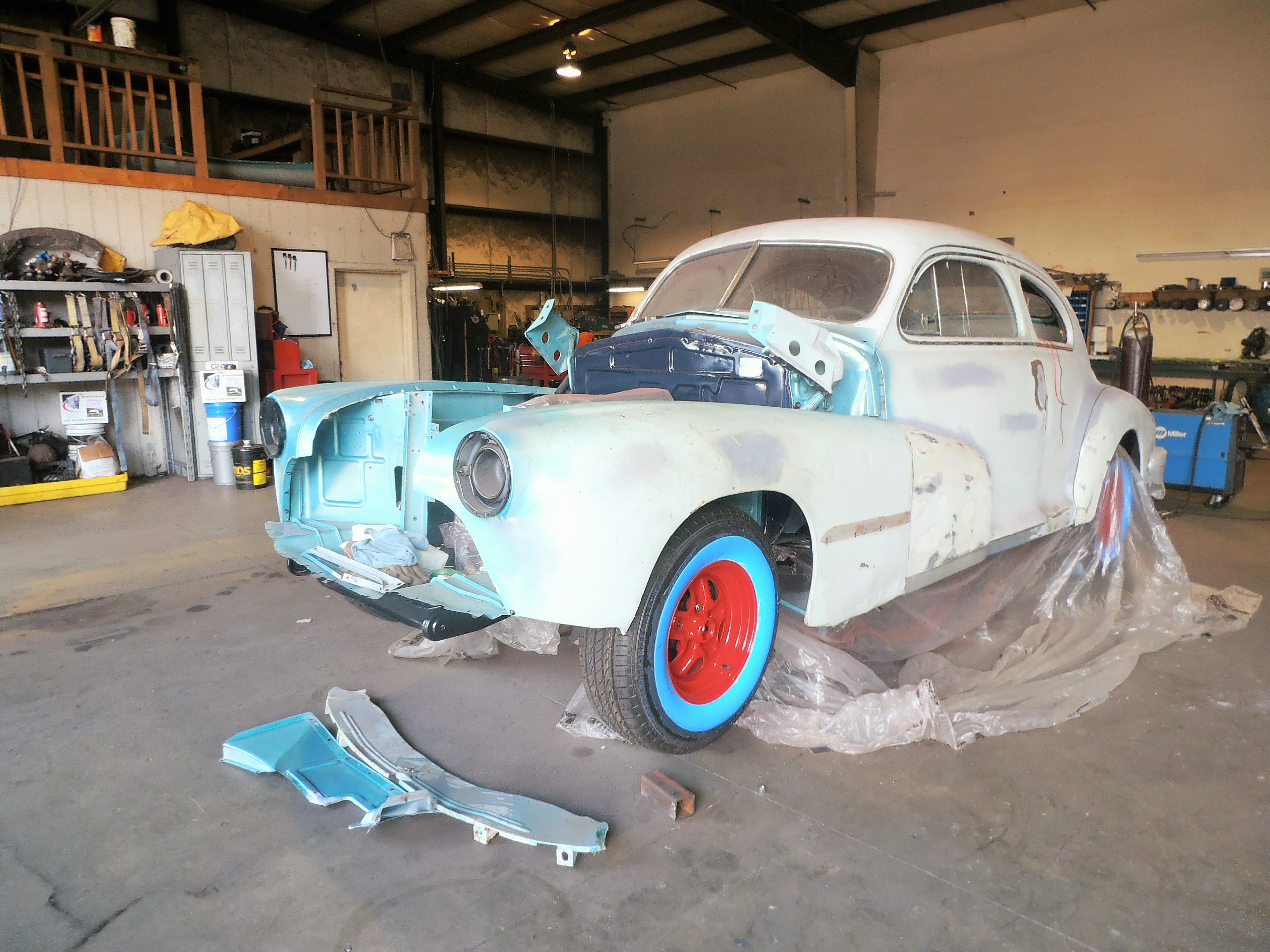

    Yesterday I had a few hours to work on the Olds and managed to finish making the special fasteners that hold the extension panels onto the doors. I don't know what the proper name for them is so I just call them "pontoons". The lower rocker extensions that fit under the pontoons were located and installed then adjusted so the door could open without s****ing them. Next the pontoons themself were bolted in place. The doors need to be finished before the front fenders are installed so you can reach the bolts from the front.
    Special Fasteners
    Lower Rocker Extension
    "Pontoons" & Trunk Lid Installed
    mgtstumpy likes this.

    Great progress so far, have you photos of the inner fender mods to suit your IFS, just curious as to what needs to be done to mine when the time comes after I recovery from shoulder surgery? Wish my progress was as fast as yours! Those extensions you refer to are simply front fender 'Door caps'. The tapered piece underneath that bolts to the sill is a sill (door cap) extension. As no ribbed rubbers for sills and extensions are reproduced, I bought generic lengths from the local auto restoration shop Also being so far away I bought an OEM Master parts catalog to ***ist with sourcing parts as Ozzie (Holden) bodies are different to US (Fisher) bodies.
    Those clamps that secure the caps to the door have anti-squeek (rubber) pads underneath them that compress when tightened. The bolts should be self tapping..
    Is that gravel shield on the floor off the car as it differs from those on mine? 2 on front under grill and single on rear

    I put the fenders in place and just used my cut-off wheel to provide the needed clearance for the upper a arm on the left side. I will clean it up and form a flange around the portion I cut so it looks better. The fender will need to be removed again to do that. The other side unbolted so it will be easy to cut and form the opening on it.
    I wasn't sure what to do about the sill rubber but that sounds like it should work so I will look for some of that rubber.
    The gravel shield that is in front is one I brought down thinking it was for the rear but it didn't fit so I thought it might be for the front but it don't fit that either. I do have a couple other pieces that might be the correct ones for the front and I am starting to think that other one is not for this car.
    Door Caps is much better than Pontoons as a description. Thanks!
