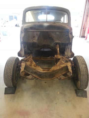

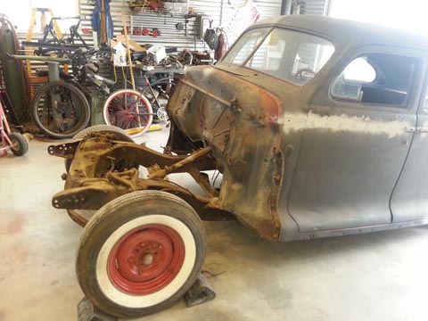

    Looking to figure out the best method for upgrading my front end?
    I want the drive train to be new, disc brakes, air ride suspension.
    Seems expensive to put in the IFS, 5 grand. looking for input on what has already been done.

    The OEM front end is IFS, needs discs & a shock relocation. Could put in a sub frame from a Camaro, Chevelle, Cutl***, ect.

    Rebuild the stock front suspension, add an Olddaddy disc brake kit, fab some very simple upper shock mounts to move the shock mount to the frame and you are good to go.
    I have owned both a subframed car which was my first 48 Plymouth and a stock rebuild which is my current 48 Plymouth. The stock modified as stated above will ride everybit as nice as the subframe and you can do it all in a godd solid day's work. No worries with building bumper mounts, sheet metal mounts, radiator mount etc as the stock frame already has it all there for you.
