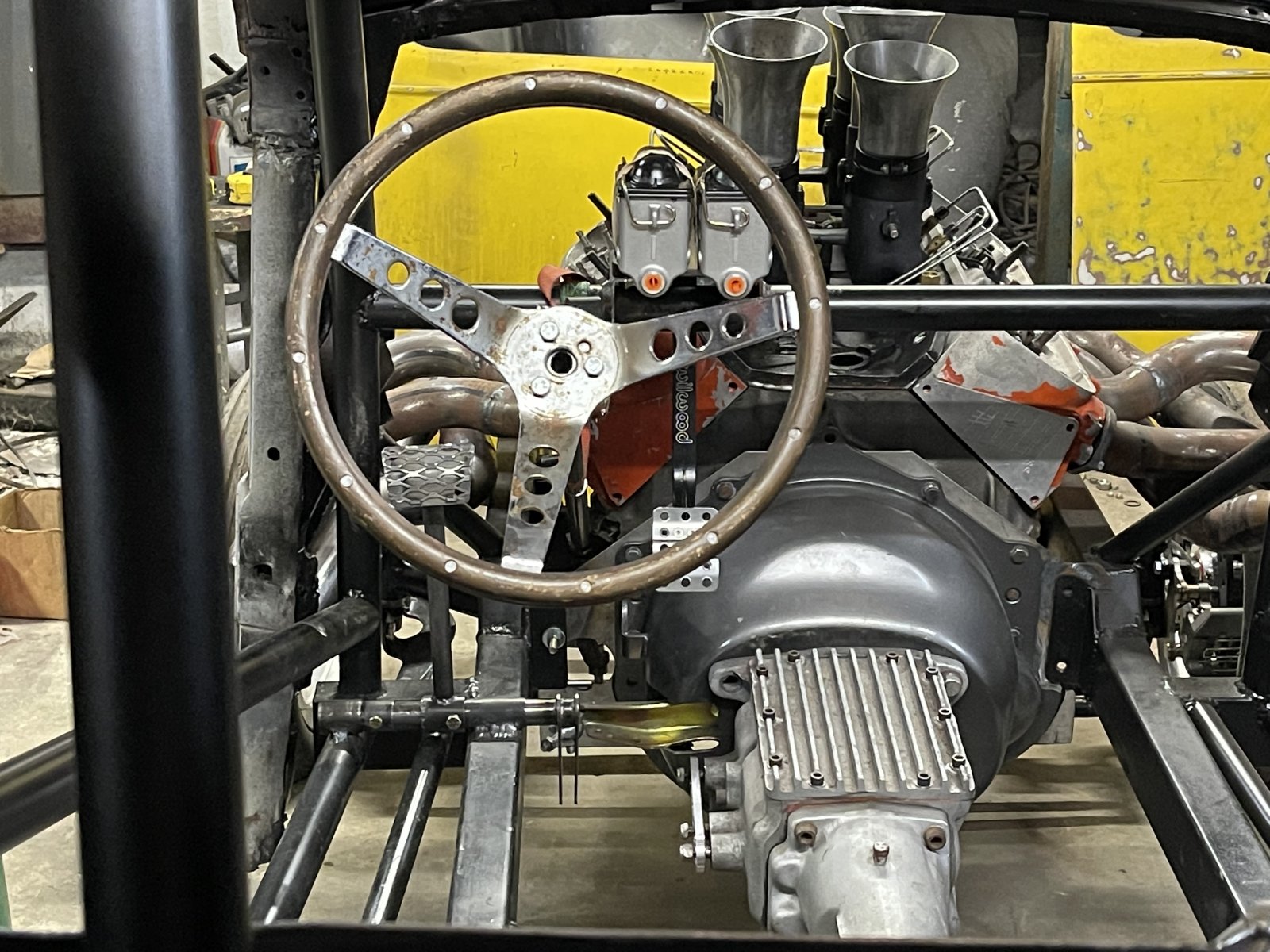

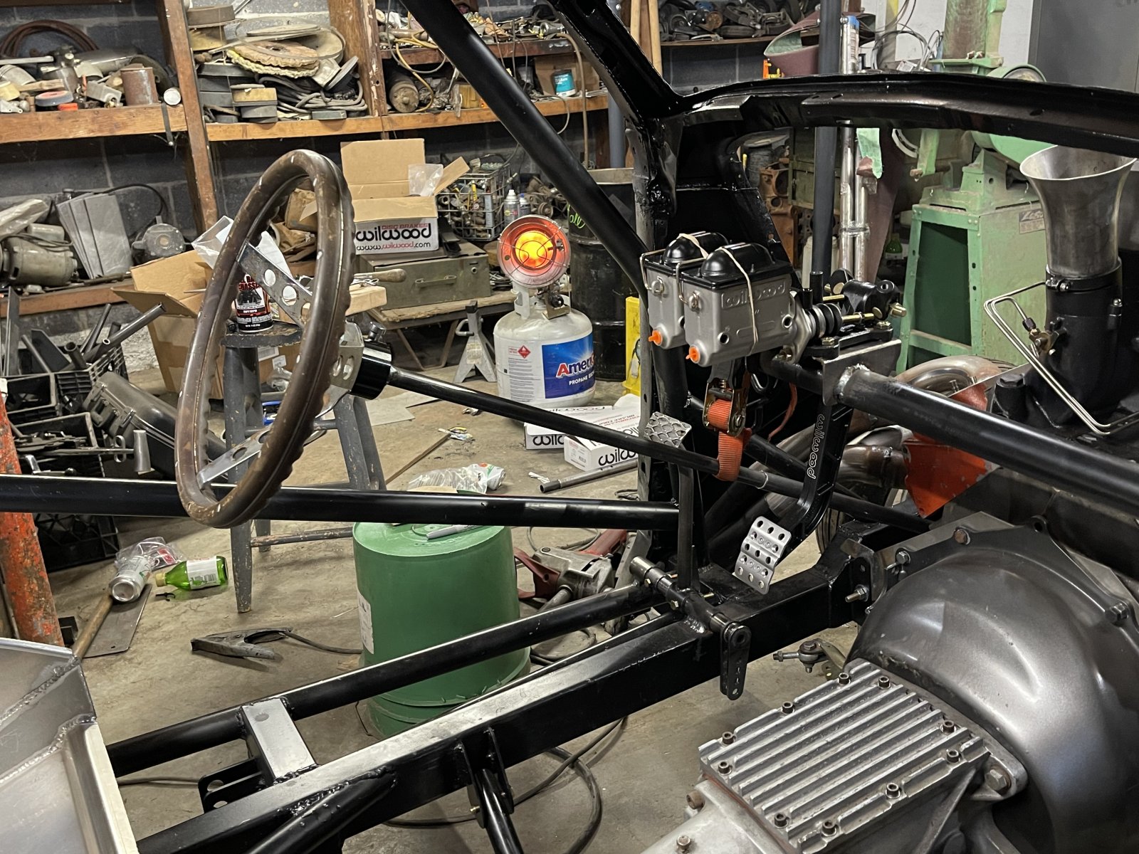

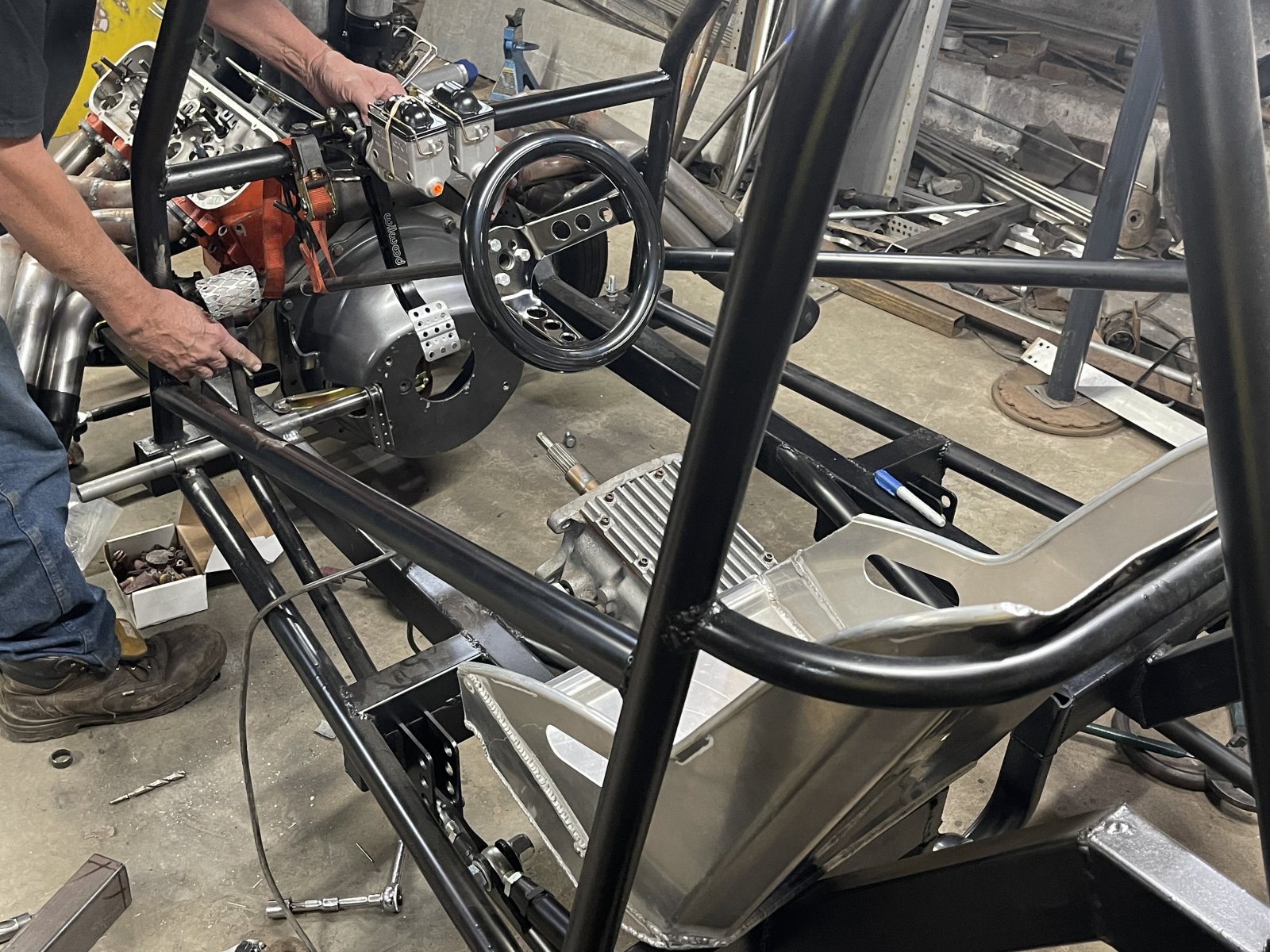

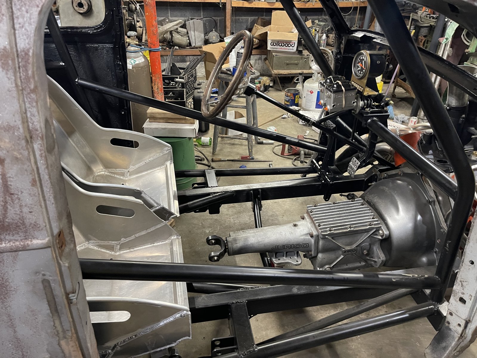

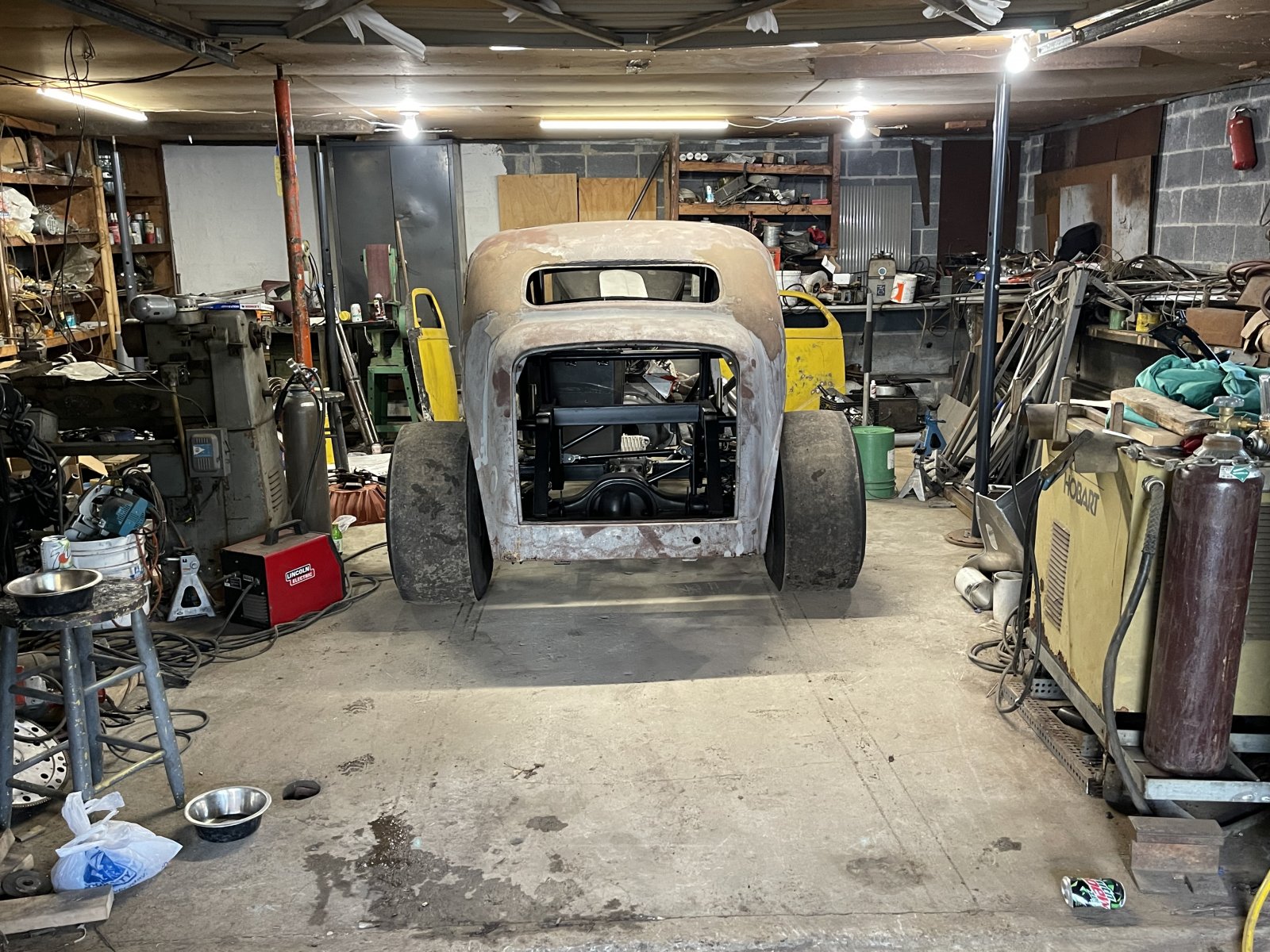

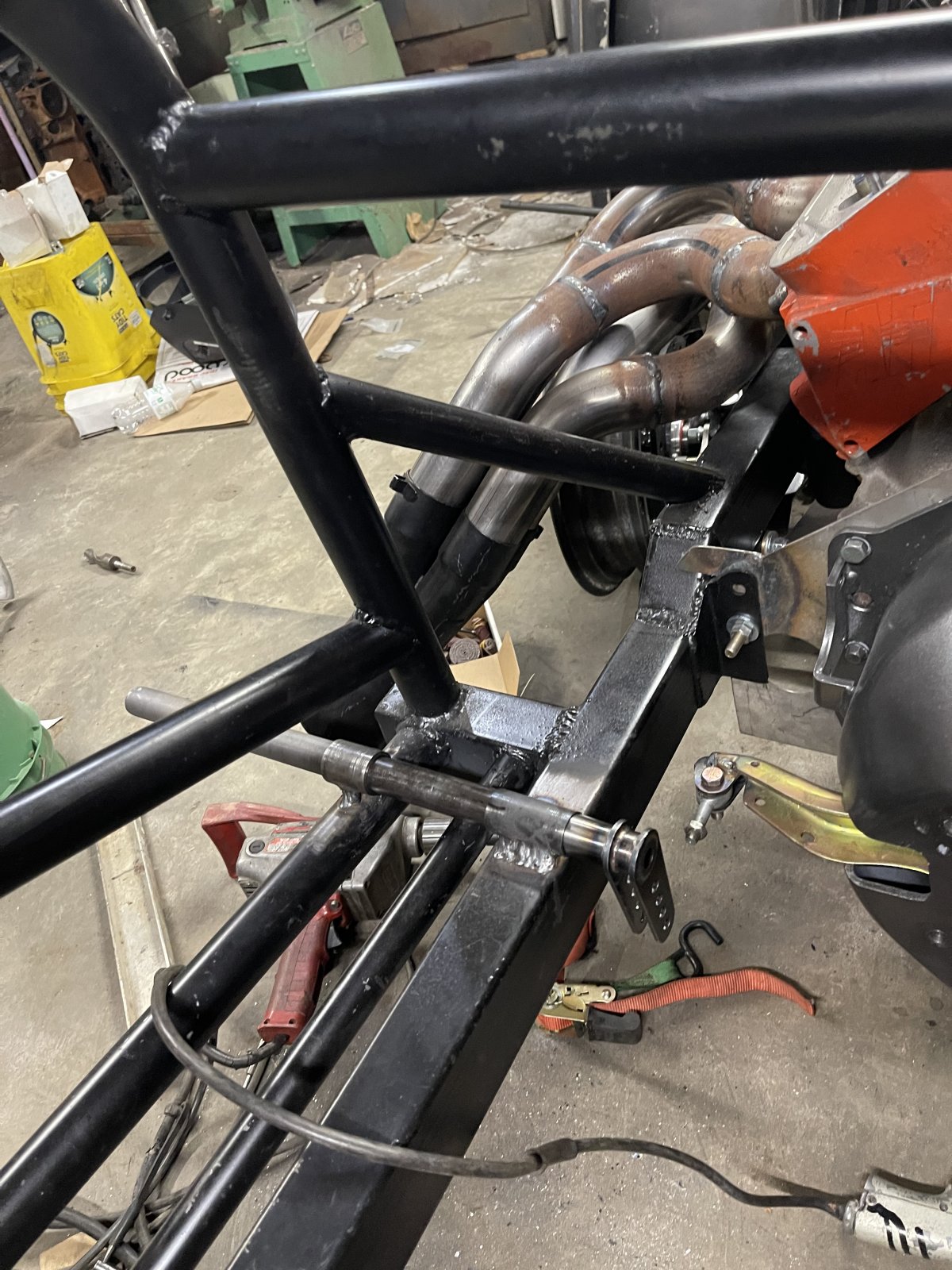

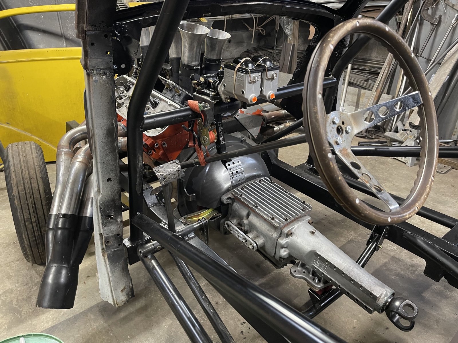

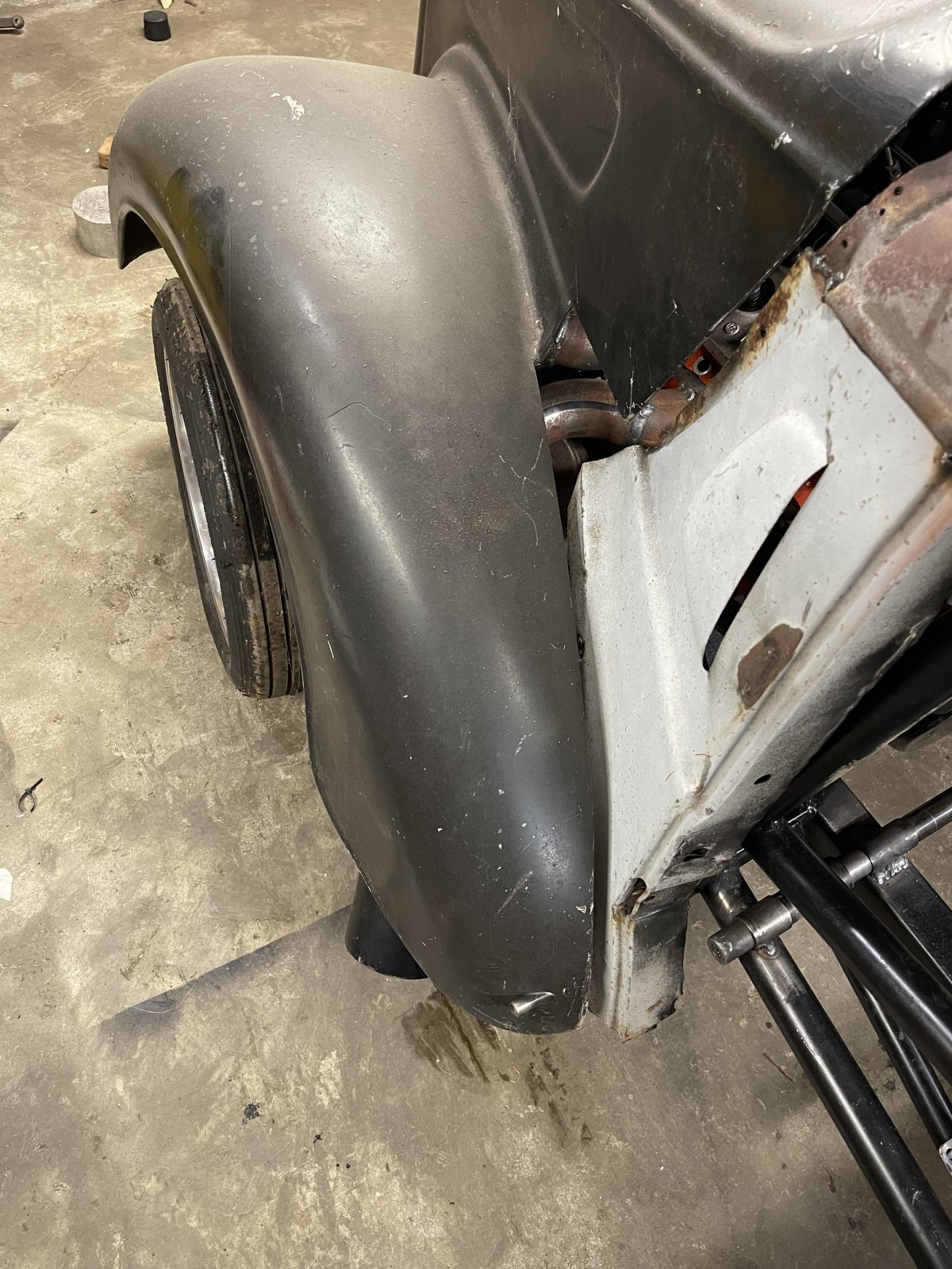

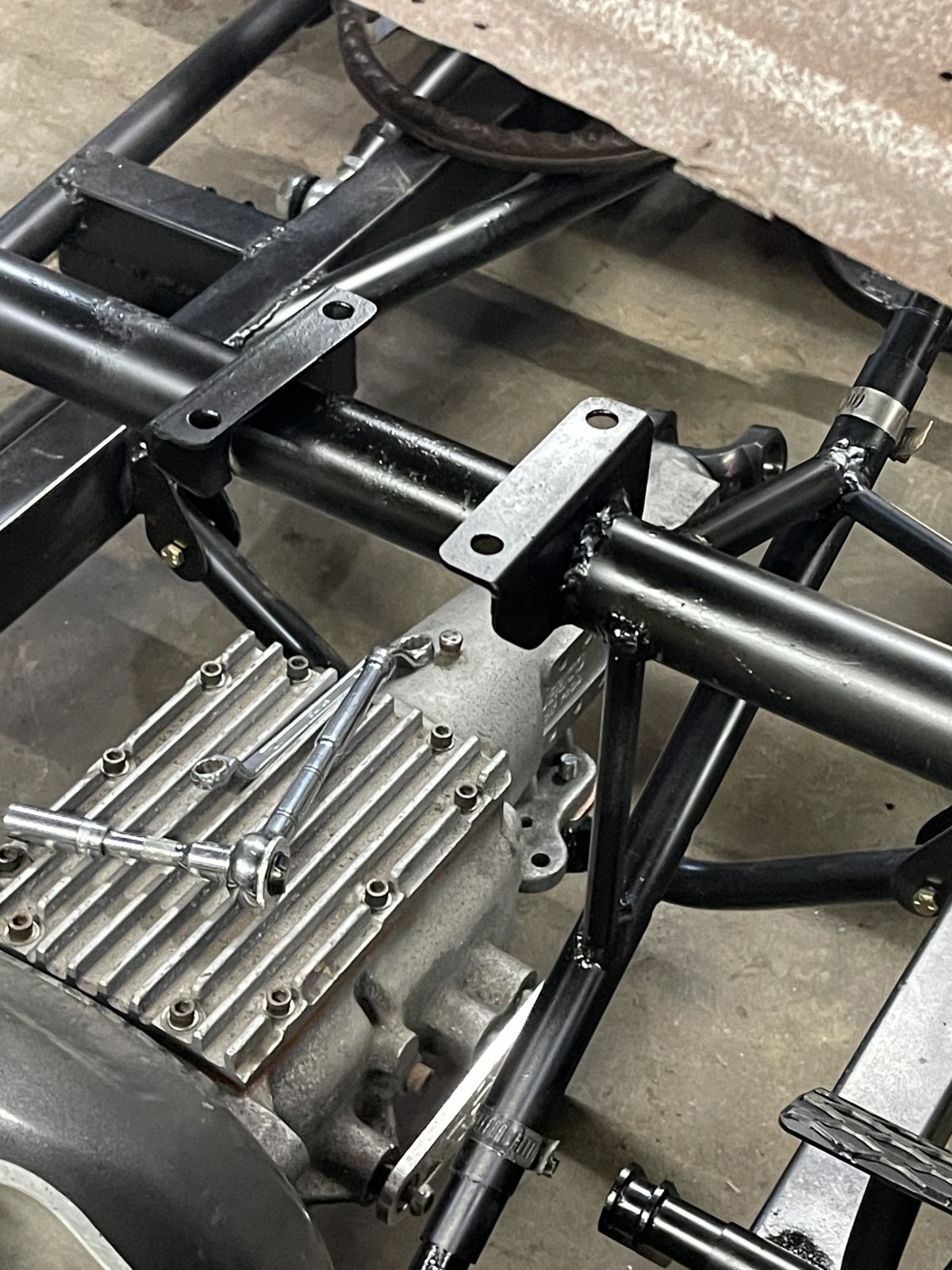

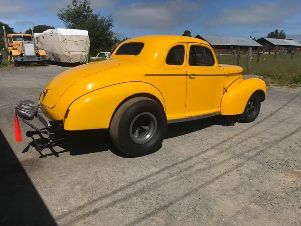

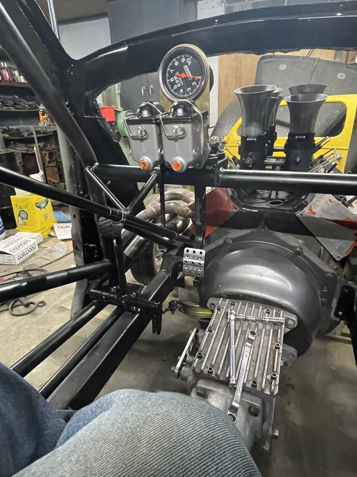

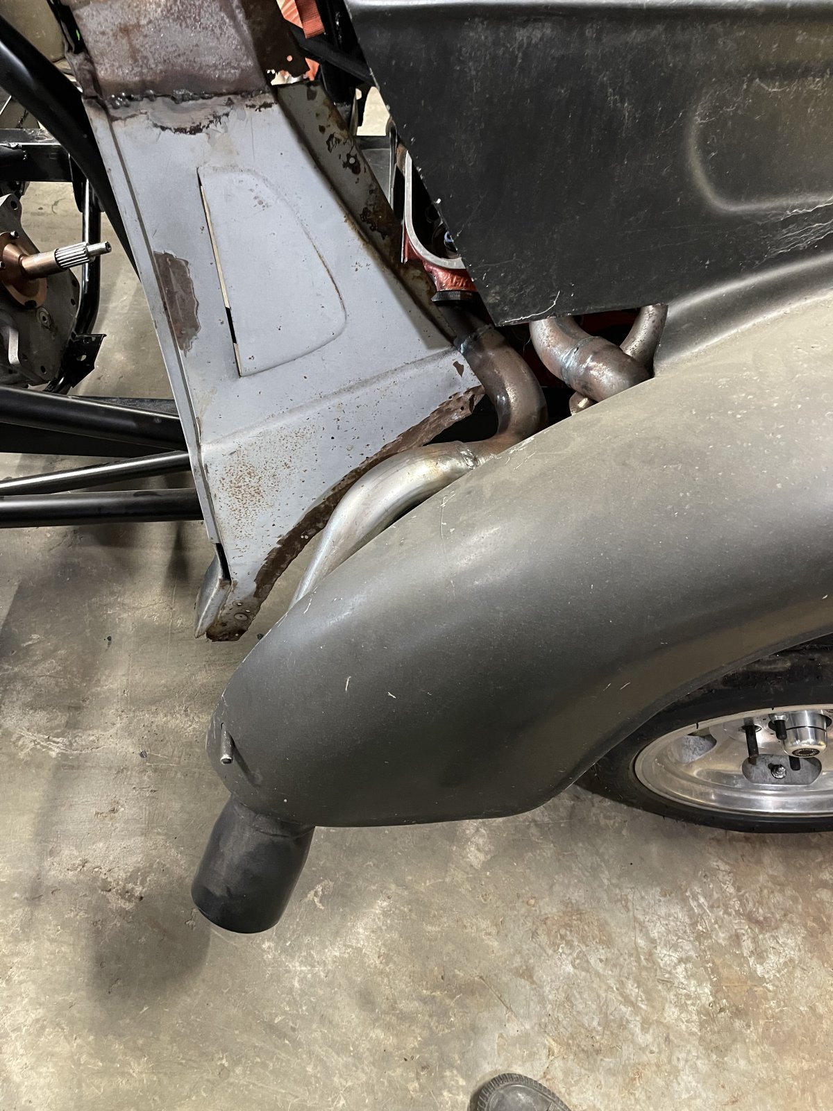

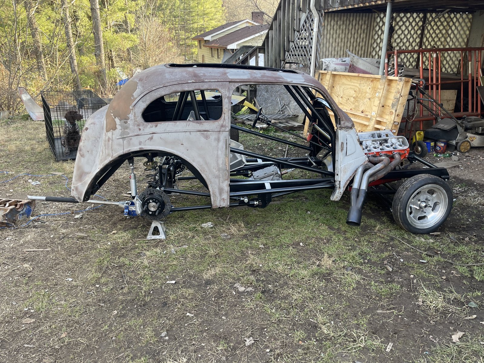

    We’ve got the pedals pretty well done, and got the steering pretty well done, just gotta mount the brake pedal/master cylinder assembly and put the steering shaft braces on. The weather was nice today though so we rolled the chassis out and placed the body back on. After we finish the pedals and steering well mount the body, tilt the nose, and start body work and paint. The body is going to get significantly notched for the headers, but it won’t be terrible. I also picked up the paint for the car today, it’s going to be bright boss ford orange. With the dark magnesium wheels it should look really similar to the studebaker coupe in this photo.

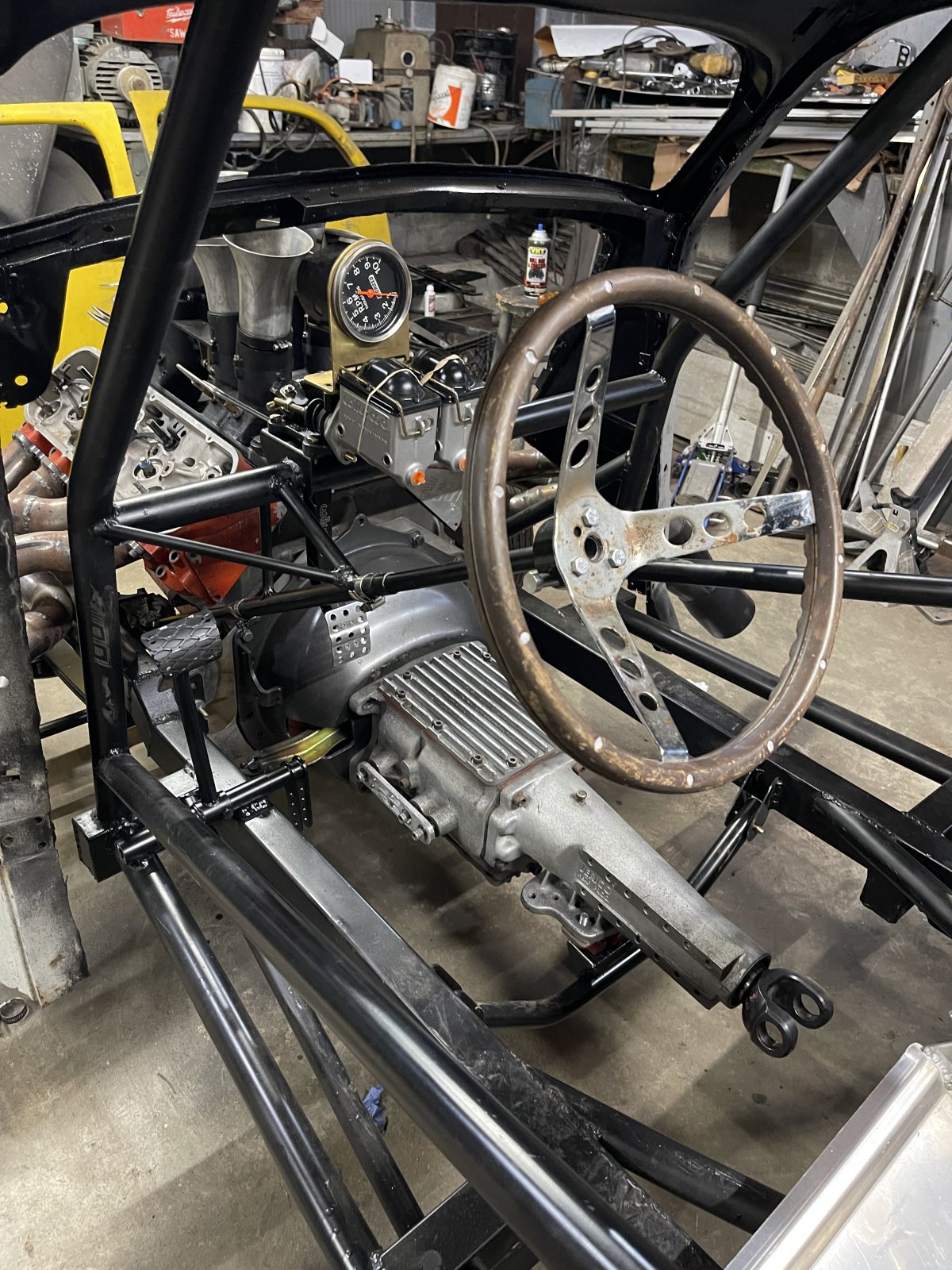

    E58205A5-AEB9-4884-B4D4-459A8E4675B9.jpeg B39583B3-0914-49F9-A929-E11757CD860E.jpeg BF804E2C-D369-4A25-8029-F9F0B943984C.jpeg 16AB223B-6A34-45DB-9D45-6FE1C901D9B7.jpeg Clutch and brake pedals are finished, going to mount the steering column tonight, the height and length is already set.
  6. Put a joint in that steering shaft and make it collapseable. (is that a word even). If you hit the wall you don't want it to spear your nice suite and seat, you in between.
    mad mikey, Stogy, Thor1 and 1 other person like this.
  7. Zak Hall
    Joined: May 11, 2015
    Posts: 702
    Zak Hall
    It’ll be mounted with hose clamps, and it is thin wall chromoly. in case of crash it will push/bend out of the way. This is a very conventional steering setup, nhra legal and used by thousands of drag cars for years. I also have the steering column as far away from me as possible. For it to hit me it would have to move roughly 20” or my harnesses would have to fail, either way it would be a crash that would significantly injure me regardless.
    mad mikey, Stogy, Thor1 and 4 others like this.
  8. Good to hear its sorted out, hard to tell from the pics. Dont crash it anyway:D
