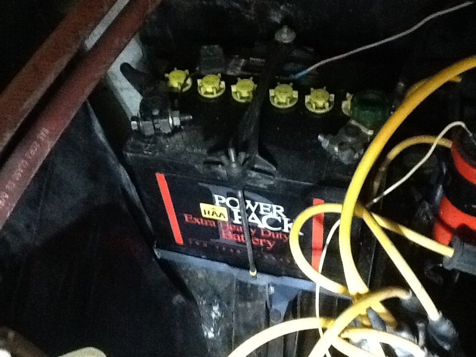

    anyone know how the battery tray goes in? I took it out but don't remember how it went in. I know theres a braket broken off but I plan to weld a new one on. but just don't see how it mounts inside the engine bay

  18. Here's my battery , the vertical bracket mounts on the ch***is rail bracket.
  19. another photo, I couldn't work out how to put more than one on at a time!

    cool, hell yea thanks roadster I see it now! =D I thought that rail was for some panel I lost along the way, was confused because I thought the battery tray rode higher than that and didn't know if it was long ways or across. thanks guys =)
