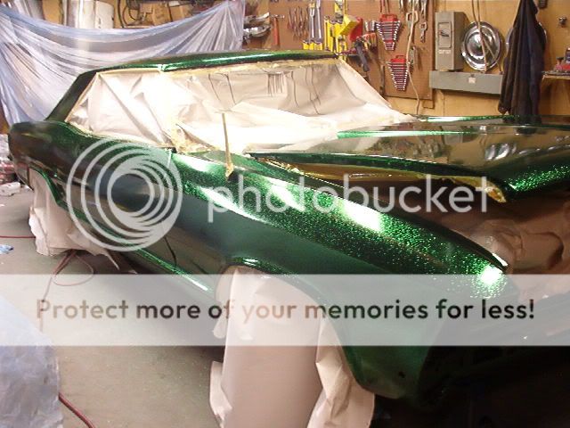

    well, turns out I got more than I need. I was TOLD I need 4-5 pounds to get the look I want, which is something like this
    but turns out I just found out I wont even use half of that. im going to spray a matching blue base coat and then intercoat clear, which with a psi regulator hooked to an undercoating gun im going to shoot the flake onto the wet intercoat clear. I want to go two tone, the flakes are two different shades from the ones in the bag and the ones in the jars. so some parts darker blue, some lighter blue and some parts unflaked blue color. everybody was like whoa, are you flaking an rv? well no I just was misinformed and got too much. but its not that bad, look at what I got it for shipped
    so I will be taking a new leap of faith, never sprayed metal flake but I have standard 2 stage paint down good, this shouldn't be hard its just an extra layer between the base coat and clear coat. but if I get it down, I will attempt this on the roof of my 59 with white and light blue flakes and lace

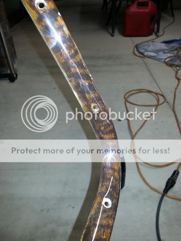

    pics of the windshield moldings during the day. finally put in got tired of seeing them laying on the floor. put in the s-16 spot light while I was at it

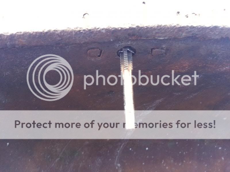

    got around to doing a job I been avoiding. when I put the rear fenders on I mocked them up only, the driver side rear fender I only hand tightened, the p***enger side rear fender was only being held on by two bolts because when I took them off all the other 8 bolts broke off on me. so since I plan to have the car driving by sunday I knew I couldn't drive it like that it would fall off so I got to work on it.
    backed it up and put it up in the air
    drill out the old broken bolts that were seized in by the rust, drill right through the middle and then tap the whole
    threads came out so good when I put the new bolts in it went on so tight it bent the washers
    then put back down, fenders are on for good nice and snug

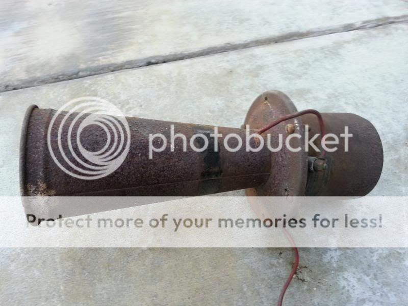

    had some time today, cleaned the horn up its a north east electric horn, original ahooga horn it has a distinct sound not like the repops
    was going to paint it but think it looks better cleaned up with patina look. tomorrow FINALLY will get to work on the timing

    Reyes- I was going to ask how those fender lips & bolt areas were on your ride. I know most of these cars they get 'crusty' real bad and I'm glad you were able to power through and get those drilled out. I snapped three off last year and gave up. I have to do some metalwork back there on mine, as well as replace the fender welting rubber. I may do that with confidence knowing you can do it with a little time, a drill and a tap. Not fun I'll bet, but you did it right. Nice job.
    Keep us posted on the timing. Hope you can get it, and start rowing through the gears.
  28. gallogiro
    Joined: Aug 10, 2008
    Posts: 911
    gallogiro

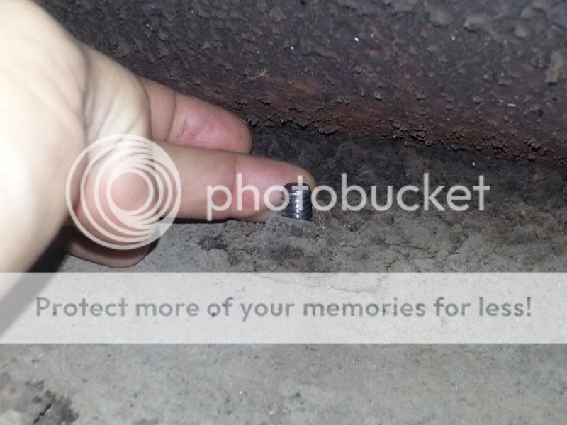

    odds are you are going to break more of them, they are notorious for rusting and seizing causing the nut to break. you broke 3, odds are there are more to break. ok heres whats good news about that area of the car. the fender is not heavy at all, so the bolts holding it down aren't load bearing bolts. if you drill and tap, start with a smaller drill bit and drill right in the middle of the bolt and use that hole as a guide then drill with the right size bit that's right for the tap. even if youre not exacly centered you still will have some wiggle room because you will not just be drilling through the bolt but through the nut and Its a pretty wide nut. tapping it is easy, once it grips itll drive itself in and just keep tapping till theres no resistance.
    option two and whats good news. if you open your trunk, if you broke the bolts, you can see about half an inch of it rising above the nut from inside the trunk.
    you can get a monkey wrench or vice grips and once you get a lock on it turn it so itll screw all the way up into the trunk and come right out. same for the ones towards the front you can see them if you pull your bottom back seat out and rear armrest out. same process. the seat will lift right out and arm rest slide right out theyre not bolted or screwed down.
    the last two on the lower front you cant reach theyre in the door jamb. except for the last bottom one. it is held on very weak and if you start drilling it the nut will break off and leave a nice 3/8 hole. the back of it I accessible from the bottom theres a drain hole. put a nut on the inside through the hole and with one finger line it up to the new hole and screw in a new bolt. once it grips just hold the nut with your finger so it doesn't spin and once it starts to tighten up the nut will grip on the rough metal on the inside and you can screw down tight.
    option 3, and the easiest and quickest. mock up the fender with whatever bolts are left unbroken exactly how its going to go, even just 2 bolts will do the job. now once its set exactly, get a 3/8 drill bit or a bit smaller and drill a hole right through the fender and the body an inch to the right or left of each broken bolt and fender bolt hole. then take a 3/8 bolt and nut and screw it down. the whole inside is accessible from the trunk and inside of the car so you can have someone hold the nut with a crescent wrench while you tighten the bolt. will work with all the bolts except the 2nd and 3rd from the lower front that are in the door jamb but the first one will hold it down just right.
    its a simple fix, trust me nobodys going to look to see if the bolts are correct or in the right place, with the interior in and the panels in the trunk youll never see them. I freaked out when I started breaking the bolts I felt I might have to weld the fender now because there was no way to bolt them down the nuts were inside the body unaccessible. theyre not and its an easy fix. hope that helps.

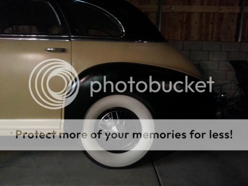

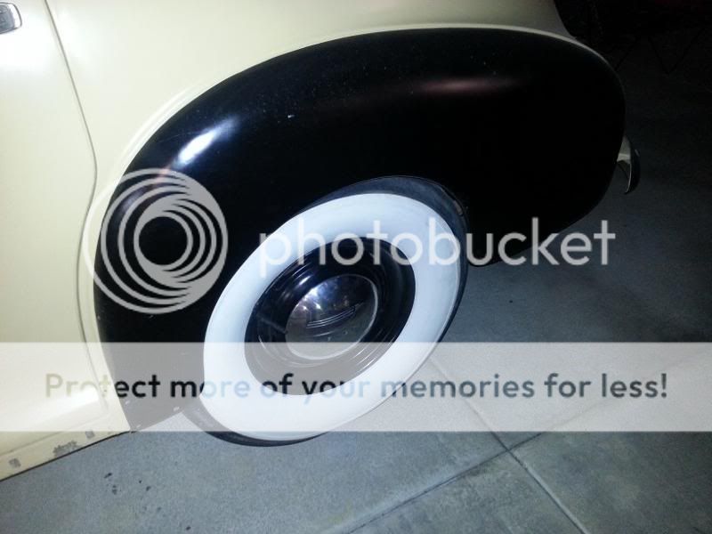

    picture it with beauty rings, will look better with them on. but what do you guys think? and whats better chrome caps or black caps
    with chrome caps
    again picture it with beauty rings. reason I might fly these is because theyre aftermarket but correct time period. and to be different nobody else has them
