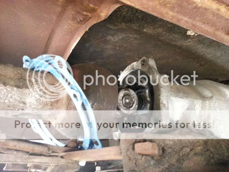

    finally got to gasket up the transmission ball
    doesn't show but I also put the cork gasket inside the ball housing that holds the ball to the transmission so its all set, im done witht this. quick question, done with the transmission but what kind of transmission fluid do I use?

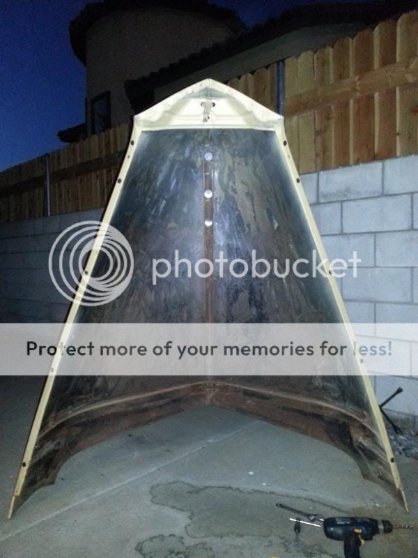

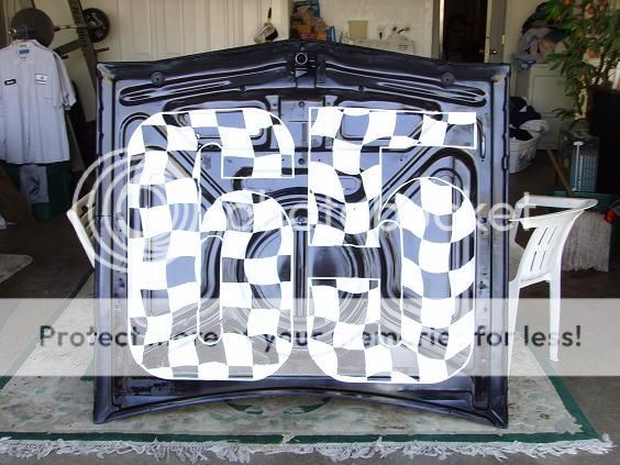

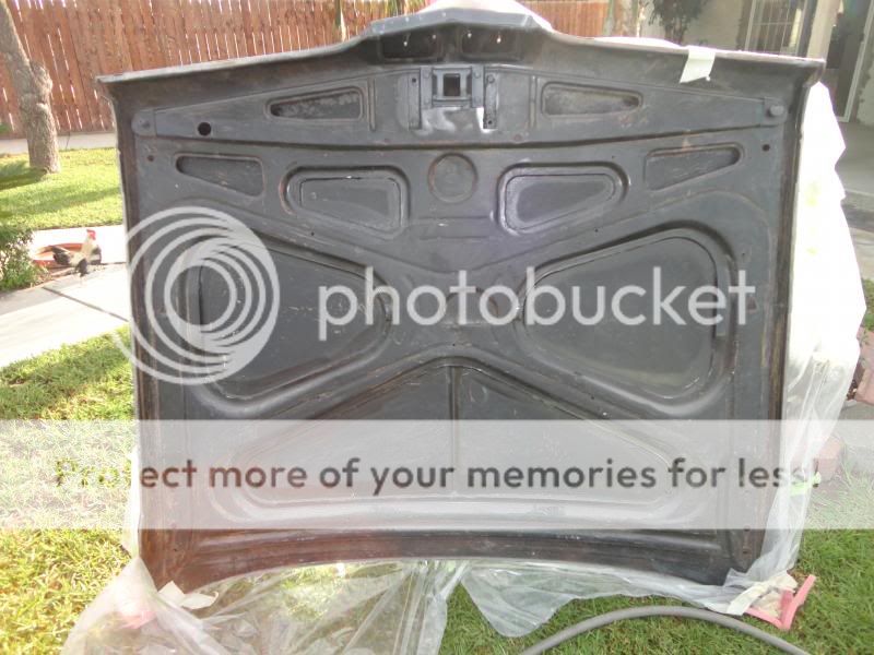

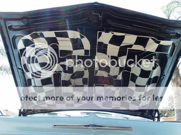

    took off my hood to the car. this is the hood to my 65
    and this is the hood on my 59
    so this is my canvas
    going through ideas in my mind what im going to put but its a pretty big size I can put something pretty big on it, something cooler than what I did on my 59. ill be working on that at night now that it gets darker early that we set the clocks back an hour but during the day work on getting it running. will take me a week to paint and airbrush the bottom of the hood

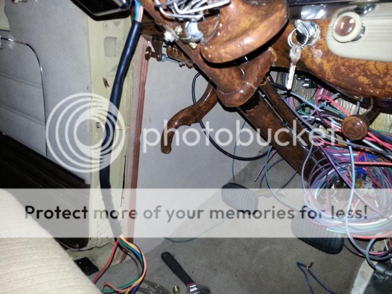

    looks simple but done right, waterproof board with upholstery adhesive and driftwood fabric I used for the door and side panels. tomorrow I will do the rewiring under the dash

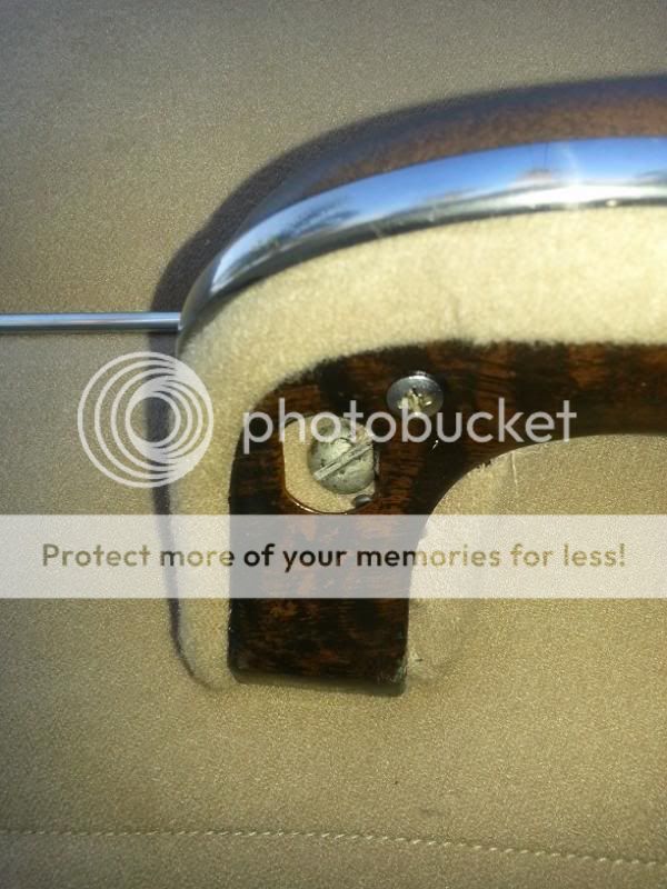

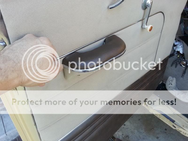

    worked on these today. all theyre missing is to mount on the door and bolt the little plate on the bottom of them but it has to wait till im done woodgraining them

    Really coming along, and the kick panels and armrests turned out just as great as the rest of the car did. I can't wait to see the hood treatment you give it. Your attention to detail is something for us all to shoot for.

    thanks monkey*****. kickpanels were super easy, no tools just scissors and glue required its just getting the right shape to cut is whats the hardest to do but is easy if you use cardboard first to get the right shape. the door handles were kind of a pain, vinyl with a heat gun will mold and shape, fabric doesn't and theyre an awkward shape so they weren't easy. as for the hood, im still brainstorming over what to put on there that everyone would like. like on my 59, im looking for another trunk lid so I can swap out at times from all white to an airbrushed one and what I want to airbrush whether I do it myself of pay someone to do it is an image of the kids from the movie "the sandlot"

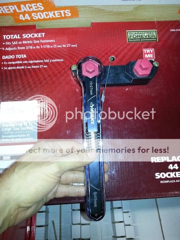

    I was at home depot and saw this. don't know how itll work or if it will work but its under 3 bucks a foot at 27 inches wide, youd use 3 feet and its wide enough to do all 4 doors and ud pay about 10 bucks for it all. but again its VINYL not rubber, mine is rubber. had a different feel and look, was more shiny and the ribs weren't that high, but its matting so it should work. I paid about 45 bucks for my rubber ones and personally like how they look better but this might work too
    it seems like a low price alternative to having fallen apart ones, but if you can spend the extra money get the rubber ones but these look like they'll do if yours are really bad and want a quick fix. saw this there too thought it was cool so I got it, 9 bucks

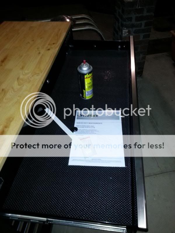

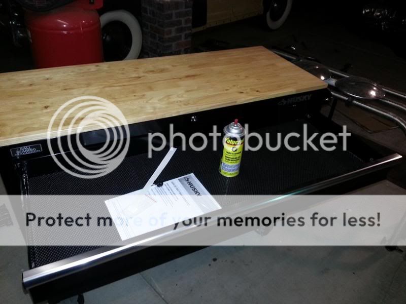

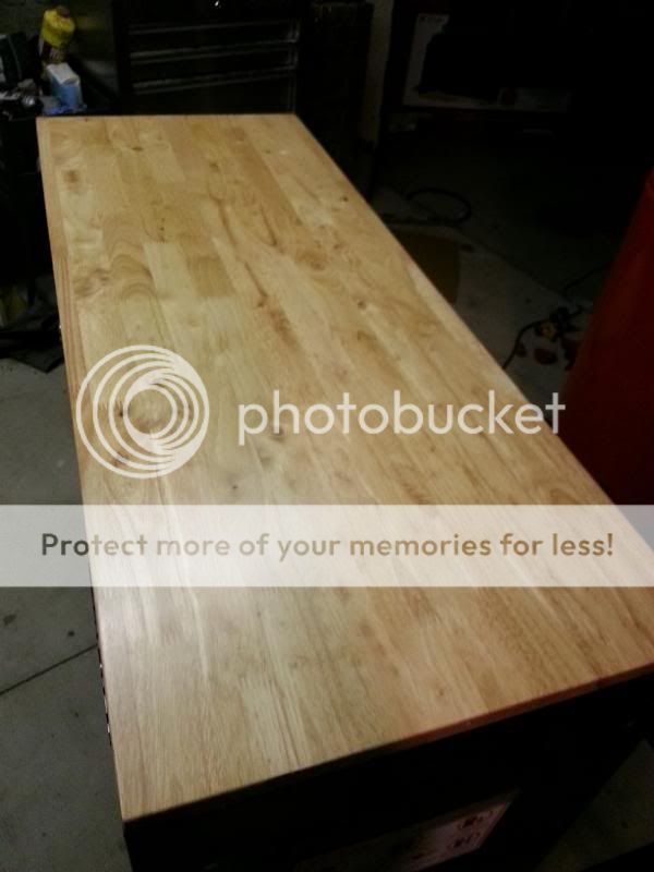

    used the box to line the bottom drawers cause im putting in heavy stuff
    check out how much they had this tool box, its the medium size one for $175 out the door. my small size one I paid more than $200 for but this one is huge

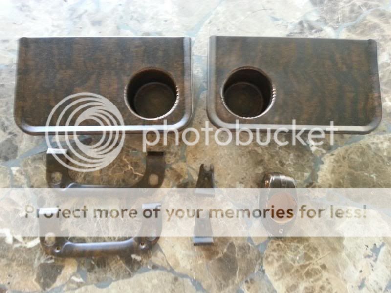

    well I got my polisher out, back on track here
    sand, buff and polish, got these out of the way now

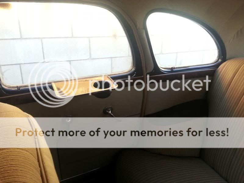

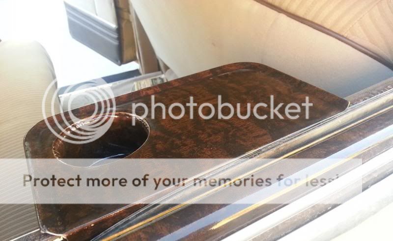

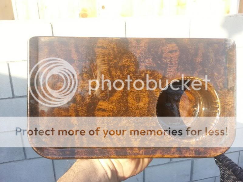

    check out how the snack trays, outside windows and inside windows match

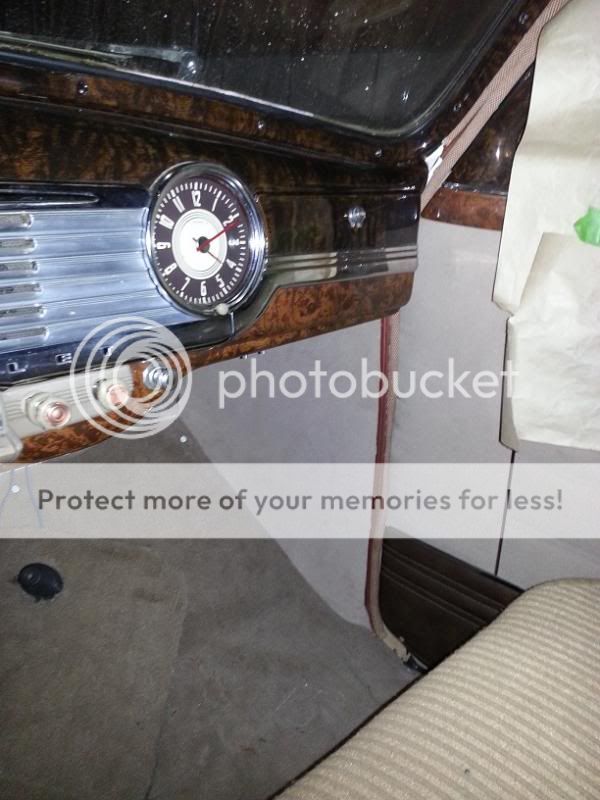

    as for the dash, im done the only thing im putting on is the column flashlight holder and maybe a steering wheel spinner if I find a nice wood or bakelite one. i was organizing the under dash wiring right now and when I sit in it now and is starting to feeling cluttered like a miami taxi cab. i got the oil meter, spotlight handle, comp***, trico fan, rear view mirror and traffic light viewer all in one close and tight area and feels more cramped now. reminds me of this girl i know with all kinds of **** on her face she has everything pierced and looks like a Christmas tree so im going to skip on the pres-a-lite even tho i like those a lot, any cigarette stuff and any dash saint. if I find the super deluxe heater im putting that in, or a record player but those go under the dash not on top so itll still stay clean and simple.
