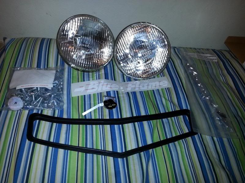

    got the headlights, brake switch, cowl vent gasket, complete bolt kit for front and back fenders, blue flame decal for my valve cover and the Chevrolet script for my 59s continental kit

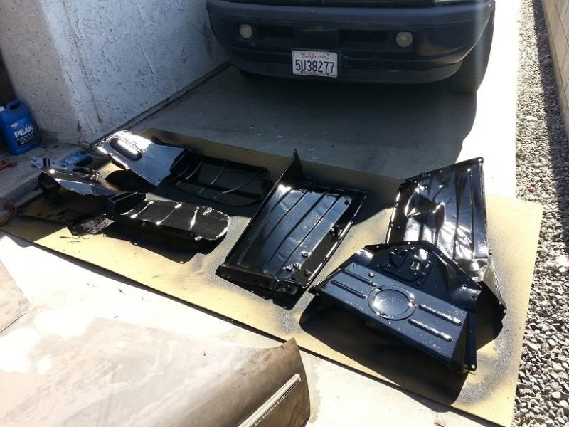

    cleaned up my frame, resprayed it since I sprayed it a year ago. getting it ready to drop motor in now all that's left is to paint the firewall on sunday and the motor drops in Monday
    and got the inside fender and panels sprayed. rust free and clean now

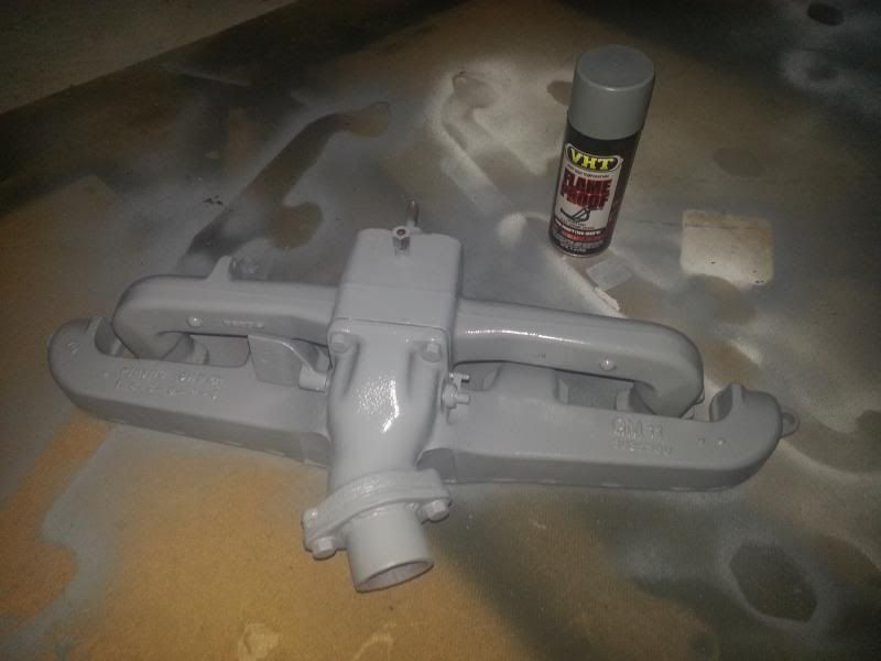

    im going to end up flying the Rochester b. you guys that have this one already, is there something missing here?
    and got the rebuild kit from autozone, that's the part #. took them a while to find it had to get the older guy to help me
    and new gaskets for my manifolds

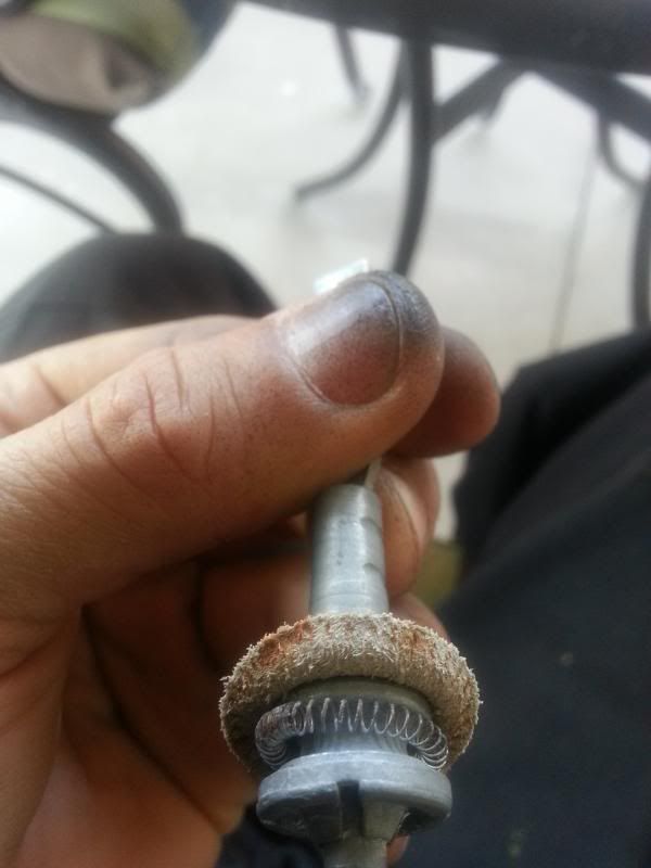

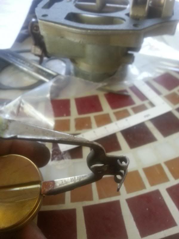

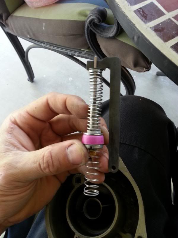

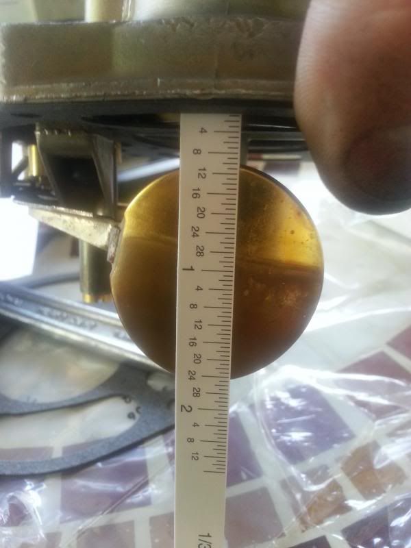

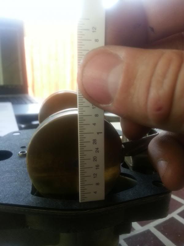

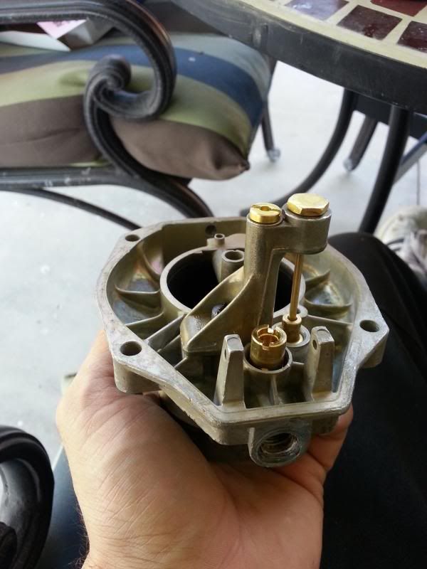

    rebuilt my carb today, it was crazy how easy that was and that's including the float drop and rise measurement. cleaning it out took longer than putting it together. but now I have a fresh rebuilt carburetor to run on my motor
    old plunger, was seized inside the cylinder I had to take It out with pliers it broke off the rod
    fresh new plunger
    old plunger was made out of leather, not sure if new one is too
    tabs you have to adjust
    to make sure the rise is 1 9/32
    and drop is 1 3/4

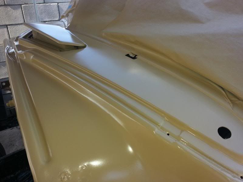

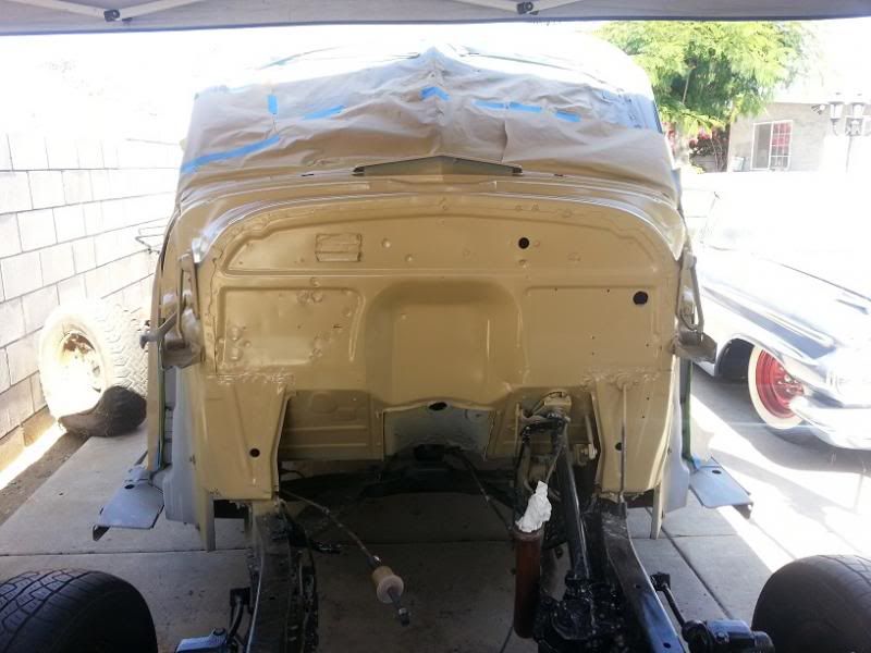

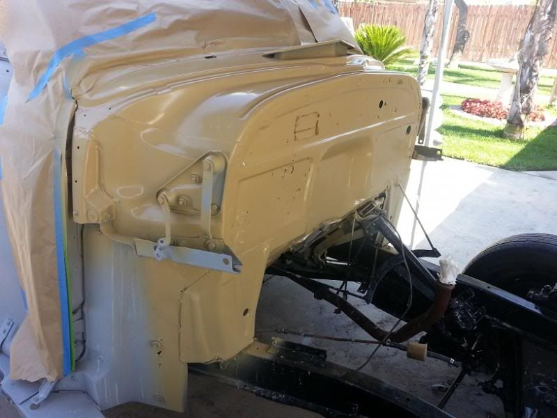

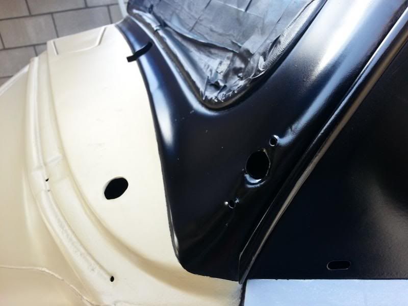

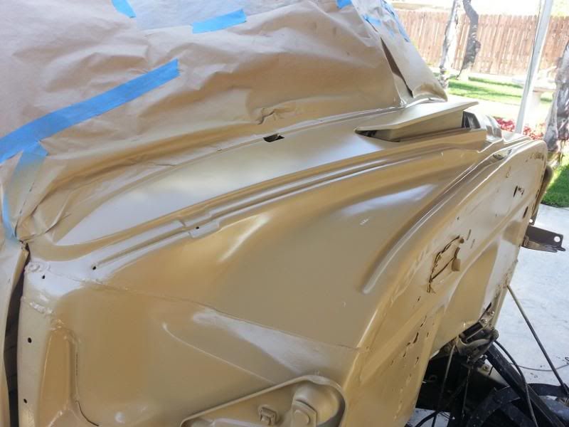

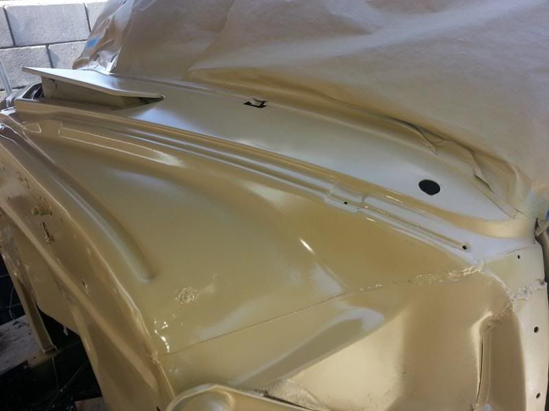

    prepped the body, masked and sanded the primer with 600 grit sand paper
    mixed the paint 4:1:1 mixture buckskin tan flat acrylic lacquer
    and now my firewall and cowl is sprayed. layed perfect, satin sheen look I was looking for. and will never flake or dull out its acrylic lacquer paint not primer. im very happy with how it came out and will look in the end

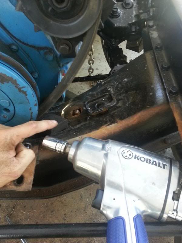

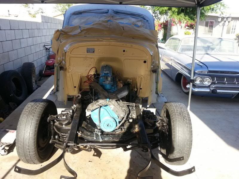

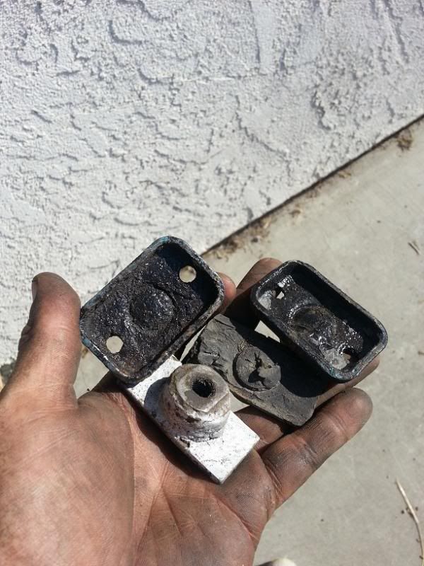

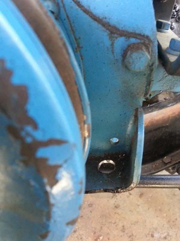

    took me hours trying to get the old motor mounts loose, no luck. hit it with impact gun for less than a min, came right off
    new motor mount holes
    and new motor mounts installed
    which means motor dropped and bolted down for good. hook up the radiator, hook up battery and connect gas line and motor will start right up
    old motor mounts no good
    second time this puts in work for me
    tomorrow hook up intake and exhaust, and paint the roof or the fenders and hood. its all going to be done faster from here now that I got all the mechanical taken care of so its on now =)

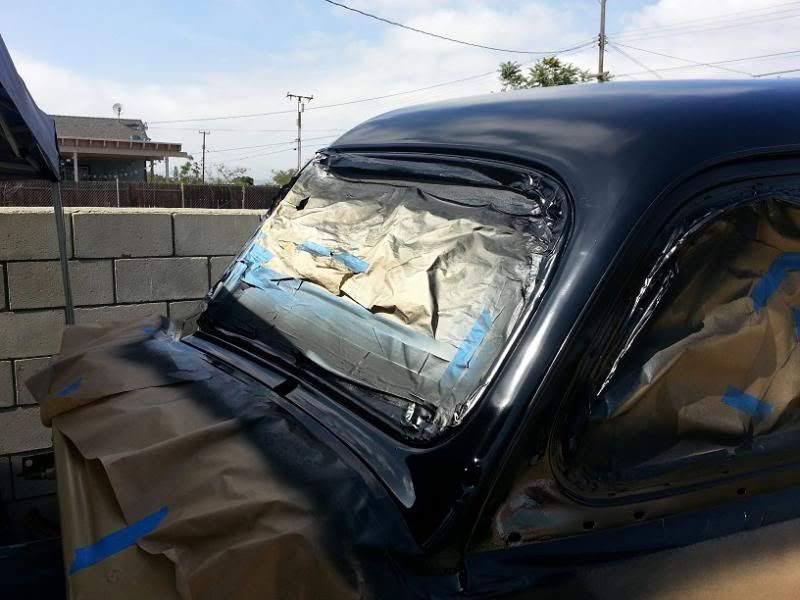

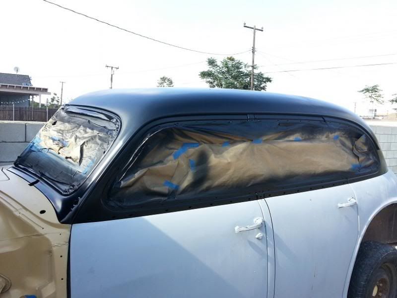

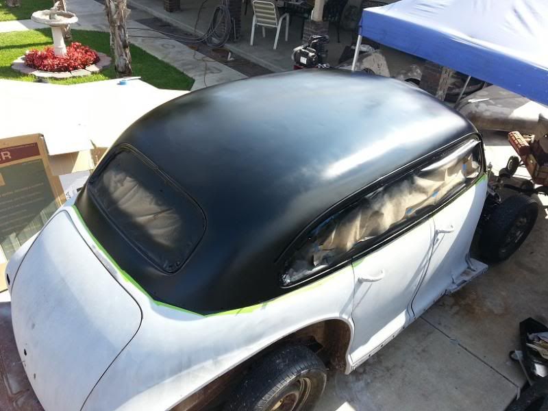

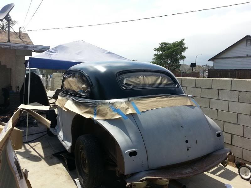

    black, even flat black, is the hardest color to paint because every single ding or imperfection I might have missed shows more. luckily theyre on the very top youd have to get on a ladder to see them. not perfect but im very happy with how it came out. besides, I plan to airbrush something on the top when the car is done so itll cover them up ;)
    wet sanded and prepped the primer
    cover up the 59 to keep overspray off
    and spray. boulevard black flat urethane
    im running a red pinstripe along the paint split
    take care of the body tomorrow

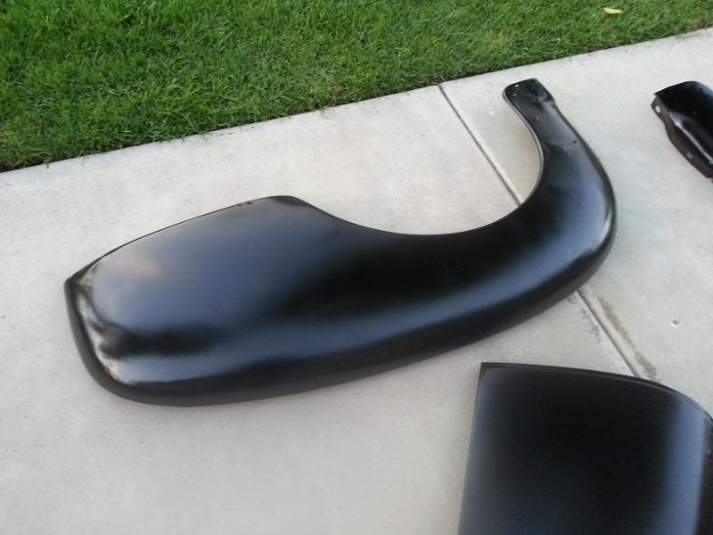

    thanks guys. there is update today, but was just prepping the fenders and hood to primer early in the morning and you guys seen pictures of the fenders ready to paint. what happened is I jumped on the motor and firewall which took me a few days and some surface rust developed that I had to remove before I primer. surface rust can settle in overnight, so a few days of neglect built a nice amount but its all gone and ready to spray =) so no pics for tonight but tomorrows pics will more than make up for it youll see and it wont disappoint ;)
    I have 2 questions guys, see if any of you guys know.
    1. voltage regulator. my 48 had the original voltage regulator, so im pretty sure its a 6 volt. but when I bought it it was running off a 12 volt battery and was warned not to because it could catch on fire, Im guessing cause of the original wiring (cloth) that was falling apart by just handling it. my motor still has the generator but upgraded to a 12 volt but because its a generator, I need the external regulator. whats the point of the regulator and what would happen if its a 6 volt regulator but used it on my 12 volt system?
    2. if I primer my fenders early in the morning and its pretty hot here in so cal so if I let them bake in the sun for a few hours since the morning, will the primer be cured enough to paint them the same day later in the afternoon?
    thanks in advance for any help guys

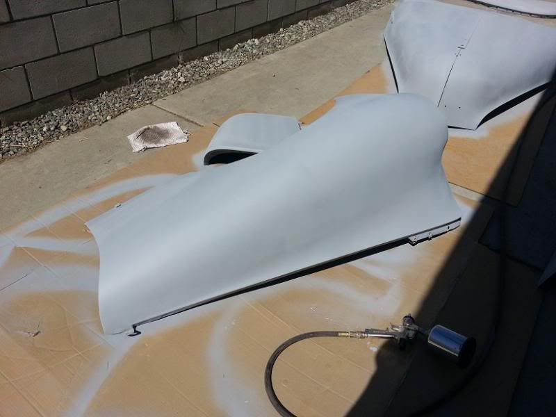

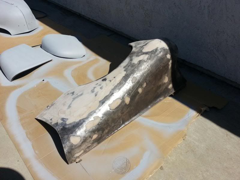

    got up today, back to work on the 48

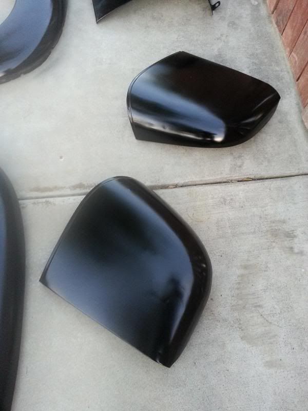

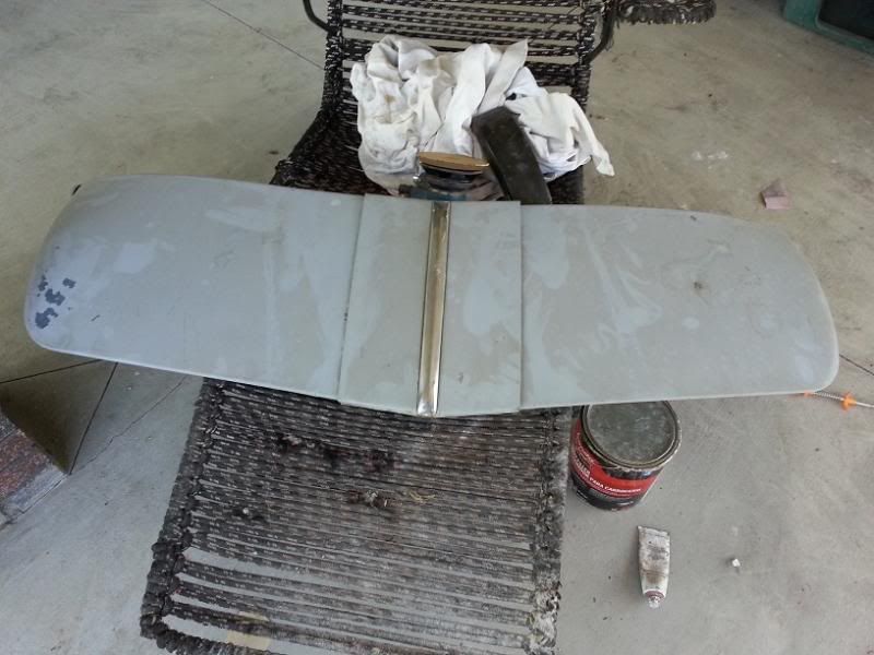

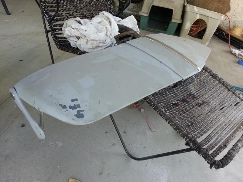

    yesterday I prepped these, they sat for a few days while I worked on dropping the motor so some surface rust set in and I had to get it ready for paint again. metal work was already done since then so all I had to do was sand the metal again with my d.a. sander. now theyre ready for primer
    and spray
    got the one shot paint and mack brush to stripe the paint part line on the cowl

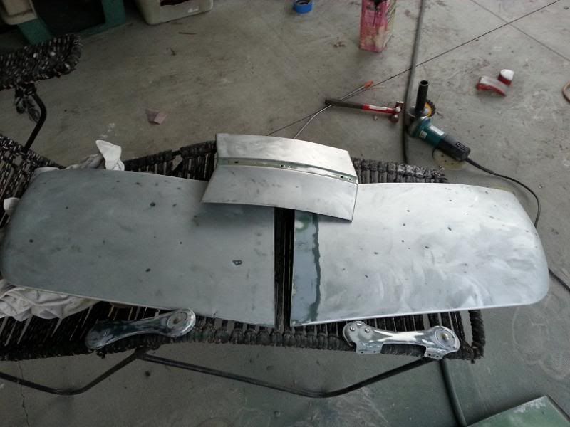

    and start to work on the visor so I can paint it and mount it for good
    small dings ill tap out tomorrow, visor came off an east coast car where it rained hail but was in very good shape

    done for the day, was going to paint them today since on the primer can it said one hour sanding and drying time but decided to let them sit overnight and through the morning till about noon to be sure theyre dry
    tomorrow I paint all those pieces black and the hood tan. then start to wet sand the body to paint. ill start early hopefully I can get it painted by tomorrow. if not ill finish prepping the visor and paint it

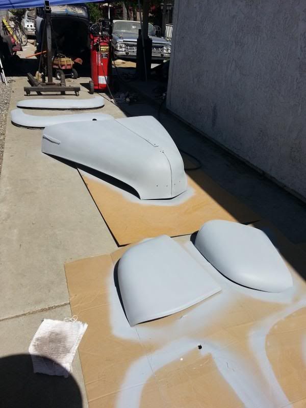

    sanded the primer to prep for the paint
    and ready
    remember, it looks glossy cause its wet. but its going to dry to a deep flat black

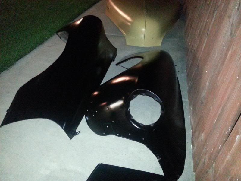

    thanks, glad you guys do. once the body is painted it all comes together and thatll only take me one day. im busy today cant work on the car but im back on it this weekend. I kinda needed the day break.
    yesterday when I started painting, I started with the hood, by the time I was done spraying the hood I knew something was wrong. I picked the hood up to move it to the side where the sun could hit it and didn't feel right, I felt drunk. when I started one of the fenders, I felt it even more and started making mistakes like I made a small drip on it and started getting sloppy on my strokes but luckily its flat black and I just went over it again. but when it started happening instead of me being more cautious I was like I don't give a ****, looks good to me like if I was actually drunk and painting. again im lucky its flat black and was fixed easy. by the time I was done with all of them and was cleaning my gun I felt like I needed to go to sleep and didn't clean the rest of the stuff up. now I woke up with a headache. the fumes got to me even though I was outside and I spray with no breather.
    so its my day off today, and its my bday so no work today. before I went in for the night, snapped these pictures where the fenders and hood were set so the sun can bake them tomorrow. gloss is almost gone so its got the satin look already. love how it looks in the night, a deep black with hardly any shine
    I was out there and even then I could smell them. apparently for bugs it was the place to be they were all getting high too and it was bug city. what tripped me out was there was atleast a dozen water bugs chillin under the fenders and big mother****ers too. I know they didn't come from inside my house so when I turned the lights on all the way they all ran back into the wood fence on my neighbors side. I poked my head over the wall and there was a ****load of them on his patio and on the side of his wall and along his windows and his sliding door was open so im sure they got inside too. im used to seeing a few, one here or there pop up but a god damn gang that **** was nasty so I got the orkin man showing up today to hit my wall. well im off, going to enjoy my day and night, called off work too. but by this time next week itll all be painted and put together and the interior in and all thatll be left is to fix the one torn small brake line and its on the road =D
