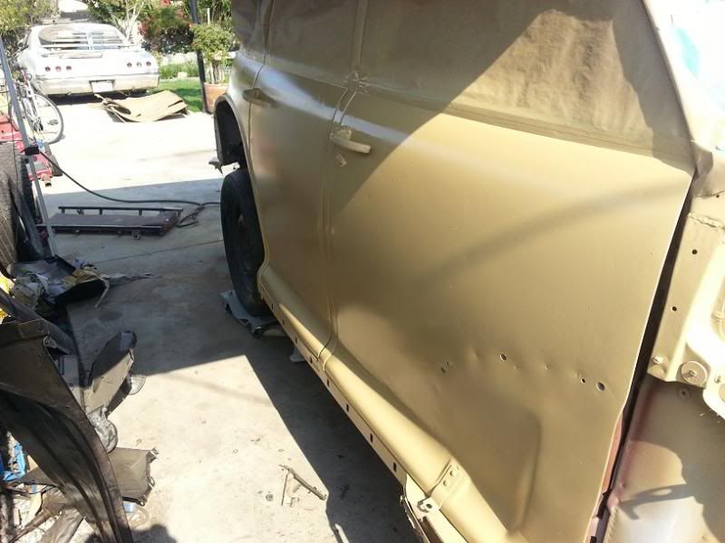

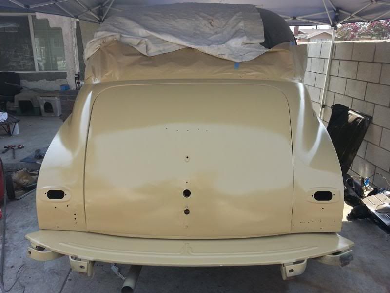

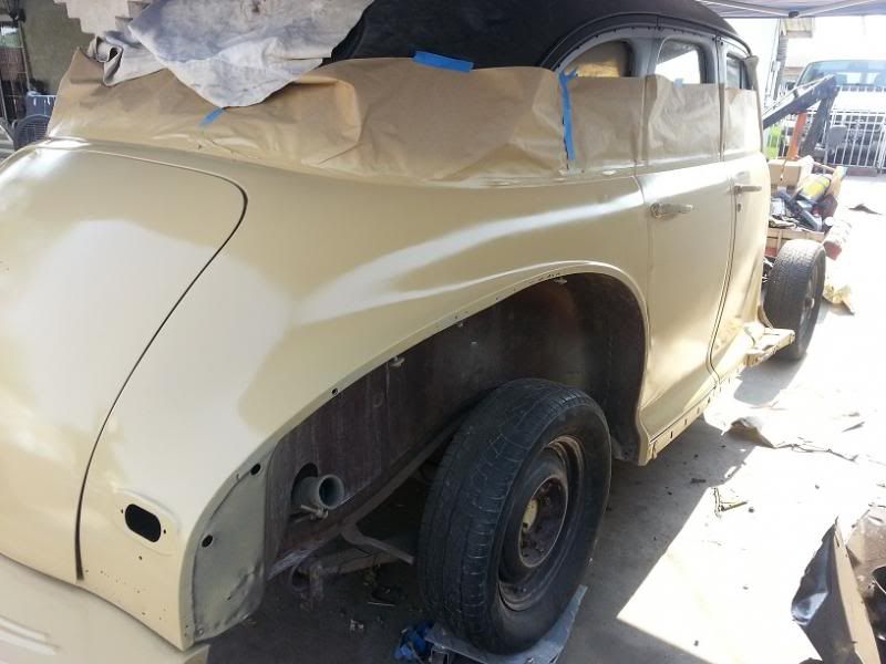

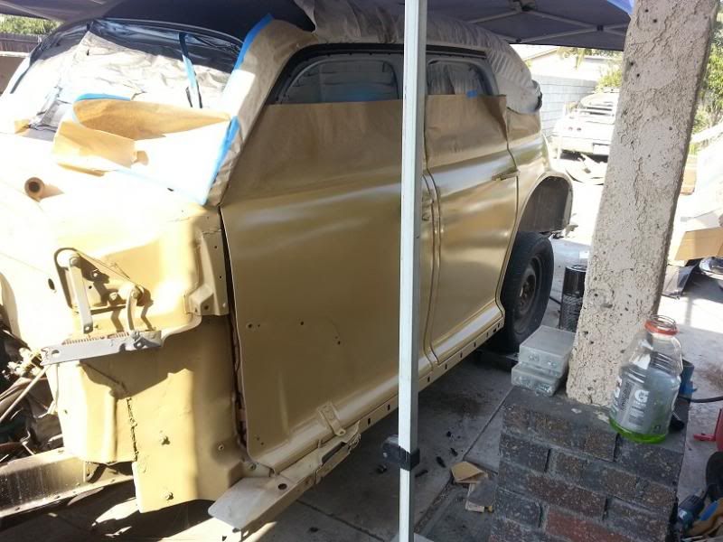

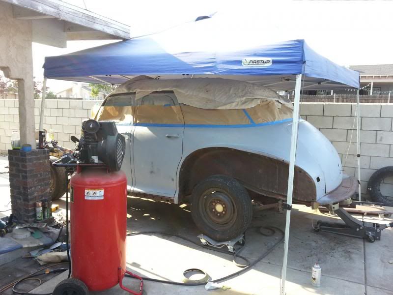

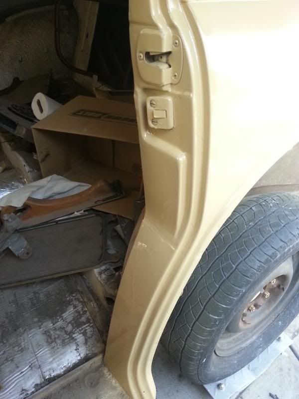

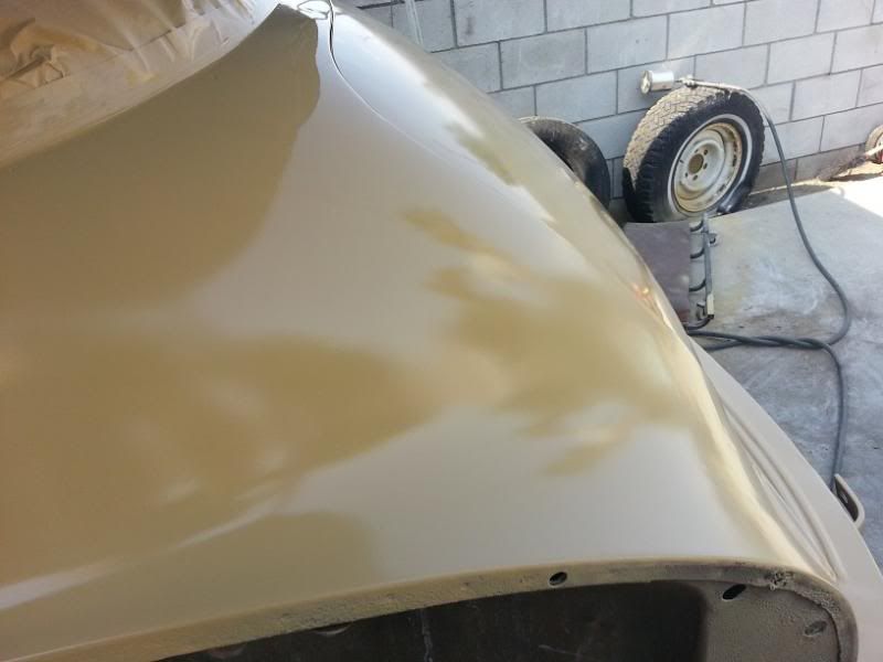

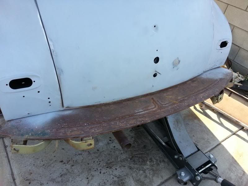

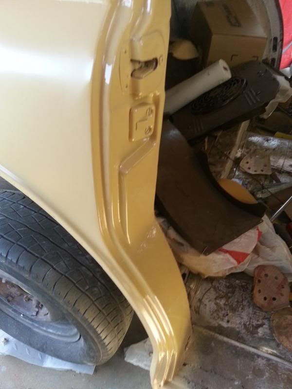

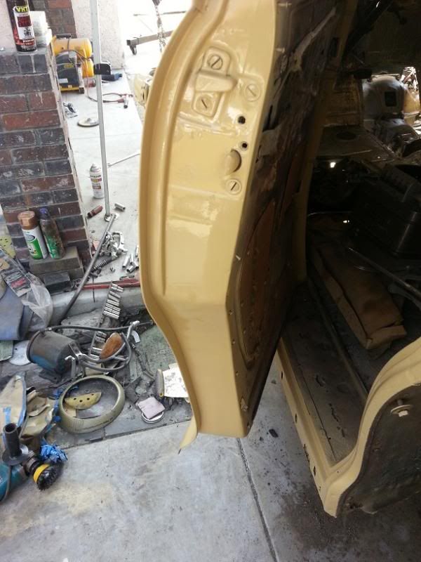

    did alittle bit of work today, prepped for paint
    tomorrow is going to be a very productive day, jumping one big step forward. also cleaning these up, before pics
    and straightened this up, was all bent up when I would use it as a step to get to the roof. now I just need to clean it up and prep it

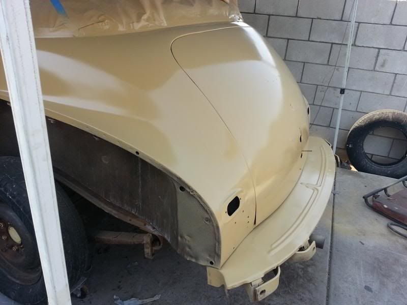

    I get you cosmo, luckily as of today im done painting only thing that's left is the dash and window moldings =D

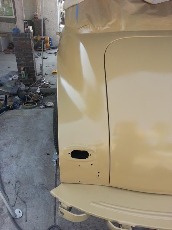

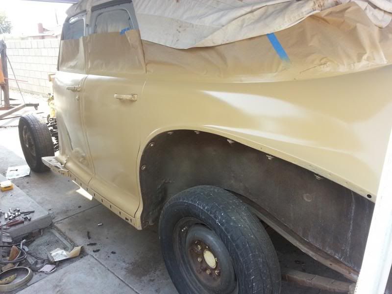

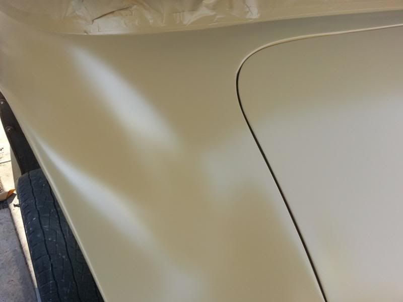

    I know I need to wash it, get the dust that settled off but im waiting a few days before I wet it to be sure the paint cured. so ingnore the dirty windows and tape, got the antenna put on
    painted the chevy logo off the hood ornament
    more work tomorrow, but as of today body and paint is done =D

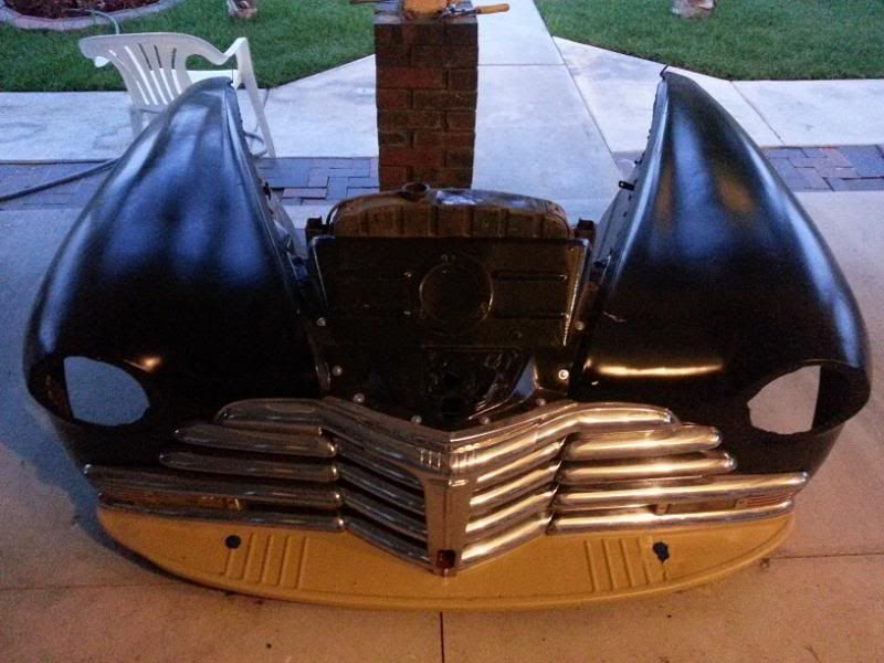

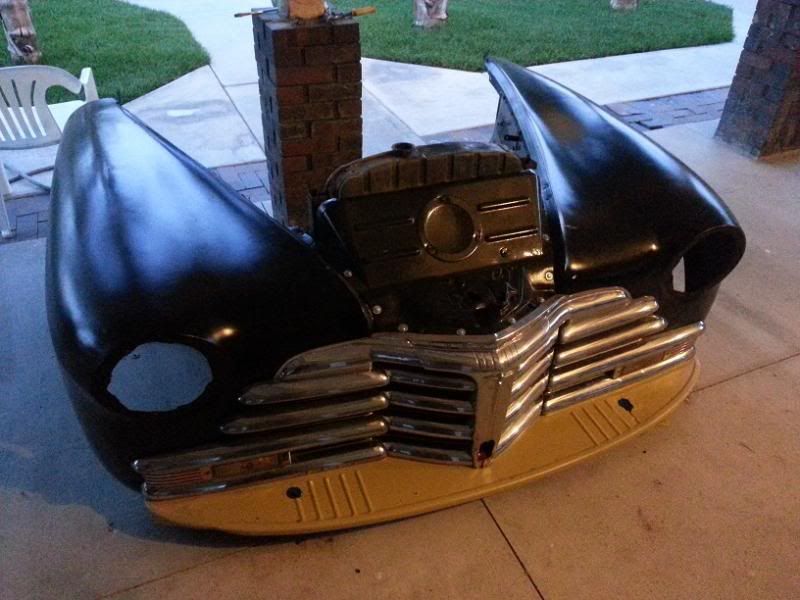

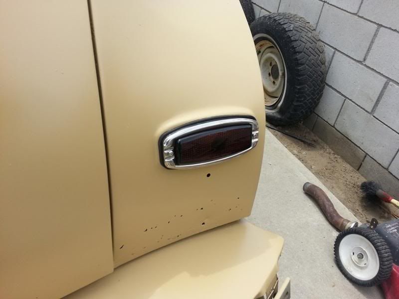

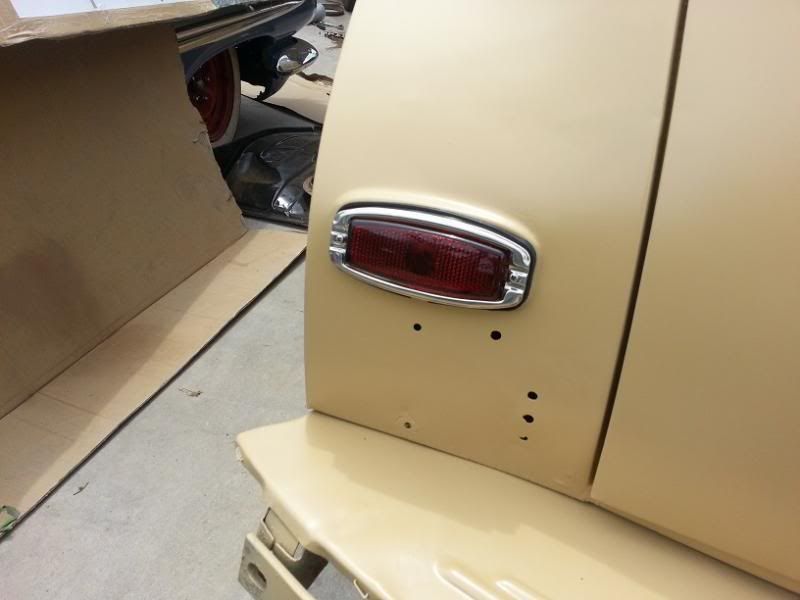

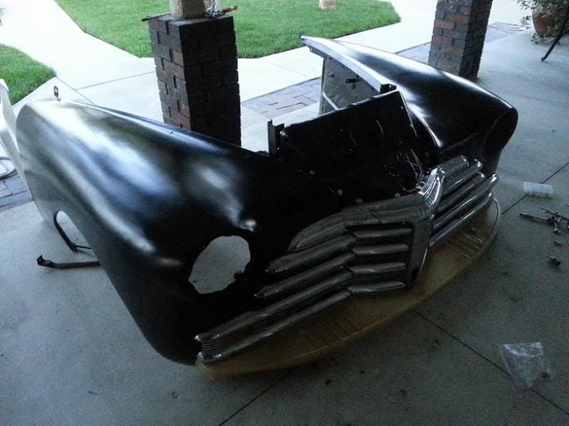

    did a few things today, put moldings, ornament and tail lights on

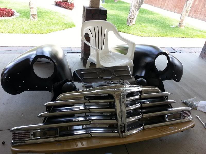

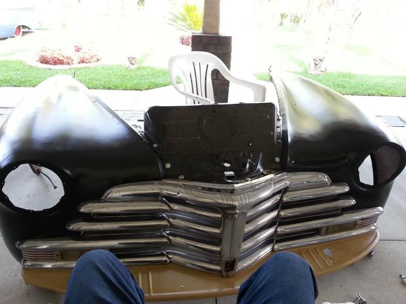

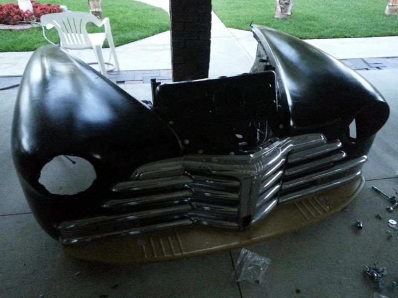

    getting started to put the front clip together to put back on in one piece
    but thought id throw these on for now to get them off the ground. I know, car is dirty but im not going to wash it for another few days to make sure the paint cures so it has dust settled on it. its flat paint so im not worried itll wash right off. but here it is with fenders and door caps on

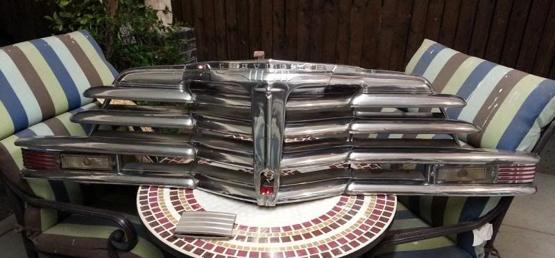

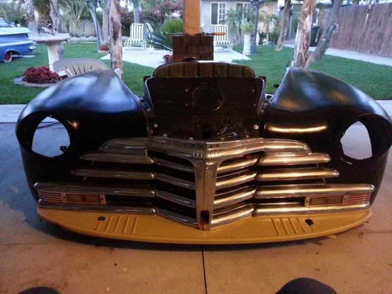

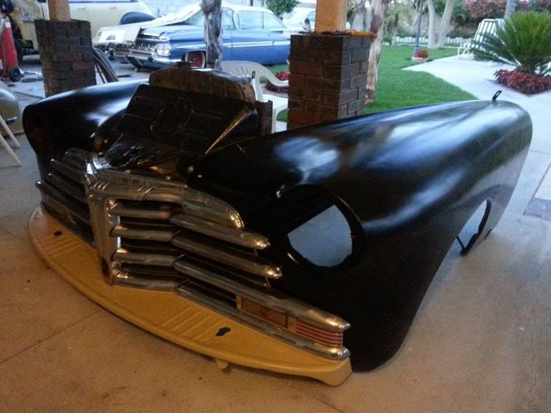

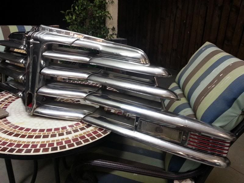

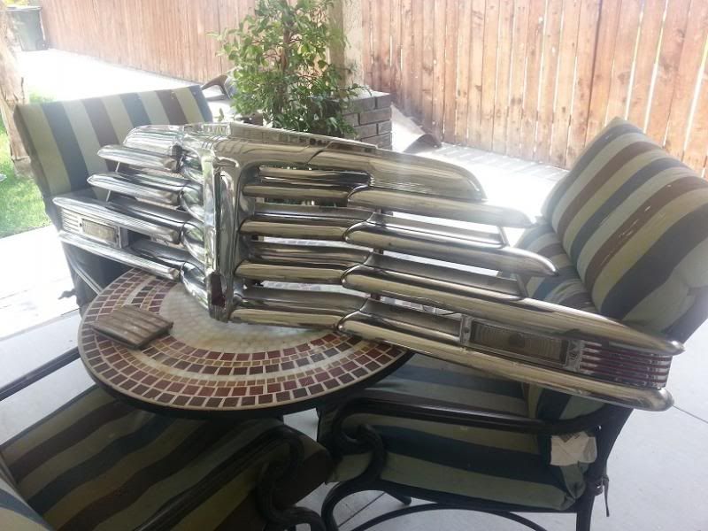

    I wasn't going to chrome the grille or bumpers, was going to fly it as is kind of a patina look to make the car look extra old
    but cleaned up pretty good, not chromed new but will do for a very nice driver grille =)
    not perfect, but im happy with this especially since my paint isn't glossy its flat. im not building a show turntable car im building a car that can be used as a daily driver and wont be sensitive
  12. jcmarz
    Joined: Jan 10, 2010
    Posts: 4,631
    jcmarz
    from Chino, Ca
    The grill looks real nice. What method did you use to clean it?

    thanks, the grill was pretty bad it actually had thick rust built ontop of the chrome in some spots where I was worried the rust ate right through the metal. on those parts I took a metal file and lightly s****ed away. the rest I took a scotch brite pad and some 3M chrome polish and lightly (as to not put more scratches or haze on the metal with the pad) stroked the 3M polish into the metal then wiped off with a clean rag. its this polish
    http://www.ebay.com/itm/3M-Chrome-M..._Automotive_Tools&hash=item20d487b91d&vxp=mtr
    on surfaces where theres no rust, I rubbed on with just my finger and it gave it a great shine. if its just stained or looks like a rust haze It removed it almost instantly with just a few rubs with my thumb. the stuff works better than I expected and you don't need a lot just little pea sized amounts each time. im doing my bumpers today which are just as bad maybe worse but ill show you how good the stuff is and its perfect for moldings, emblems and hood ornaments. when I bought it the guy told me be careful cause its pretty aggressive not chemical wise like itll burn your skin but abrasive to where I can go right down to the nickel or that copper plating under the chrome plating if I rub too long. he said when I use it im pretty much taking a thin layer off the chrome and that's what polishes and removes the scratches

    Thanks for the info on how you cleaning up the grill. A HUGH difference. I can't believe it's the same grill. As for your radio, why not get one of those tissue dispensers and and place the unit inside.

    jc marz heres better pics of the grille in the day, that cream works miracles
    and as of today, dog house is ready, by this weekend my car will be one solid piece
    done for the day, off to see lone ranger =)

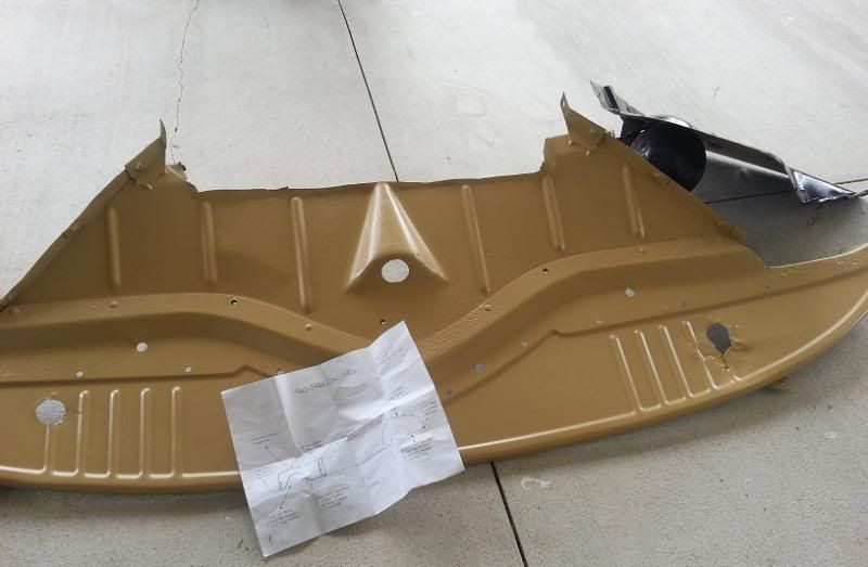

    Also if you have found out what its for, disregard. But this lever in your pic below...
    That is your accelerator linkage. Your gas pedal has a hinged part with 2 screw going into the floor and then the top part has a little round rubber plug that 'pops' onto the little bulb on the end of the linkage. There's a bellcrank on the block and your secondary linkage goes from there to the carburetor. There should be a return spring on that too somewhere. It came with the Carter W-1 carb so if you're using the Rochester you may have to fab up something a little different but it should be close.
