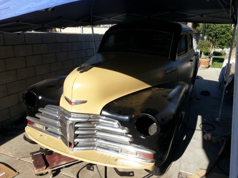

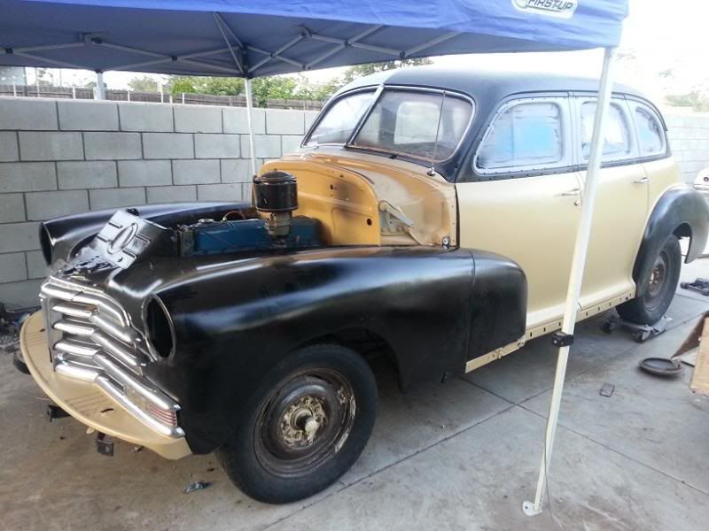

    had to retap new threads in the hood for the hood hinges
    pop the front end on, was quick took a few min only
    and put the final piece, the hood on. car is dirty, will wash it this week finally I just wanted to let the paint cure good so itll look better after but its dirty right now I know. car is now all bolted together and one solid piece just missing the bumpers which im putting on tomorrow

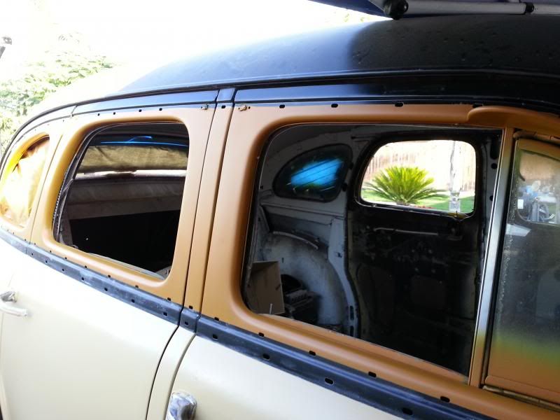

    fixed my medallions today. had broken bolts so I couldn't mount and were dull
    and got my windows painted and ready for woodgraining
    also woodgraining my steering column

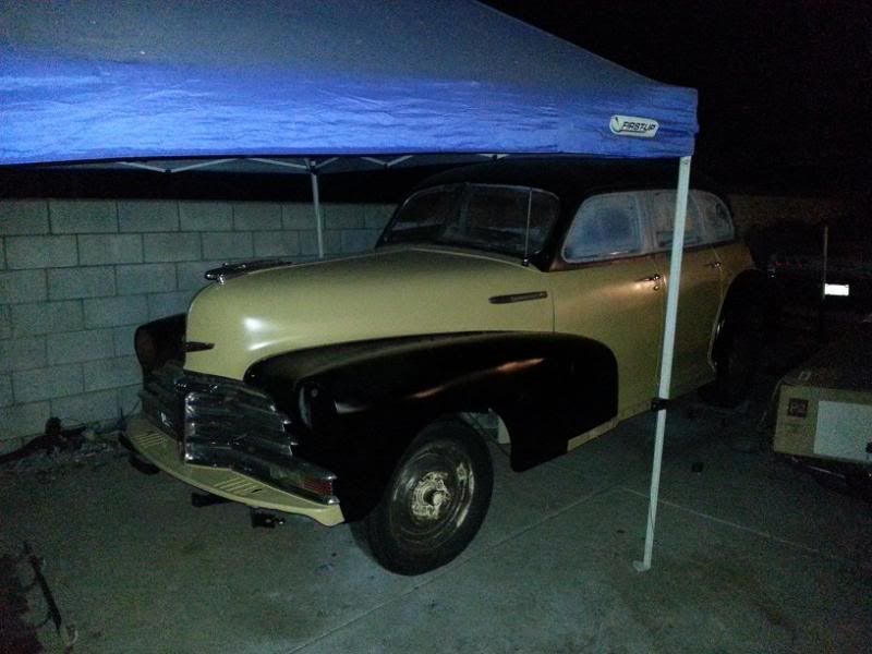

    will be a busy day tomorrow, going to get a lot done. dirty but day pics of front end on
    whats cool is now I can finally wash it, I will after the woodgraining is done.
    chillin with my project in the back, cant wait till its done and on the road

    Sorry but going to have to disagree with the woodgrain on the side just going to be too much also why is the gravel pan not black ?

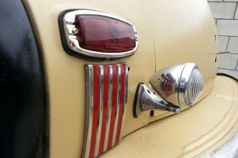

    I believe the woodgrain will stand out real nice once it's done and the stainless is back on. But what's with the holes near the tail light?

    you think? I just figured it would match the woodgrain on the inside. im using the woodgrain kit the roller with the inks so itll look like actual woodgrain not paint brush strokes. I figured worst comes to worst, id just spray flat black over it. also figured it would be different and personal touch since Ive never seen that before. but this is the first 40s car I build with no guidance, even on other websites dedicated to only 30s 40s cars I don't get feedback so im on my own here. I know all the history and facts to them but in some minor aspects like this im playing it by ear. the inside is going to be all original and nice like new as well that's another reason I thought the woodgrain would go with it. but of course adding my own personal touches on the inside like custom privacy curtains with original vintage Victorian print paisley fabric and other little extras but for the most part original. and as for the splash pans, I know the back one is same color as body and isn't the fender colors because on the back the body has the biggest surface flowing into it than the fenders. so I did the front splash pan as well to match the back one. but again I wasn't sure so I just play it by ear so its tan not black. but the rear splash pan I know for sure is same color as body, I have the original 48 dealer album and it shows them same color as body but doesn't show any angle on the front to see the front splash pan

    the holes on the tail light on the right side are small pitting I thought I took care of but didn't pop up and realized I didn't till I sprayed the flat tan. the holes on the left side its three in a row and one just to the left of it is for the back up light. the three holes is the mounting holes for the bracket and the one to the left is for the wire. its a back up light with a bracket and the back up light looks like a small Appleton spotlight its cool ill post a pic of it when I pull it out to mount it

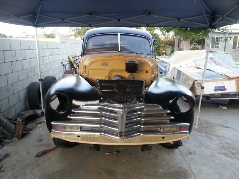

    Did you prep the bare metal with anything before primering? It looks like you did rust removal and primer a section at a time as you dis***embled it. Did you ever take the body off the frame? If not, how did you paint/primer the frame and under part of the body?
    Did you have to replace tons of rubber grommets, seals etc? I pretty much knew what I was in for cost-wise on most things like paint and interior, but almost every inch of rubber on my 41 is dry-rotted and when I checked Steele Rubber Co. prices for stuff I almost had a heart attack.
    And can I borrow that wood grain kit when your finished with it?:D
  11. gallogiro
    Joined: Aug 10, 2008
    Posts: 911
    gallogiro
    before primering I sprayed it down really quick with metal prep to remove any contaminants, its a spray can I got from where I bought my primer but someone posted about a better way to prep the metal that they got at home depot. but hit all the metal with 150 grit paper on my d/a sander right before I sprayed it because rust settles in just overnight even though its just a haze. and yea I did a section at a time, its impossible to have the whole body sanded and do the bodywork at the same time and still spray the same day. youd be going back at the end taking off the rust haze that build up while you were working on it. and if your body was like mine, youll be doing body work and prepping for a lot of days.
    I never took the body off the frame, if youre building just a driver like I am and the floor and frame isn't rotted out theres no need. the body mounts aren't really body mounts on these, its just a thin piece of rubber like off a tire that its only purpose is so the body doesn't squeak on the frame, not really a cushion like on newer cars like on my 59 that I did raise it off the frame so since this one looked fine I left it as is. to hit that part of the car I had to crawl under it and grind it then spray it.
    as for the rubber, a lot of it was dry rotted but I left as is like around the windows because they still kept water out. I am just going to go over it with rubber restore. and the rubber on my suspension still looked firm so im good there. I am just going to get the rubber for my weatherstripping the doors and trunk. and yea the kit isn't cheap, but is well worth the money since its half what woodgraining a dash and window frames cost $1000+ last time I checked to get done RIGHT instead of work that looks like a bunch of paint brush strokes or someones ameture arts and crafts weekend project they supplied from michaels yet still say its original woodgrain and charge the full amount that someone that does do it right charge. if youre good at it itll pay for itself after the first job you do for someone, but still pays itself after the first job you do for yourself. after that its all profit

    I've never seen a reverse light like the one you mentioned. It will be interesting to see it mounted on the car.

    thanks. im trying my best even though im only building a street cruiser not a show car, my 59 kicked my *** on that and I need a break. this was today. all I need is to tomorrow put toner on it to darken it a bit and then seal it with clear coat and polish and its done
    im not a woodgrainer, so its not perfect but im very happy with it. its something different and that's what I want and stand out. that I know of im the only 48 with woodgrain windows

    Which wood grain kit did you use? Where did you get it?

    Not to say that your woodgraining job dosen't look good but those Inkblot tests came to mind because I see a tiger, a monkey, a goat. Take a look and see if you notice something.

    Great job! For me the burl marries together the black roof and creamy yellow body, well done!!!

    took it easy today. polished up as best I could and installed the back up light and trunk lock handle. the bumpers are on, im not chroming them theyre going on as is im fine with that since the paint is flat not glossy. plus it gives it a cool vintage patina look I like. all the back end is missing is the bumper guards that im polishing up right now
