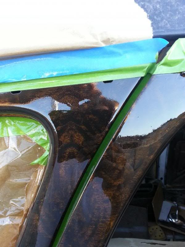

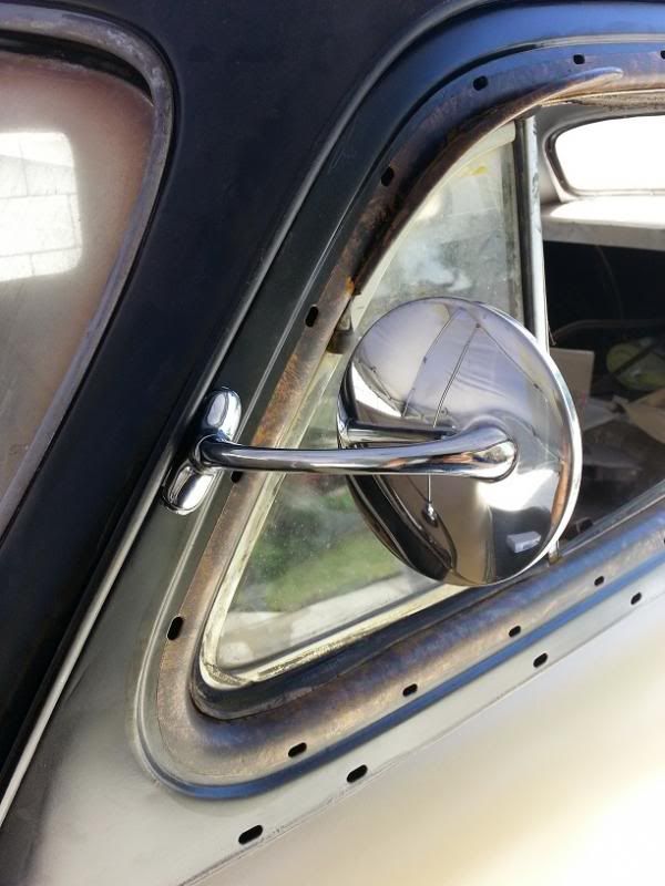

    got my mirrors in the mail today, theyre repops but the cool ones that don't have the screw showing on the back of the mirror that connects it to the bar and its a curved arm mirror

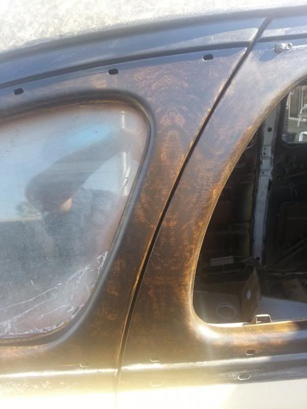

    and I finally put the toner on the woodgrain on the windows. it made the woodgrain look more realistic and deep, doesn't look like just print anymore looks like wood now. I used the dark toner not the light toner and I got exactly what I wanted, to look dark like stained wood. I wanted that because now it matches the flat black and doesn't look out of place and 3 tone. and if you look at the pictures, the darker it gets, the blacker it looks so at night itll look black like the roof and fenders but from a straight angle you can see the woodgrain

    tomorrow I spray clearcoat then Thursday I wet sand, buff and polish and its done. while I wait for the clearcoat to dry, ill start the woodgrain on the dash and inside window frames. those im using the LIGHT toner, which will be lighter than the outside window woodgrain. did other small things too to wrap things up on the car, I put these metal panels in that I forgot about

    I'll admit I was nervous about the wood grain before you started but liked it when you put it on and now with the toner all I can say is "wow". Nice creative touch. One of a kind.

    thanks jefe. well just follow how I did this one so far, you can do it on your own just get in that garage and start hitting it. remember its always progress forward not backwards. and yea the toner sets it off, but well see how it looks after the clear coat

    I can't imagine the clearcoat doing anything other than making it look richer with more depth.

    yea, let me know what you think. this is BEFORE I wet sand, buff and polish to take off any orange peel and shine it up even better. that's in 2 days when the clear coat cures

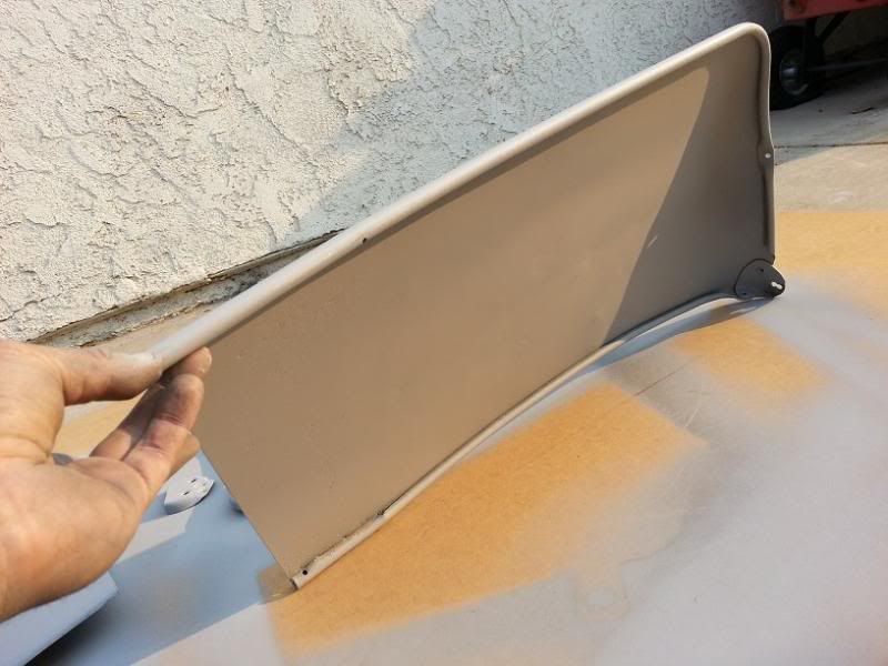

    so I had to keep myself busy for the day so I redid my fulton visor. used a bit of bondo on small dings and prepped it
    primered it
    bottom too
    thought I was done for the day till I saw on the primer can its only 1 hour wait to sand and top coat so it was on
    looks glossy right now, but will dry flat will match the roof and fenders

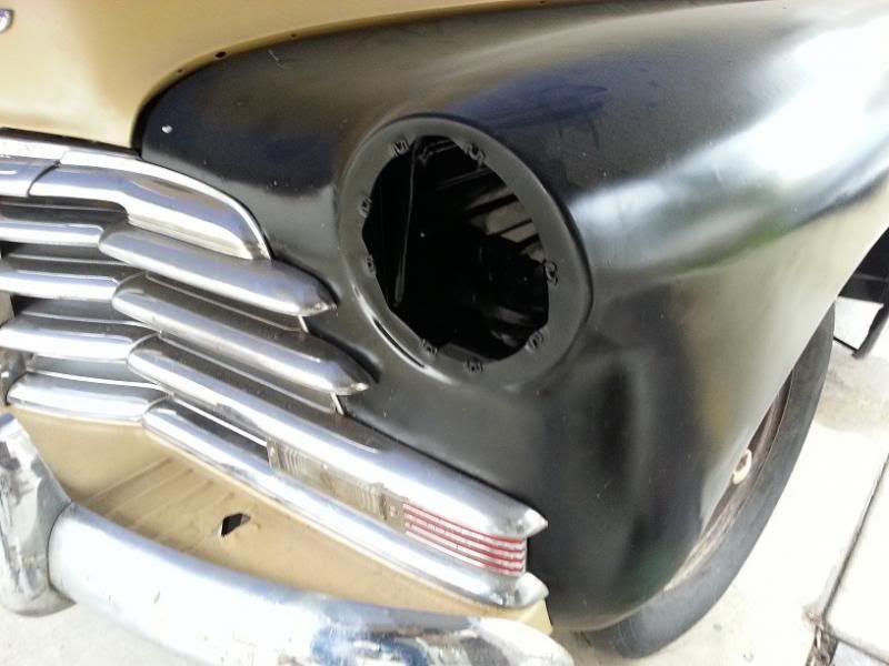

    Love the red on the headlights.

    was that usually painted a different color or was it same color all the way around? I wasn't sure but I striped them red

    On the 42 to 48, the headlamp rings where body color from the factory.
    Gallogiro,
    The red stripes are standard from 41 to 48 and it didn't matter what color the body was, it was red striping throughout. If I remember the story correctly, it was Harley Earl who wanted the red stripes because he said it would make the car stand out, even as it aged.
    By the way, FYI, the bowtie on the hood should be blue and the Chevrolet letters red.
