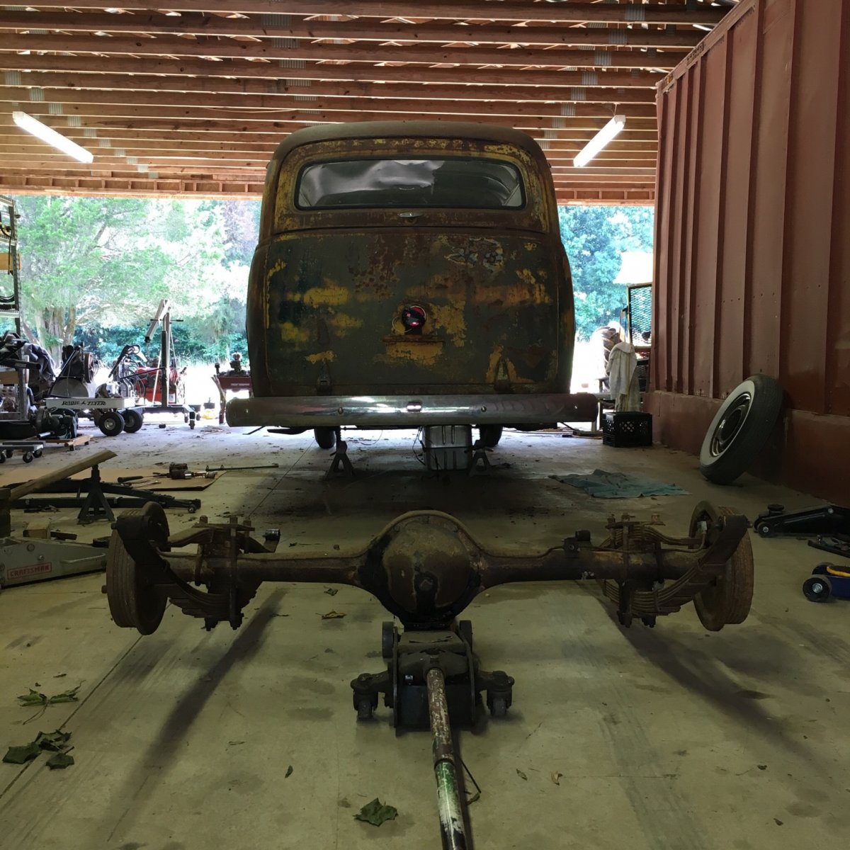

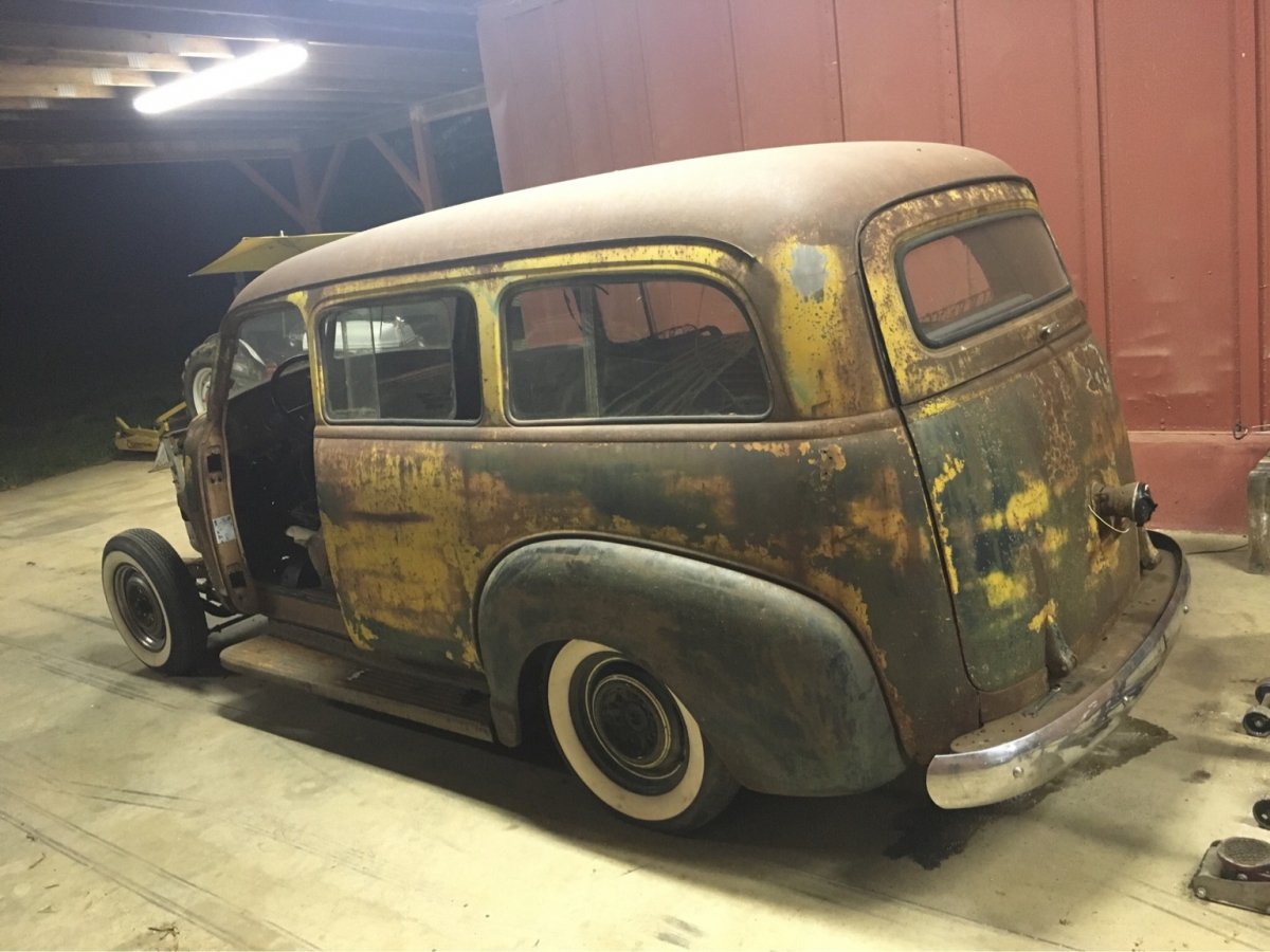

    Got this Suburban last year, going to add a few pics of the process. When I got it, it didn't take much to make it run and drive. Problem is it was super slow with the 4speed and straight 6. It's a very solid car, everything seems to work. The goal is a family car that I can drive... the roadster can only take one kid at a time! Trying to keep it traditional with addition of AC and power brakes. The engine will be a 327 with a T5. Here is a picture of when I brought it home. IMG_0001.jpg

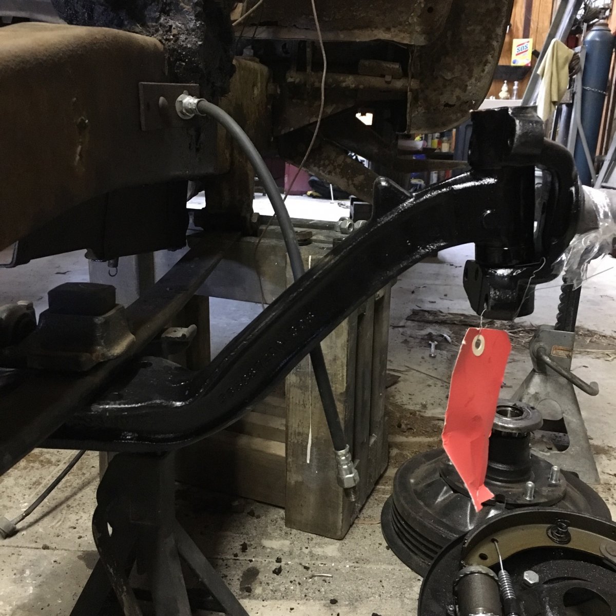

    First things first, got the axle dropped 3", it already had front mono leaves when I got it, so I will run those for now. I also upgraded the steering ends.

    Switching to an open drive shaft, out comes the old rear end. In with a 69 Chevy truck rear to keep the same 6 lug bolt pattern so I can run the original wheels. IMG_1488802968.244980.jpg IMG_1488802991.985251.jpg IMG_1488803018.002171.jpg
