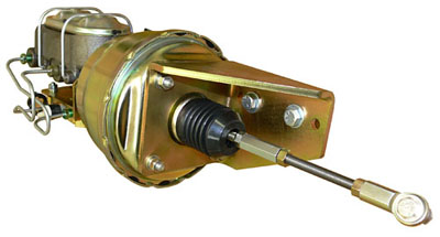

    Any chance you have pics showing the floor/frame mounted booster set up with both brake and clutch pedals? I've got the CCP power booster set up that comes with the pedal kit for my 49 AD. The problem is the new pedal kit doesn't allow for a clutch pedal. So I'm trying to figure out a way to use the power booster and keep my clutch pedal.

    cool - at least I know it's possible. Got any shots of the bracket that shows how the booster is mounted to the frame?
    Here's what I have:
    wondering if it will work if I cut the pedal ***embly from the bracket

    I would say yes you are better off using the stock brake/clutch pedals, looks like what you have is for an automatic.... Here is a pic of what I basically have. looks like it mounts more towards the rear of the truck than yours, so if you did cut the pedal off it would need to go back to clear I think... or just get the correct bracket from CCP... it bolts right to the original holes on the frame.

    HA! Just found this:
    thanks for the help!

    Wait.. looks like this one is just for the master cylinder not the booster.. you will need the one with 4 holes.

    good catch! I don't see just a bracket on their site - I guess I'll have to call and ask

    you got a part number for this one? I wasn't able to find it on the CCP site

    Mine all came in the front disc brake conv kit...
