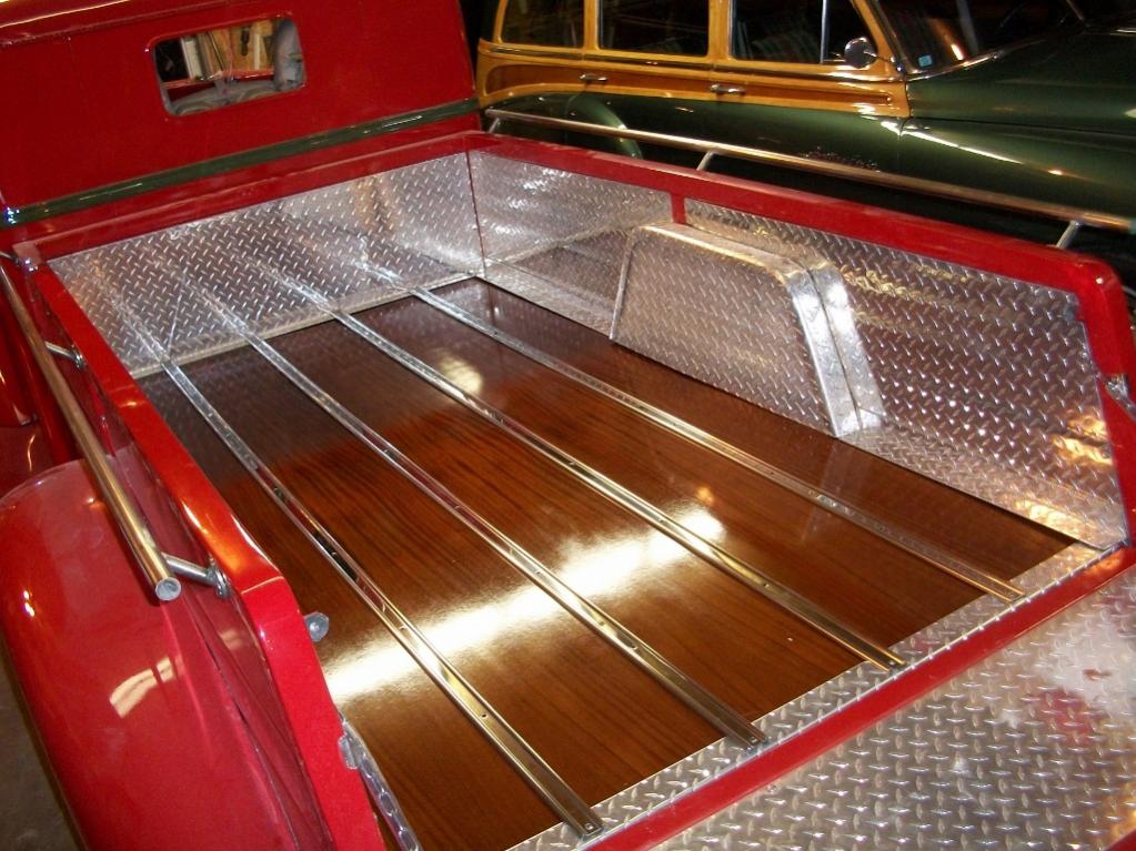

    I did the final mock up of the Diamond T bed's inner panels and floor yesterday. Had to make the little filler panels from side panels to floor (the box is 52" wide and the floor is a 4x8 sheet of Cepele marine plywood). The result is quite striking, even without the varnish on the floor. The stainless bed strips will be mounted with polished stainless carriage bolts thru the floor, which will be bolted to the bed frame with counter-sunk carriage bolts hidden by the rub rails (the pre-cut holes in the rub strips don't line up with the floor framework). Complicated, no? There's a couple more pics at my blog, just click on the link in my signature line...

    2nd coat of varnish on, and I lifted the bed floor out and painted the underside Massey Fergesun Red with a roller and tractor paint (it's a near dead on perfect match). The Cepele looks like walnut now with varnish on it. I guess it's OK. The picture below is from EXACTLY one year ago. Pretty big difference, huh?

    Well, am I done with the bed floor, or should I sand it one more time with 320, a fourth coat of Polyurethane, then ultra-fine and wheel it out? I think I know the answer...;) The rub strips and interior panels are just laid in, I couldn't resist going out in the shop tonight and seeing how the dark wood looked against all that polished stainless and aluminum. Get the sunglasses out, it's gonna be BLINDING!:cool:

    WOW thats gorgeous! As for another coat, that'd just set it off more but the NASA people would be griping about you shining lights on the space station. :rolleyes: :D

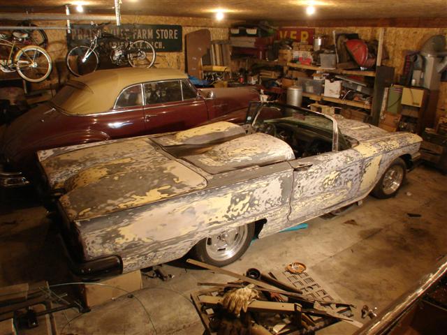

    Yeah, Baby! The top is already off my 'Bird, the w/s posts are sunken 2", so it's half done. Lets see, if I simply moved the top forward to the edge of the door, I could even leave the tonneau cover in place. I think I like it!

    Lol, we have drifted rather far afield from my Diamond T, but hey, it's my thread! The top is already removeable, so that's done too. If it were a pickup, there'd be a place to put the top, right? Here's the 'Bird.

    I really like those tonneau covers, saw one when they first came out and thought the '63ish T-bird was a two seater. It looks good on your car.
