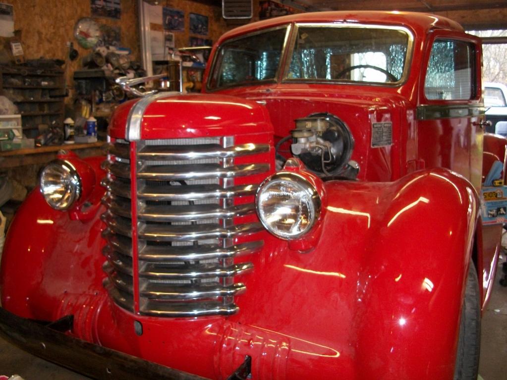

    Thought it was done by now, right? WRONG! I've gotten lots of OTHER stuff done though, and am back on the truck. Got the windshields in today, the headlights in (they even work, although the left one has a bad ground and is dim), the electric cooling fan in, and started on the running board trim.
    The truck has been out of the garage, up and down the drive and around the yard under it's own power, so it's a runner. Today was supposed to see a lot done, but I got distracted and worked on my daily driver, but hey, I still got some things done.
    To see more of what's happening at "Cool McCool's Garage", the Diamond T project and all the other stuff I'd like to get done this winter, just click on the link, and follow along...

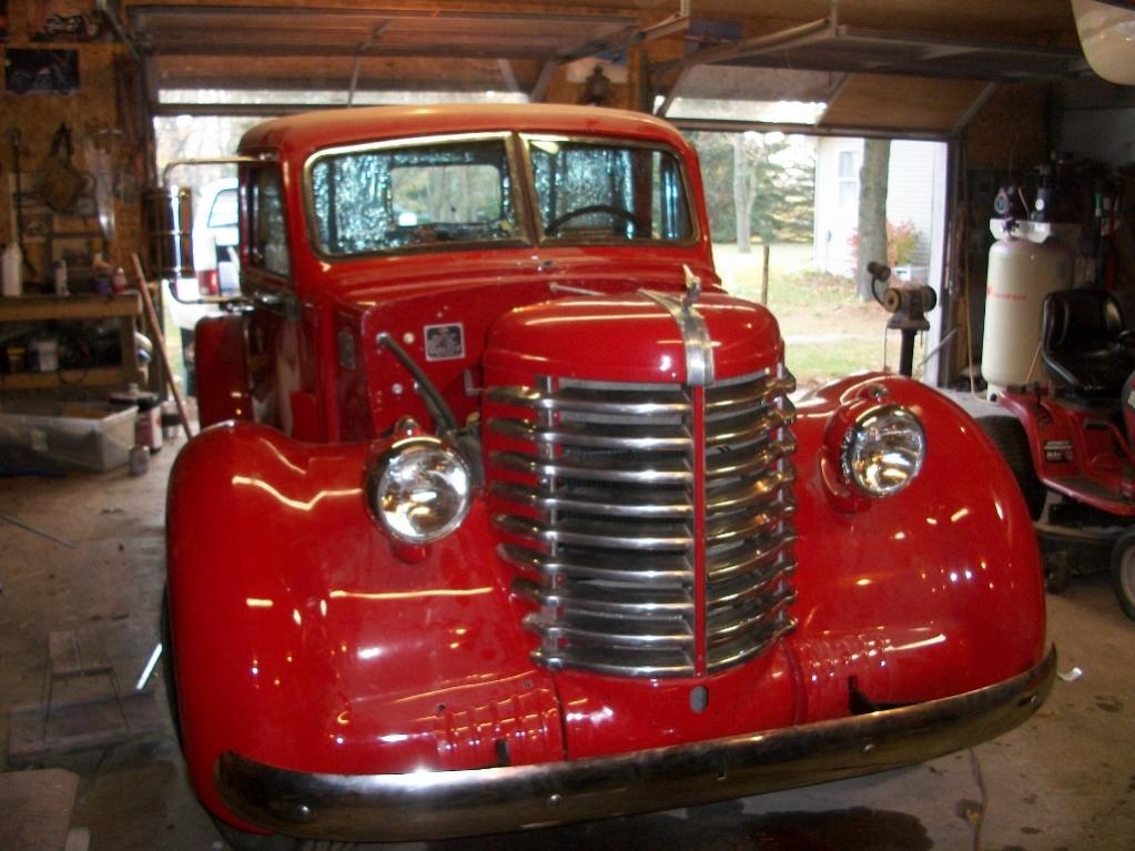

    They say you should pull a project outside, stand back and see what it look like before calling it "done". The front is about 2" too high, and it sets a teensy bit higher on the left than the right. A smidge off the front coils should take care of both issues. Other than that, I don't think it could look ANY better!:D
