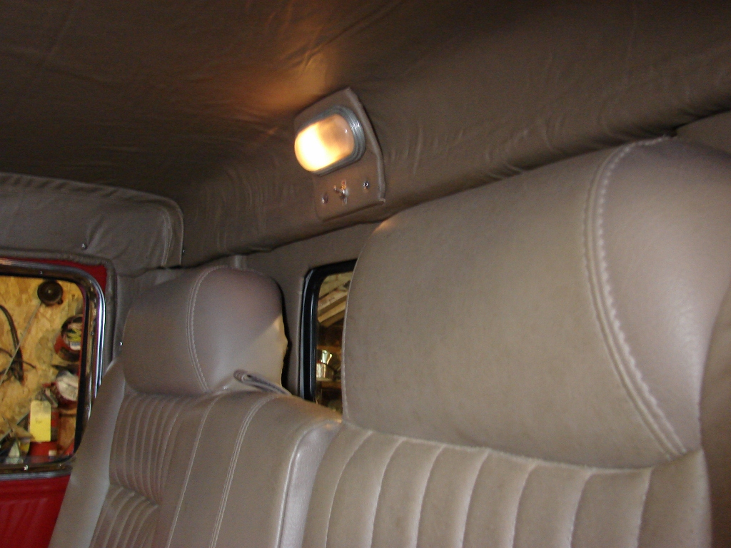

    Sure can. I posted a thread called, "Getting the upholstery done" a couple days ago with pics of how I made the panels, just search that title.
    These originally must have had a molded tar paper headliner, long gone. If I had any metal working skills, I'd have pounded a single piece aluminum panel, but lacking that, I simply bent a piece of .030 over a 3" pipe for the radius at the back, and hammered a lip to fit over the channel that frames the back of the cab. Above the doors, I made small panels that pinch the headliner up against the roof. These replace the cabs original steel door frames. The cab rear panels are done the same way, just fitted over the cab framework. All the panels are covered the same way, 1/4" headliner foam glued to them, with leather glued in turn to that. The hides have been rolled up in my basement for about 20 years, and had some wrinkles that were impossible to smooth out when I glued 'em down, but in real life, in the shadowed interior, they loof fine, actually matching the slightly wrinkled look of the seat. The color match is perfect, a happy coincidence. The seat is from my buddies salvage yard, the rear seat from some SUV, make/model unknown (to me). Looks good to me. The tall headreats are pretty modern looking, but the cab has a big brace/frame right behind the seat that would fracture your skull with the tiniest of rear impact, or even a big bump.

    Thanks Brian ! I have been tossing around ideas in my head for a similar headliner set up , something I can do myself.

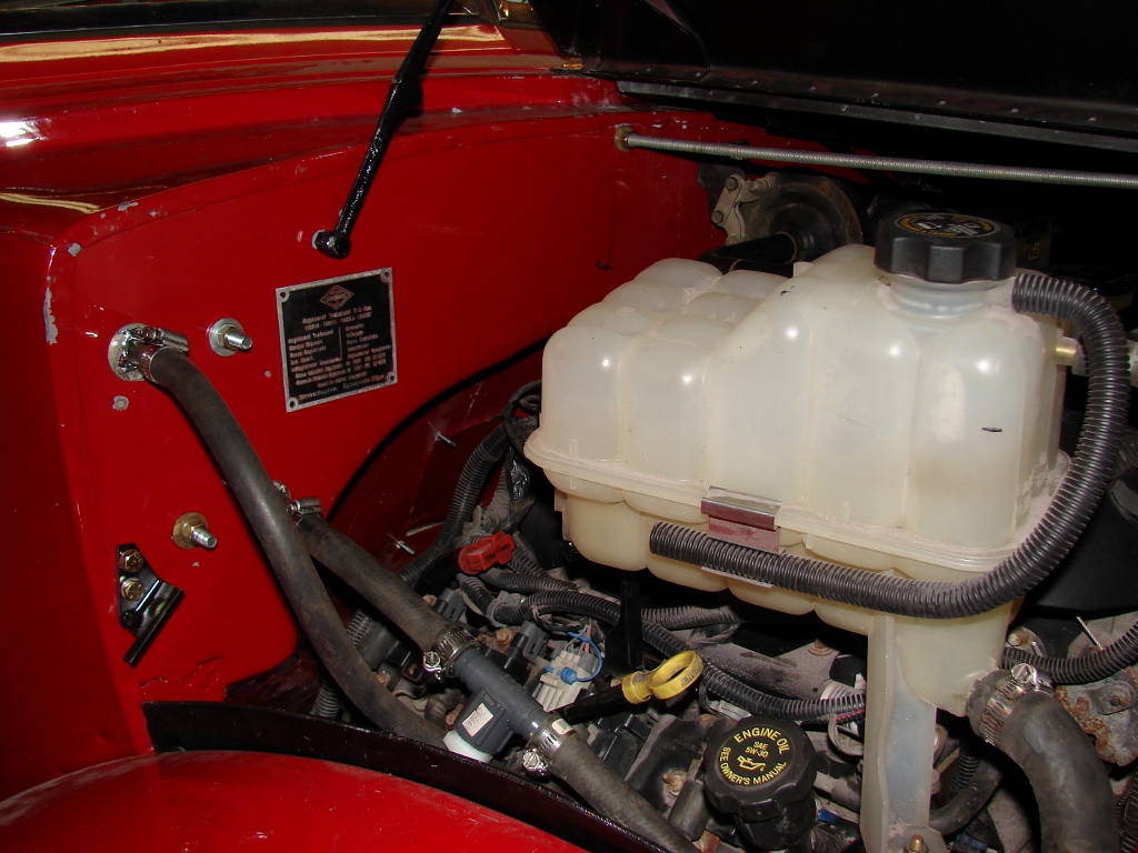

    So, the, wiring is basically done. There's coolant in the radiator, the brakes are bled, I got the left front spring trimmed so the truck sets level, and the interior is done aside from carpet and the kick panels. I'm going to get the radio and CD changer mounted today, and figure out where to inconspicuously put some speakers. Kick panels and doors probably. Then, exhaust, front end alignment, and buffing the paint.

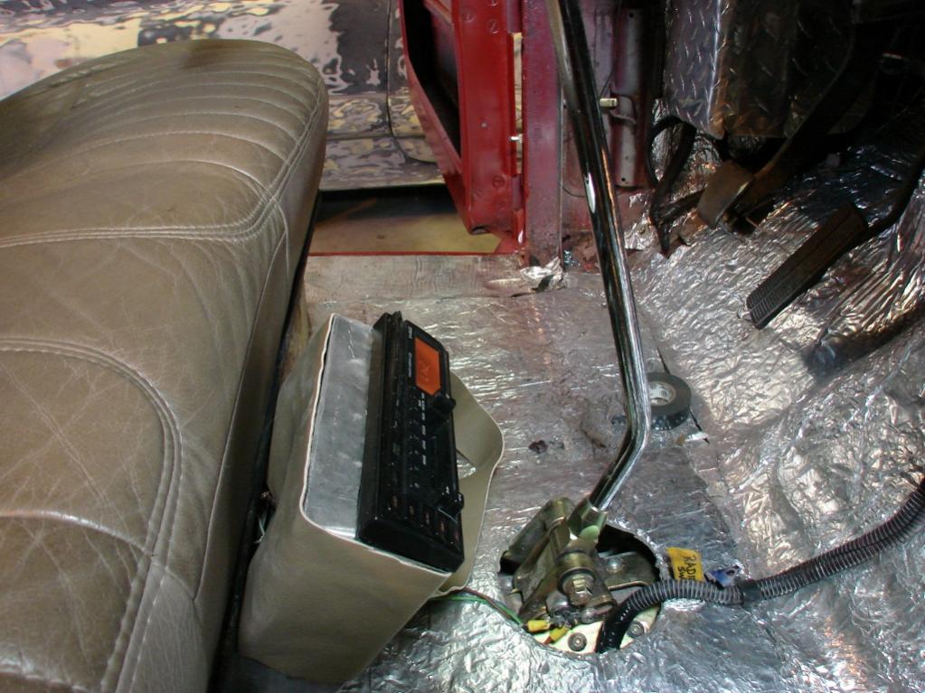

    Radio and CD changer in. Wiring re-routed, bundled, wrapped, and tucked in up under the dash. This may actually turn out pretty good.

    All that work installing the (admittedly ancient) stereo and CD changer, and the damnned thing didn't work. I was able to "fix" it, buy going to Best Buy and getting a new stereo. Blue-tooth capable, satellite ready, 3 input jacks for MP3, I-phone (if I had one) or other device, and best of all, it was on sale!
    Should have done that in the first place, but I had try to save a buck...

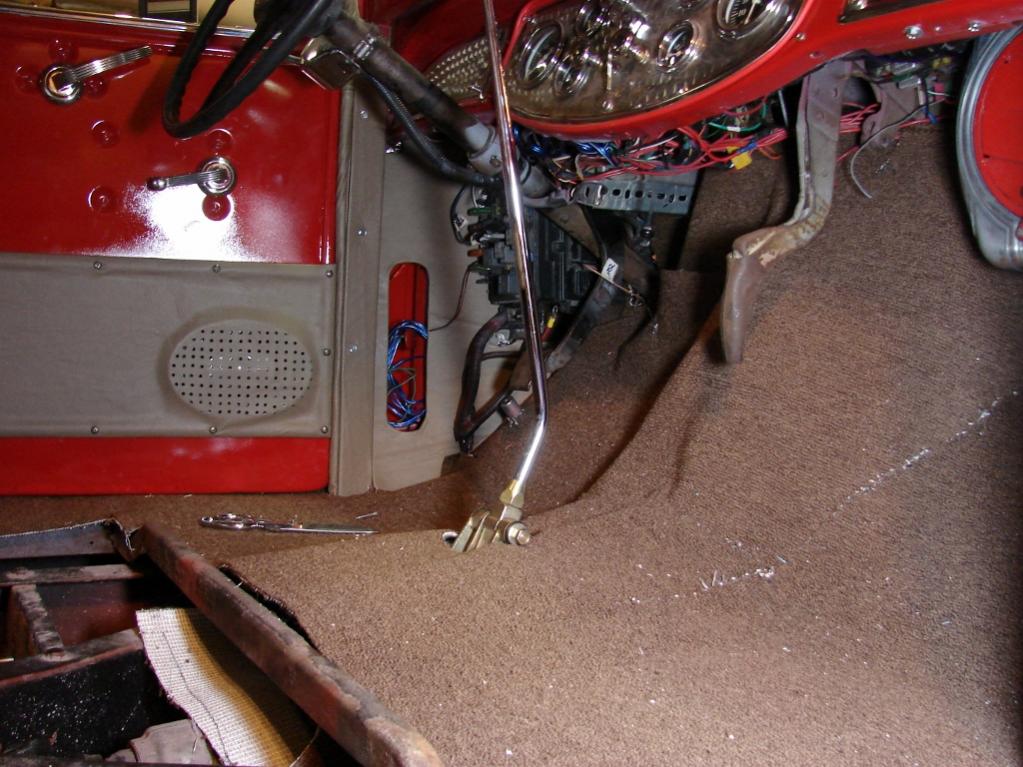

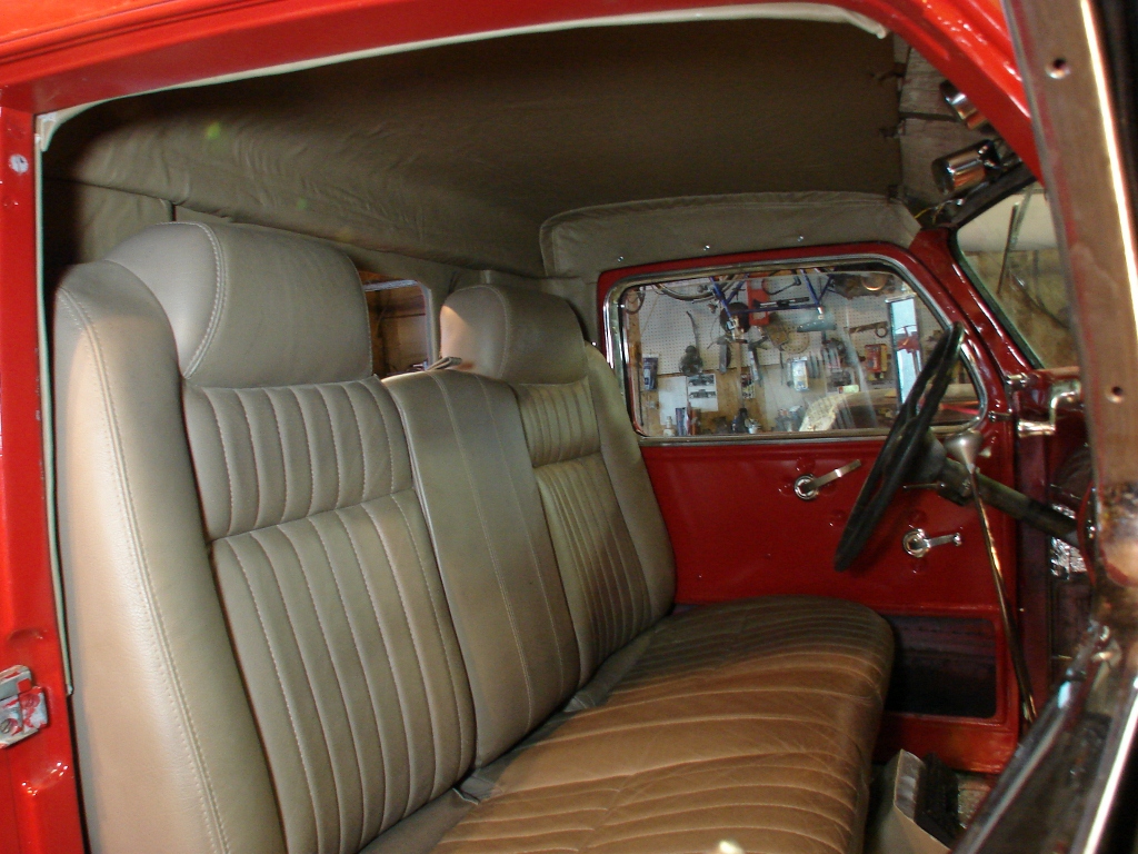

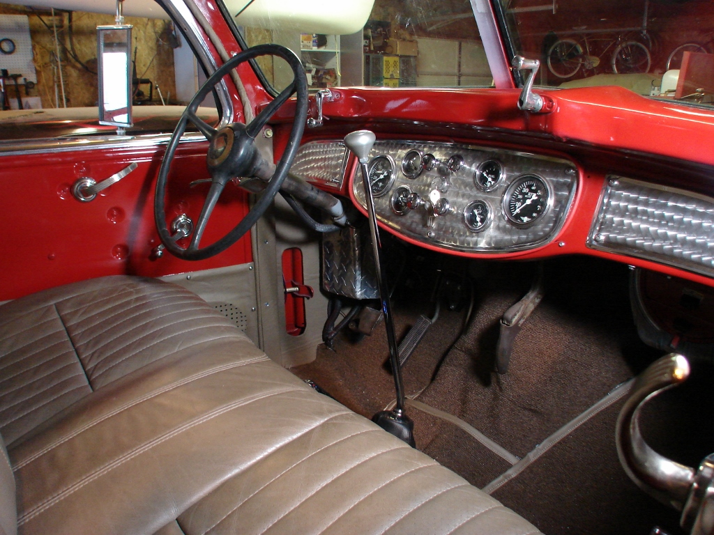

    I'm sneaking up on finishing the Diamond T. The interior is DONE, and the results are, I think, the best overall interior I've ever done. The carpet binding went great, and I got the stereo installed out of the way on the floor behind the Lokar shifter. Didn't want it hanging below the dash, and there is NO other place in the cab to put it. Or anything else, for that matter...
    Now, the fun job of color sanding the clear and polishing it. I know, I know, I should have done that while the paint was still "green", it'll be much harder now, but I'll get it. I knew I'd scratch it up putting it all together, and I was right. Nothing that won't "buff right out"...
    Here's the interior. I still have to paint the steering column and emergency brake handle, and refinish the steering wheel, but I'm calling that paint work, not interior work!

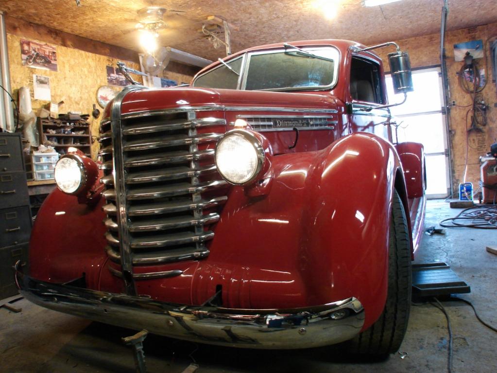

    I managed today to get out and get the park lights/blinkers wired up on the headlight buckets. An 1157 bulb BARELY fits under the lens, but they're in. Now, off to that online auction site to buy two more chrome hubcaps for the Dodge wheels and some marker lights for the cab...
    Brian

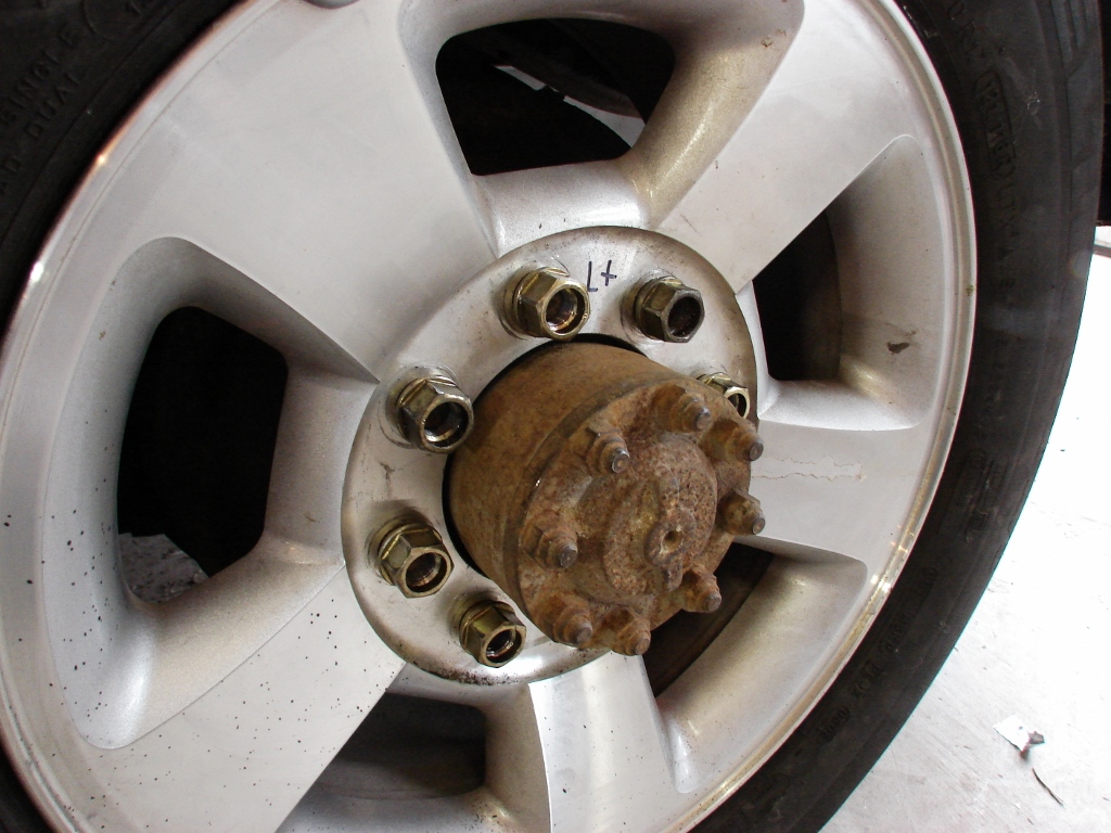

    Thanks to my friend Kirk ("Crafty B"), I've got the wheels mounted on the truck!
    Well, they were on, but the rear axle, from an early 70's Dodge, had 5/8x18 fine thread lug nuts, which didn't fit the taper of the wheels, nor would they hold the wheels center caps on.
    Kirk very graciously let me use his shop, and I drilled the (metric thread) late model Dodge lug nuts out, and then re-tapped them, with the correct thread. After a trip to an industrial supply store for a 5/8x18 LH tap for the left side. Still cheaper new studs, and Kirk now has the tap if he ever needs it.

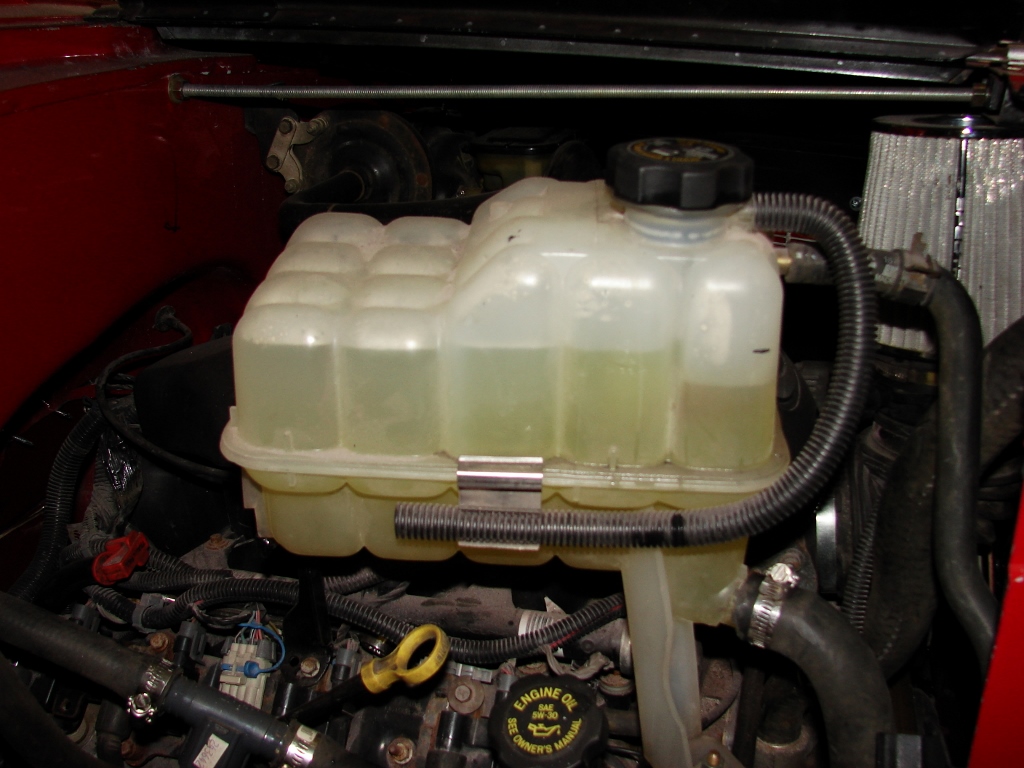

    The cooling system is full, after a leak that turned out just to be old radiator cap. The power steering is filled and bled, and the wheels now will stay on. I think we're ready for it's maiden voyage to the muffler shop!
