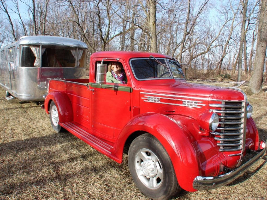

    I better update my build thread with the latest pics, even though yesterday I celebrated (OK, bragged) by posting pics of the truck in the yard with the trailer on the back.
    I've driven it about 20 miles (unlicenced and un-insured), and once when it quit in the middle of the intersection down the road from home, the local police officer helped me push it to the shoulder, never asked about the lack of licence plate, mufflers, or insurance papers. :eek: I did have my licence on me, but he didn't ask for that either, probably too winded pushing to think...
    Anyhow, today I'm thinking of going scrounging to find a "Y" pipe from a late model Silverado or Sierra so as to run both pipes down the left side of the chassis. The battery is smack in the middle of the "X" member on the left, the fuel lines run inside the left rail, and I made a running board support without a "hump" for pipe clearance that'll make tucking the left hand pipe up in the frame a challenge. On both my '48 convert and '51 wagon, I made crossovers using factory (they're stainless) "y" pipes, cut apart with the cats out, and ran duals down the right side.
    I like the looks from the back of twin pipes right together, and I think there's room to kick two over the rear axle and straight out the back.
    Here's the truck out, running, and hitched to the trailer.
