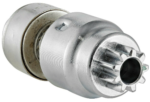

    Time to actually get off my *** & make my '48 Dodge road worthy again....Hit the ****on, and all I get is a whirring noise, so I'm guessing the bendix is stuck & not popping out to engage the flywheel, car's been sitting for a long time, like 10 years now.... I know they used the flathead in cars until 1959, my question is, how interchangeable are the starters? Has anyone found something else that interchanges? I'm not concerned about authenticity here, just what will work.... I did a 12 volt conversion, kept the original starter, always worked no problems. Thanks!

    Thought the Bendix unit was the ***embly that slid in & out....at least that's the impression I get when I look the part up on eBay....

    That’s as I know it too. My fork lift has a FH Dodge engine and the starter was doing the spin, no engage, I put the new ***y in as your pic shows to fix it.
    Edit: But make sure you don’t have a bad spot on the ring gear though.
