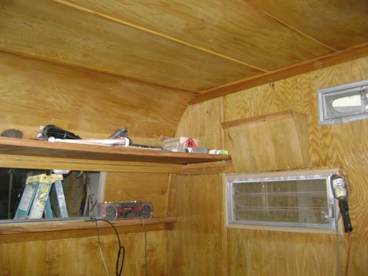

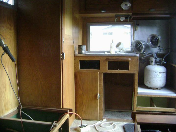

    Here's the only 2 'before' pictures I have of the interior during the initial clean-out.
    It had a bi-fold, double size bunk bed above the table but was too wide to fold all the way up. It was a head banger, so I got rid of 1 panel and made it into a twin bunk that folds all the way up.
    The seating on either side slides together making a king size bed or use them as two twins without pulling out.
    Notice how crooked the stove sits. Under it was Masonite for support. Besides sagging, there was a 6" round scorched spot under the oven burner. I could stick my finger through the 'burnt' Masonite. I used plywood with cement tile backer on top of that instead of Masonite.

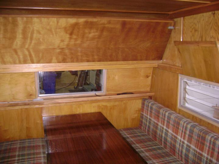

    And a couple premature 'after' shots. I added another coat of gloss urethane on the inside today but forgot to take pictures.
    When I cut the bunk bed in half, it left the ledger on the wall for the bed that I didn't remove because it was glued and screwed to the paneling. So, I built a magazine rack / holder over it. The ledger on the opposite wall, I removed because I had to replace the paneling.
    I got a full length mirror that will cover the old mirror spot on the closet door. Also have the original shades for the 120 volt electrical lights.

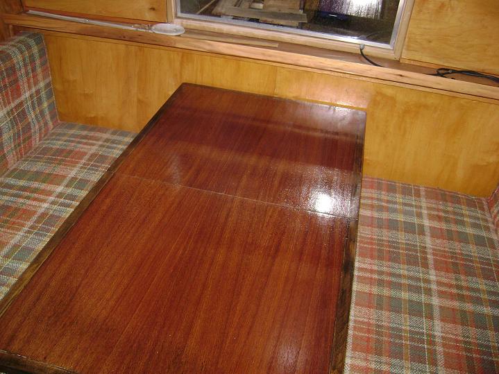

    The mahogany dining table was water stained really bad and the finish was toast.
    I put some 60 grit on the circular sander and burned through most of the water stain. Then belt sanded, then vibrating sander, then 220 grit hand sand. I put a coat of finish on it today but no pictures. It's gonna look awesome.
    Also rebuilt the connection for putting the 2 table halves together. And redesigned, built new legs. It had wobbly tent poles for legs since the originals were broken.

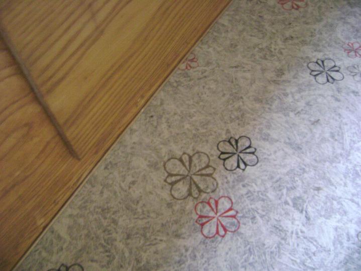

    Oh yea, check out the 'atomic' floor pattern that's under the gross green carpet. It even has little pieces of metalflake that don't show in the pictures. The vinyl is in good enough shape to use.

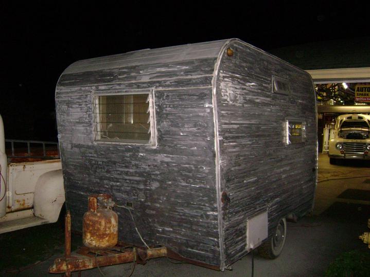

    The table is installed.
    You can see the upper bunk in the 'up' position.
    Got the front and driver's side stripped of paint.
