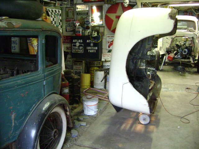

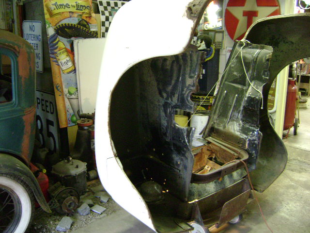

    Got a better grill the other day from a good friend off of a '48 F5 parts rig.
    Traded a pair of kinda rusty Model A rear fenders for it but I had to pull the grill out of the truck.
    What a job, about 50 fine thread 5/16 bolts rusted in place along with 1/2 dozen caged nuts in tough locations that wouldn't budge. Had to call in the sawzall. Ended up cutting the front clip off right behind the core support. For as rusty as the truck was I'm surprised the grill was in such good shape. It was the original as under the black paint it still had the wide red pinstripes.
    Here's the position for removing a grill with the front clip off.
    Still somewhat of a hard job if the fasteners are rusty..

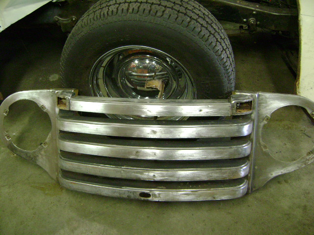

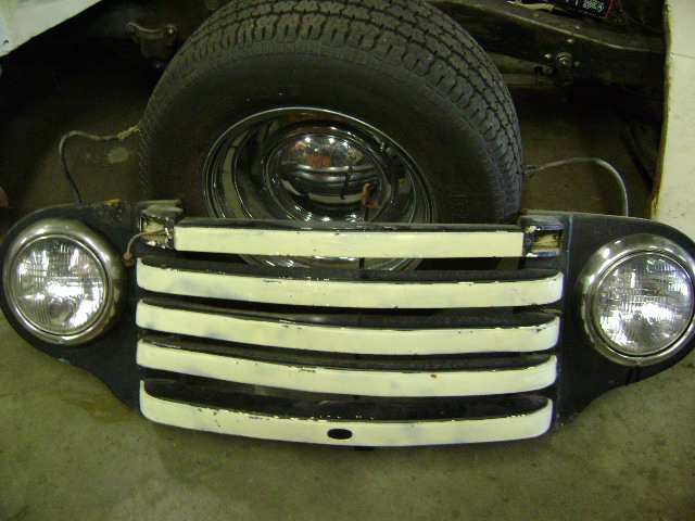

    My old grill with the Elvis smile. It had been wrecked and beat out and had 2 grill bars welded in the wrong position.

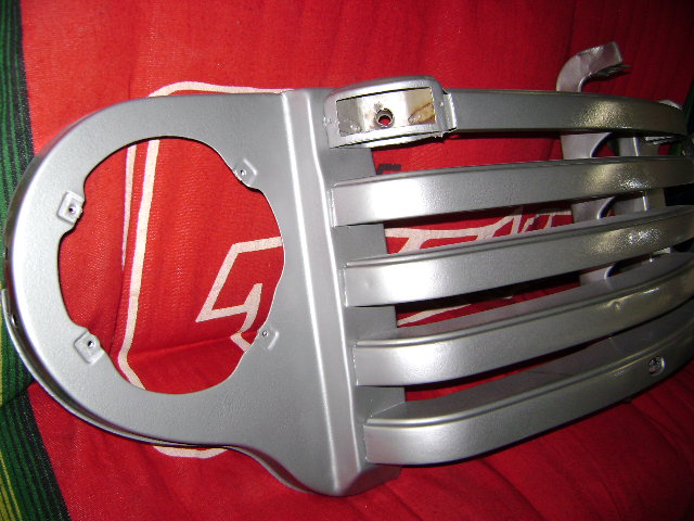

    Here's my 'new' one just about stripped and ready to rattle can rebuild. It has a few dings but much nicer.
    Got it painted last night. Used the same 'hammered' paint as I used on the heater, pictures will follow ***embly. Also beat on my inner fenders and got them painted semi-gloss black.

    Sneak preview of the rattle can rebuild on the grill.
    Used leftover hammered finish paint from the heater.
    It has small dents and dings so wasn't really worthy of a high gloss paint job. I didn't want to try and knock the dents out and end up with something worse than I started with.
