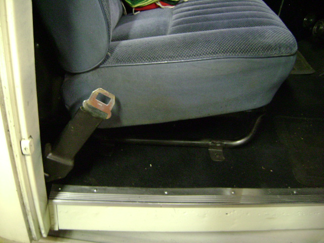

    I did get some seat belts mounted. What a fiasco that was.
    Plan A:
    Had some early 1960's blue belts saved but after looking they were in too bad of shape plus no retractors..
    Plan B:
    Had a set of nice black belts w/ retractable shoulder harness from an 80's S10. Made sure they worked properly, cleaned them up and installed. Well.... The seat in the F1 is about 10" taller from the floor than an S10 seat is. The shoulder harness wouldn't retract with the lap pulled out far enough to latch. I was pissed... They landed out in the driveway.
    Plan C:
    Back to the parts stash... 68-72 Chevy pickup lap belts only.... I was able to use the same holes in the floor from the S10 belts. Worked perfectly and have retractors so the belt isn't always getting caught in the door.
    I'll keep an eye out for something with a shoulder harness since I've already drilled for it.

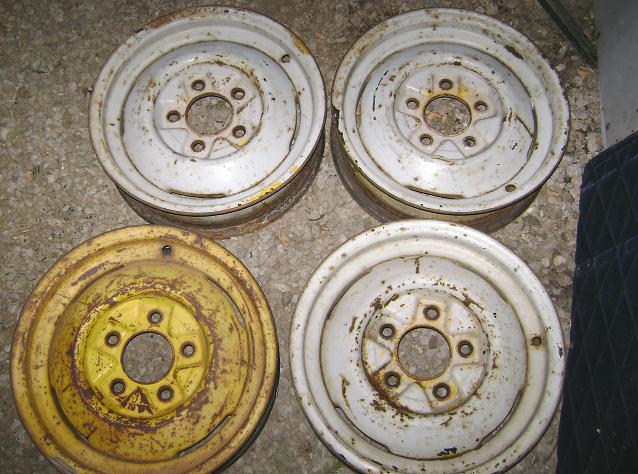

    I'm cleaning up my 2nd set of wheels that I'll trade off with the chrome wheels for a different look. The 'stock' wheels are 53-56 F100 and are 15"X5".

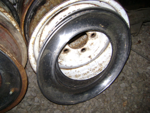

    Also have a set of 40's-50's Mopar beauty rings that I'm thinking about running. They fit well with the original style hubcaps. Not really sure I like the look, maybe a little fancy for an old truck. Kinda need to decide before the rims are painted as the rings will scratch the paint during installation.

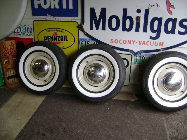

    This weekend's progress:
    Paint rims and install tires.
    (cheapo junkyard tires with good tread that I sanded into wide whitewalls)
