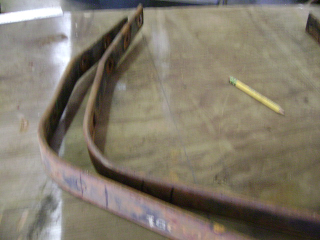

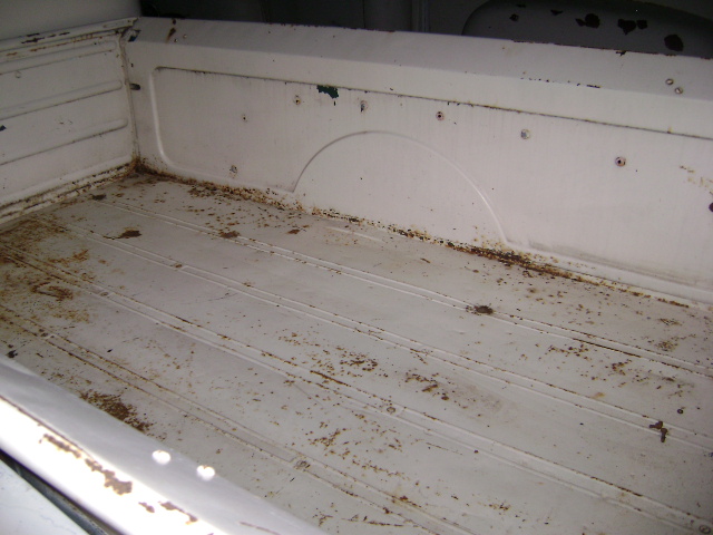

    Most 1948-1950 have a wall to wall stamped metal bed floor with simulated bed strips. They also have 3/4" thick wood under the metal. I was lucky and mine was in pretty good shape.

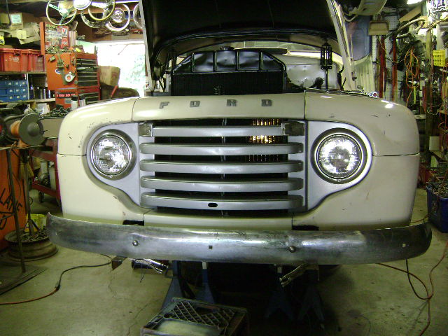

    Today's progress.
    Finally got the radiator and shroud in. (3rd time is a charm) The shroud needed more cut, weld, grind. Noticed the fan on the engine is offset about 1-1/2" to the driver's side.. That's goofy...
    While waiting for the paint on the remodeled shroud to dry, I cleaned up the Chevy truck front bumper and mocked it up.

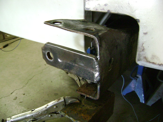

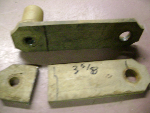

    The bumper came with all the original brackets but they'd need lots of modification to work. I scratched my head and went to the parts stash looking for something that would work.
    Ended up with a pair of rear spring shackles from a Chevy S10.
    Cut them up and welded to the F1 frame horn with no modification to the frame. They bolt to the original Chevy bumper bolt holes.
    The piece with the vice-grip was a temporary holder for the bumper.

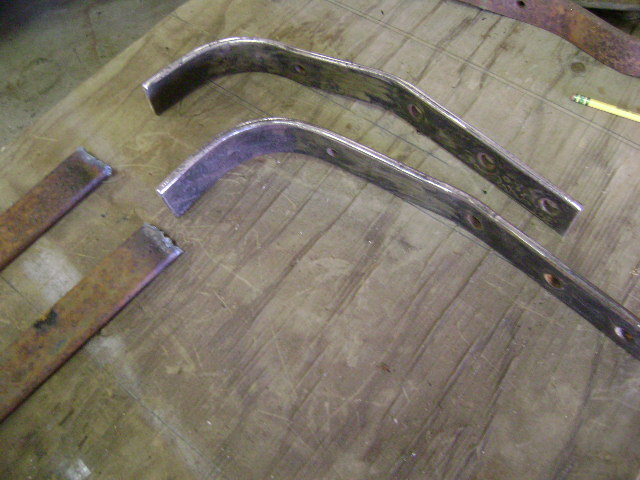

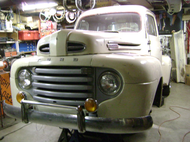

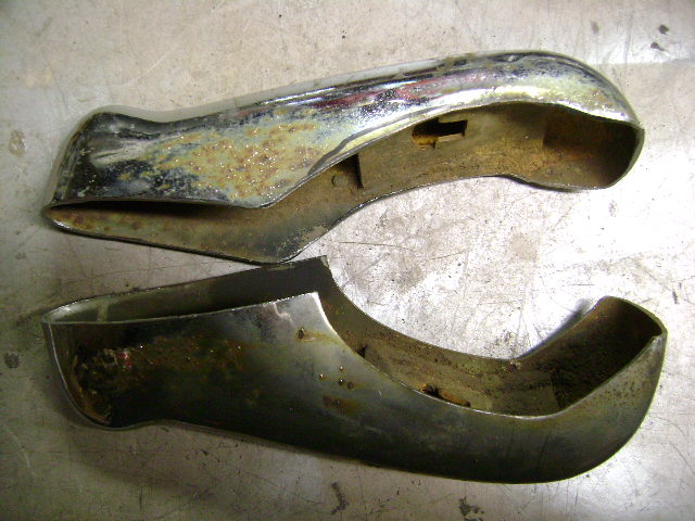

    While is was looking for bumper brackets, I found a pair of bumper guards that looked like they might work. I think they were off of a '55-'57 Ford car but don't remember for sure.
    You can see how the top one was modified some. I cut off some of the bottom end and ground it to better match the contour of the bumper.
  10. LowKat
    Joined: Nov 29, 2005
    Posts: 10,015
    LowKat
    So got the brackets built for the 'fog lights' (really they're turn signals) and got them installed.
    I tripped over a piece of chrome tubing I scavenged from some old clothing racks and made a towel bar for between the bumper guards.
    Drilled a 3/8" hole in the side/top of each guard, made a bushing for inside each end of the tube. Ran a piece of all thread through and put a nut on each end.

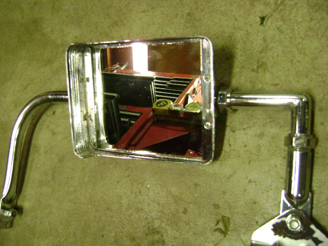

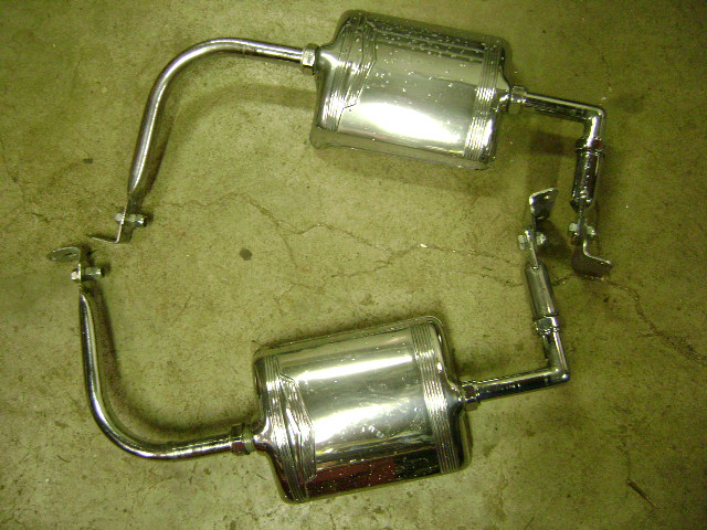

    $5 swap meet door mirrors I'm probably gonna use. Truck had 'peep' mirrors on it but you can't see***** out of them. The shape of the cab blocks 1/2 the view. I'll be able to see out of these and will occasionally tow.
    Yea, they have pits n'****s but still shine up and look period correct with deco ribs and hooded lenses.
    Truck had farmer mirrors on it 'back when' with repairs you can see through the 70's paint. New mirrors will cover the old repairs. Gettin' there.......

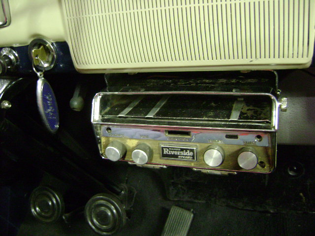

    The 8 track I'm using was also a 4/8 track but I had to loose the switch because it rattled too bad after gutting the machine.
