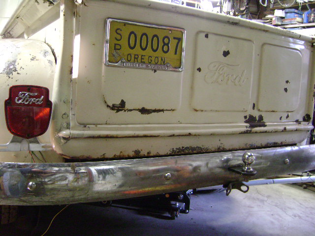

    Took Mrs. Lowkat out this morning so got a late start.
    Got my hitch and bumper mounted. Spare tire carrier (48-52 Chevy) is ready to mount but it'll be in my way right now.

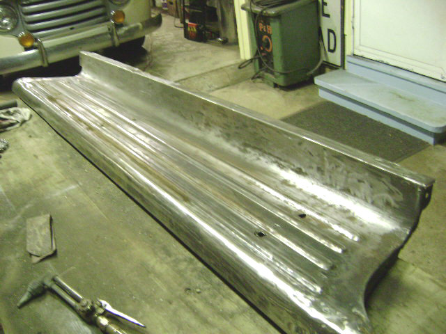

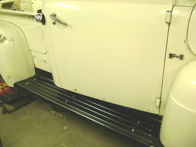

    Did get the running boards off of the driveway parts truck.
    Stripped, painted semi-gloss and got them installed.

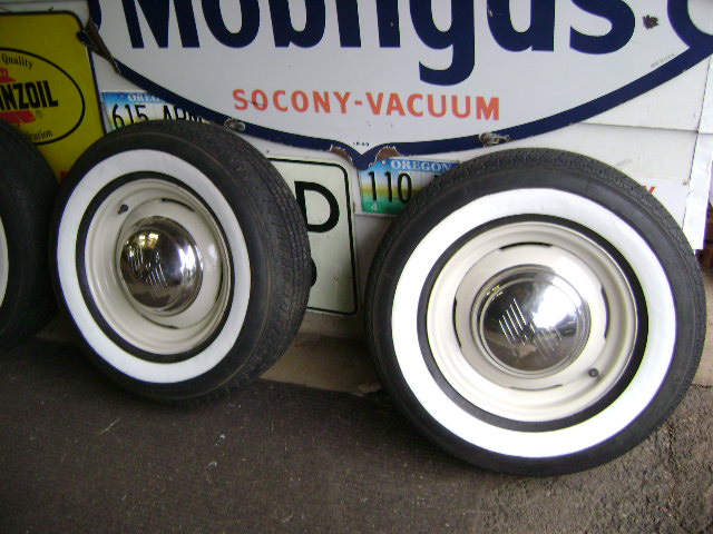

    Marshall 793 all season radials (a cheap tire)
    They were junkyard specials off of this '73 Buick.
    They were one inch whitewalls I sanded to make them wider.
    Took about 20 minutes a tire.
    There's a few threads on the HAMB with instructions.

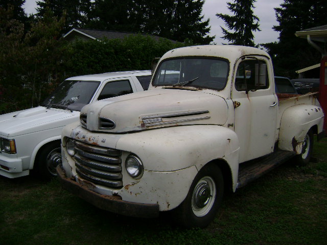

    The last few days I've been cleaning up the parts truck. (#1)
    Probably gonna send it down the road.
    BEFORE:
    AFTER:
    BEFORE:
    AFTER:
    BEFORE:
    AFTER:
    The engine as found.

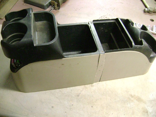

    Stopped by the Goodwill looking for an old patterened wool blanket to use for a seat cover. Didn't find that but did find one ($3.99) that matches my door panels better than the Ranger seat does.
    Picked up a huge aftermarket console at the wrecking yard so I can have a cup holder. Gotta have tunes and icy beverages on those road trips you know.
    Anyways, I cut it in half, turned it around backwards and most of it slides under the seat. I'll make it look pretty later.

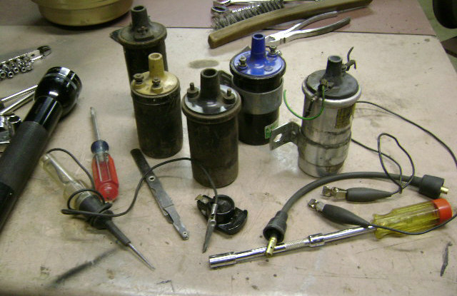

    Went to start the engine last night but couldn't get spark.
    I just had this thing running great a couple months ago.
    BUT....... installed a complete used wiring harness since.
    Get out the remote starter switch, test light, drop light,
    jumper wires and start troubleshooting.
    Maybe I made a mistake on the starting circut for the coil.
    Disconnected the 'new' wiring from the coil.
    Hot wired coil direct from the battery... nothing.
    It has a Bosch coil and I've never had one fail.
    Tried a couple different coils anyway... nothing.
    Pulled the distributor cap.
    Metal tang on top of the rotor was bent to ****???
    Went out pulled the rotor off of the parts truck,
    installed.... still nothing.
    Finally gave-up for the night....
    and took a photo of the 'tools of frustration'
    This morning I figure I'll try the coil/distributor wire first.
    Pull the petrified coil wire (an old wire core one) off the
    parts truck, install.... VROOOM!
    Reattached the 'new' wiring and it works perfect.
    Engine started with the key switch...
    First time in 29 yrs.
