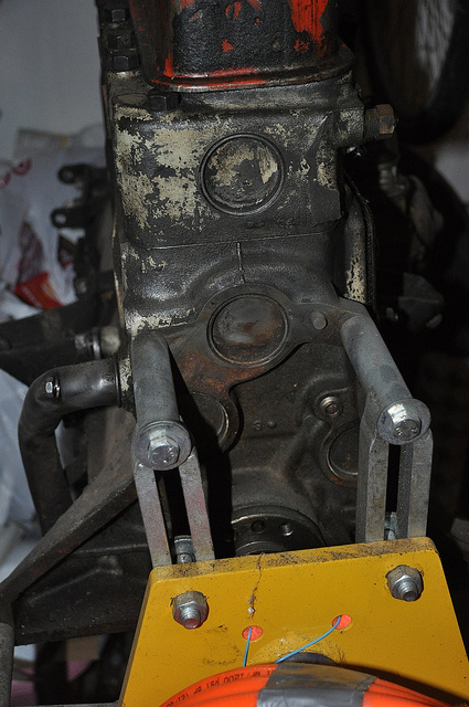

    got the motor pulled over the weekend.

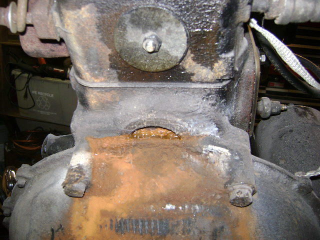

    Here's the problem.
    Will be replacing all the frost plugs with brass.
    It needs a clutch too so I'll get that installed.
    This should keep me busy for a couple days anyways.

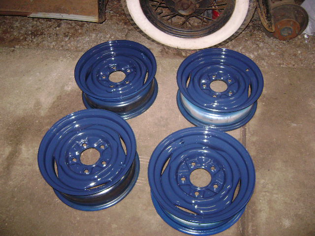

    I had some 1957-1964 steel wheels. Two of them are 5-1/2" wide and two are 6" wide. Got them cleaned up and rattle-canned the same dark blue as the interior of the truck. The color is actually Navy Blue and darker than the photo shows. The camera flash washed the color out.
    I also had a set of "driver" 1955 Ford car hubcaps I bought at the Portland swap meet last april for $5.
    Last night I sanded some junkyard tires to make wide whites for it.
