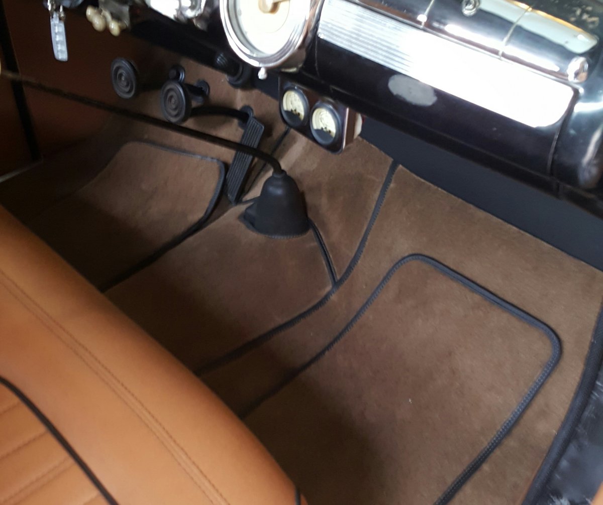

    old interior.jpg oldinterior 2.jpg new backseat.jpg new interior.jpg Forgot to update the interior pics on here ( yeah - I kinda did this fat girl outta order oh well...)
    replaced the floors aft of the toe board and had my good friend do the interior - after some horse trading for some welding work I did...

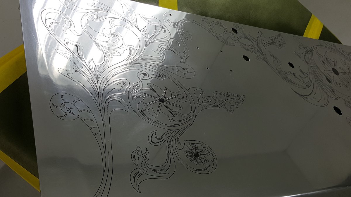

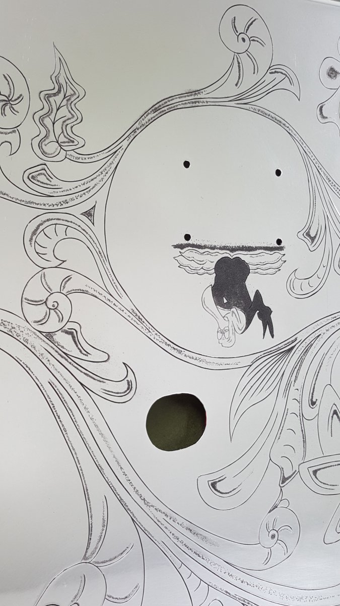

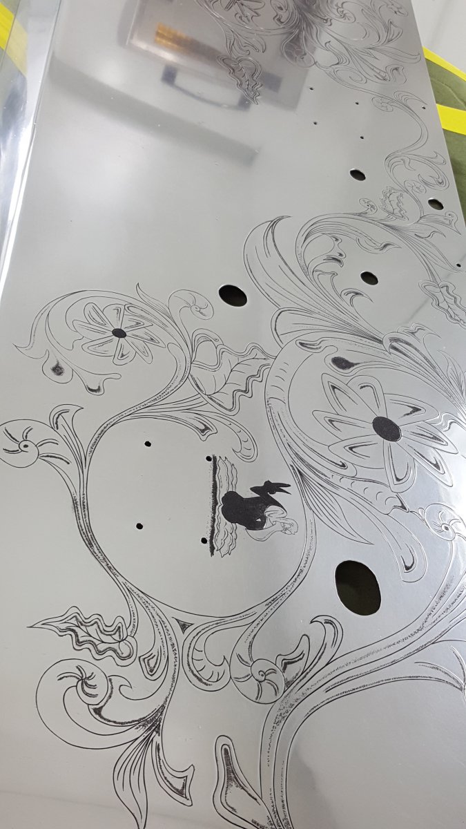

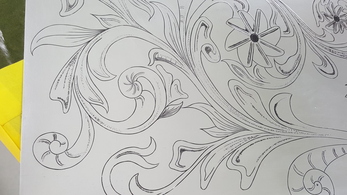

    fabbed up an aluminum firewall - after marking it up and locating a few things, had my friend engrave it in the theme of an 1890's Visalia Saddle - and I had to add my Buzzard - he's on my boat and now this!
    It's still wet - just cleared it and it's in the booth til tomorrow and I'll try to install it and stab the motor!

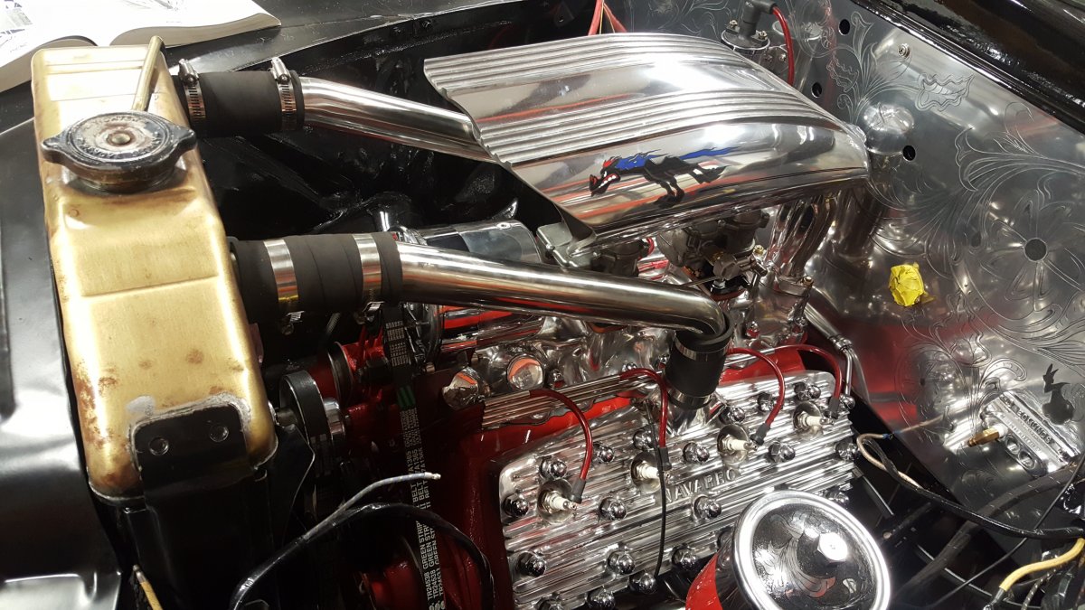

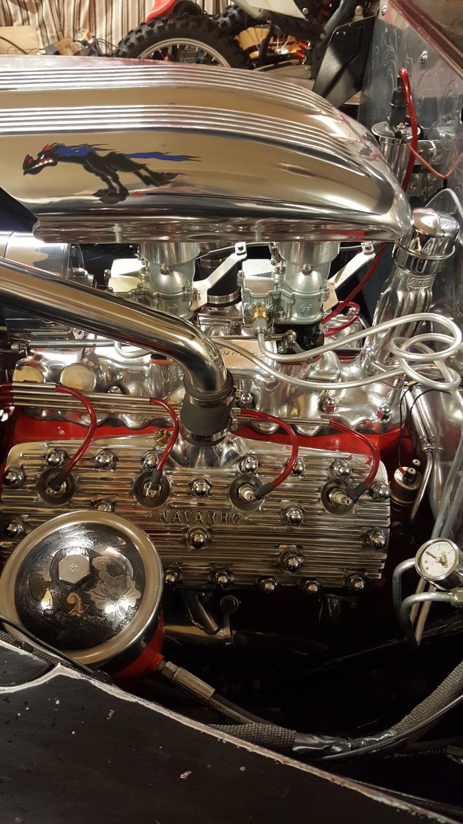

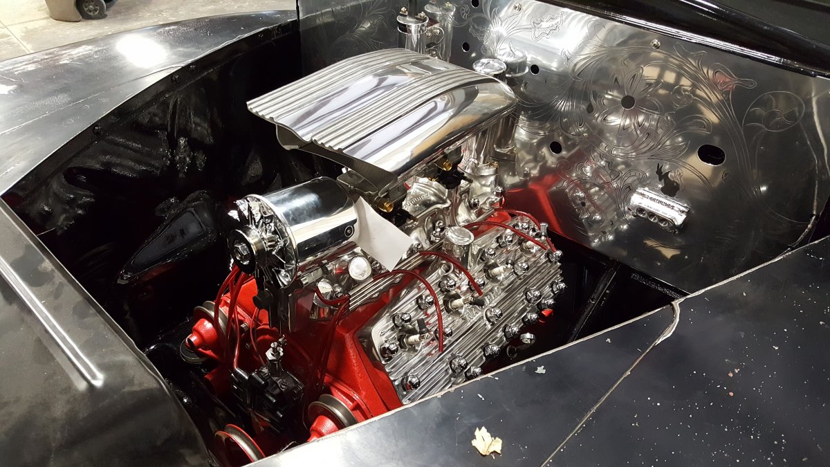

    Stabbed the motor today!!! Now the hard part - Wiring and other magical and mysterious to me things! stance in.jpg in.jpg in2.jpg

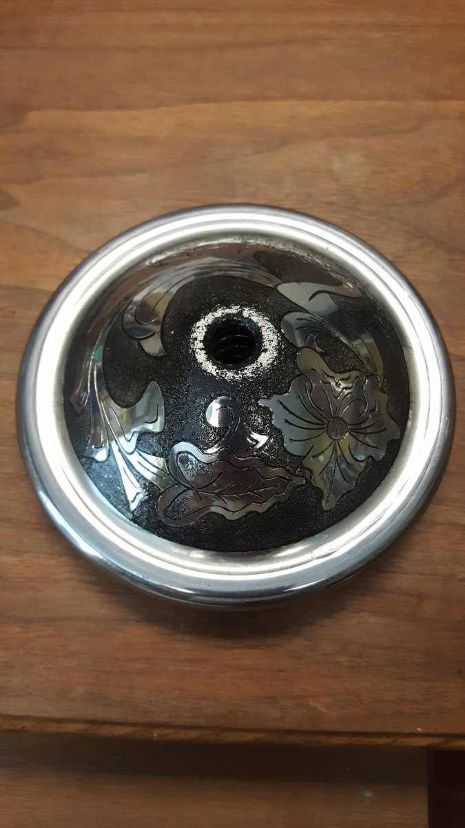

    20161201_143046.jpg 20161201_143022.jpg got my oil canister lid back from my buddy who did it up to match the firewall...just cleared it a few min ago!

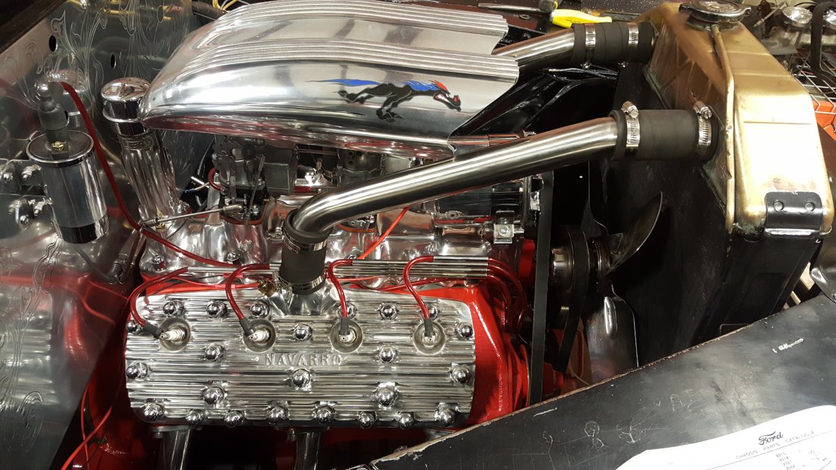

    Exhaust, minor wiring and add oil and we should be good for a break in run!

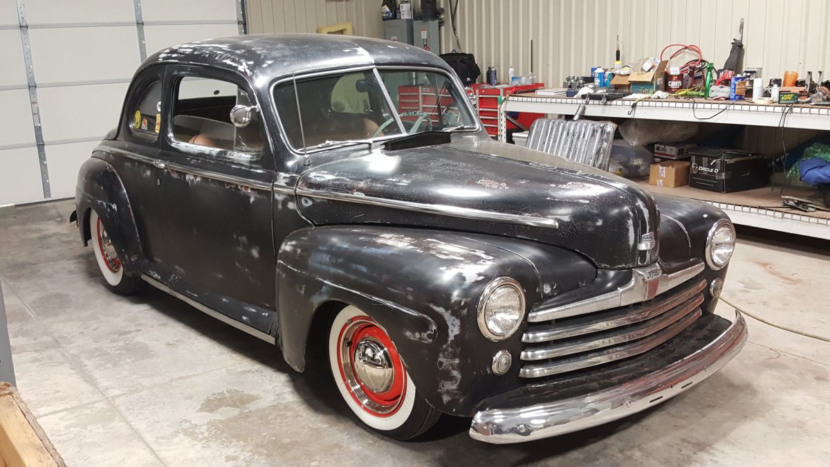

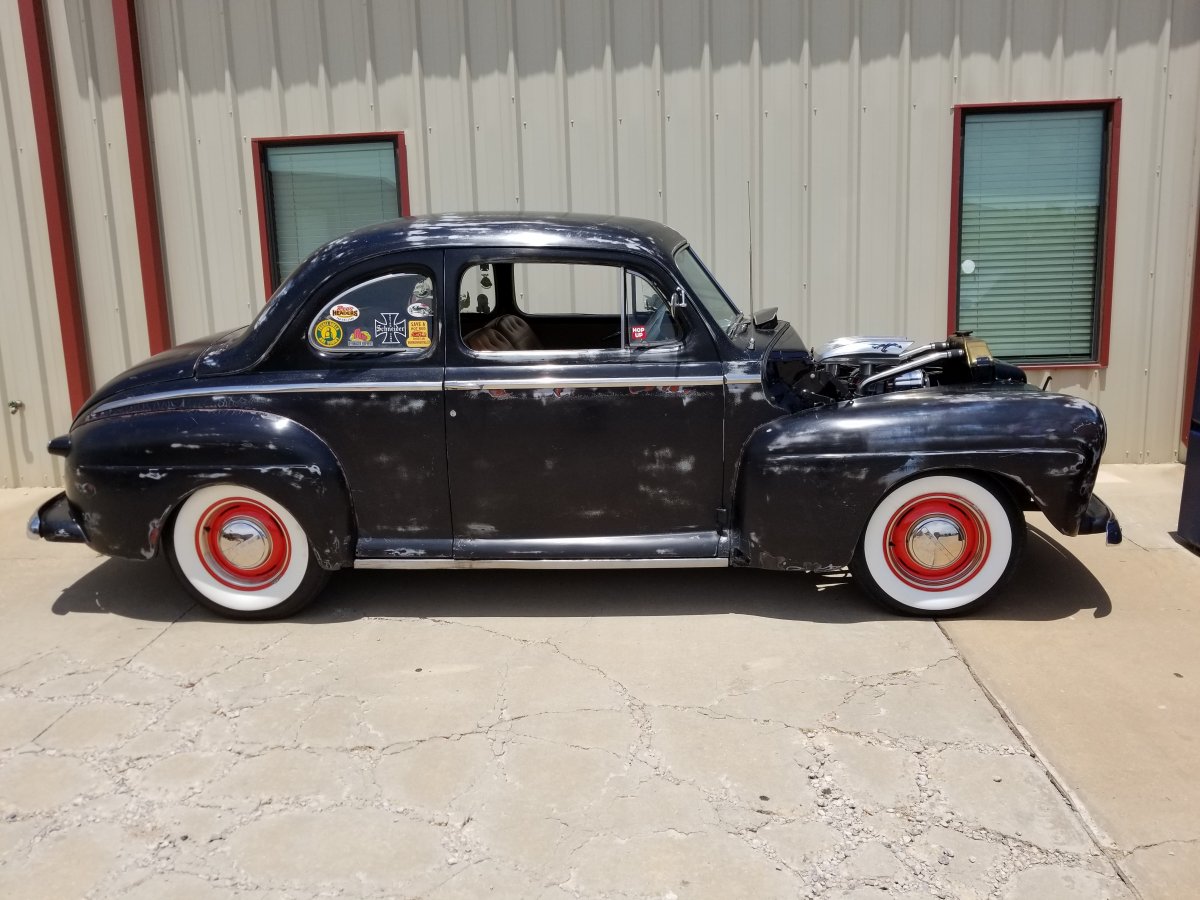

    20170323_160749.jpg 20170422_225019.jpg 20170422_184049.jpg A year later....carpets in and done...
    Firewall all tidy inside...new..NEW genuine Strombergs on... and it drives reliably, eats the hell outta gas and hasn't made me walk or call for help in a couple weeks!
