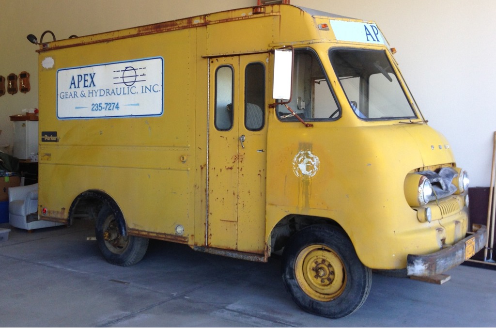

    It's a step van carrys a P35 vin #. I just love the big F series fords. ImageUploadedByH.A.M.B.1390520403.957502.jpg
    brEad likes this.
  7. OahuEli
    Joined: Dec 27, 2008
    Posts: 5,243
    OahuEli
    from Hawaii
    God those things are ugly! I love 'em!:D

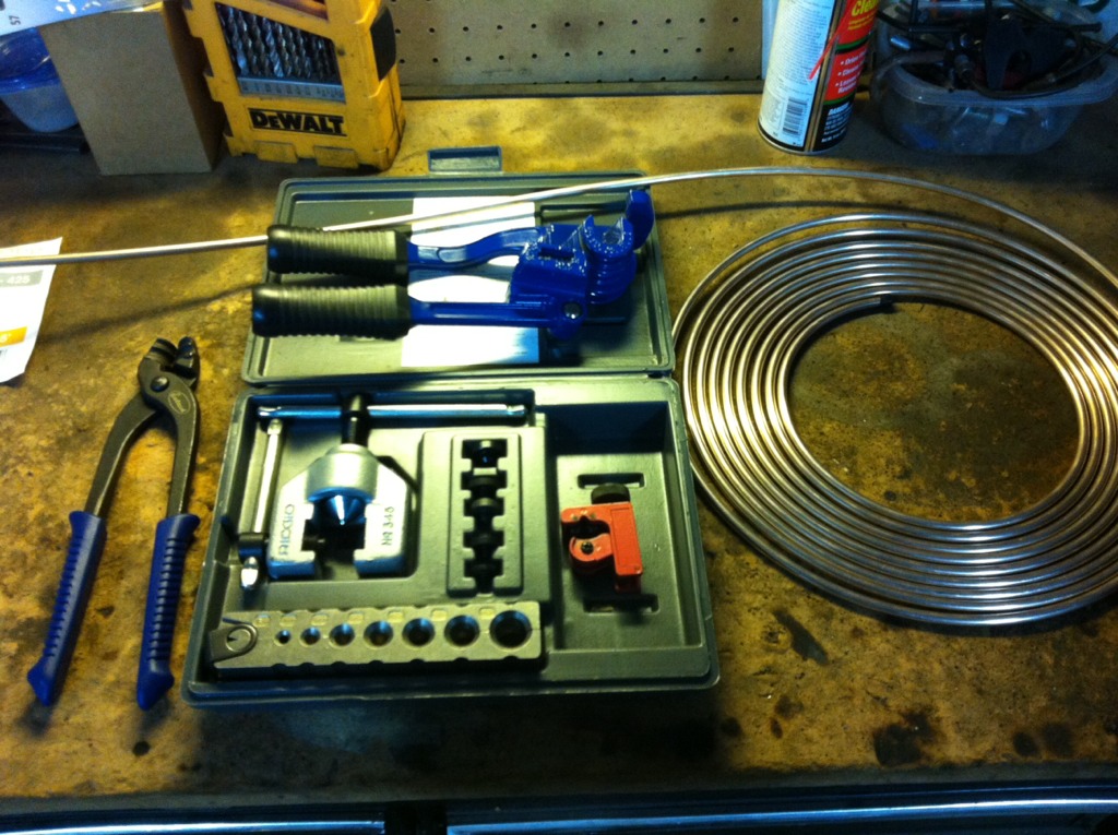

  8. It's time, time for brake lines!!
    - NiCopp brake line? Check
    - tubing bender? Check
    - brake line tool? Check
    - tubing cutter? Check
    - Rigid flaring tool? Check
    - homemade tubing straightener? Check
    Now let the fun begin!
    brEad likes this.
  9. LOL!! I agree Eli, that P35 is strange but oh so cool!!
  10. So where did you find this truck and what are you going to do with it? I've never seen one before. Thank you for posting a pic of it.
  11. alaska 53
    Joined: Sep 3, 2012
    Posts: 68
    alaska 53
    Yep they are odd but pretty cool. No ideas yet which way I will build it. Most likely lowered keep it stock other then that. Hard to find parts.
  12. alaska 53
    Joined: Sep 3, 2012
    Posts: 68
    alaska 53
    It once belong to the FAA government ordered. I am the 3 rd owner it has 16k miles on it from what I can tell from wear on stuff and paper work that's original mileage.
    I have yet seen another one. No real ideas yet on the build yet.
