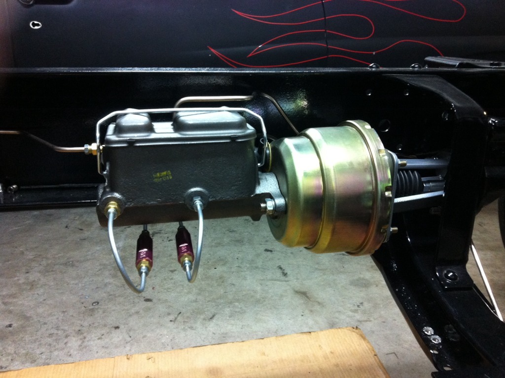

  2. Had a pretty successful couple of days. I filled the rear end with gear lube, acquired another master cylinder, have all but one brake line done (ran out of time), power washed the motor, removed the accessory drives from the motor, and got a few other little odds and ends done.
    My goal for next week is to have the brake system bled and leak checked. Crossing my fingers that all of my flares are leak free!
  3. Brake lines done!

    Posts: 348
    Tantank49

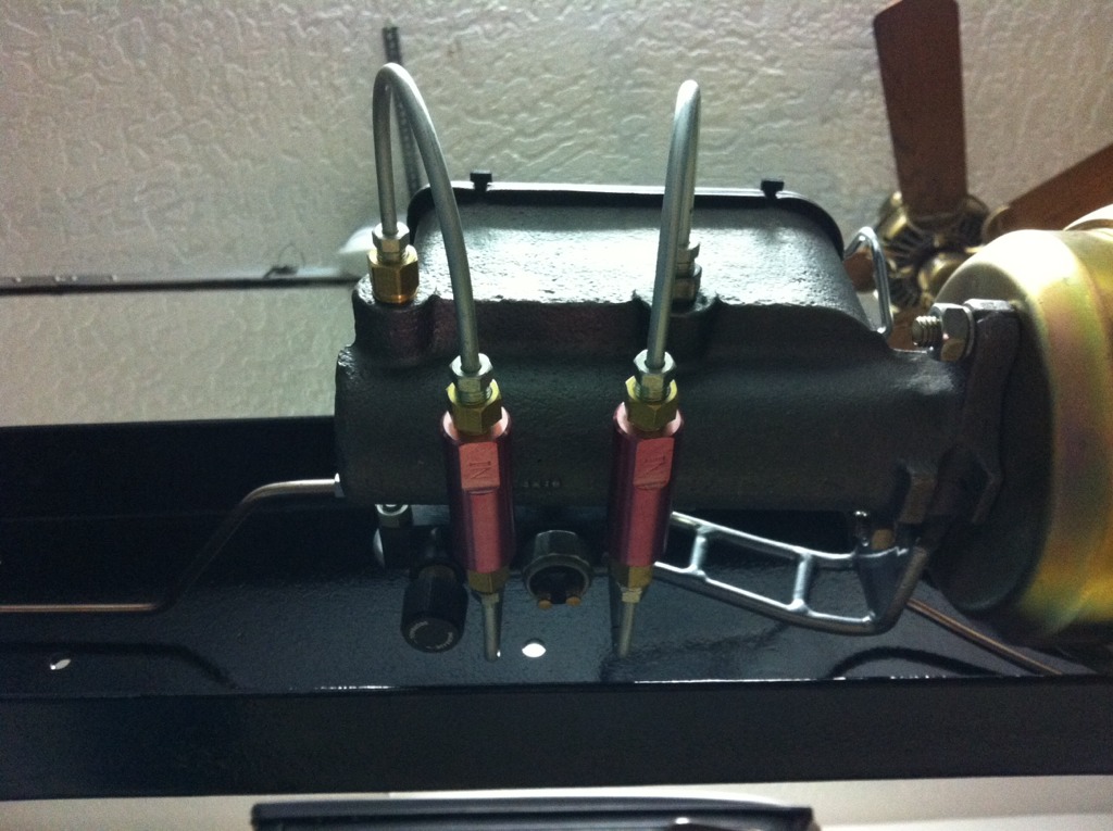

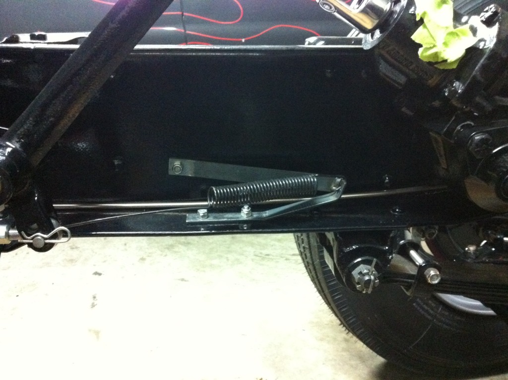

  10. Bench bled the master cylinder and reinstalled it. I haven't tried bleeding the brakes yet, I want to see if any if the master cylinder fittings leak so I'm gonna let it sit and see what happens. In the mean time I made a bracket for the brake pedal return spring. Nothing fancy but I think it will work.
  11. Well, my worst fears realized. Every line coming out of the proportioning valve are leaking. I just don't get it. There is obviously an art to double flares and I ain't got it. All of the flares looked good so I'm just surprised to see them leaking. Well, at least I have patterns for lines.
