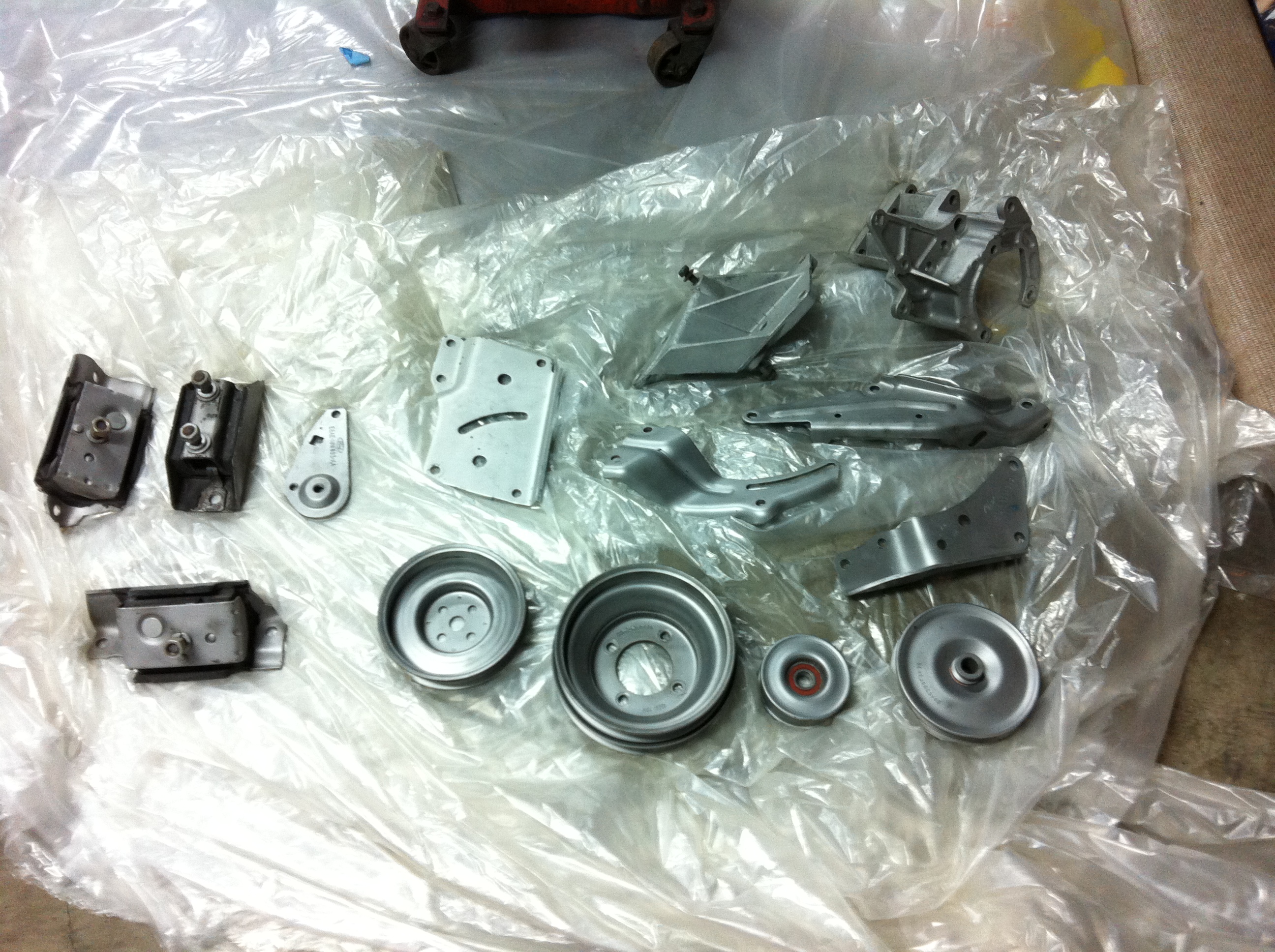

  23. These past few weeks have been very productive for me, I finally have the engine/transmission re-installed in the ch***is! At first I was just going to scuff the engine and transmission and paint them but a couple of things prevented me from doing that: 1) I saw dirt in the input/output fittings of the transmission and 2) the paint on the engine was flaking off in chunks. So, I separated the trans from the motor and took it to actual honest transmission guy here in town. I told him about the dirt and that the trans had been sitting so he cleaned out all of the dirt and installed new front and rear seals. While that was happening I took several days and used every method I knew of to remove the old paint from the engine including the use of a bead blaster at Eglin AFB's Hobby Shop to clean up the timing chain cover, brackets, pulleys and what ever else I could fit inside the blast cabinet. While I had it all apart I replaced all of the seals, timing chain, etc. The motor looks great inside; nice and clean and spins over smoothly. Also, I finally got to set the crowning touch on the engine, its tribute to Hot Rodders of the past. Looking at the pictures below I'm sure you'll be able to tell what I'm talking about. If you can't, I'll give you a hint, fun comes in threes. IMG_1909.JPG IMG_1911.JPG IMG_1914.JPG IMG_1915.JPG IMG_1916.JPG IMG_1928.JPG IMG_1930.JPG IMG_1938.JPG IMG_1943.JPG IMG_1944.JPG It's so great to have yet another milestone in the build. I'll be working on the little things now to finish up the ch***is.
