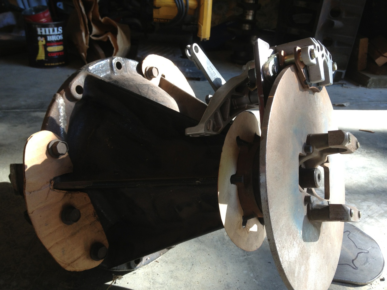

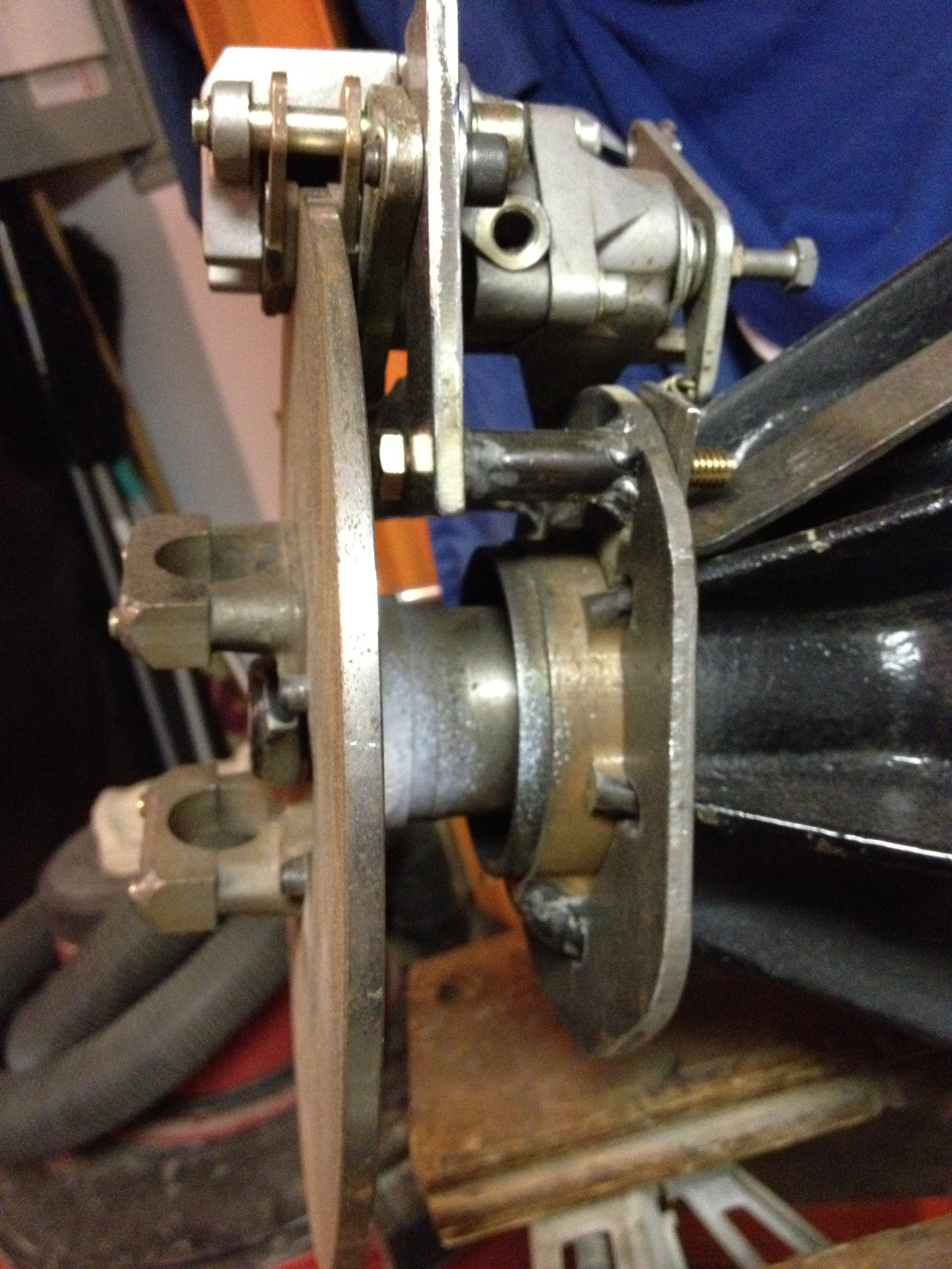

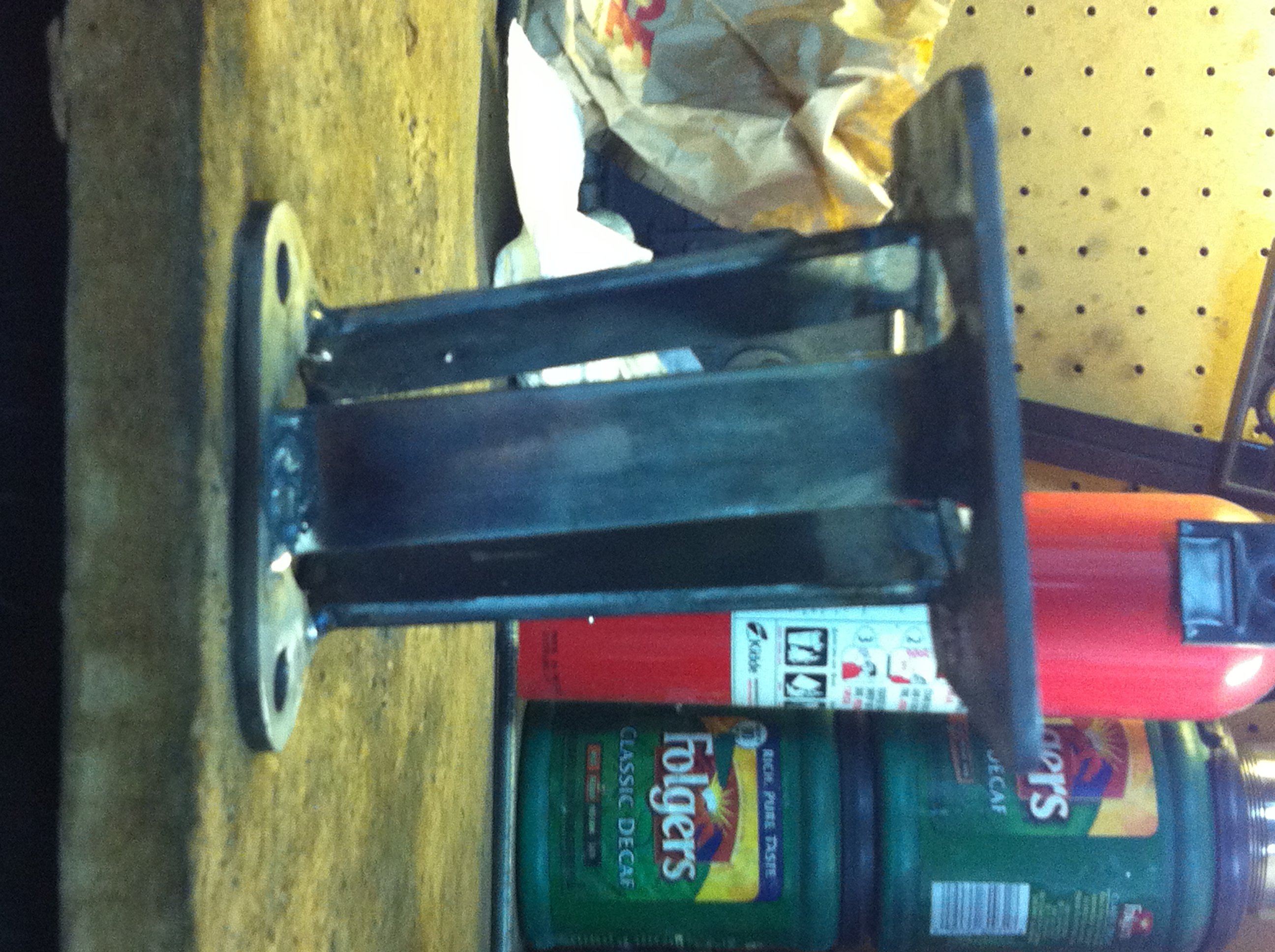

  1. Hivolt, I have about a weekend worth of work to finish off my e-brake bracket, then I'll post some pics and show the results. I've encountered a problem with the new master cylinder and booster, however. If I try to install it inline with the brake pedal, it is too long and will interfere with the trans crossmember. Time to do more hotrod engineering! I'm thinking either a reeeeeal long brake rod between the brake pedal and the booster/master, or angling the combo beneath the driver's seat and actuating with a bell crank.
    I just love your setup, and can't wait to see these F-2 guys' builds, too. Here's to heavy-duty hotrodding. Here's an early shot, before I fabricated the bracket. E-brake on Rockwell ham.jpg

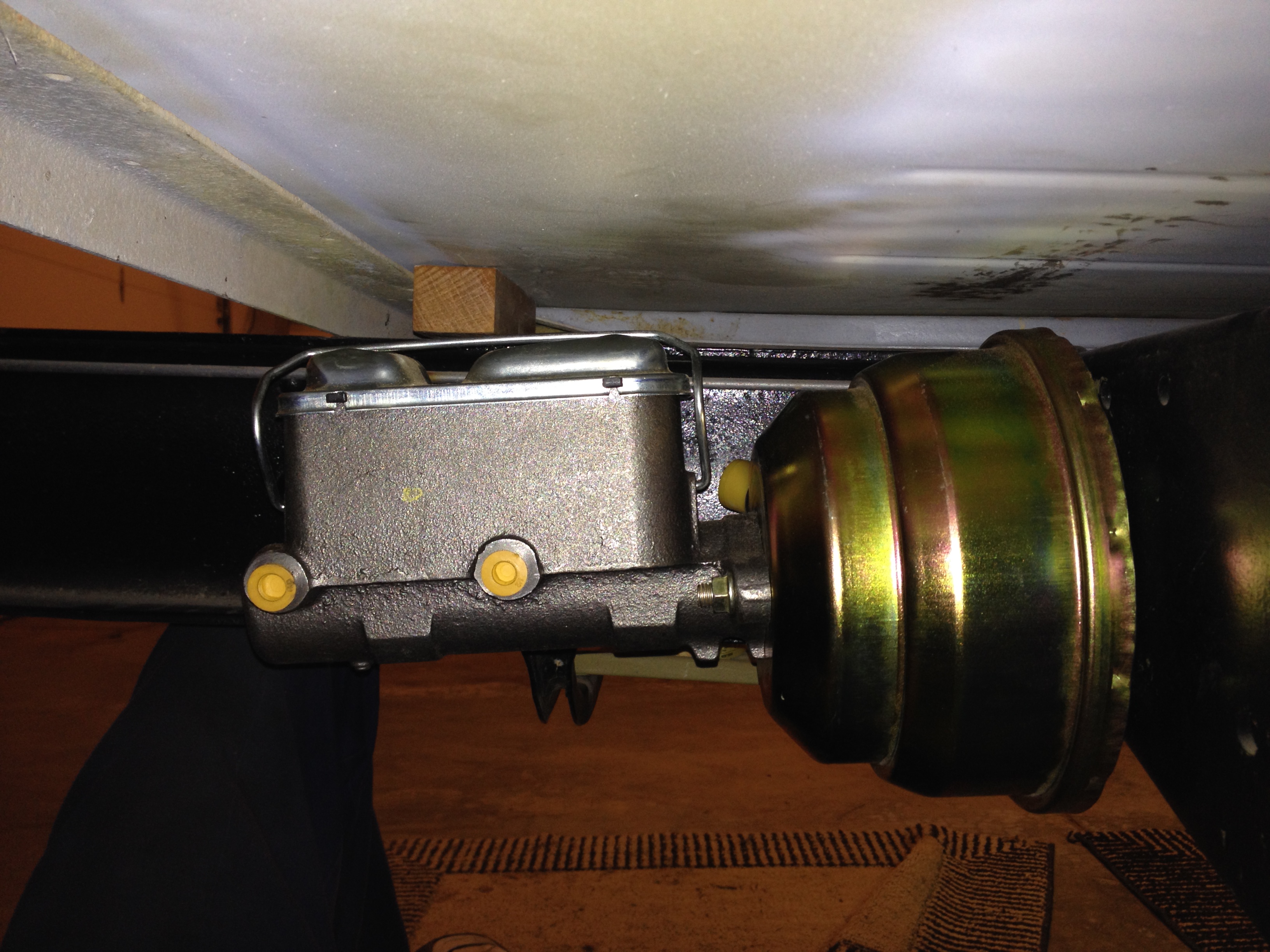

    As you can see, the m/c and booster slant backwards slightly. Potentially a problem?

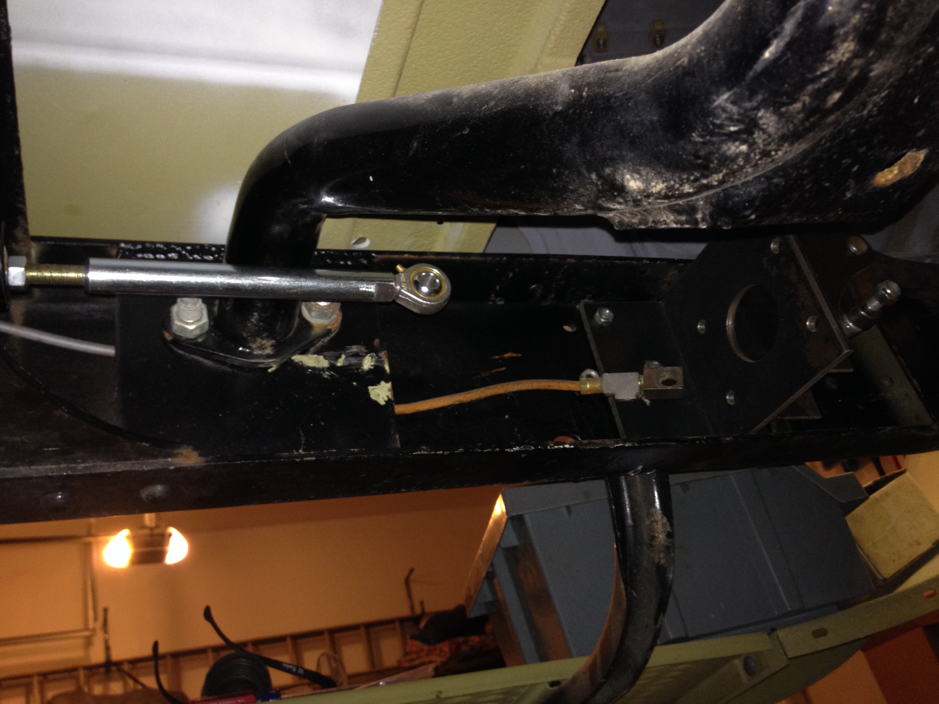

  4. Oops. Somehow I dropped a paragraph before the last note. I mounted the m/c and booster on the crossmember just behind the trans support. You can see in the photos that the shaft just barely (an eighth of an inch clearance) misses the trans mount, but the new shaft from the brake pedal to the booster will have to be about 22 inches instead of that 6-inch shaft shown to illustrate clearance at the trans mount. Also, the m/c and booster slant slightly downward. Potential problem? I can shim it, but would prefer not to. Also will have to cut a hole in the floor at the back of the cab to access m/c reservoir. Don't see that as a problem.

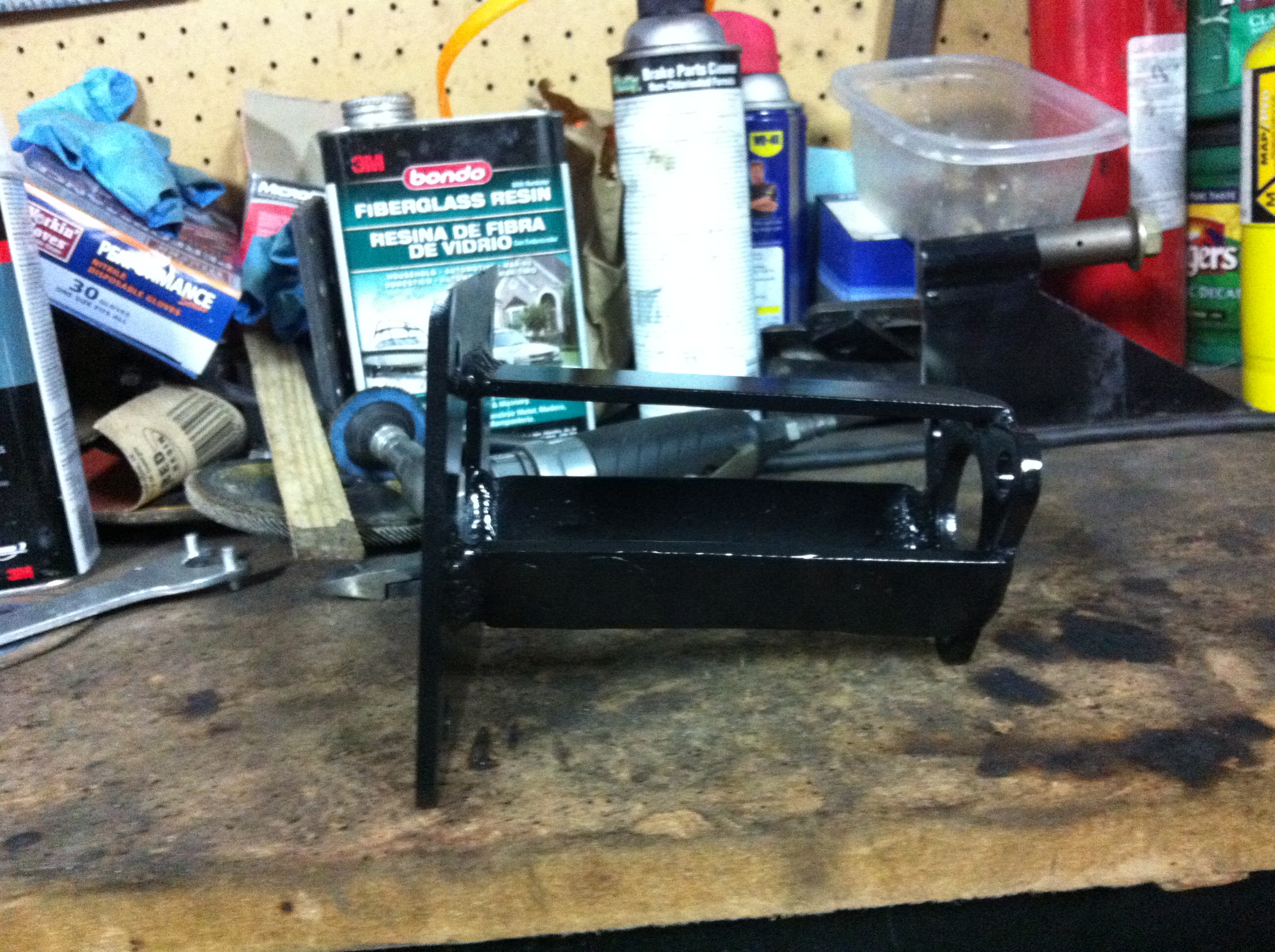

  5. Also, here are some shots of the finished e-brake. Decided not to make the "ears" at the back of the differential housing. Instead using three straps. All they really do is hold the bracket with the star cutout tightly into the web ribs of the differential housing, so no need to be quarter-inch steel plate, just strong enough to hold the "star" bracket in place. 210.JPG 211.JPG

  6. Hey Osage, the work is looking good! Now I see what you mean about not having clearance for the MC/Booster and I think your solution is as good as any unless you do away with the power booster. As for the slight tilt, I don't think it will be a problem. I actually encountered a similar situation when mounting the MC/Booster on the F4. In order for the booster to clear the frame rail I had to tilt it toward the center.
    Once everything was mounted I "cycled" the brake pedal to watch the actuation of the rod on the booster to make sure it didn't bind and it all works smoothly on mine. That being said, once you get the pedal rod to length cycle it through the motion and see how well it works. That's my $.02.

    For the e-brake, you'll have to start marketing that fixture! I like it a lot. I like how you've used the third member and made your brackets to work with it. Looks like either the "ears" or the "tabs" would work well. I wouldn't think there'd be a lot of stress on it since it is "just" an e-brake; meaning it isn't having to endure the forces a brake would when trying to stop a moving vehicle. Great job!

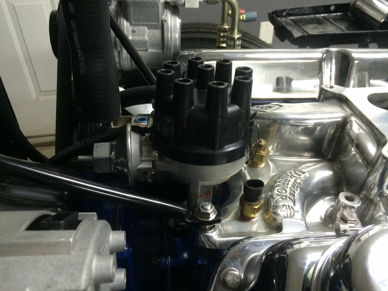

    Thank you osage. As I mentioned above the manifold is a standard four barrel manifold with an adapter on it so you could always go that route too for three deuces. The only problem I have at the moment is with the distributor. This is a duraspark distributor that was in the motor when I got the truck but it is all rusty from sitting. As you can see, with the newer style distributor cap it won't let the adapter mount as it should.
    So I put a one inch spacer on the manifold and it allows the adapter to "fit" but it hits the distributor.
    I ordered a new distributor, the older smaller cap style, which came in yesterday so I plan on putting it in to see how much room I have. If it works then all I'll need to do is swap the distributor gear from cast iron to steel or bronze in order to be compatible with the roller cam.

  21. Osage, Cowboy: your comment about putting the smaller cap/rotor on the distributor I already had would definitely work but as you can see in the pic above the vacuum advance is all rusted up as are some of the components in the distributor, plus the drive gear is cast iron which wouldn't work with the roller cam and the cost of changing just the vacuum advance and distro gear was almost as much as getting a brand new distributor with the correct gear so that's what I did. Oh, and the smaller cap provides the needed space just as you suggested. I worked at installing the new distributor last night but for the life of me I can't get the oil pump drive shaft to line up with the distributor such that the rotor is pointing in the right direction. I'm not sure what I'm doing wrong but I fiddled with that thing for 2 hours last night and it either wouldn't seat down at all or the rotor would end up in the wrong spot.
    As for the coil, I picked up a chrome MSD coil from an auto parts store so I wouldn't think it's output would be too crazy.

  23. Got the distributor fully seated last night. I ended up using a socket on a long extension and turned the oil pump shaft a little bit. Put the distributor in and it dropped right down where it was supposed to be.

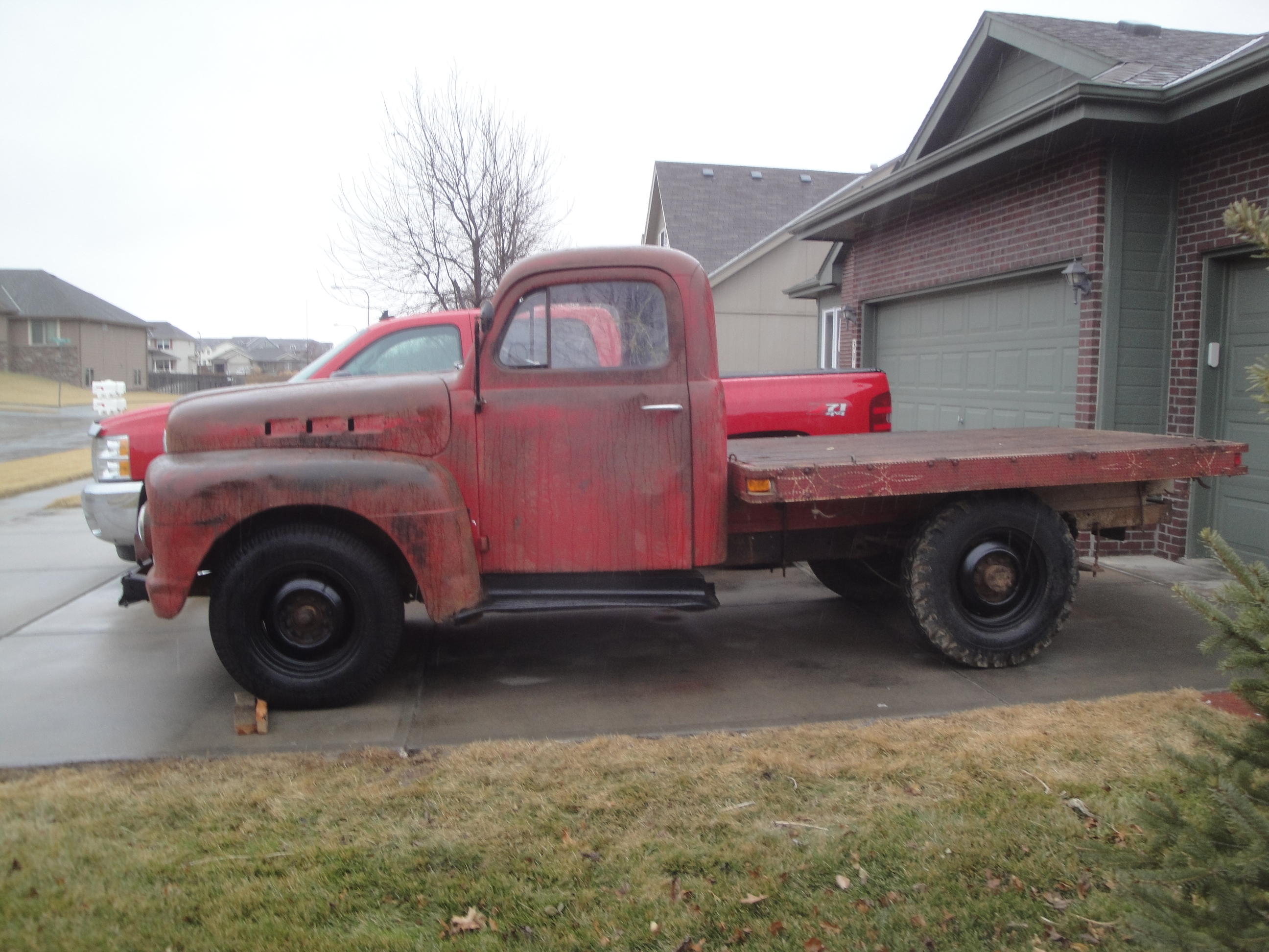

    Subscribed. Buddy of mine is redoing his grandfather's-from-new 1344.JPG '51 F3 flatbed farm truck with 65K miles on the cheap - kept the flathead V8, punched out a frozen piston then replaced with new pistons/rings/bearings, not doing much more than redoing mechanicals (brakes), cleaning up, repainting/refinishing. Runs straight pipes up through flatbed behind the cab, trying to talk him into building low-profile open stakebed sides to replace the stock rack box that it was wearing. He's patiently looking for a cheap set of wheels to replace the 17-inch widow-makers. So what are the rims you're running off of so that I can put him on the right direction?
  26. Yutan, your friend's F3 looks great and I wish him the best of luck with it. Great story behind it too being that his Grandfather bought it new. I'd be more than happy to share any lessons learned. As for the widow makers, this web site provided me with some great info on replacement rims for the F4. http://www.fatfenderedtrucks.com/widowmaker.html

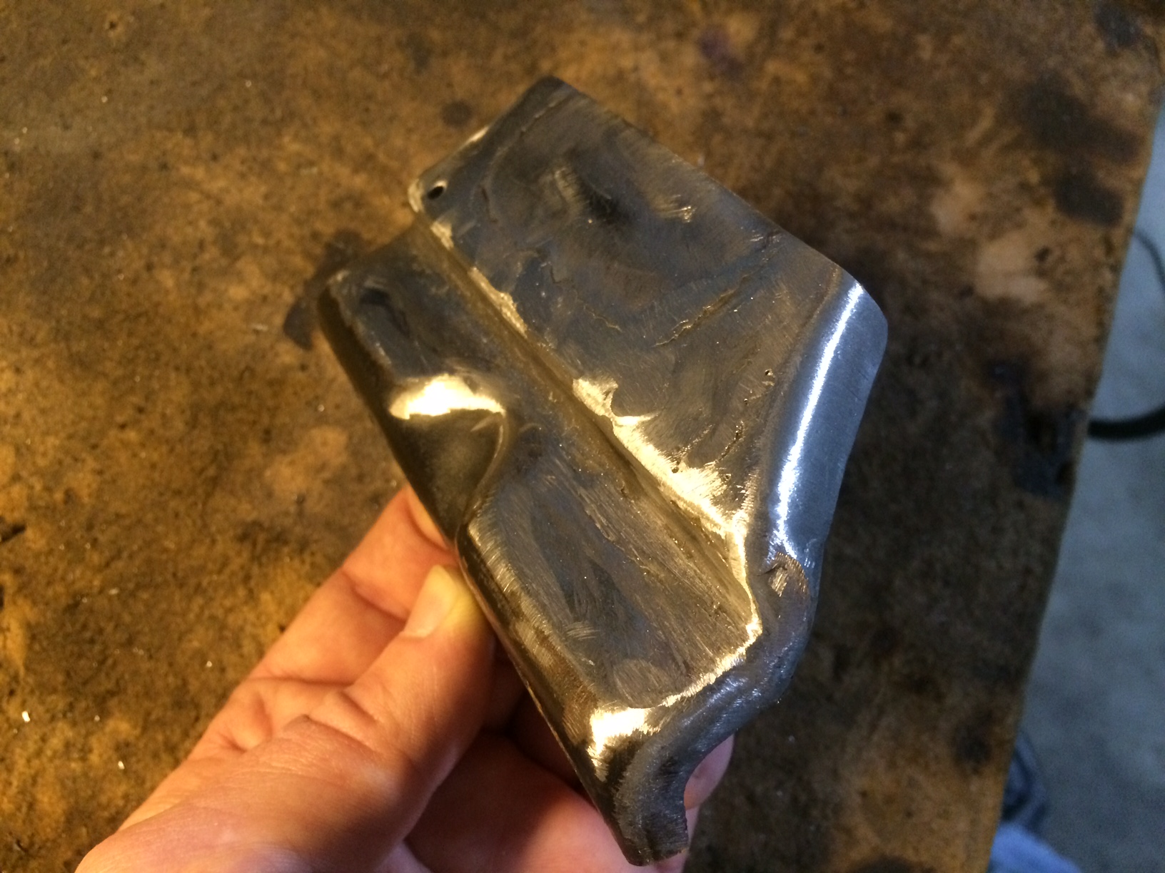

  30. I finished up the coil mount bracket last night, though I do need to paint it now. Anyway, the engine was fuel injected originally so it had one of those Ford square coils mounted off of the AC bracket. Since I'm going to be using a 'normal' cylindrical coil I decided to see if I could modify the stock coil mount. This is what I came up with. It isn't too pretty and my welding is more functional and not art like some of you guys who can 'dime stack' your welds. I have to admit, the bracket has been hot rodded as it's been chopped, sectioned and channeled! haha
    side view of the original square coil bracket. Sorry I didn't get a front view.
    At this point I've laid down the part where to original coil mounted and cut half of it off. Also, I've marked where I'm gong to section the bracket.
    Sectioning complete.
    New side view.
    Sorry the pic us upside down, but here the new coil is mounted to the bracket.
    And mounted on the AC bracket.
    I need to shave a little bit of metal off between the heater hose and bracket but for the most part I think it will work fine.
    Oops, got one out of order, here's the other side of the modified bracket.
