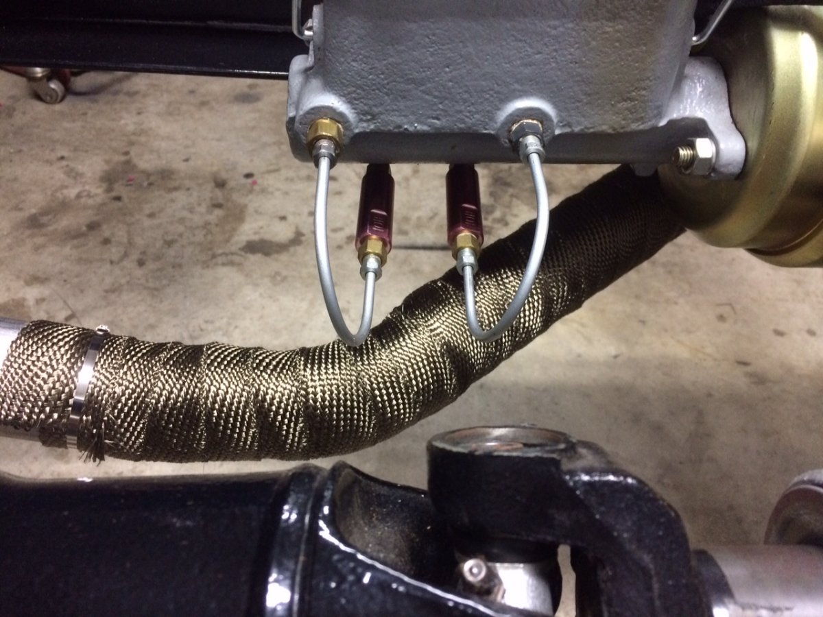

  1. I bought some header wrap the other day and wrapped the AC lines since they run close to the header and I also wrapped the exhaust pipe where it ran under the master cylinder. I'm not sure if that was necessary but I figured it couldn't hurt.
    Next on the list is repairing the running board support mounts. I have the rust perforated portions cut out, now I'm on the hunt for the same thickness metal to repair them.

    Is the exhaust pipe stainless? It's my understanding that the header wrap will hold moisture up against the pipe and rot them out if they're not coated or stainless.
    prefect20 likes this.
  3. Good point, the exhaust pipes are aluminized. Not as good as stainless but better than bare steel.

    I'd hit the wrapped area with some header/exhaust paint. The heat while running will drive moisture out, but apparently the wrap can tend to attract and hold condensation kinda like a blade of gr***.
  5. Ok, thank you for the tip patmanta. I'll get that done. Or would a simple metal heat shield tacked to the exhaust pipe be better? I could form a piece of sheet metal with some standoffs to allow for airflow. My whole point for the exhaust wrap was to ensure the heat didn't affect the brake fluid.

    A heat shield would probably be the ticket. I'd attach it to the frame under the MC rather than the pipes.

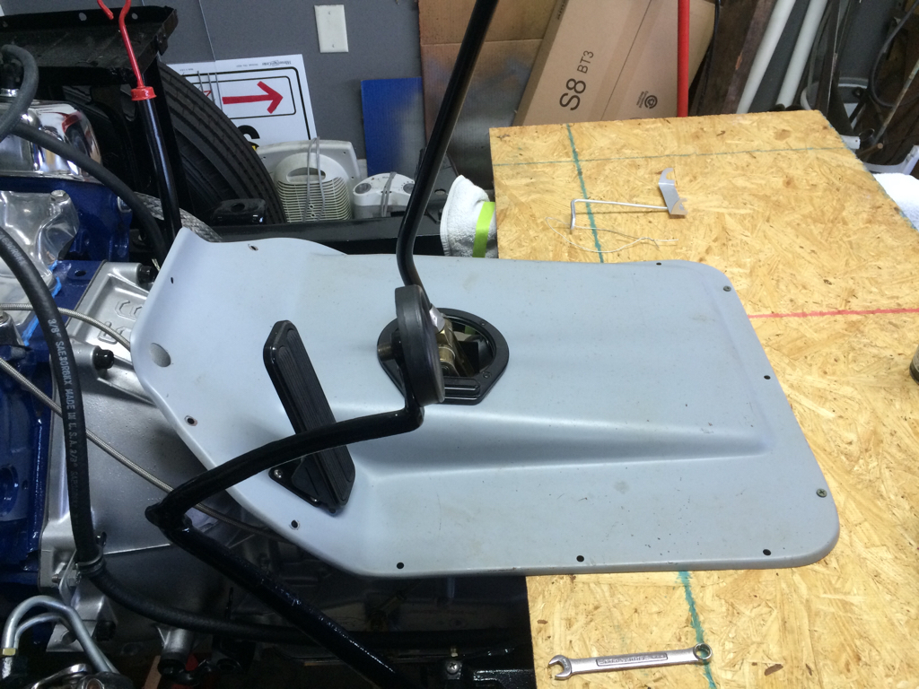

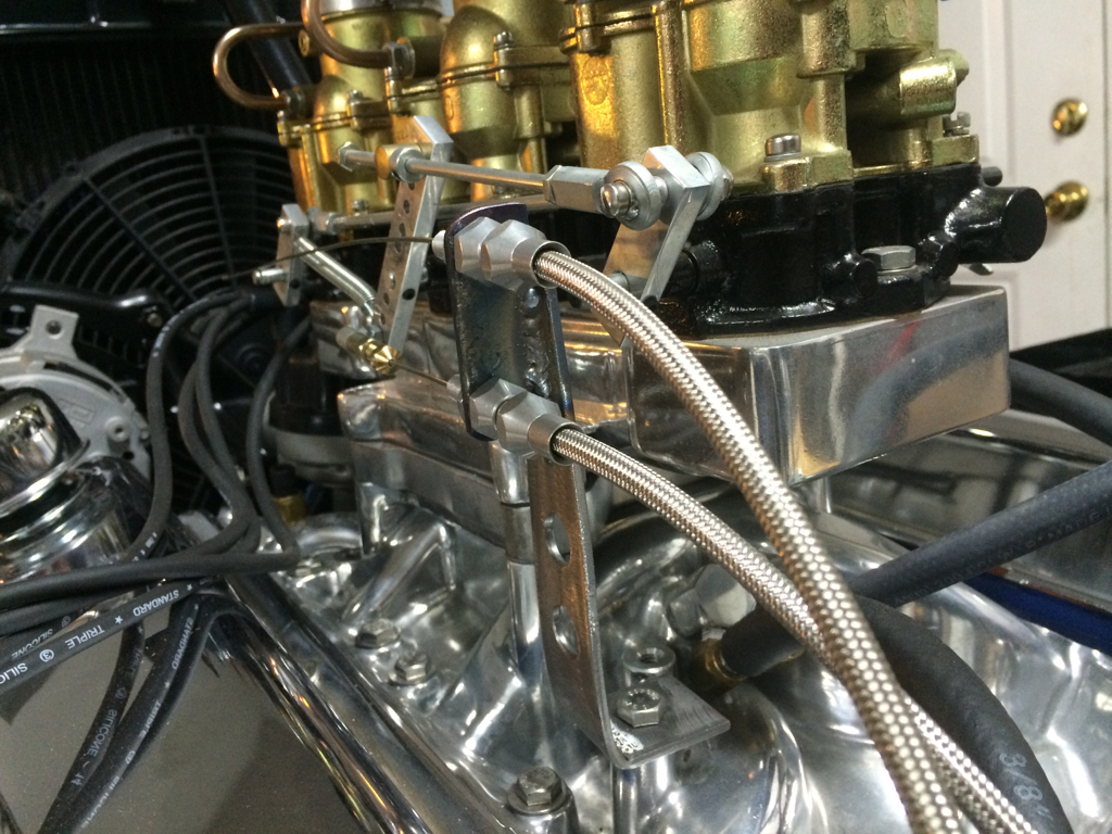

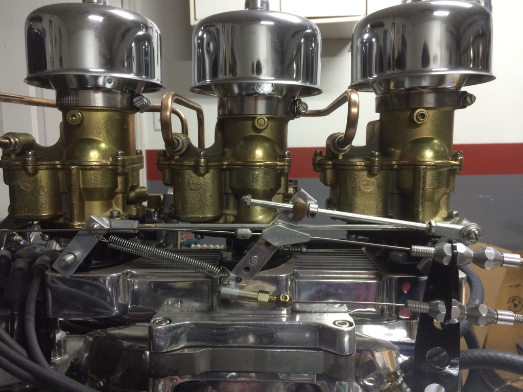

  9. Sorry guys, I know it's been awhile. There's a couple of things I'm trying to think through: 1) getting the throttle linkage worked out and 2) fixing the running board supports.
    Originally I was going to use a single four barrel carb so the Lokar throttle cable and AOD TV cable were set up accordingly. Well, now that I have the three deuces I'm trying to figure out how to use the cables I already have. So I worked several hours the other day slicing and dicing a Lokar cable bracket just to realize what I created won't work.
    Here I mounted the trans tunnel to a board sitting across the frame rails. I did this because the gas pedal is mounted to it.
    It's kind of hard to see the bottom of the gas pedal where the cable attaches.
    And here's what I made only to realize that it won't allow the carb to open fully. I need to figure out a way to run the cables horizontally, obviously. Nice brain fart I had there.

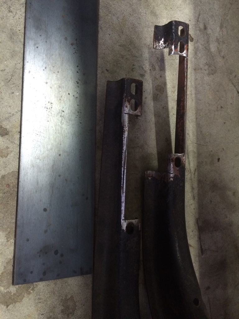

    And here's a pic of the running board supports. Two of the four look like this.
    I cut out the bad portions and I have a piece of 1/8 inch steel to use to fix them but I'm trying to figure out how to bend it. None of the local shops have a bending/brake big enough to bend it.
    I have a portion of a rail road track that has a similar shape to form the bend on. I also have an acetylene torch set up a friend gave me but I don't have it put together yet. I tried a propane torch but it just doesn't get hot enough. I think I just need to get the oxy-acetylene torch set up, heat up the metal and persuade it into shape over the rail road iron.

    Regarding your oxy-acetyline rig, get a good "Rosebud" tip, maybe 3/4" diameter. That will help you spread the heat to form the metal. A couple of vice grips for sheet metal bending might keep the fingers from getting hot and making you say bad words.
  11. Dave, for the length of those patches (I'm guessing 8-10 inches?) and their width, even when you get them red hot, you'll need a 20-ton press to get the bend quickly and evenly, don't you think? I've cut off railroad spike heads and used the shanks welded to track plates to create a press mold for thinner plate steel in my 20-ton press. I'd think with the right amount of heat, you can persuade that 1/8-inch plate to bend in the right profile.

  13. Eli, I was looking the throttle cables last night and I think I've figured out how to do it. In the picture showing the cables, you'll see an allen head bolt sticking up. Well, there are two tapped mounting bosses on the intake, I think I can make a bracket that will mount to those bosses and provide a place to attach the throttle and AOD cable. Time to pull out the construction paper for a template!!
    Osage, with a 20 ton press, do you think I would even need to heat the metal? It's "ONLY" 1/8 inch thick. I hadn't thought of using a press and your comments on the rail road spike used as a press mold is ingenious! Perhaps I could get a piece of solid rod that is the radius I need for the bend and use that to press the metal into shape. Now all I need is a 20 ton press.
  14. Alrighty, I think I got it the throttle and AOD TV cable bracket done. I took a piece of 1/8 inch flat stock and made this. I cycled the throttle pedal and it works great!

    Dave , getting back to the running board dilemma ( unless I missed that you got them figured out) when I have to bend 1/8" plate I cut part way through the plate . Bends much easier , tack it all up , weld it in place everywhere else and then run a bead along the areas that you partially cut through . Hit them with a flap disc and know one would be the wiser ! Later , Andy...

    Andy, I have not fixed the running board supports. I like your thoughts on bending the metal and may try that.
