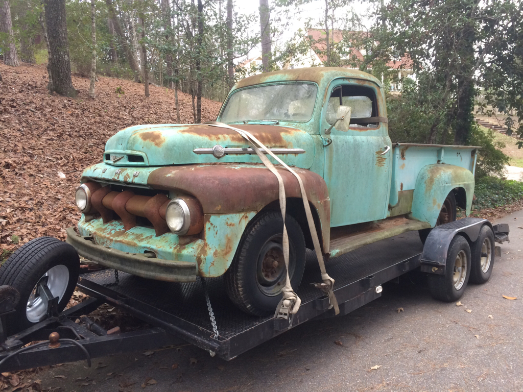

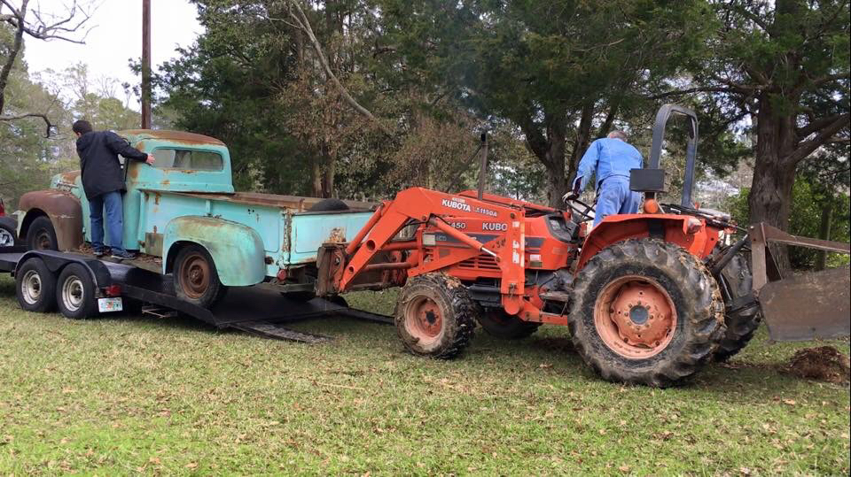

  9. I drove to Mississippi for the weekend to visit my parents and to pick up a 52 F2 parts truck. I've been friends with the gentleman who owned for years so it was great to visit with him and his wife. I even talked my wife into riding up with me! It was great spending the day with her.
    I love it when cl***ic cars follow me home.
    Back at my parents house.

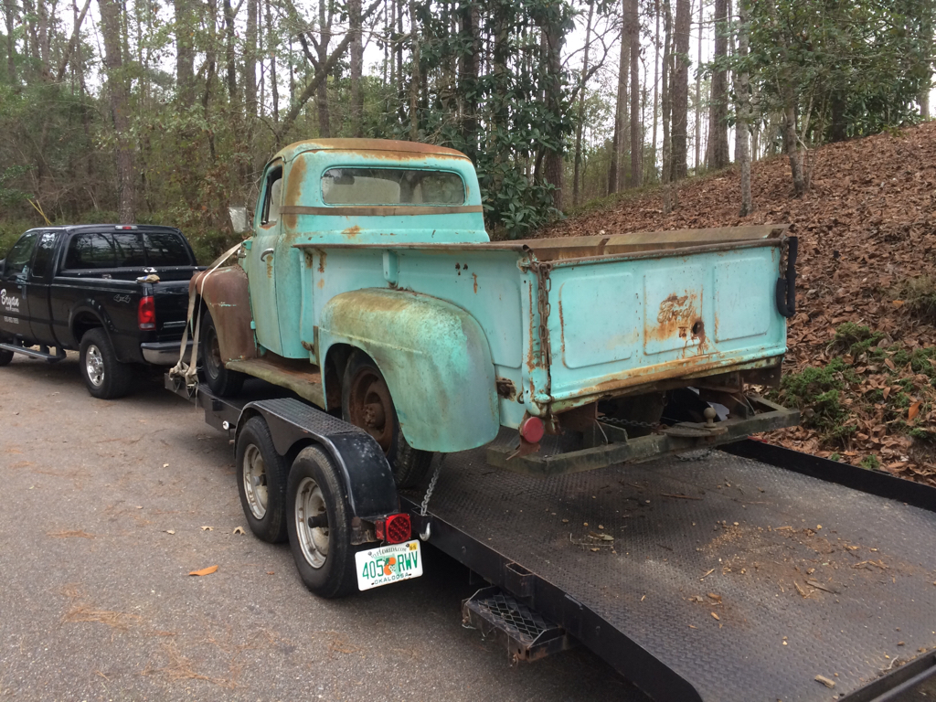

  12. There are several parts that I was missing for the '48 and I was able to get this '52 for less then buying the needed parts individually. I will be using the inner fenders, door opening mechanism, door weather strip clips, cowl vent cover, ashtray mechanism, and what ever else I may need along the way. I also plan to look at the running board support brackets to see if I can use them to repair the ones for the '48.
    I agree it's a stretch to call the '52 a "parts truck" because it is restorable. The bed is the worst part of the body, pretty much the lower 4" of the bed is gone or severely rusted. The only thing holding it to the frame are two badly rusted bolts on the back.

  14. Here's hoping the running board brackets are sound and can save you the effort of repairing your old ones. Best solution of all. Yes, I can see the bottom of the bed looks like it has a CCA patch panel. Those don't weld in too well, do they?
  15. Now I feel bad HOTFR8. For what it's worth, some of the parts I'm taking off of the F2 I'll replace with parts that I have. For example, the inner fenders that I have need a lot of work. A good metal person could fix them but I feel it is beyond my skill, whereas the inner fenders in the F2 are almost perfect. So I'll swap those parts. The same is true for the cowl vent. But for parts like the window channel and door latch mechanism, you're right, the next person would have to source those parts.
    Osage, I was looking at the running board brackets on the F2 last night and they are different than the RB brackets on the F4. Figures, but I may sacrifice one of the F2 RB brackets to save the F4 ones. Yeah, the bottom of the bed is toast. I keep thinking that when I finish the F4, it'd be fun to make a patina'd ride out of the F2 (source a drive train and perhaps some new axles) but I'm not sure how to repair the bed and it still look old.

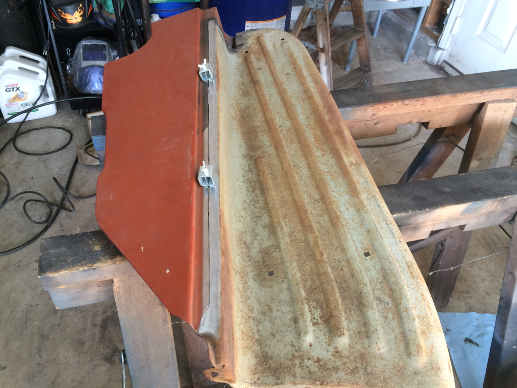

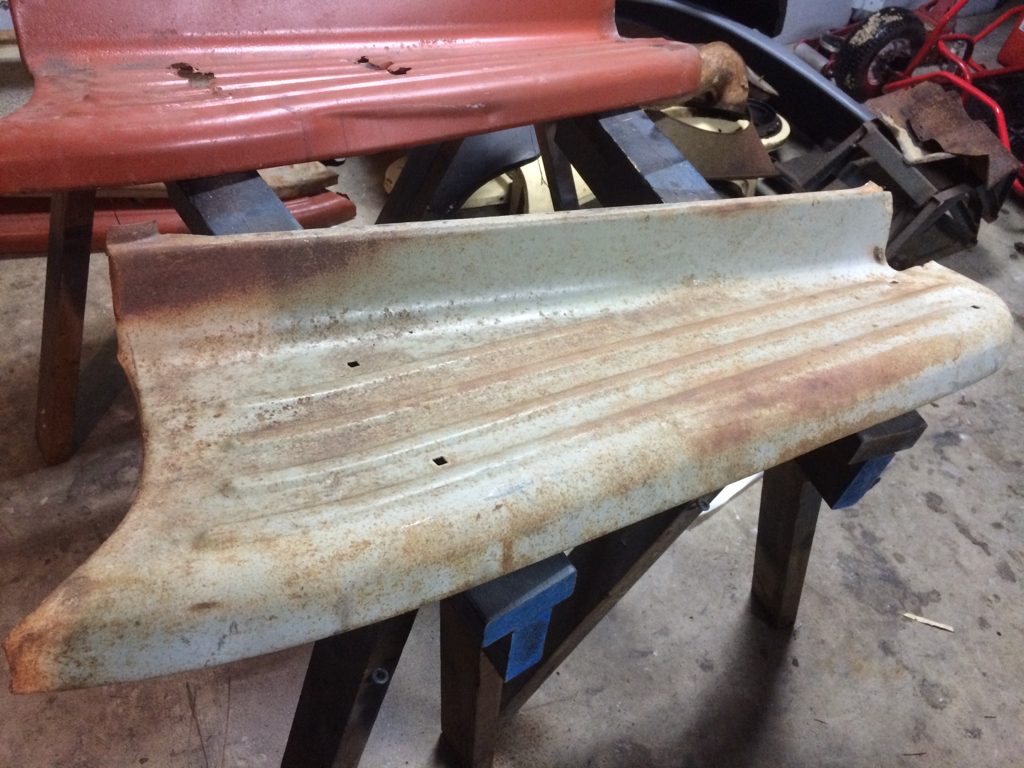

  17. I was able to put in a little work today. A friend of mine came over to help. While it rained this morning we figured out how to repair the running boards. The red oxide primer ones are the original and the silvery ones are from a panel. I think you'll be able to see how we cut them to fit together. I just need to file fit the two pieces and weld together and repeat the process for the other side.

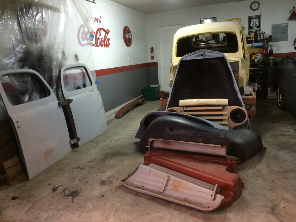

    After lunch and the rain stopped, we took the front clip off the 52 to get the inner fenders. The rusty bolts fought us the whole time.
    And here is some comparison of the inner fenders. Gray ones are what I had, they aren't horrible, but the 52's just have surface rust and not rust holes.

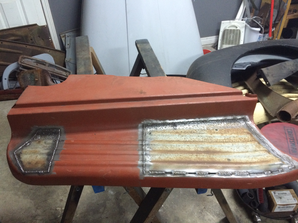

  24. Well, I almost finished up the p***ages side running board before I ran out of Wire and gas for my mig. I ended patching this running board differently than I did the driver's side. The donor running board was in worse shape on the front and back than the original. The pictures tell the tale.
