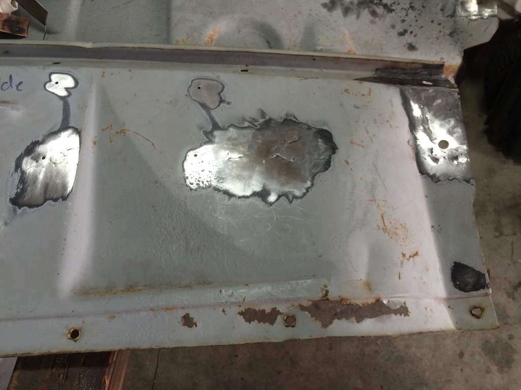

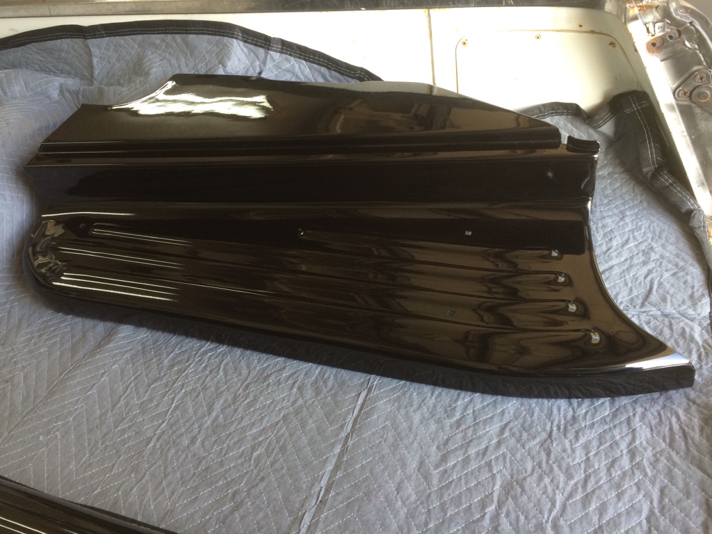

  6. I've been working on repairing the original inner fenders which includes closing up some unused holes and fixing some cracks and rust. Here's the right inner fender. I still have the rust holes at the bottom to fix which includes the repairing the access panel. I'll start on that next.

    Your steps look good Dave . I like the black . Is the cab coming soon ? Don't know if I can pull it off on my car though . Every time I see someone laying down black I try and convince myself I can do it as well !!!

  9. I know what you mean about black. The only thing I've painted on the truck is the axles and they were very forgiving given the fact they are very textured. Knowing out pitted the running boards were even after I repaired the holes, I was very happy with how the painter smoothed them out. The cab should be coming soon, then the doors and the rest of the panels. I'm trying to stay ahead of the painter but being sick all week has put me behind again. The inner fenders are the worst, which is what I'm working on, so once I get those done the rest should be easy(ier).

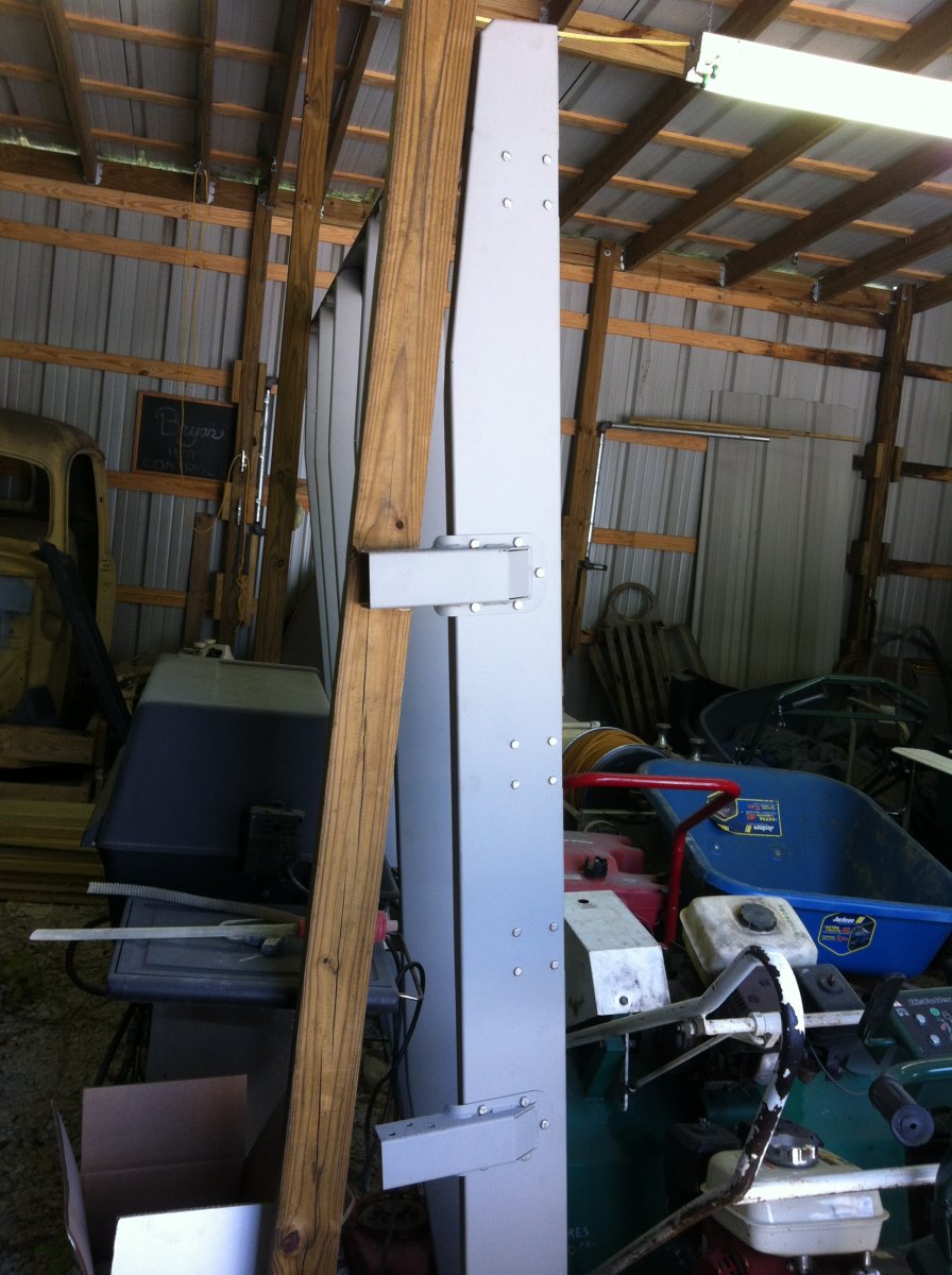

    Here's what's going on the back of the F4, sorry I don't have any better pictures at the moment.
    A guy on the ford-trucks web site created CAD drawings of his original Ford script bed which I got a copy of which was given to metal works shop. I plan on replacing the visible hex head bolts with carriage bolts so they look more like rivets. The bed will be the last thing I tackle because once the bed is on it won't fit in my garage.

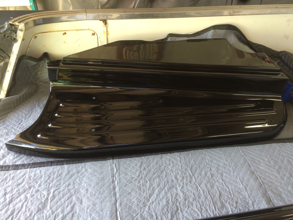

  15. I just got this photo from the painter!

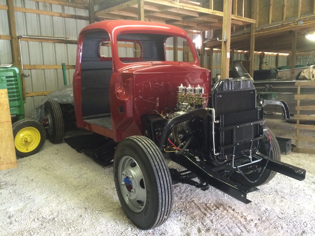

  23. Got the cab on the frame!! Boy that was a precarious undertaking.

  28. SO NICE to see all your hard work coming together! Dave, you got the color just right, too. And with the A/C, you'll actually want to drive around in it from May through September down there in Florida.

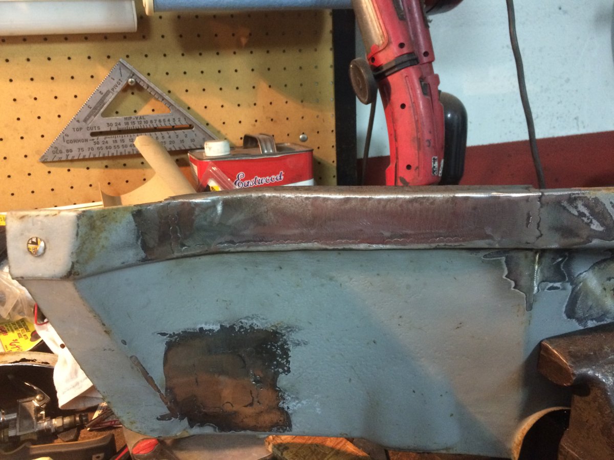

    Driver's side is done. To be honest, while I was fixing the area that bolts to the core support, I warped it pretty bad. I ended up cutting some relief cuts so the metal would lay flat again and welded it back up with better results.
    This the P***enger side inspection panel. This was the part I dreaded fixing.
    I ended up cutting a strip of metal and slowly welded it in, bending the metal to match the contour of the panel as best as I could. Once it was welded in I bent the edge down.
    Then I just cut the excess metal off and drilled the bolt hole (which was done after this picture). I'm finishing up the inner fender panel now which had a similar rusted area where it and the inspection panel bolted together.
