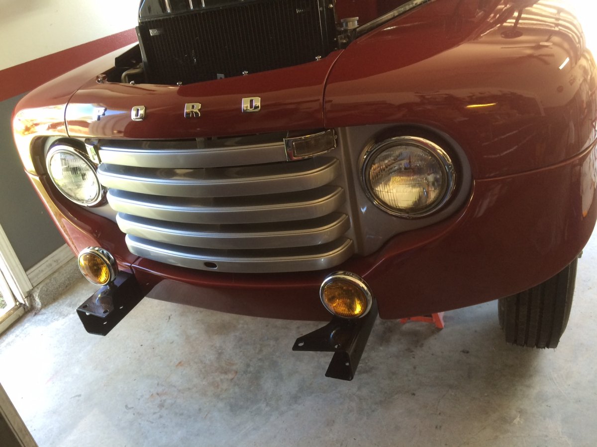

  3. Here are a few more progress pics. A good friend of mine donated some fog lamps to the build so I mounted them to the frame horns. I have already converted the parking lights to twin element bulbs (parking lights and turn signals) so I'll wire the fog lights up as actual fog lamps. Kind of a novel idea I think. haha. Also, I made a "frame" to hold the AC evaporator. After looking as some pictures of when I originally mounted the AC evaporator, I realized that the unit is about 1 to 1.5 inches to low so I'll fix that this coming weekend. As soon as I figure out how to keep the pictures from posting upside down I'll upload them.
    The front will look better once I mount the bumper.
    Sorry for the odd angle of the picture.

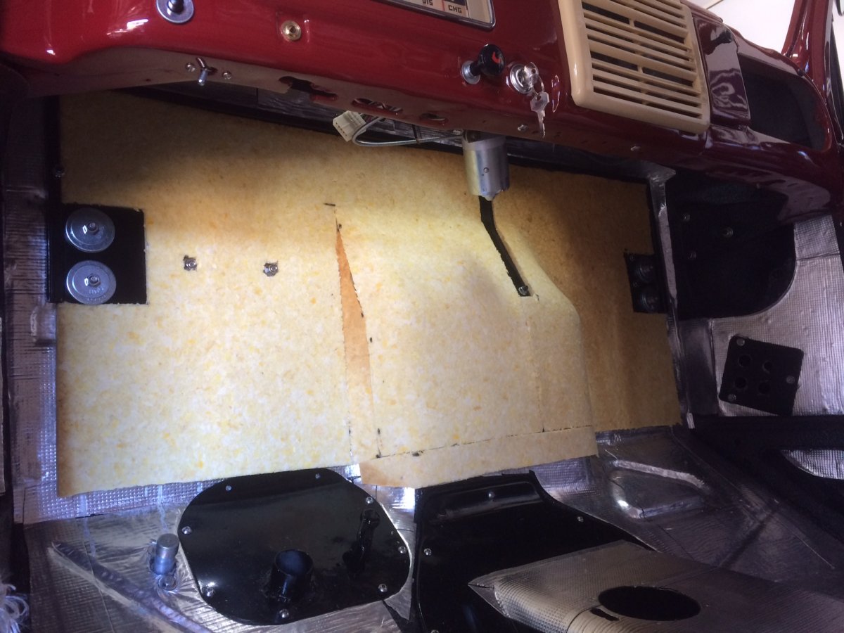

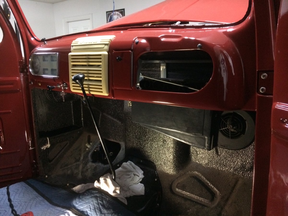

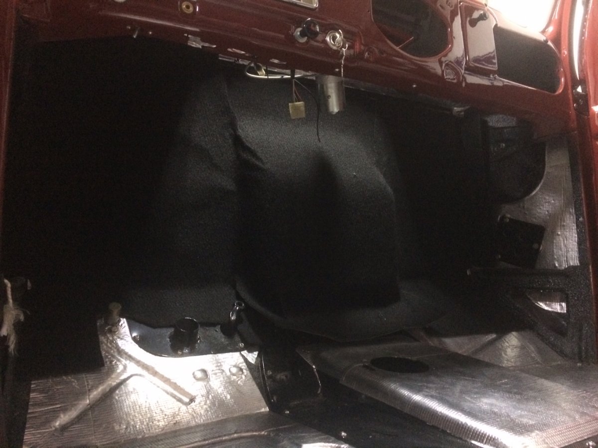

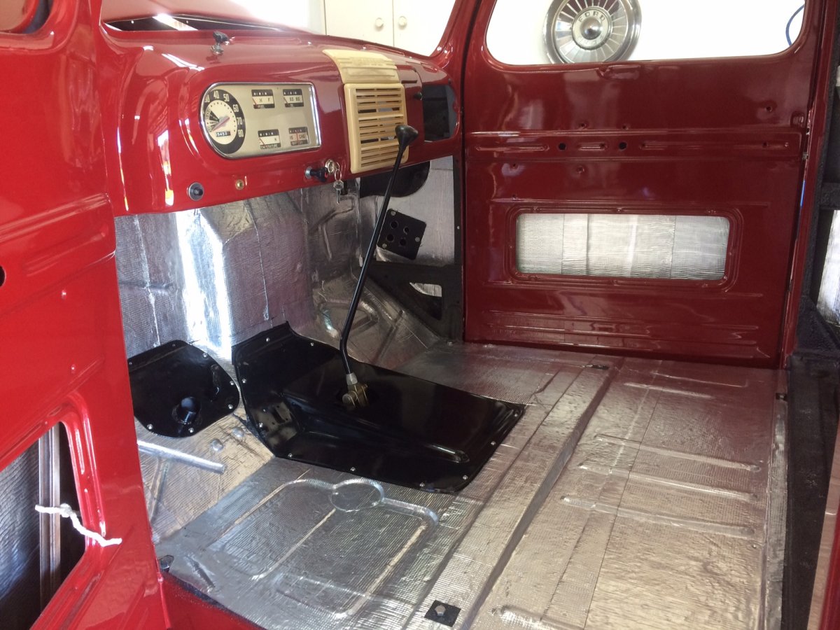

  11. I finished installing the insulation in the cab this past weekend and laid the carpet out to see how it would fit. I must say I'm a bit disappointed. The carpet set for a friend's '50 F1 fit the cab a lot better and was in two pieces. I bought the carpet from the same manufacturer but it is completely different and doesn't fit the firewall as well. Do you guys have any recommendations on getting the carpet to fit better?

  16. I made a little more progress and think I've figured out the carpet issue.
    1st: I installed some carpet padding to hopefully add some sound insulation.
    2nd: I added some carpetish type of material. The waves/wrinkles you see are because I don't have it fully glued to the padding on the driver's side. Notice I left it long on the bottom covering a portion of the toe board.
    3rd: I laid the carpet back in. Here's what I think I'm going to do; the piece of carpet in the middle that is laid over on itself will be cut off. Then I'll carefully trim the portions of the carpet that run up the firewall; basically rounding the corners. Lastly I'll take it to an upholsterer and have the edges bound. I think that will look good. Thoughts?
    Johnboy34 and volvobrynk like this.

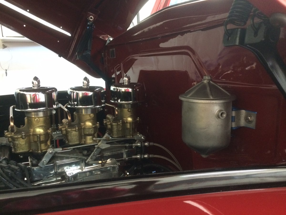

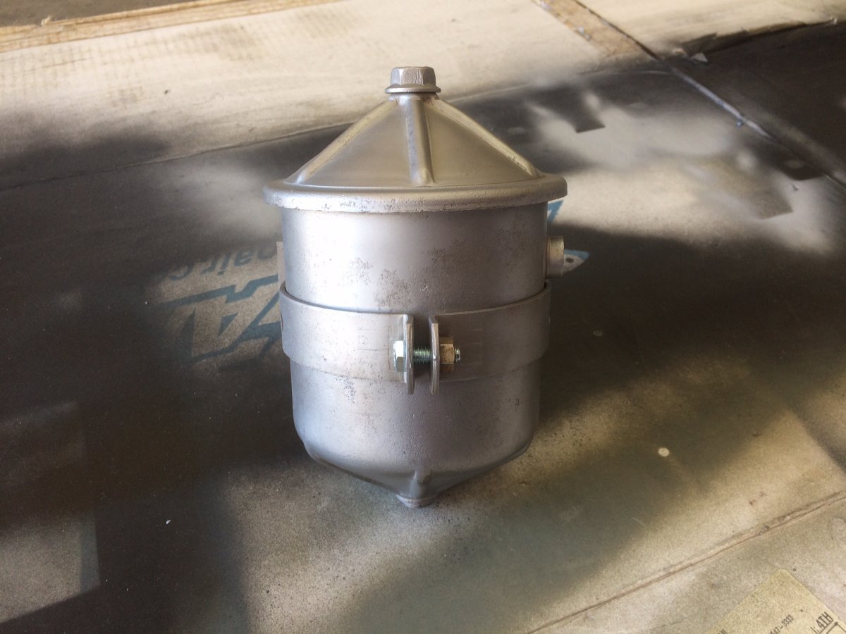

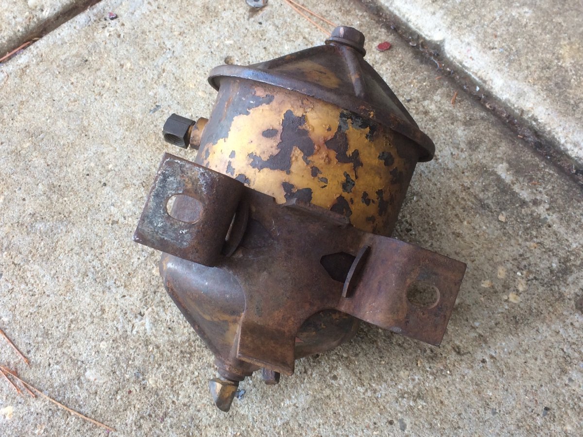

  17. I also started on another side project for the truck. Let's see if you guys can figure out what I'm going to do with this old oil filter canister.
    The Canister as purchased. Well, it was actually much greasier inside and out before I gave it a good cleaning.
    This is what I ended up with after a quick trip to the blasting cabinet at the Hurlburt Field Hobby Shop.
    I decided I didn't like the strap around it so I weld the mounting bracket to the canister and temporarily mounted it to the firewall. There's a little bit more work I need to do on the canister before I paint it. Any thoughts on what I'm going to do with it?

  19. I think you will use it as a remote master brake cylinder reservoir, but I guess I'm cheating because you suggested I try that when I was stumped regarding the nearly inaccessible location of my own m/c. I scored an old oil filter and cleaned it up, too. Just haven't hooked it all up yet. Please share details on how you plumb and vent this.
  20. Thank you bengel.
    You are The Man, Osage. Yeah, I'm going to make a remote MC reservoir out of the oil canister. I did this on a friend's '50 F1 and it is working well. I'll definitely show more details of how I modify the oil canister but it's pretty basic. The trick is going to be the MC lid. If you are using one of the 'industry standard' Chevy MC or a Ford MC you're pretty set. All you need to do is order one of the following:

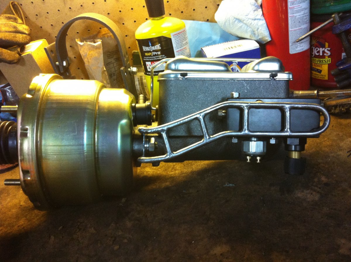

    However, I'm going to have to make my own MC lid since the MC I'm using is not your standard MC. I have some ideas on how to make it and I'll post those pics along the way.

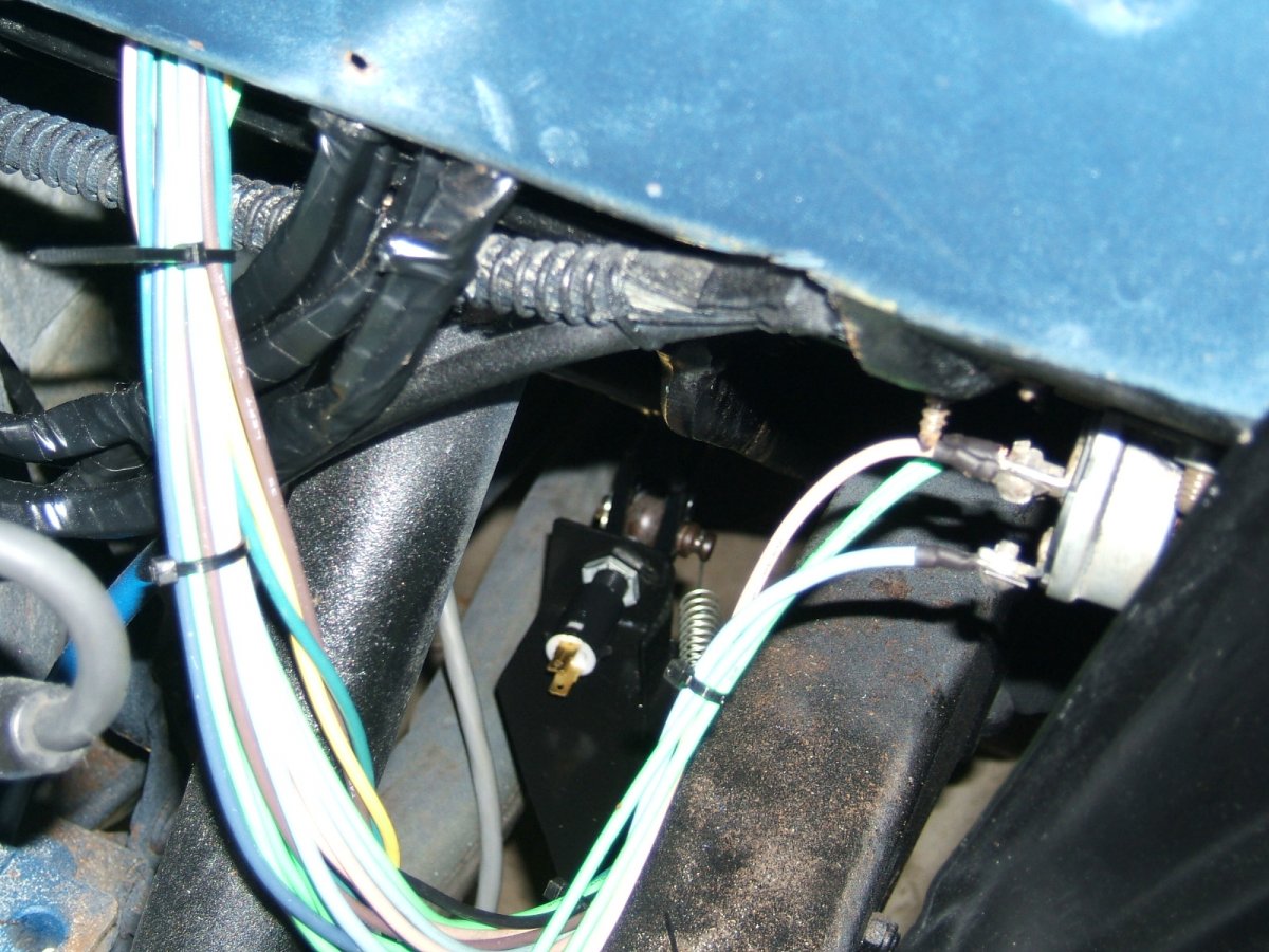

  23. Osage, the brake light switch I'm using came with the proportioning valve. I've read various pros and cons to using the hydraulic switches versus mechanical switches. Here's are a couple of pictures of the setup I have now.

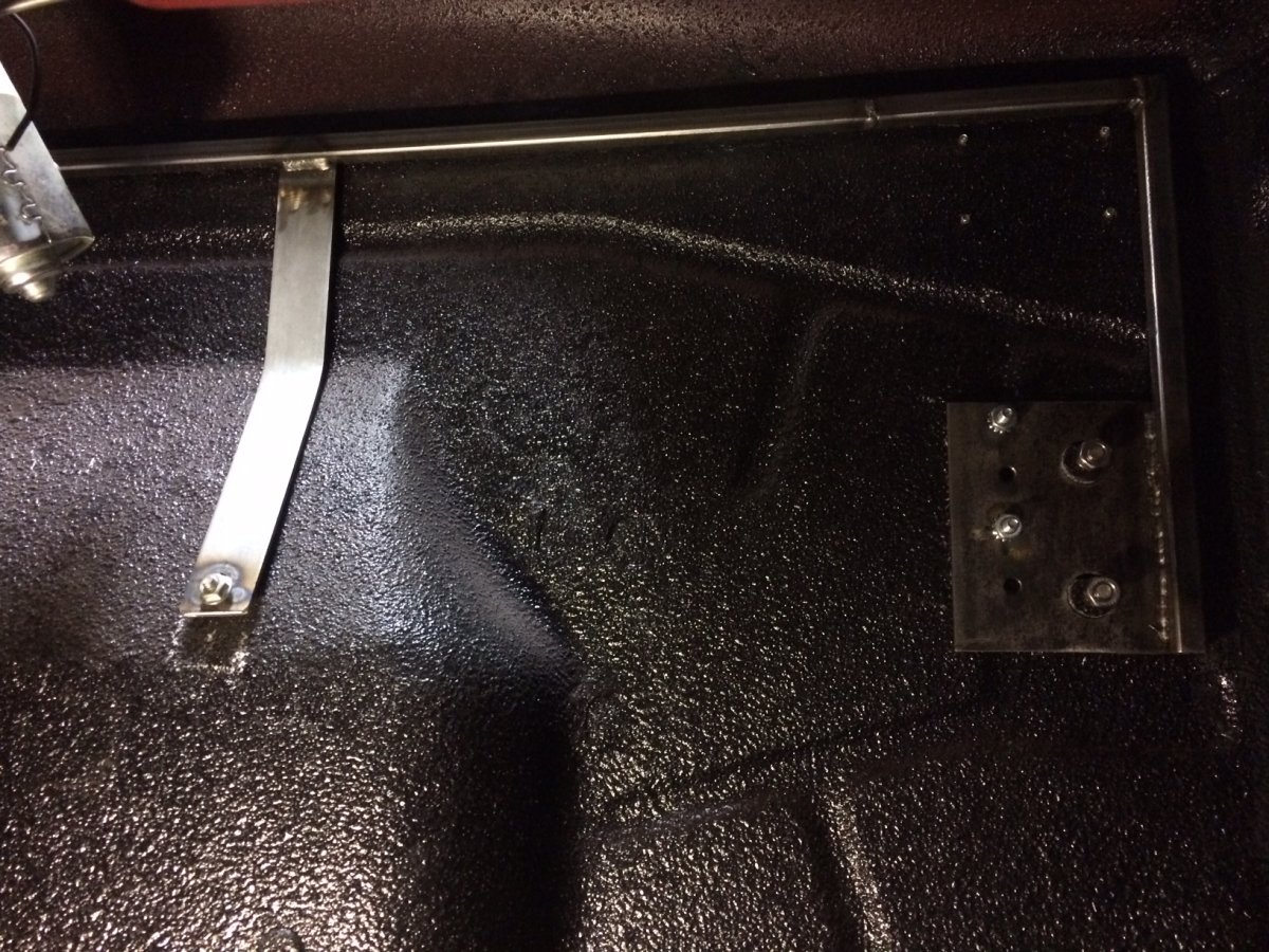

    As for using a mechanical switch, I installed one of those on my friend's '50 F1. Here's how I mounted it. There are probably better ways but this setup is working well. I made the bracket (not pretty but it works) and the switch is Chevy truck switch I believe.
    As you can see, the switch is positioned such that the brake rod depresses the switch when the pedal is not being depressed.
    I hope this helps.
    Thanks HOTFR8. Hopefully it will work out well. I think I'm going to glue the carpet down too, at least in the back portion of the cab. I know the seat will help hold it in position but the carpet slides a lot on top of the insulation/heat barrier.
  24. Thanks, Hivolt. The mechanical switch is kinda the reverse of what I thought it would be, with pedal up depressing the switch and pressure on the pedal relaxing the switch and completing the circuit. Smart!

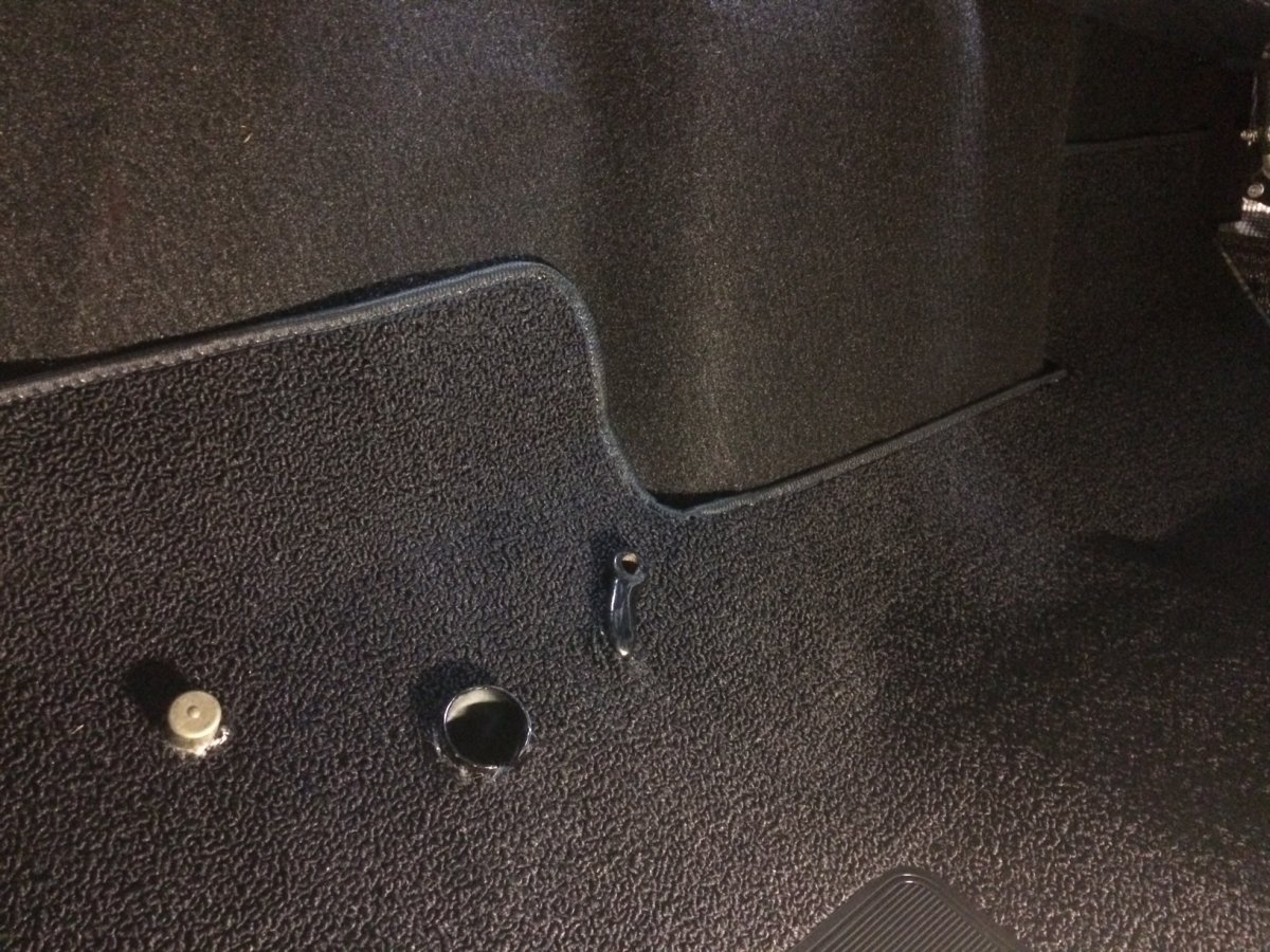

  26. Got a few more update pictures. I found a local shop that would put binding on the carpet so I had that done. I also installed the interior panels and gas tank. Slowly but surely it's coming together!
