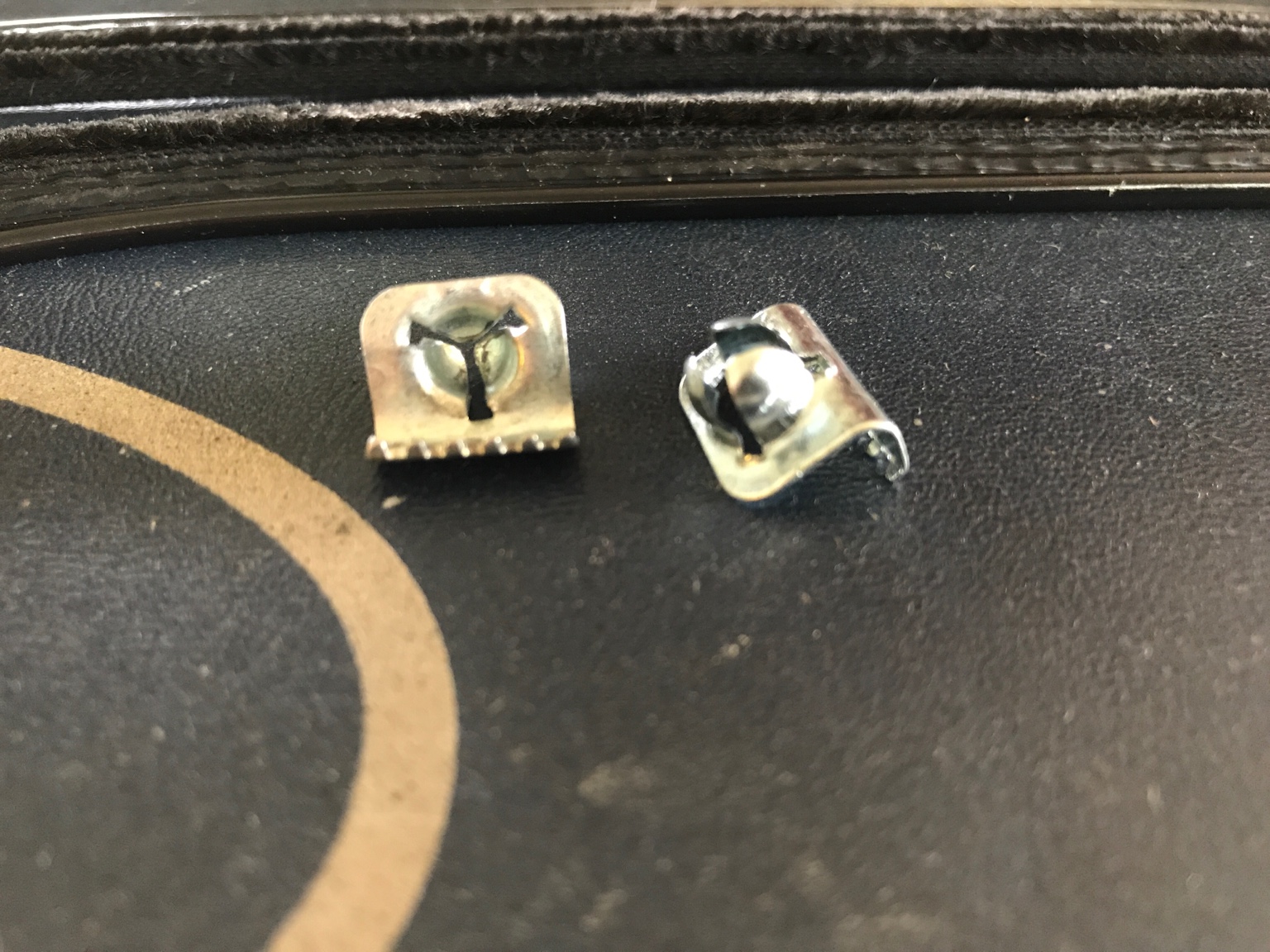

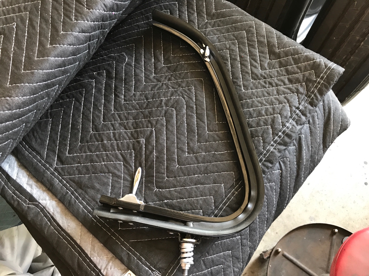

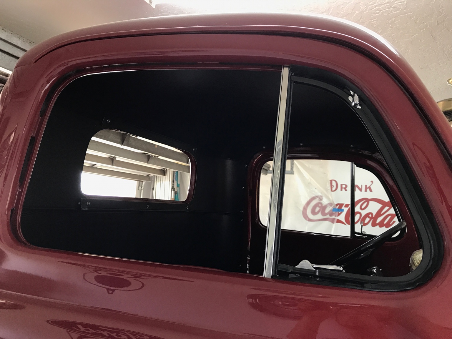

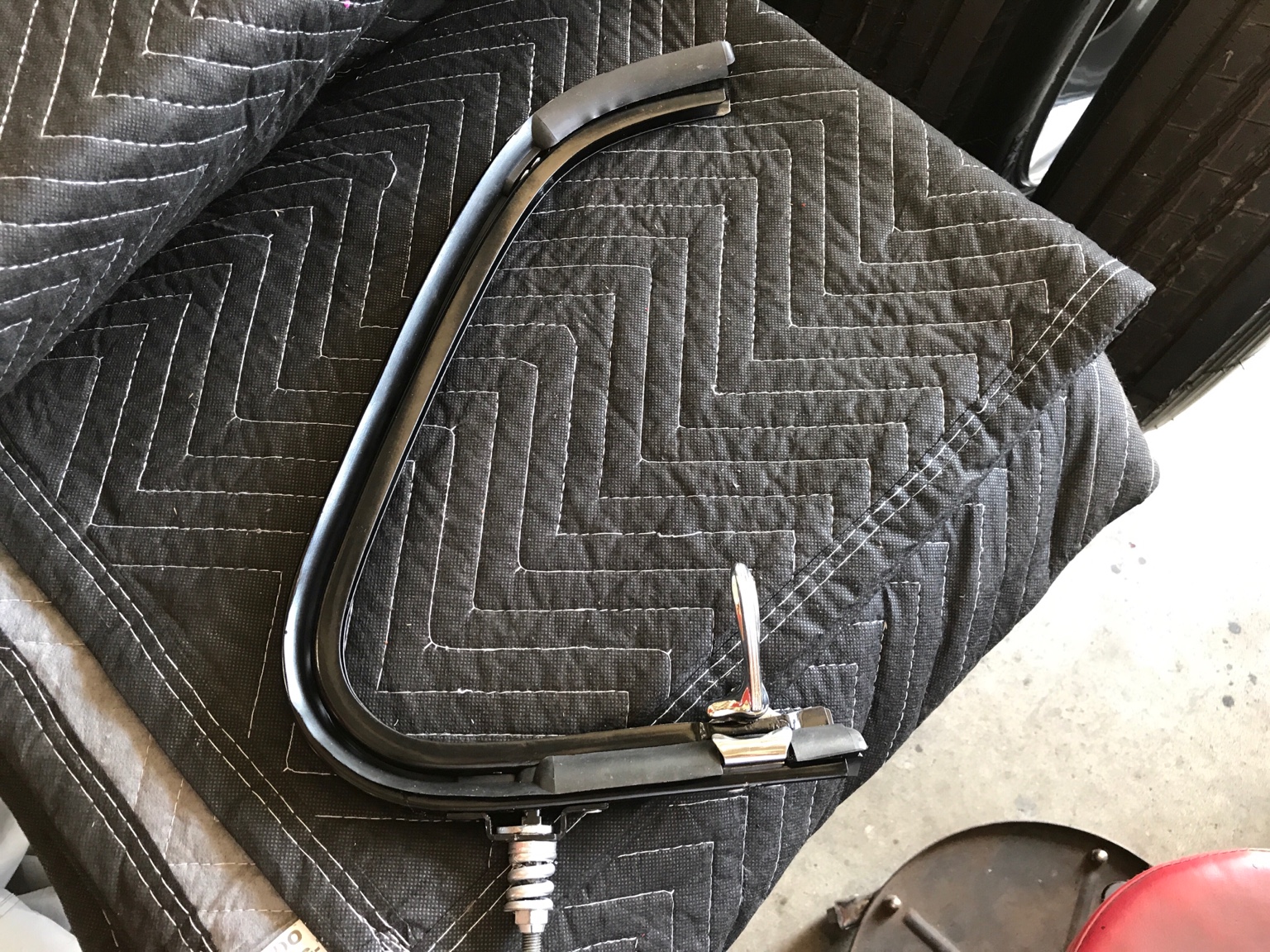

  2. I finished putting the vent windows together and installed them. I also installed the window regulator and division bar. Man that division bar was a pain in the back side to install!! Now I'm on to the window felts. I have the main one that goes around the window in but am struggling with the fuzzies on either side of the door. Is there a secret to install the little clips??
    These are the minions of evil I'm struggling to install.

    Yep it's a pain in the ***....those clips are really hard to snap but once in place they old tight!

  4. I officially HATE installing the window fuzzies!!! Oh my word what a pain in the posterior!! Unfortunately I nicked the paint in a few places. [emoji35][emoji35]

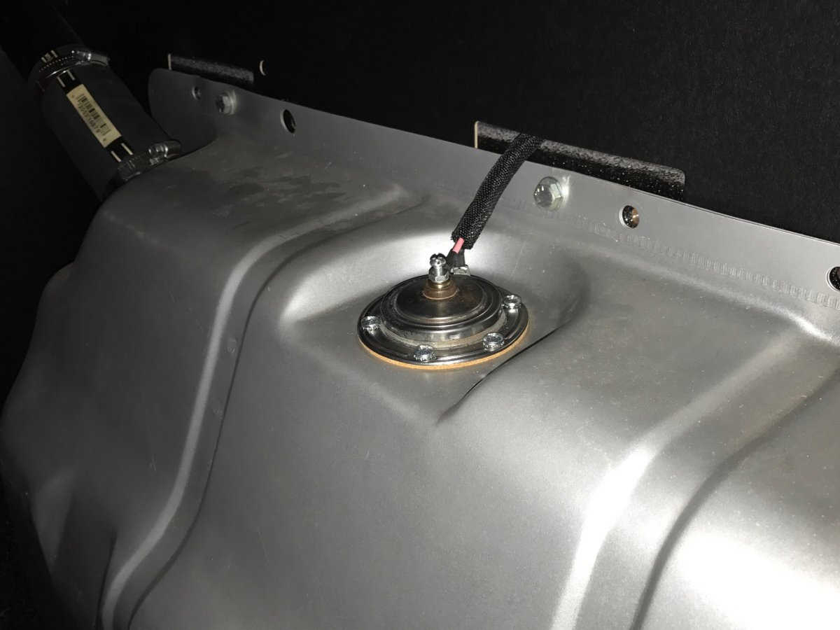

  5. I've still been plugging away at the old Ford by testing all of the electrical items. I had an issue with the starter solenoid; I could hear it clicking but it wasn't sending power to the starter, so I replaced it and the starter turns over now. I have an issue with my brake lights that I haven't fully tested yet. There's a pressure switch in the proportioning valve and I have power to one side of it, I just need to see if the switch is transferring power to the other side when the brake pedal is pressed. Also had an issue with the fuel gauge. The aftermarket sending unit would only bring the fuel gauge to half-a-tank. After talking with a good friend of mine, he schooled me on the King Seeley gauges and sending units and then offered the original sending unit off his '40 Ford to me! I got it in the mail and tested it this weekend and it works! I cleaned up the exterior, inspected its innards and then modified the float arm to work with the truck's fuel tank. I now of the fuel gauge reading exactly half a tank (with 10 gallons of gas in the tank).

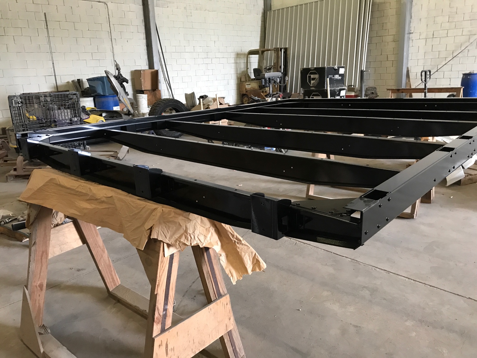

  6. Stopped by the powder coater today and the bed frame is done!! Man it looks good. It's a little dusty in the pictures.
    One more step forward!

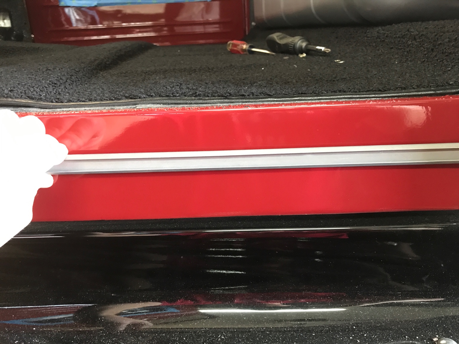

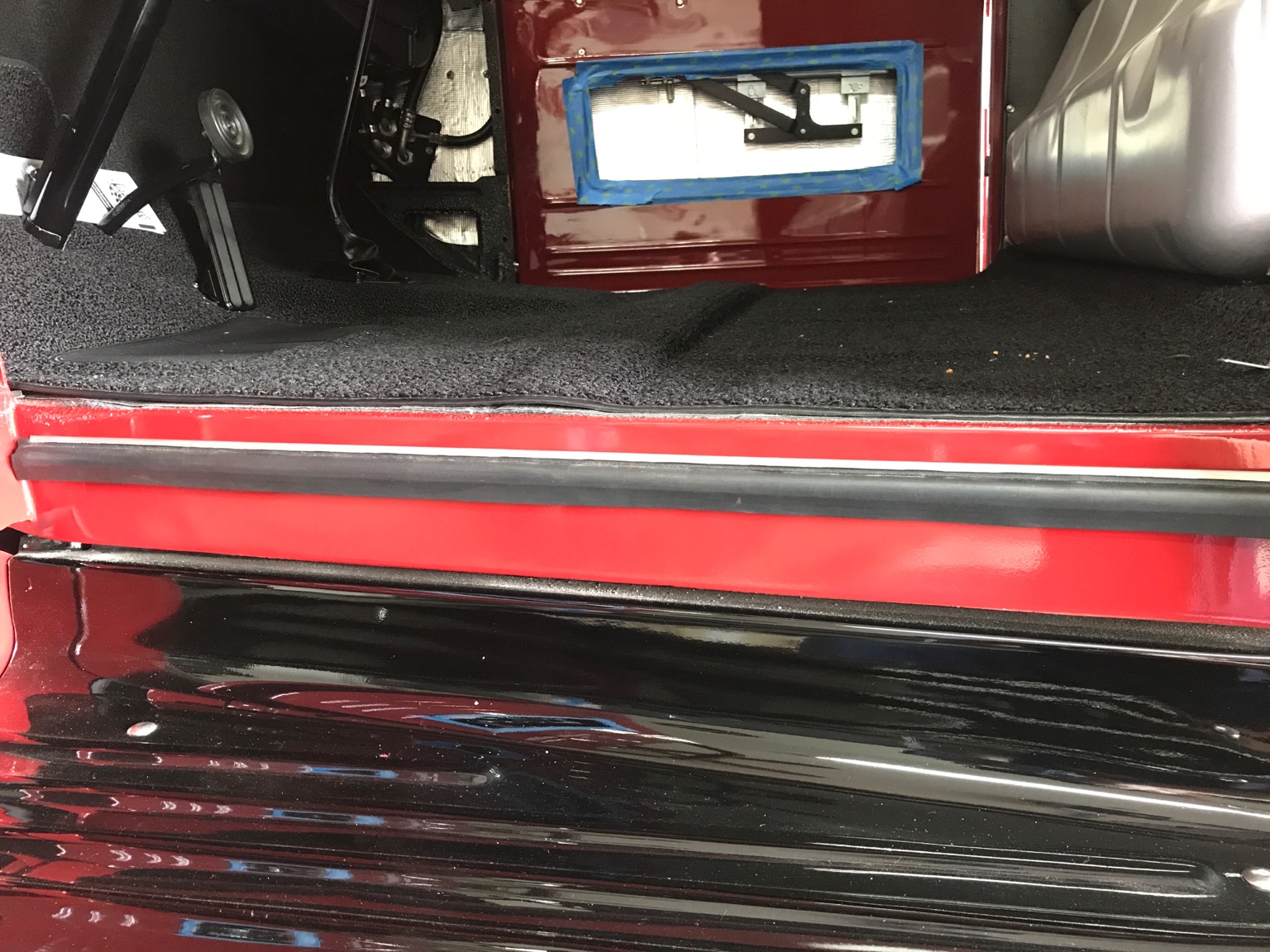

  11. Would one of you be able to help me with a measurement? I need to know the position of the weather strip that seals the body to the door. Please see the picture.
    Thank you

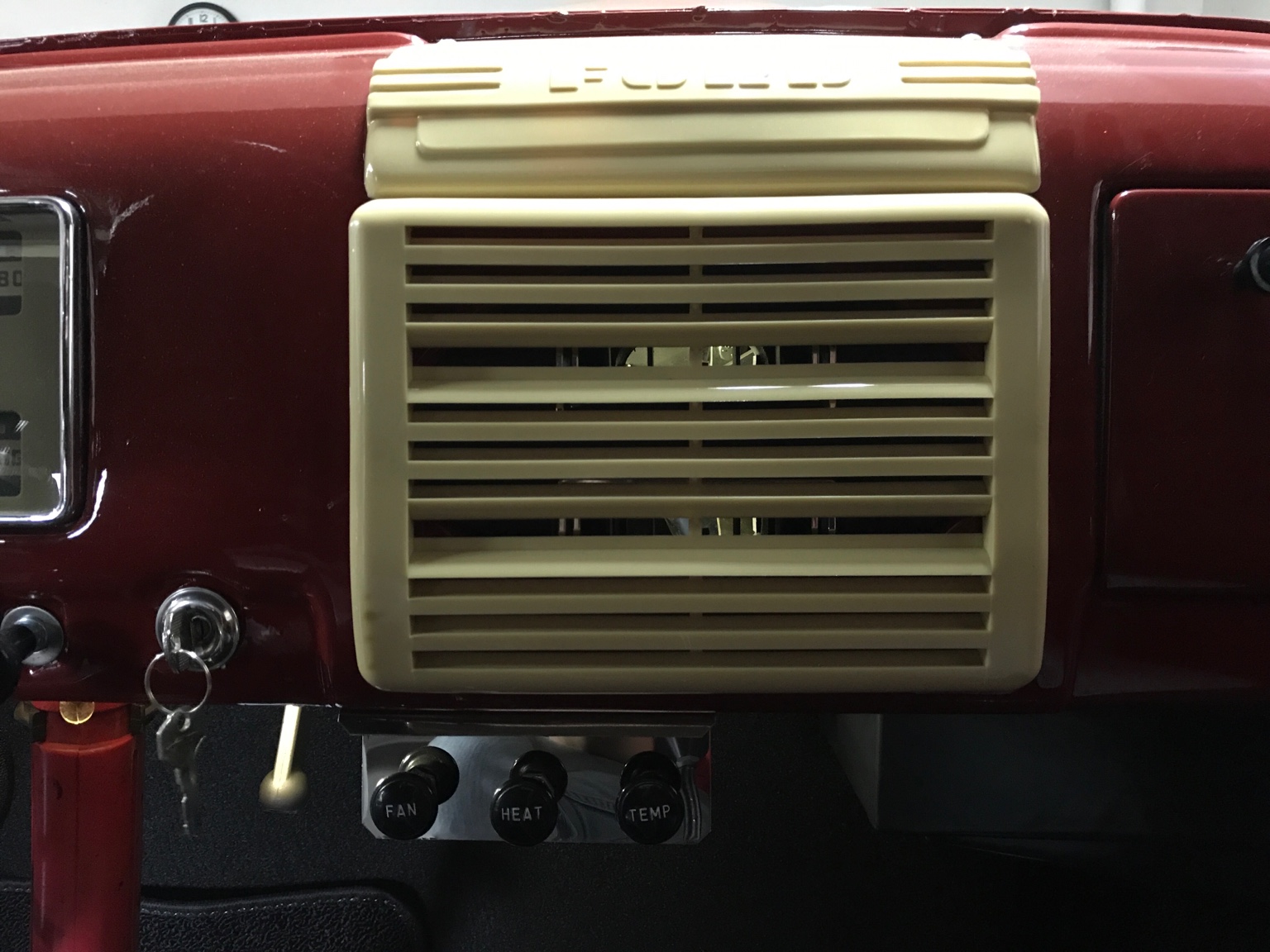

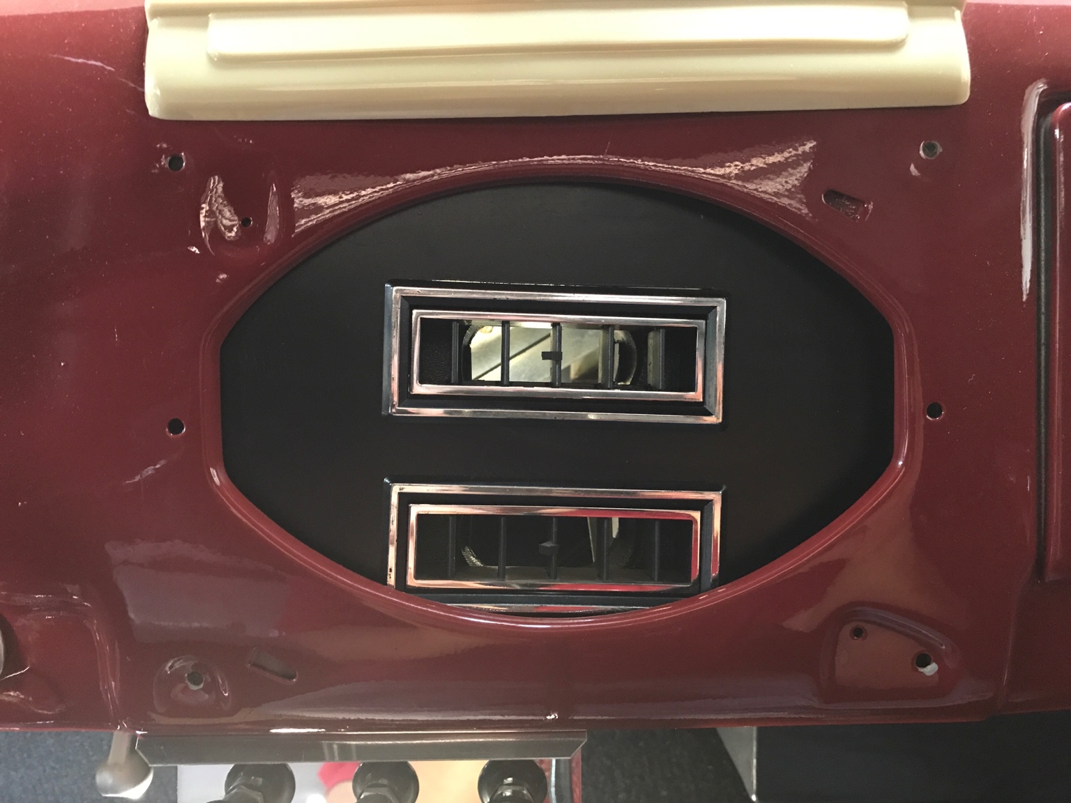

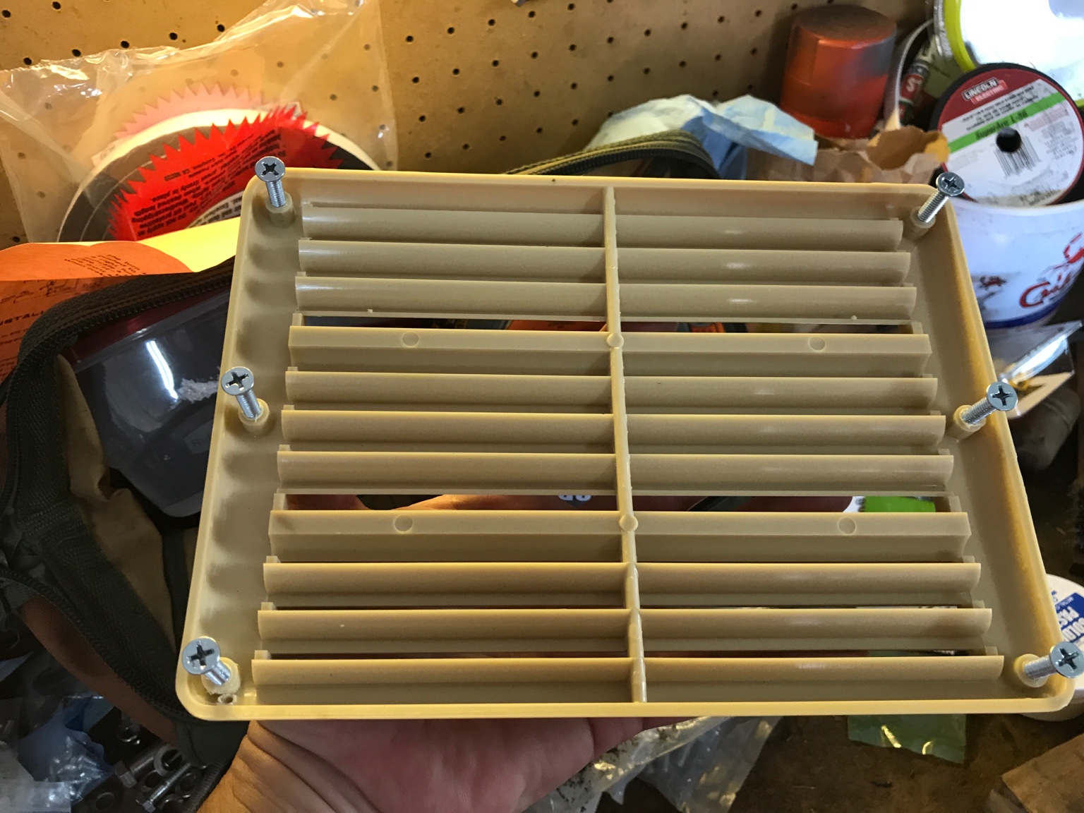

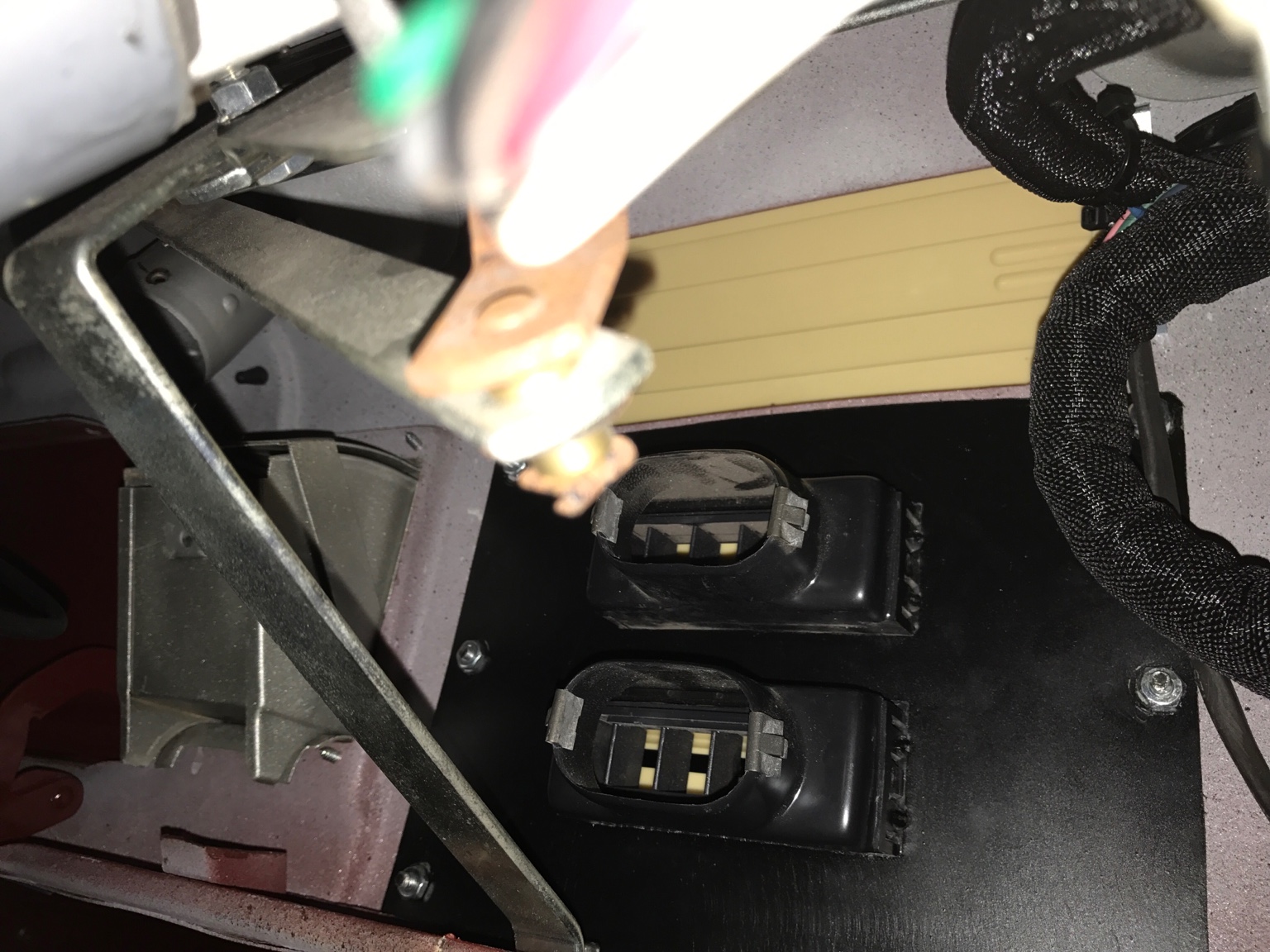

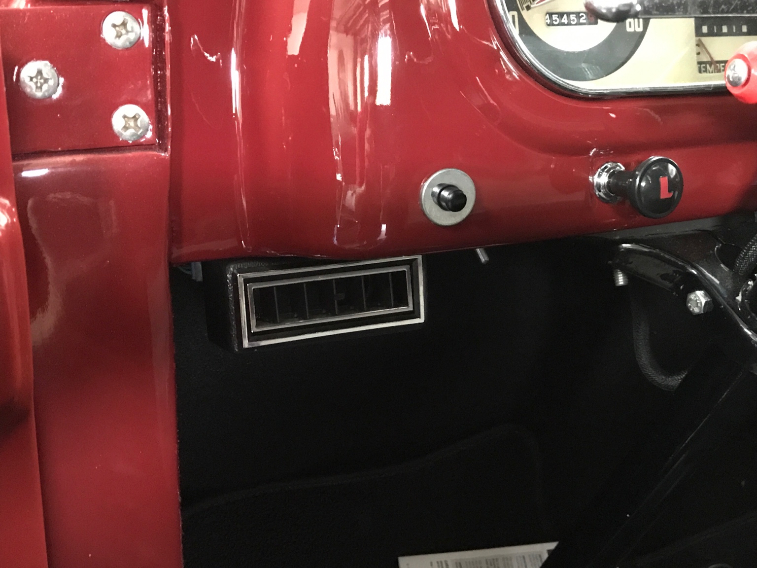

  15. With the excitement of running the engine I decided to go ahead and mount the AC vents. The left and right side vents are just bolted under the dash.
    For the center vents I decided to mount them behind the speaker grill. True, I won't be able to adjust them but I just hated the look of them hanging below the dash. Here's how I did it.
    First I screwed in some machine screws into the back of the speaker grill. Then I cut the heads off of the screws (not shown).
    Next I cut some metal to mount the vents to.
    I slide it behind the dash.
    Finally I put the speaker grill in place, matched up the studs to the holes in the metal mounting the vents and tightened them together with nuts.

    Behind the speaker grille. What a great idea.

    I don't know if anyone sent the measurement for your door seal, I just measured mine it is 7/8" below floor board to top of channel. Stock 51 F1 should be the same cab.

  21. I installed the weather stripping yesterday. Thank you paleot for the measurement! The install went well. Now my only problem is I can't shut the driver's door!![emoji35] The p***enger door shuts and seals fine. I tried adjusting the driver side hinges out but couldn't get enough adjustment. Guess I'll have to take the door off and see if I can persuade some more adjustment from it.
    Always seems like one step forward and two steps back.

    Is the seal too thick, hard? I take it the shuts fine without the rubber. You could use clay or something to check clearance between door and rocker, (like checking valve to piston) and see how much room there is. And hopefully you stay high and dry through that storm!

  26. Johnboy, I think the driver's door just shuts closer to the "rocker" area of the body. The P***enger door closes perfectly with the rubber seal in place. If I can just get a little more adjustment on the driver hinges I think I can make it work. Worst case I may have to remove the C channel that holds the rubber in place and just glue the rubber to the rocker area.

  29. Osage, what I want to try first is to see if I can get any more adjustment from where the hinge mounts to the A pillar. I had to make the plates that the hinge bolts screw in to. It's possible I made the plates too big and thus not allowing enough adjustment. That's the easiest place to start at least. I really don't want to resort to bending the actual hinges.
