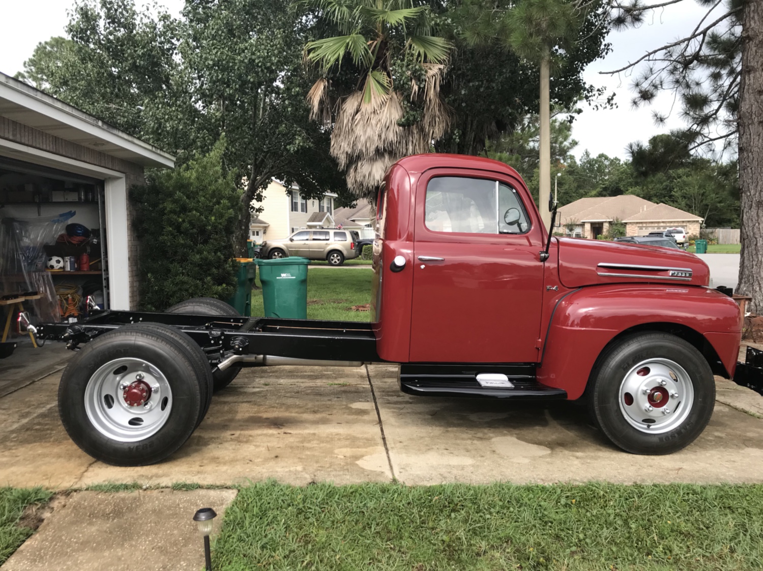

  2. Thanks Osage, honestly it's almost surreal to have the F4 driveable! Unfortunately the truck isn't mine, it belongs to a good friend but Fortunately I was able to restore it without having to pay for the parts. :) I'll have access to it and plan to debut the truck at the Emerald Coast Car show Sept 8th, which means I got to get the bed wood finished!
    There's nothing special about the engine and transmission. They came out of an 89 Grand Marquis and are completely stock. The only difference about the 302 is I changed the distributor to a Dura Spark and put a carb on it. Even the accessory drives are stock Grand Marquis.
    I was really curious how it would all work with the factory rear end/gearing because it's pretty steep, 5.44:1 if I remember. The most important thing on the AOD is making sure the TV cable moves in perfect symmetry with the throttle cable and that you get the trans pressure at 35 psi. So far it shifts great, the only oddity is going into OD; at times it wants to hesitate. I plan on taking it to a really good trans guy Friday to have him check it out.

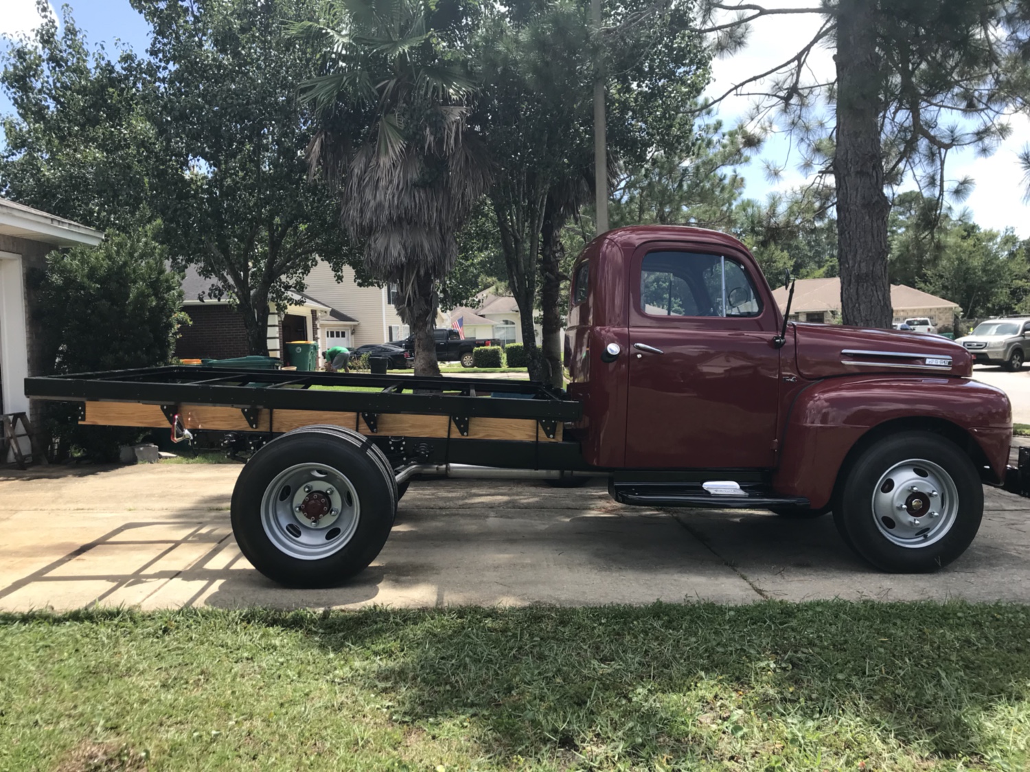

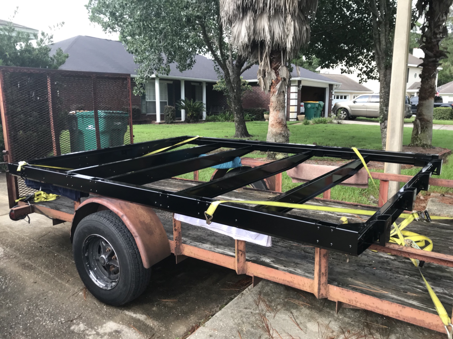

  3. Well, I’ve been plugging away at the wood for the bed. I put three coats of gloss black paint (sanding between each coat) on the spacers and I think they look pretty good. I’m also thinking about putting some welting on them to eliminate any squeaking of the wood rubbing on each other. Thoughts?

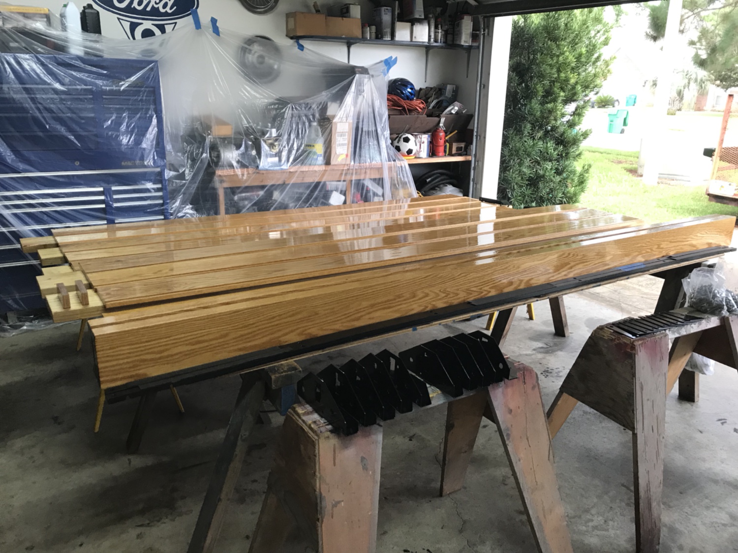

    I also started varnishing the wood stringers and flooring. Some of the flooring had some coats of varnish already applied by an employee of the owner but I wasn’t sure how many coats so I took some 120 sand paper and sanded all of the wood. I have all the pieces laid out in my garage and as you can see there isn’t much room for all of it. I have one coat of varnish on the top sides of the wood. The boards that are glossier than the others are the ones that had some varnish on them already.

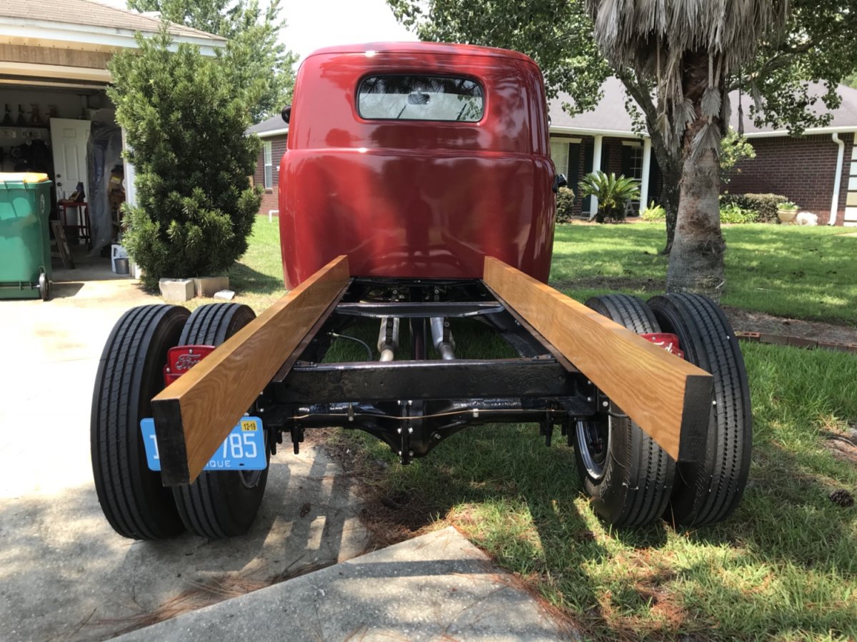

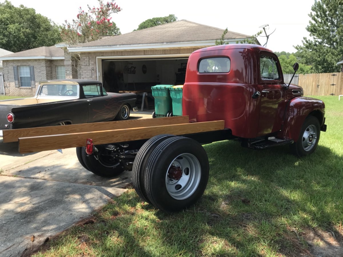

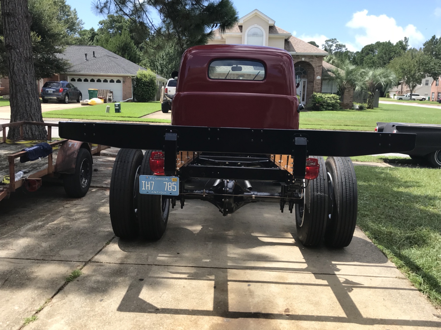

  4. The wood for the bed is almost ready! Sprayed the final coat on the bottom of the boards yesterday and am hoping to spray the final coat on the top tomorrow. Maybe next weekend I’ll have the bed on!
    I set the stringers on the truck for teaser.
    I know a lot of you guys don’t like these, but the owner wanted some step plates so I put these on today. I like them.

  8. It’s about to get real! Good Lord willing and the creek don’t rise, the bed is going on tomorrow!! I have everything (I hope) ready for the task.
    Wood varnished? Check
    Stainless strips cleaned? Check
    Bolts and nuts? Check
    Bed frame and truck washed? Check (is it sad that I washed the truck for this?)
    Can hardly wait!!

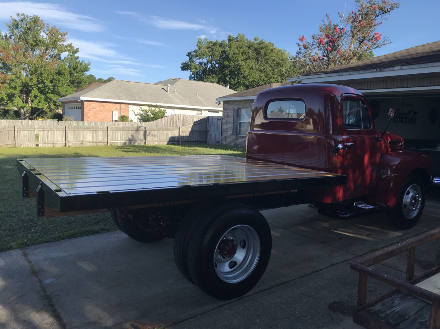

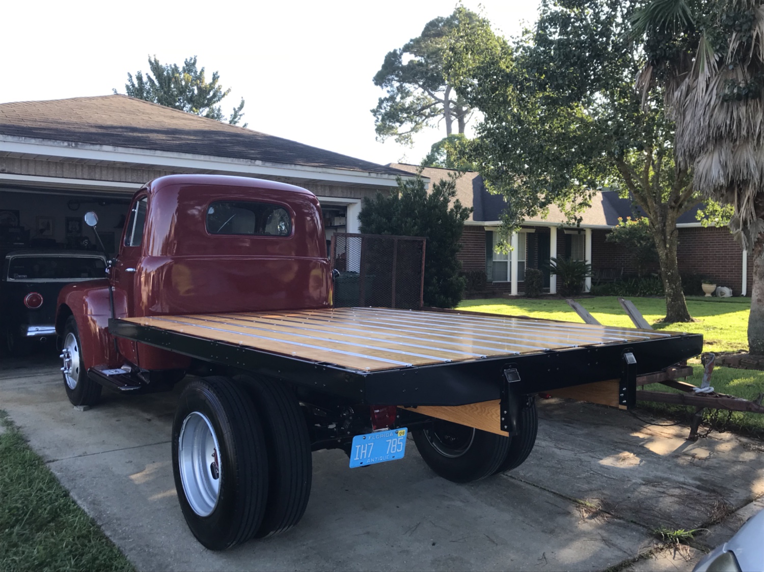

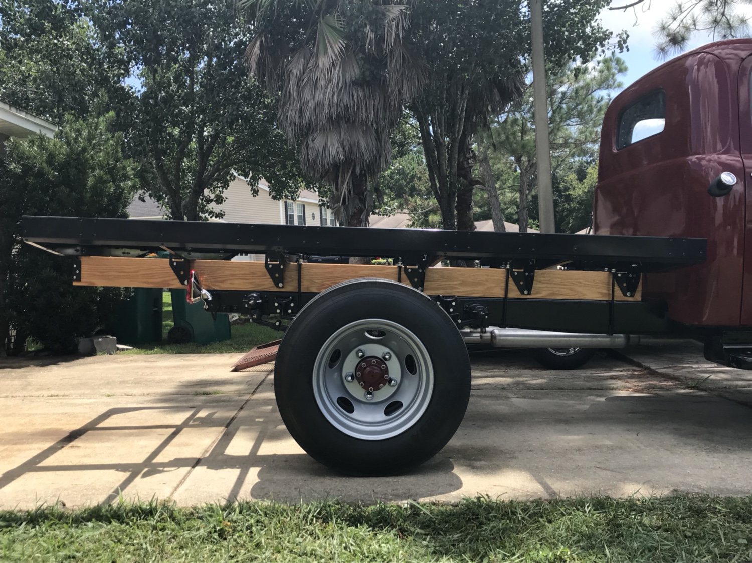

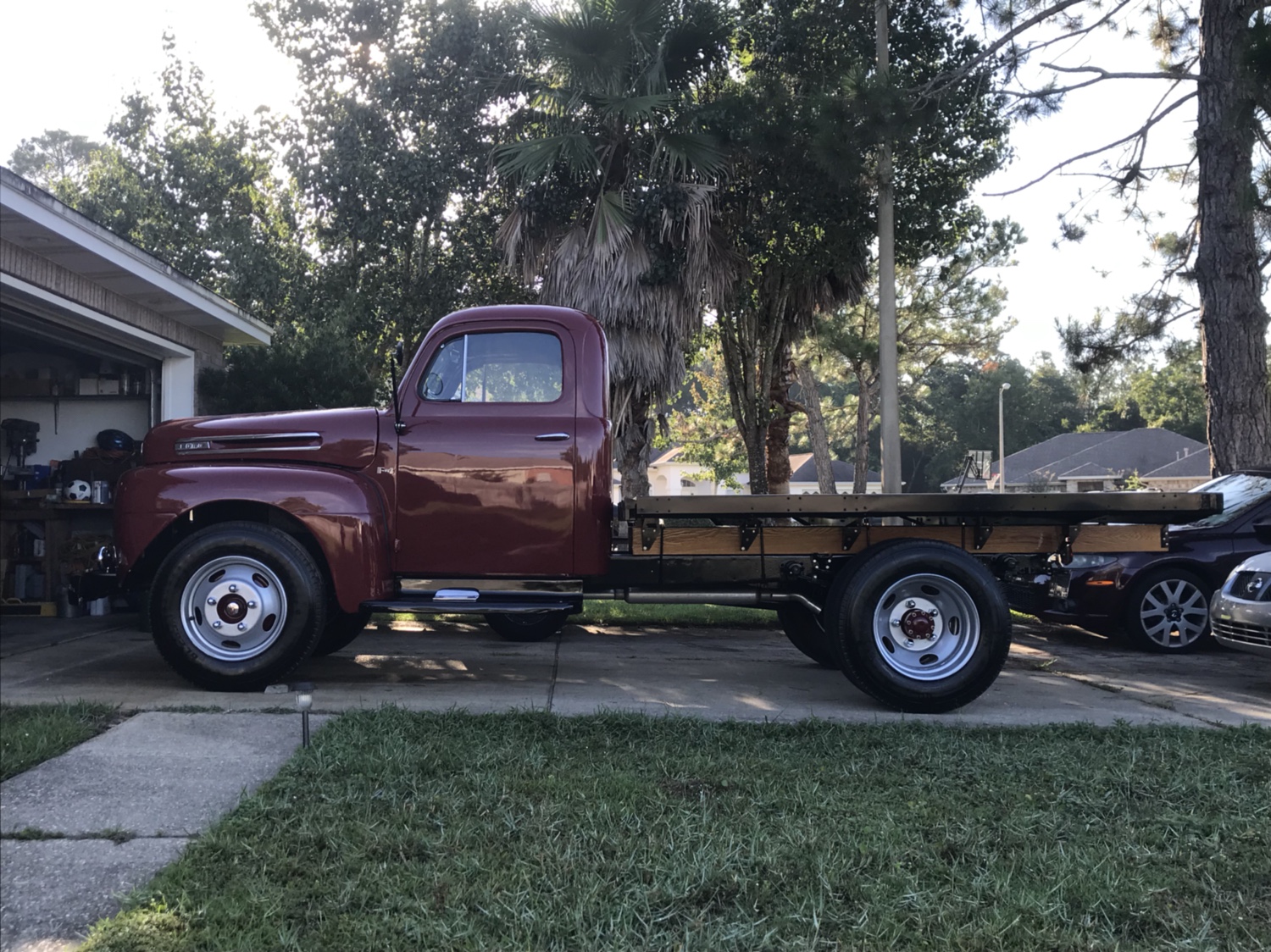

  10. The bed is on! Took me all day! Holy cow there are a bunch of bolts on it. I don’t have any pictures of the finished product yet because it got dark outside but here are some pics of the bed mounted to the truck.
    55Deso, brEad and Johnboy34 like this.

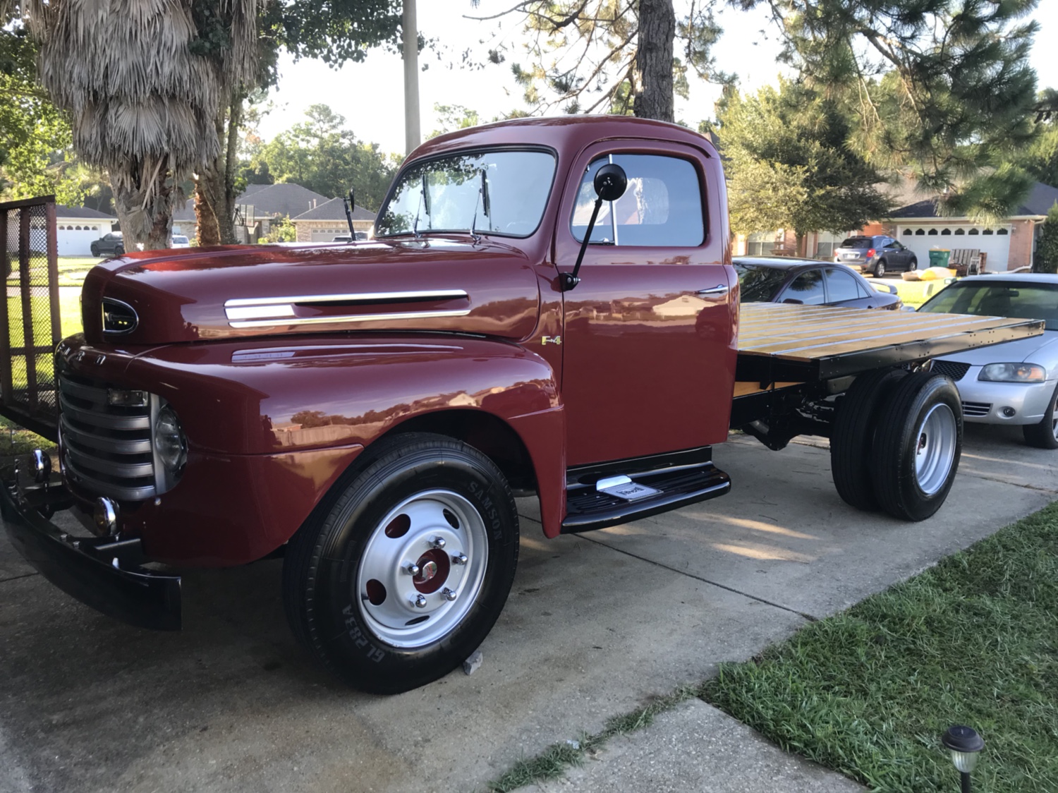

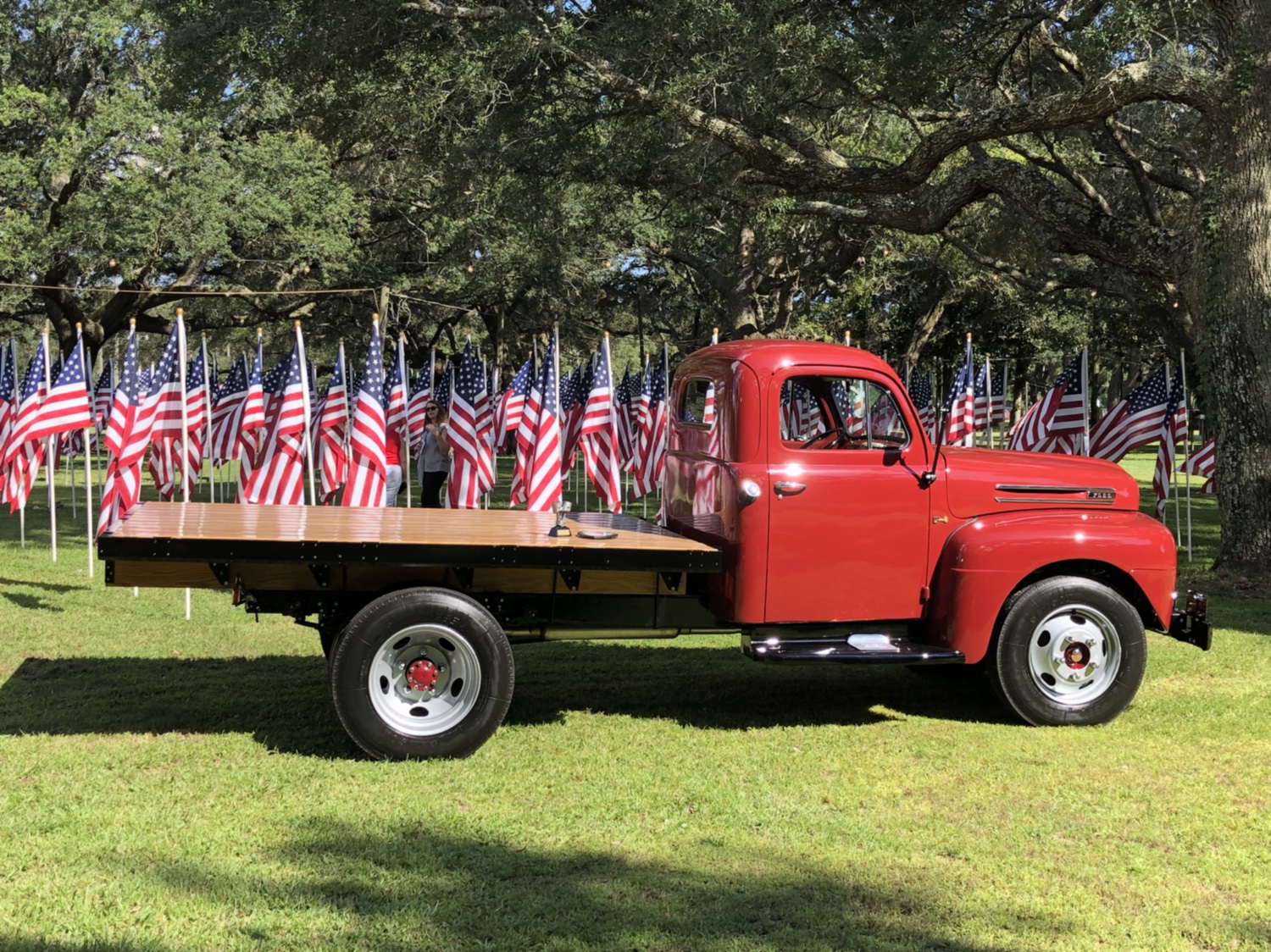

  11. Some pics of the finished product.

  17. I used my father-in-laws cordless impact when attaching the bed frame to the truck and used my air ratchet when tightening the bolts holding the wood flooring down. I would not want to tighten all of the bolts/nuts by hand.
    Thank you!
    I don't have the stake sides built yet but the owner of the truck does want them. I got to the point where I just wanted the truck done and driving, knowing I could go back and finish the stake sides. I know the sides will be "half height", meaning the top of the sides will not exceed the bottom of the rear window. What I can't decide on is what material to make the vertical stakes out of. I'd love to have some original metal ones and have thought about trying to make some, but we'll see.
