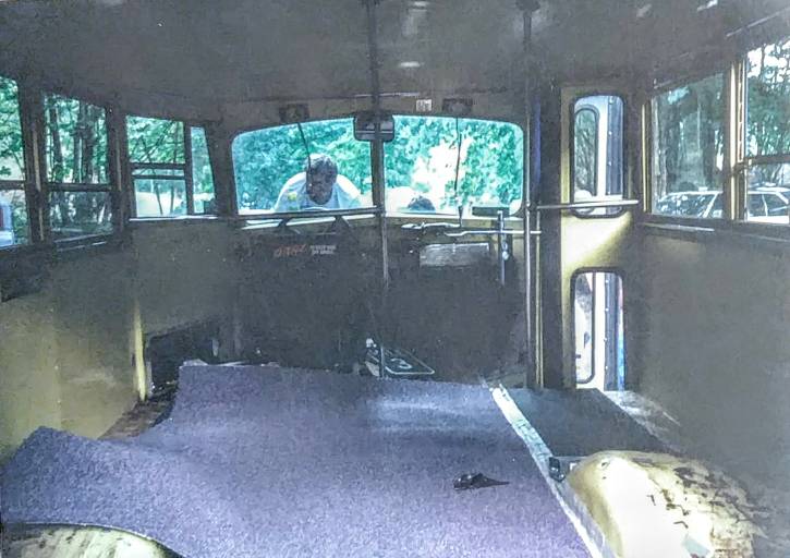

    Here is the interior of the bus. It’s to bad they stripped it out.
    [​IMG][​IMG][​IMG][​IMG][​IMG]
    If any one knows of a junk yard that has one of these busses with a chrome 3 piece bumper. Need to find one....
