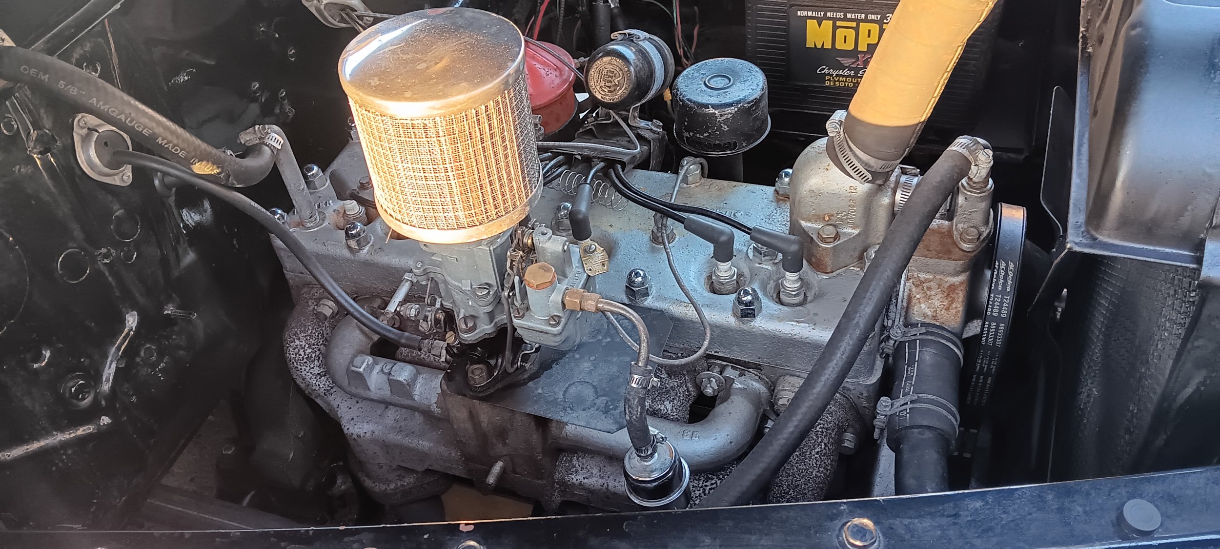

  27. Hillbilly Werewolf
    Joined: Dec 13, 2007
    Posts: 562
    Hillbilly Werewolf
    Here is a better picture of it.
    It is just a plain ol' Napa battery, with a sticker and a little spray paint.
    The Mopar sticker is from Ebay, it matches the logo cast into the '40s and '50s batteries depicted in mopar parts ads. The caps I popped off and hit with a couple coats of gloss red spray paint. I left the top barcode sticker for warranty purposes, but It would look better without it.
