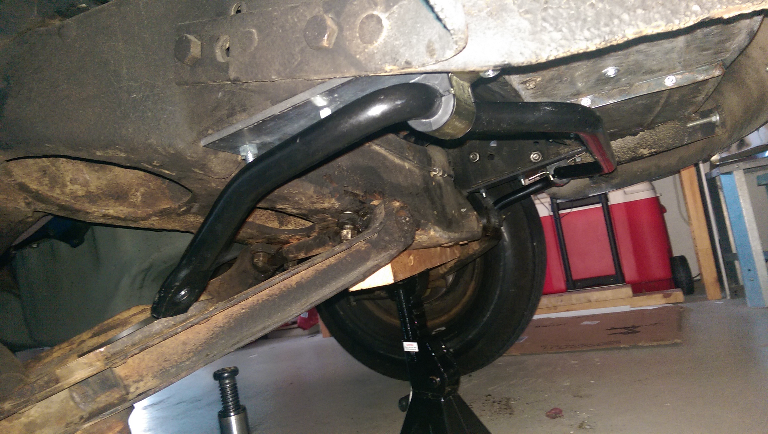

    anyone have the part number for the 1" sway bar that should work ? it looks like I ordered the wrong bar , see below this is what I have and it does not fit:

    just got the advice to flip it over and drop the mounts on another forum, will do tomorrow

    I dropped the mounts 2 " today, better but far from perfect.

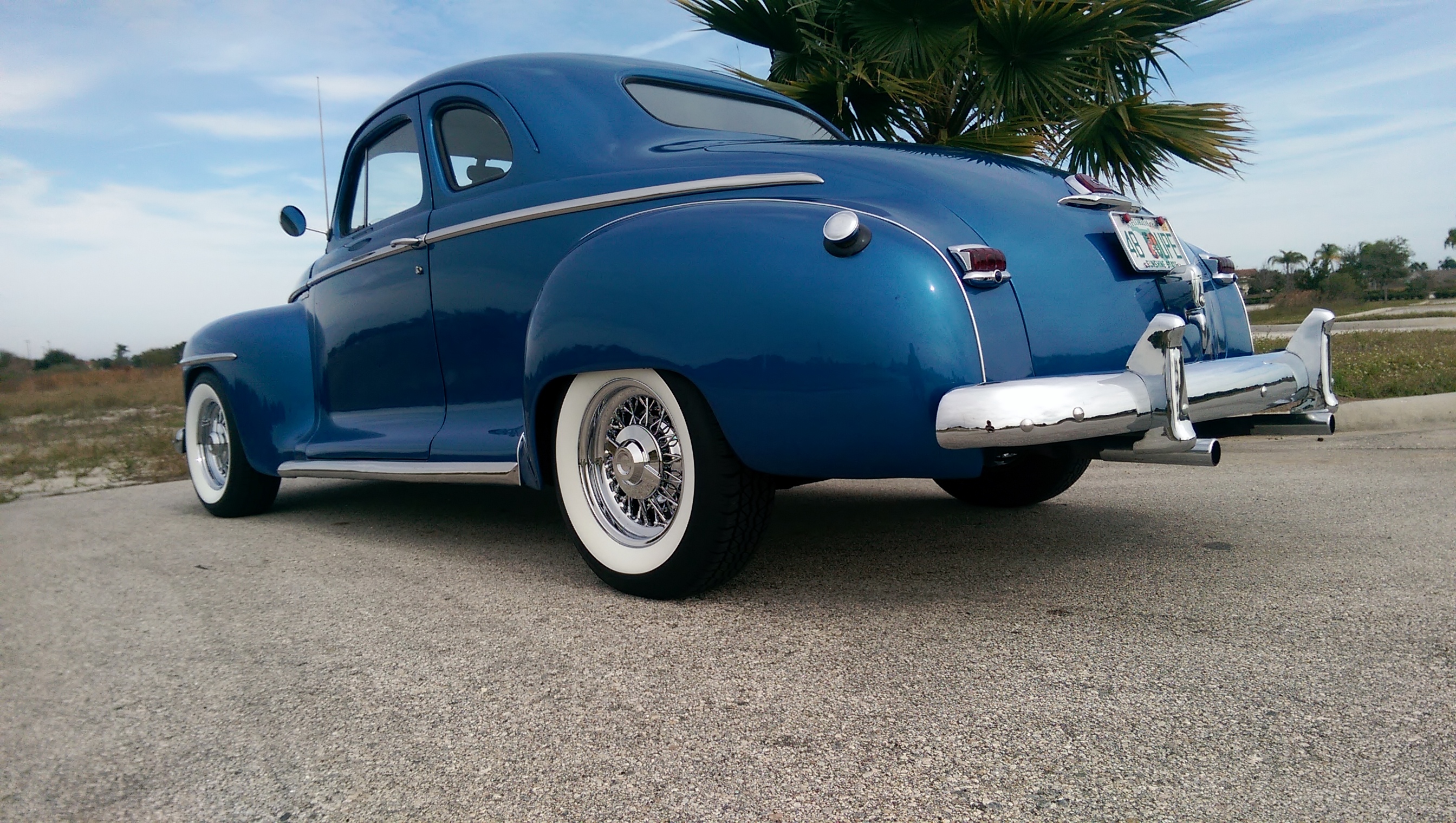

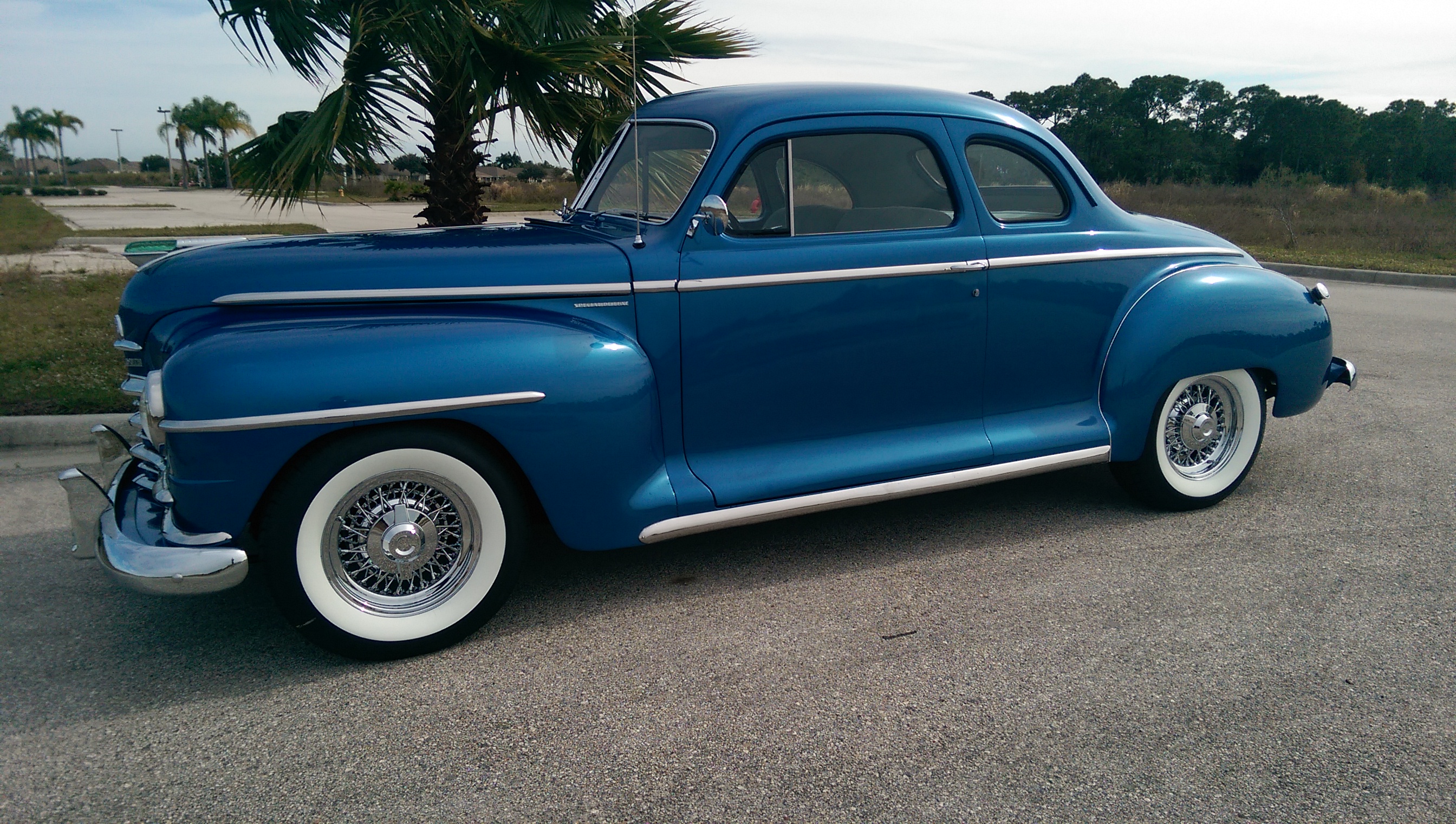

    IMAG0086.jpg IMAG0102.jpg Thanks guys , just installed Aerostar springs with new insulators ,cut one coil, installed Cherokee sway bar new BFG radials and 15x6 true spokes, big difference in handling.
    volvobrynk and wvenfield like this.

    Thats the one I used , but not the best option as I had to drop the mounts 3" and I have seen guys using the Cherokee sway bar without dropping the mounts so I guess they used a different year ?

    Moody Blue, Good job filling out those wheelwells. It makes all the difference in the way our 48s look.

    Thanks I am very happy with the 215/75x15 BFG tires on true spokes , makes a huge difference compared to the Coker bias ply tires I had on before..next step will be to install the od transmission.
