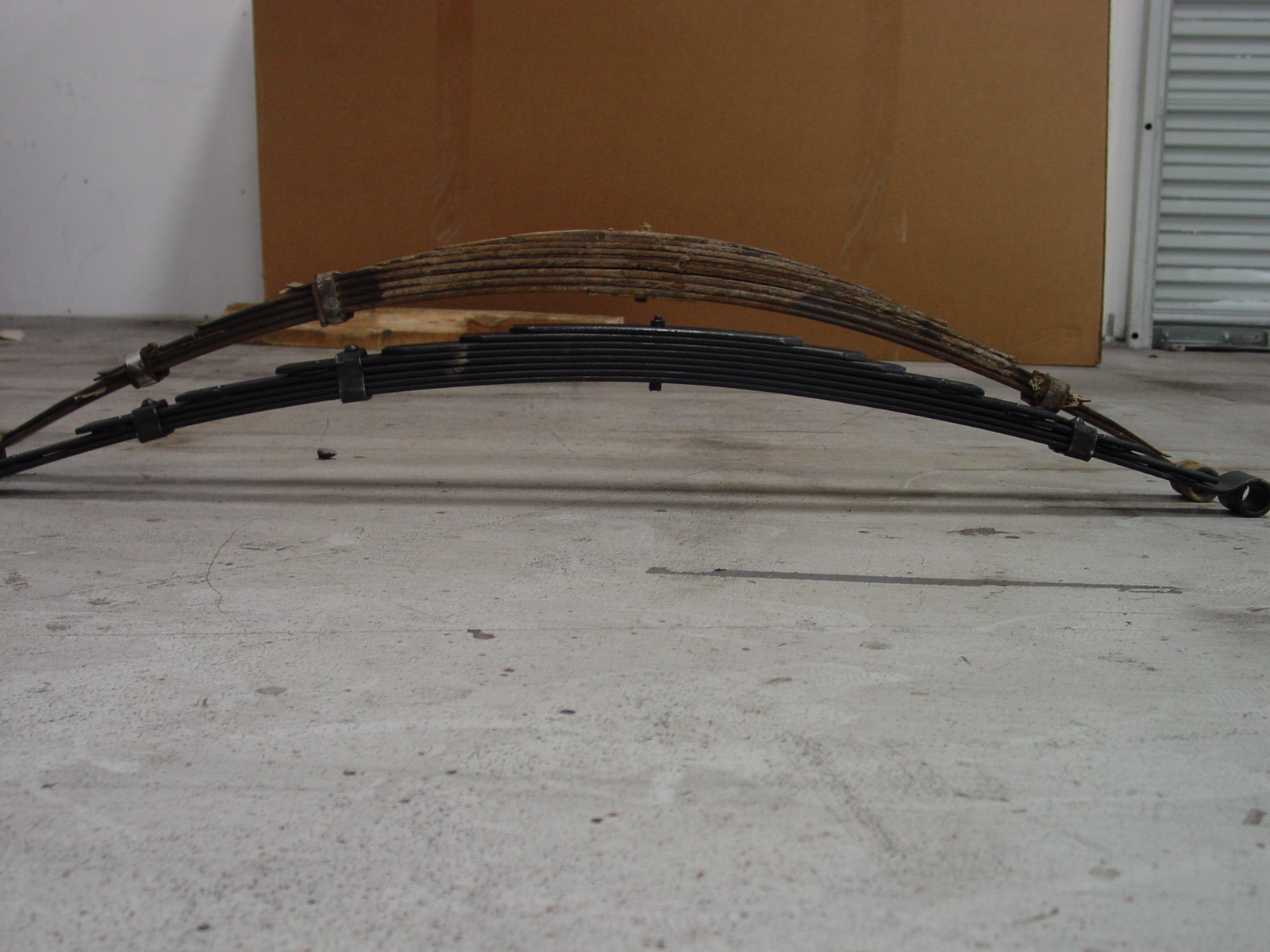

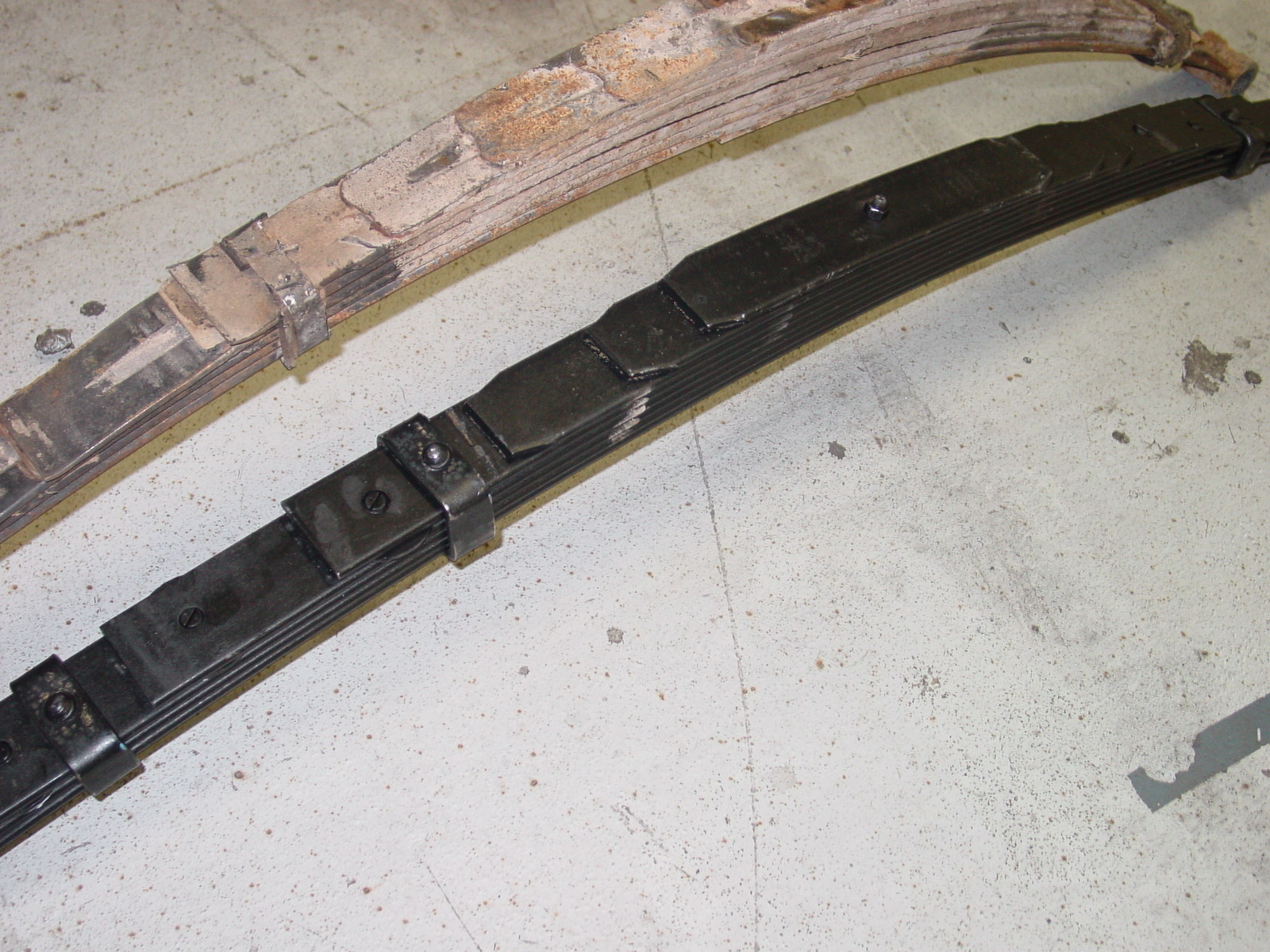

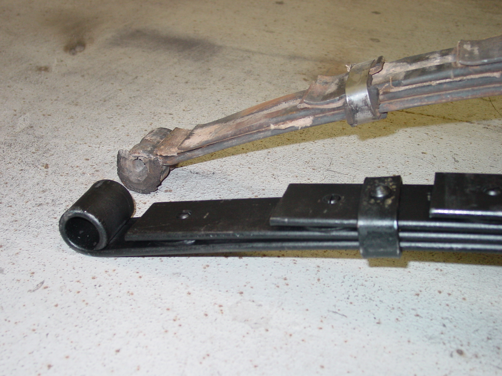

    I'd like to add St. Louis Spring Company to the list. I contacted a handful of spring manufacturers, most would make a stock height set of 1951 Mercury leaf springs. St. Louis Spring made a 4" drop set of Rear Leaf Springs for my '51 for a very reasonable price. Bushings not included. The best part about it is I called to order them five days ago, and they arrived today. I spoke with Nick, and I wish every company had customer service like St. Louis Spring.
    Hand-crafted Leaf Spring Suspension since 1945
    http://SaintLouisSpring.com
    314-533-2132
    Most orders made and shipped within one business day

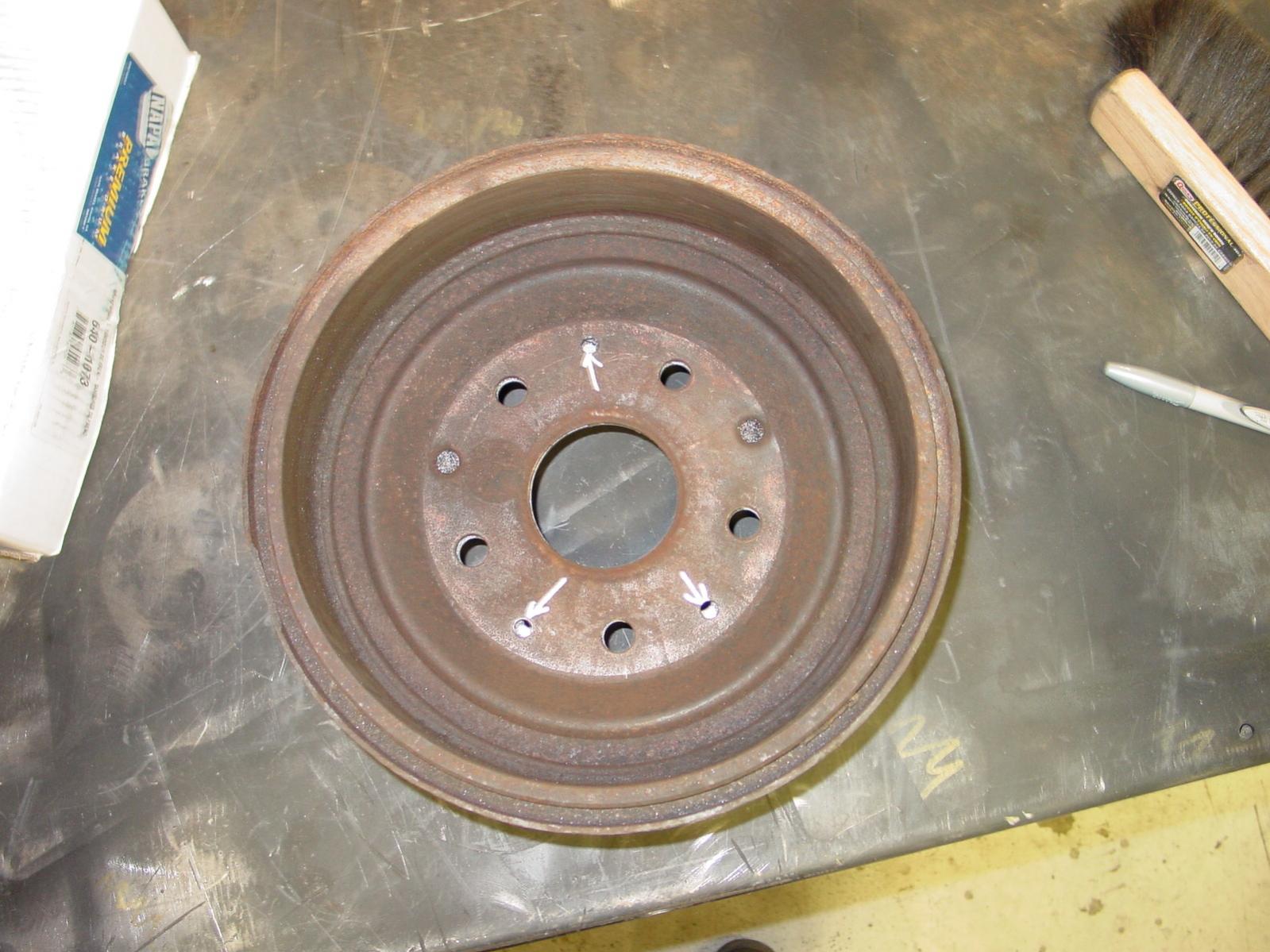

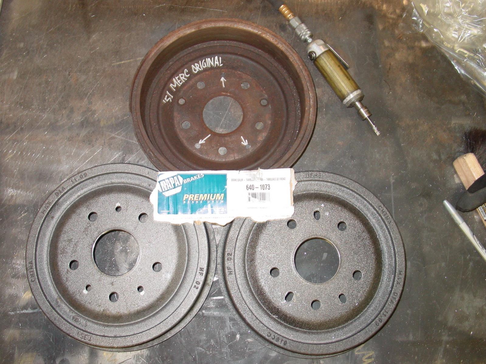

    For those of you running the original rear end with drums on your 49-51 Mercury, here are a few pictures of the Napa rear brake drums. These pictures show the modification you'll need to do. The three holes that attach the drum to the rear axle shaft must be enlarged. The picture showing three drums are the old rusty Mercury drum on top, a new drum on the lower left with silver markings where I need to enlarge, and the lower right is after they are enlarged. The last picture is the old drum laid on top of a new drum for marking the new hole locations.
    Rear Brake Drum - Napa Part # 6401073 (old) ==> new part number 440-1073 $45 a piece

    I haven't done the rears on my 51 yet but I have done the fronts and they had to be done the same way with 53 to 63 F100 drums. I purchased Raybestos Brand from Rock Auto and got a pretty fair deal for Canadian made parts. The retainer holes are located pretty much the same as the Dana 41/44 rear drums are for the F1 pickups through 1952. The hub center hole is larger on the 53 thru 63 F100 drums but I found some spacers that will fit tight enough to keep them centered if the lugs get loose for one reason or another. It's the only thing out there for now. Its just too bad they don't pierce some for the 49/51 Mercs.
