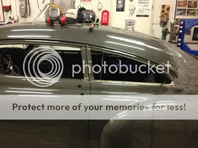

    Some more photos of the welding.
    Then work was started on the posts. I was set on having the posts slanted so thats how it was done. I dont have any detailed pics of how it was done, but it turned out alright.
    Another profil shot.

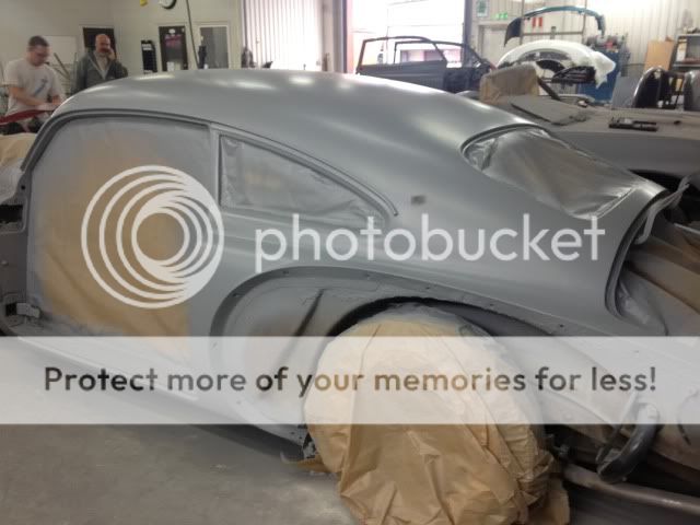

    They wasted no time and took it down to bare metal. I was a bit worried that some old patches or there would be lots of bondo in some places. The only problems we saw were 2 dints in the roof over the left door. It looked like a ladder had fallen on the roof in some point of its life, funny but it was not noticeable from the inside. A friend stepped in and fixed it quickly and we were back on track and it was in primer in no time. I have seem to lost all the bare metall photos so we will have to do the primer shots.
    The front fenders needed a bit more work but not that bad.
