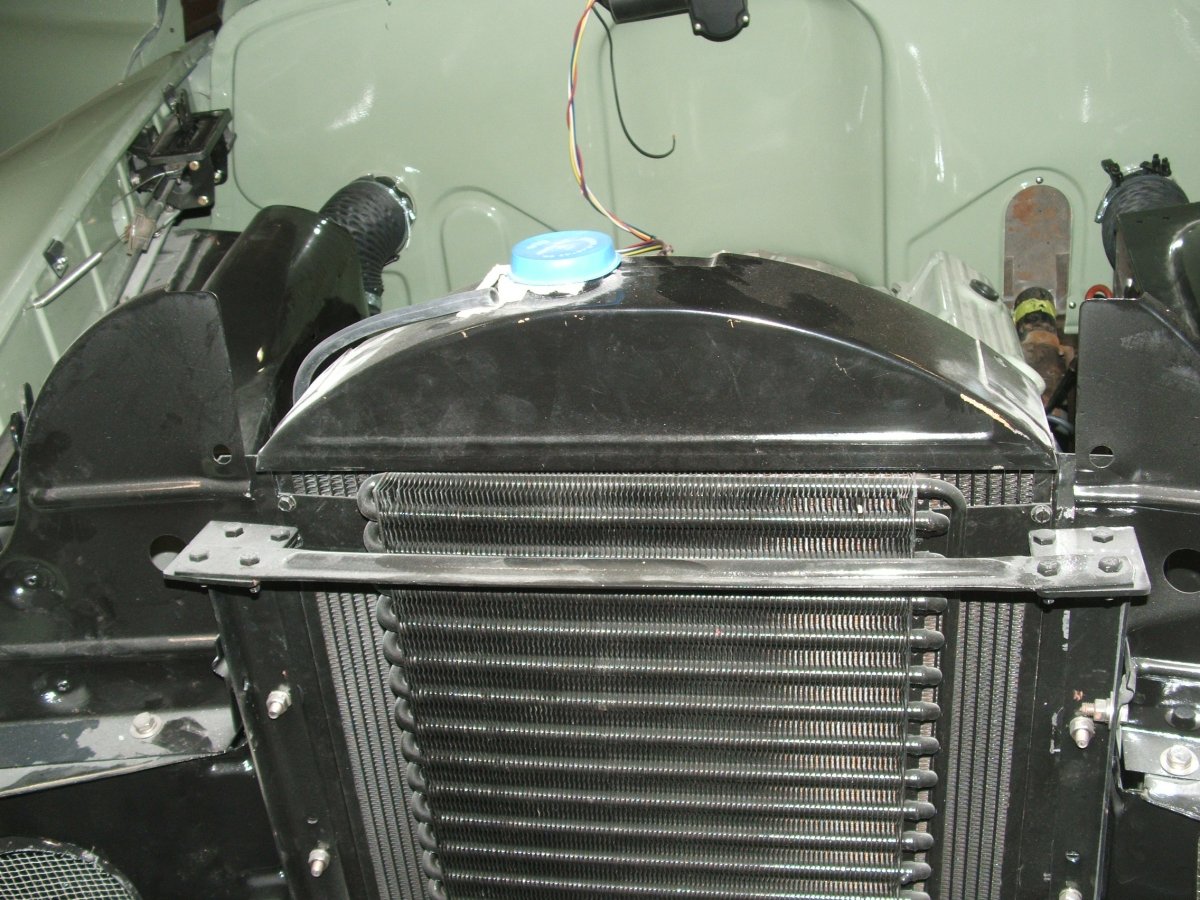

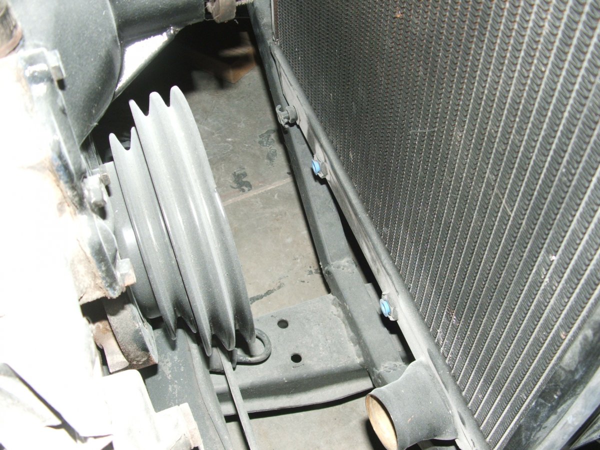

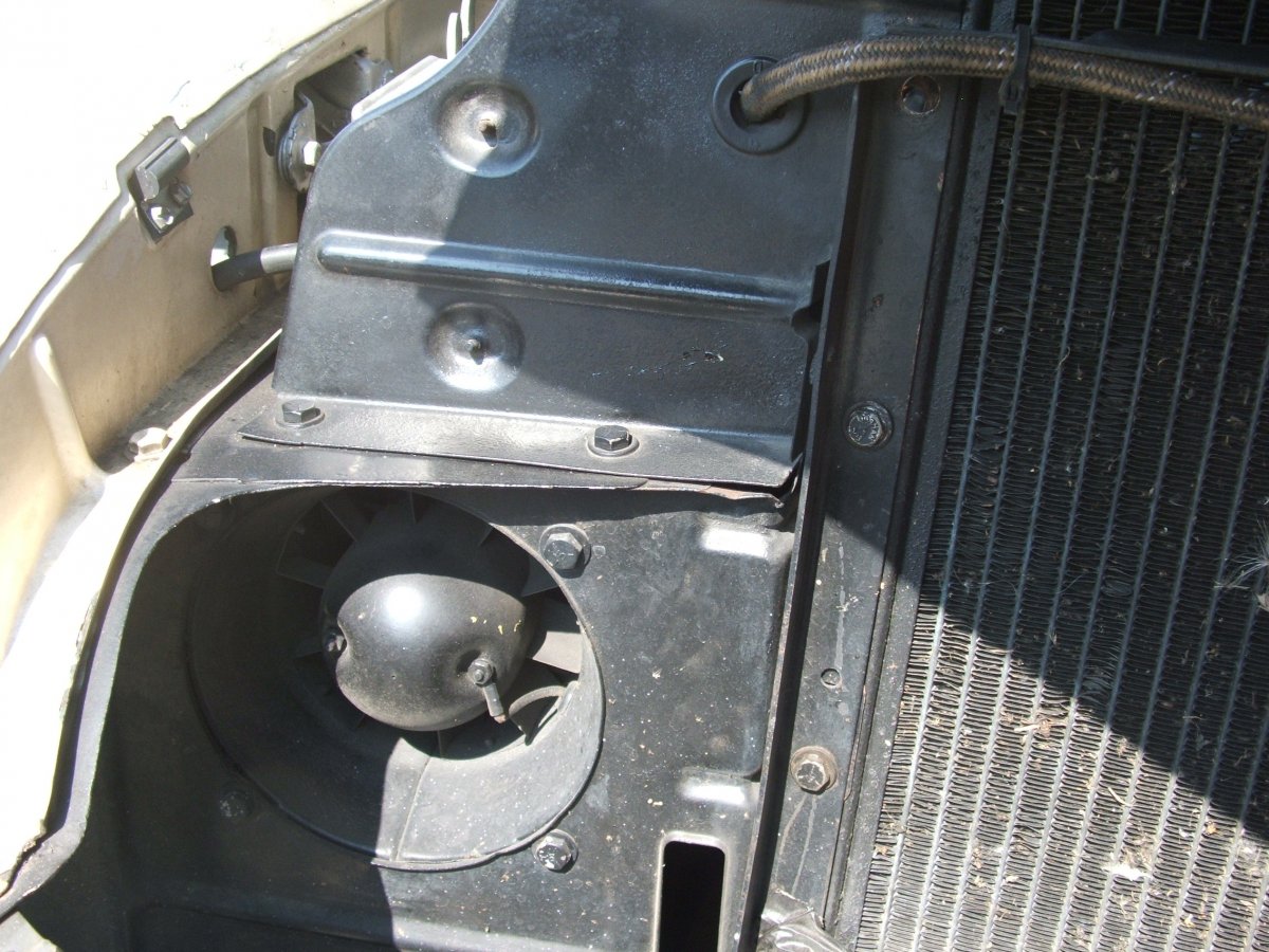

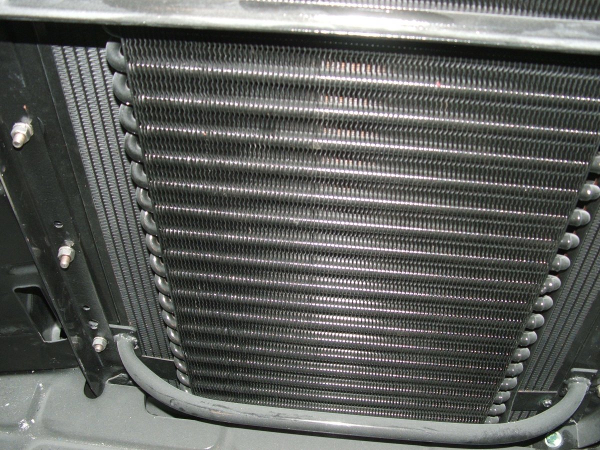

    Oops. Forgot to attach the pictures of the front of the radiator so you can see the support pieces.
    A wider view of the radiator--inner fender panels and the top panels on the inner fender that close off the air flow under the hood and force it through the radiator.

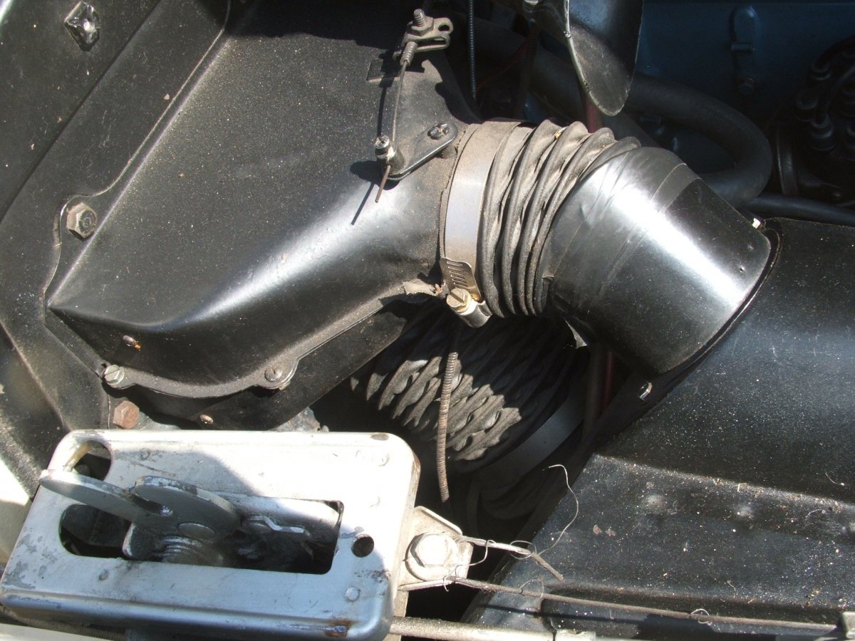

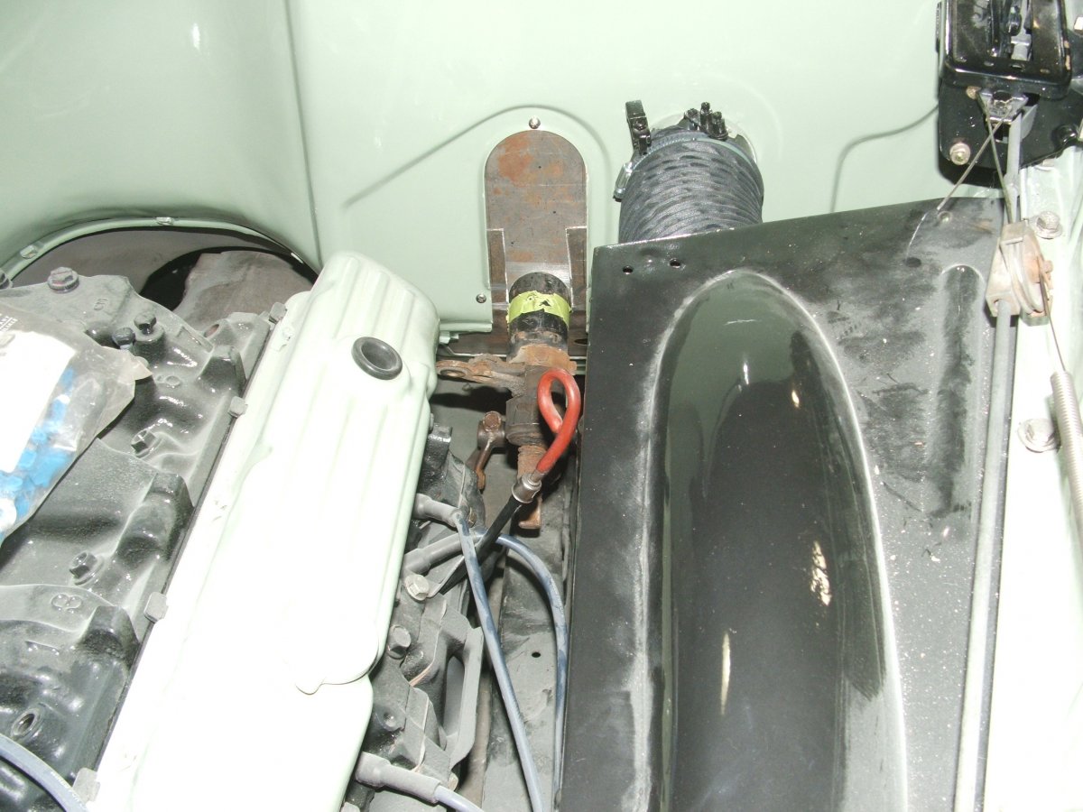

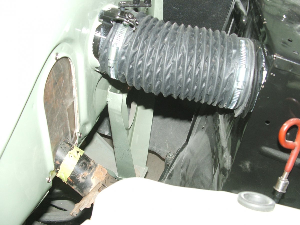

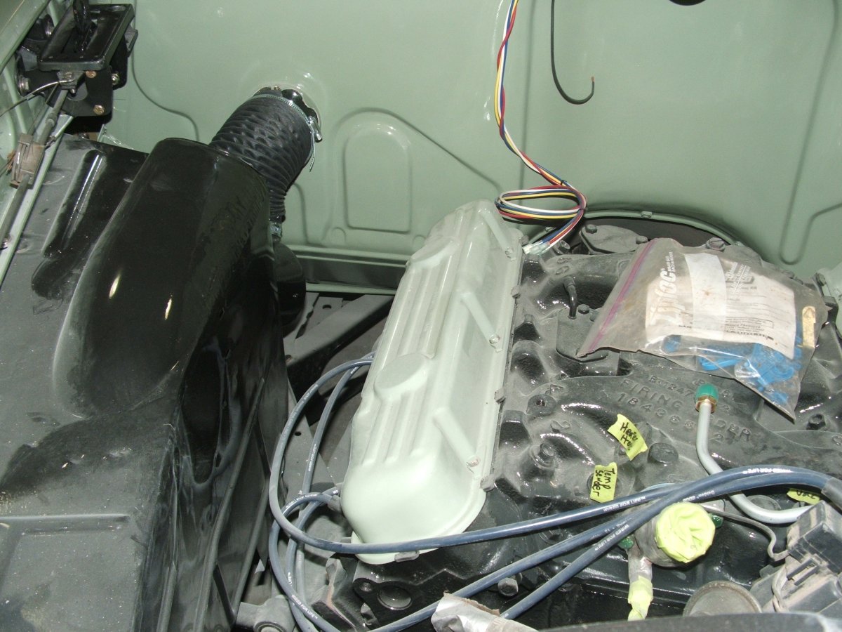

    These Buick's had an amazing heat, defrost and ventilation system. One heater located just behind the firewall and another under the p***enger's seat. Ventilation tubes ran from behind the grill under the inner fender well with the p***enger side tube having an electric fan at the front end of the tube to push air.
    The air on the p***enger side flowed to the back of the inner fender panel where it split with the lower tube acting as a fresh air vent under the dash and the upper tube running through a heating unit and into a defroster tube that went from one side of the dash to the other.
    The upper rectangular box went to the defroster and the lower (see accordion hose underneath the box) furnished the p***enger venting. While this system was pretty forward thinking the air ventilation system was not independent from side to side. There was only one vent cable and it opened both the p***enger and the driver's side tubes. You can see the cable housing coming from the driver's side as it goes over the bottom accordion hose and back under it to the flapper in the firewall. Since I was installing a Vintage AC/heat unit I didn't need the upper rectangular box so I made a round cover to plug that hole where the vent tunnel exited the back of the inner fender panel.
    As indicated previously, I had already welded in a patch in the p***enger side firewall where the big rectangular defrost/vent box previously attached. That gave me a smooth firewall above the remaining vent hose that now matched the one on the driver's side.
    The vent control knob on the dash originally connected via a cable directly to the Driver's air vent flap and when you pulled the cable it opened. You can see this cable bracket on the driver's side at the top of this picture.
    There was a secondary cable from there to the underside of the p***enger's side vent flap thatwould open the flap on the p***enger's vent at the same time. So, there was no independent control from side to side. To allow the p***enger to control their own air flow control I had to disconnect the cable running from one side to the other, remove the p***enger side cable bracket, reverse its position and add a cable and pull handle under the dash on the p***enger's side.

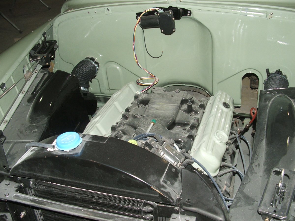

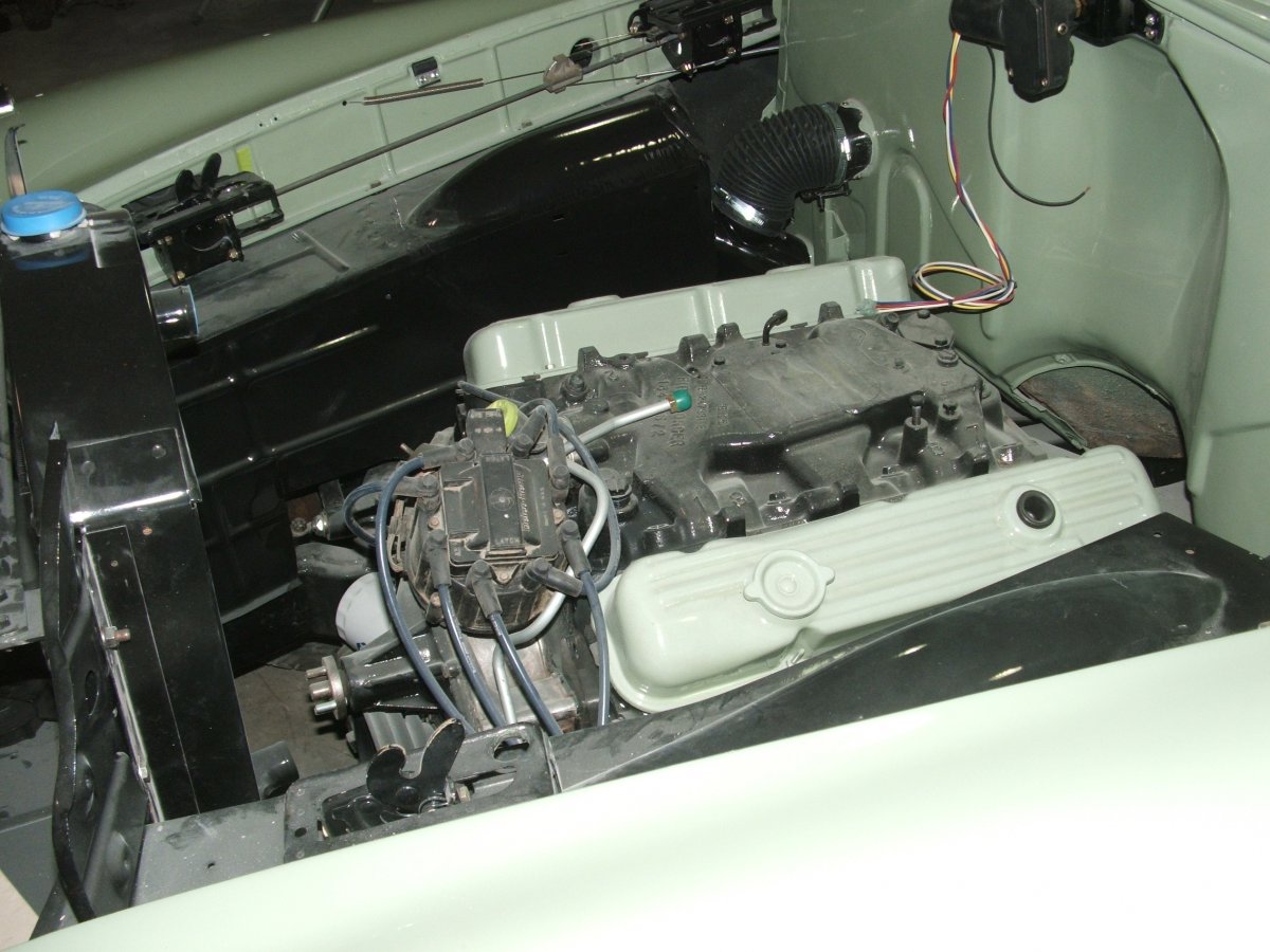

    Earlier I promised a couple of pictures relative to how the Big Block Buick 455 fit in the engine bay. So, here you go.
    As you can see there is plenty of room, side to side and front to back. Unlike a Chevy with its Distributer in the back where you have to watch the firewall clearance these front dist. Buicks don't have that problem. Also notice the distance between the fan snout on the front of the water pump and the radiator. If anything, I may have to put a spacer in to move the fan closer. Here is another view.

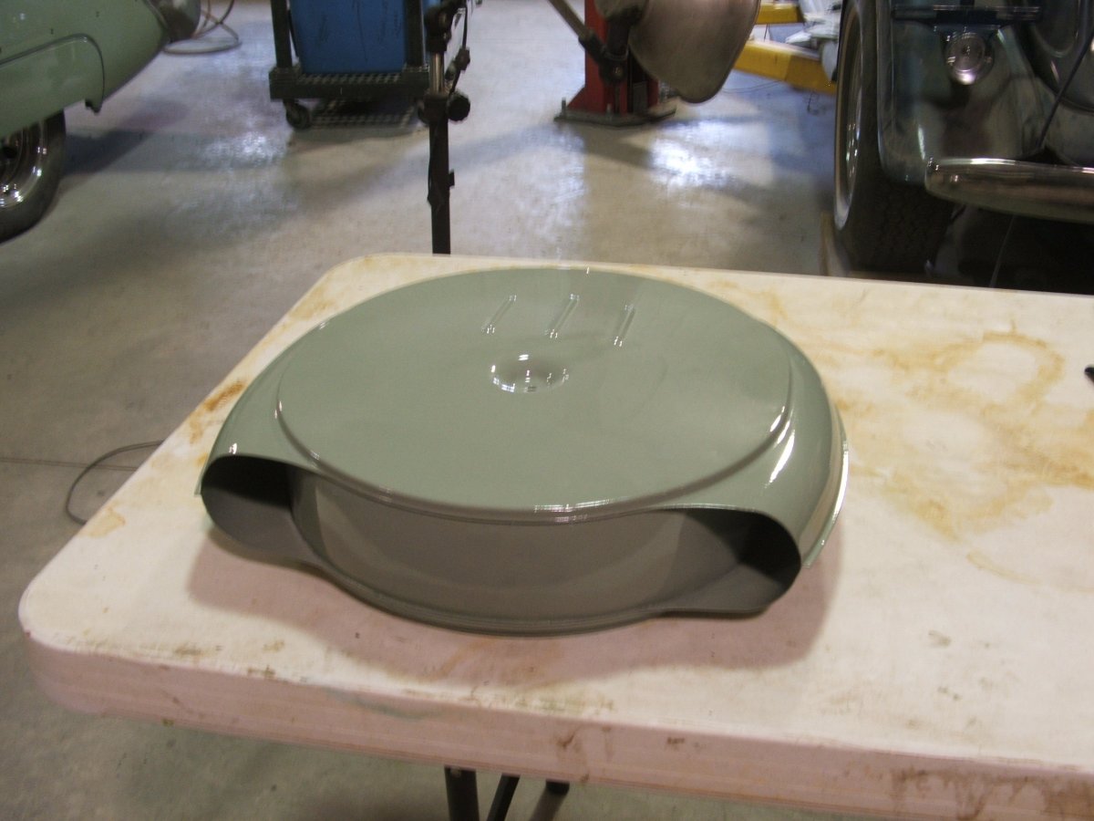

    A friend had an "original" Caddy oil bath air cleaner he wasn't going to use so I cut a deal with him, removed the bottom oil bath part, subs***uting a bottom plate from an old after market chrome one I picked up at a swap meet for a couple of $$. It's now painted the same color as the car and I will probably have it pin striped. Luckily I measured the height of the engine with the carb and air cleaner before installing it to make sure it would fit under the hood.
    The Quadra-jet is being rebuilt now so no current pictures of the air cleaner

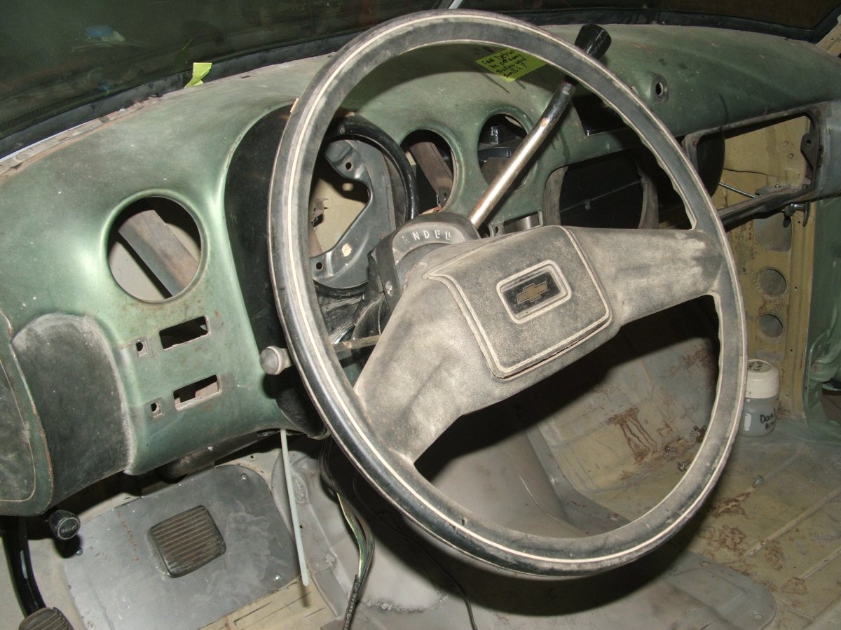

    As mentioned earlier, I made a two piece floor board retainer for the steering column. The pieces overlap at the column exit hole in the fire wall. The bottom piece also covers the hole in the toe board where the brake pedal comes through.
    The column is from a Chevy Step Van. It's not tilt, but in all the years I have put tilt columns in builds I can never remember actually changing the position of the wheel. I was careful to position the column with the dash and the front seat in the 49 so I don't think it will be a problem.
    I haven't pulled the steering wheel on this column yet to see if the original 49 wheel will fit, but if it doesn't then I will search out an early 60's Buick wheel.
    Once I made sure of the positioning of the column I tack welded the column to the upper plate in the previous picture, removed it by first unscrewing the bigger bottom plate that the clutch pedal comes through and s***ched welded the column to the upper plate. I sanded down the column and the attached mounting plate and painted them.

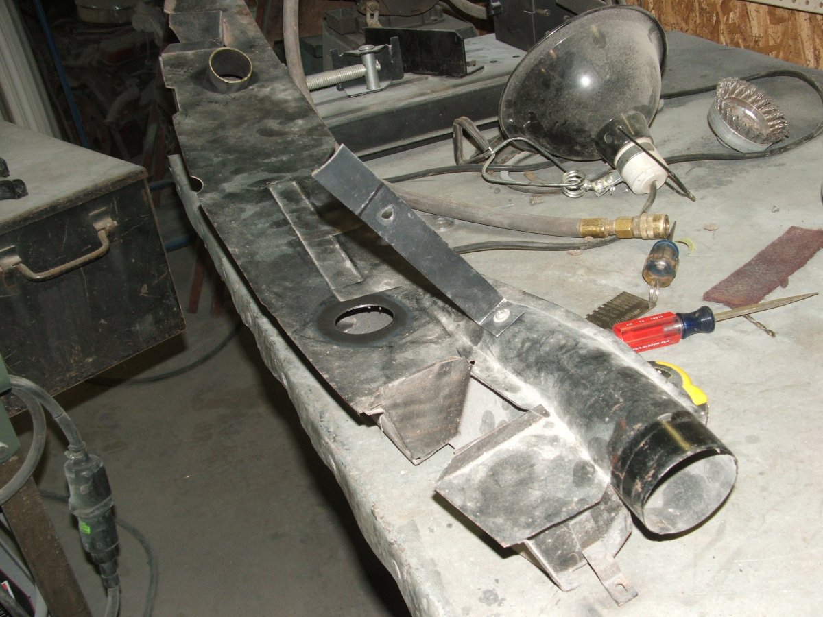

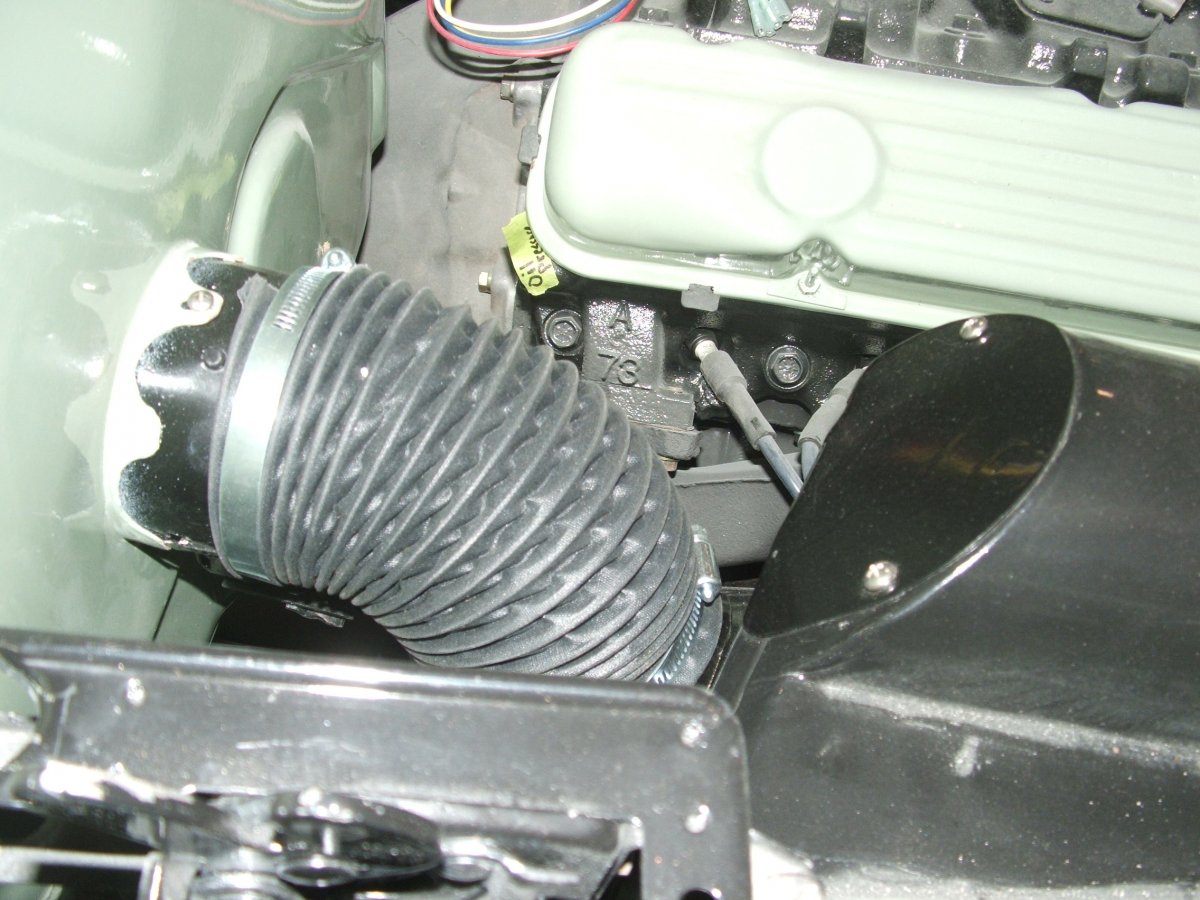

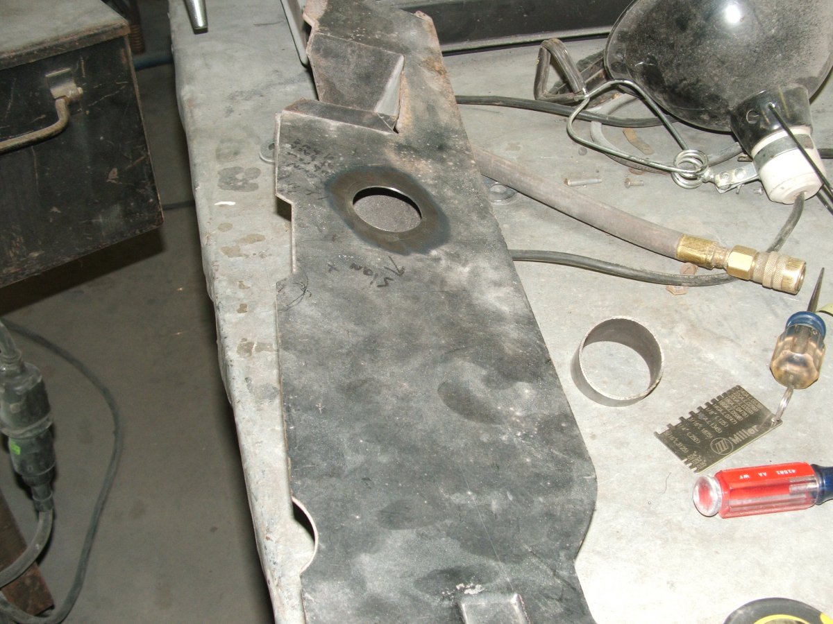

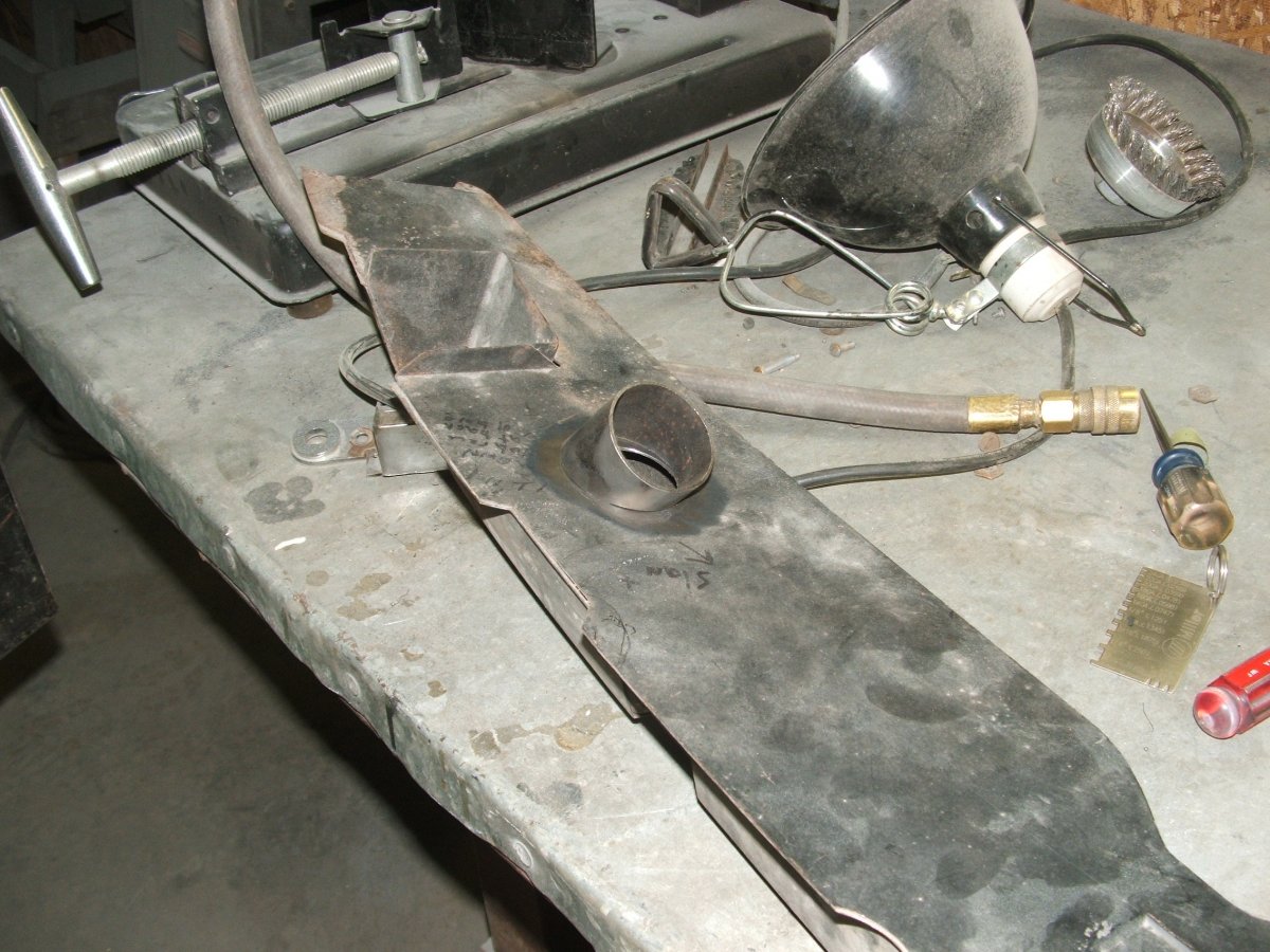

    Getting the stock defroster tunnel to work with the Vintage AC set up. Drilled a couple of 1 1/2" holes at each end of the underside of the tunnel. Tunnel is upside down in the picture below. This end is the driver's side.
    Then cut a piece of 1 1/2" thin wall tubing (look at right center of above picture) with a 45 angle on one end to weld on the opening so it would slope toward the center where the AC unit vents are.
    Cleaned the surrounding surface so I can weld the angled tubing to the defroster. I will also put a couple of weld bumps just below the bottom edge of the tube to hold the accordion AC flex hose from the unit in place.
    In the next picture you can see the hole in the p***enger side of the tunnel and the original air intake hole on the end. I will cut this back an inch or two and make a weld it shut. The strap is one of the three that holds the AC unit in place. I just used a sheet metal screw to hold it to the tunnel in the mock up. I will remove the screw, drill a 1/2" hole in the tunnel and weld in a 1/4" nut to make sure the bracket is solid.

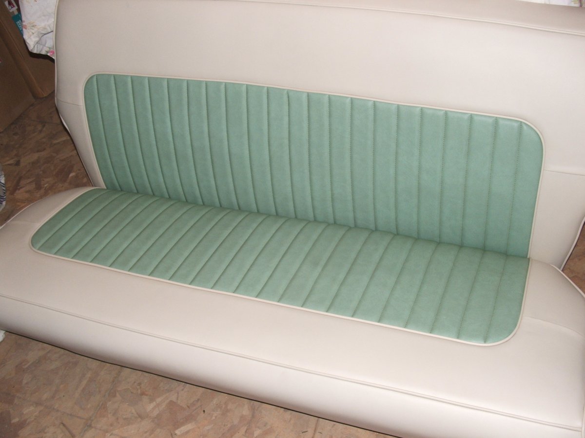

    OK, I'm pretty much up to date on the build. The new headliner I ordered has arrived and is at the upholsterers. I took the seats in a couple of weeks ago.
    As you can see, each spring is individually wrapped in burlap. He had to dis***emble everything and then make new burlap pockets for each spring. Very labor intensive. That part is completed and Saturday when I stopped by his shop, he had the tuck and roll inserts done and was fashioning the remainder of the covers.
    The backs of the front seat are metal so first the spring part is covered then the separate backs and then they are re***embled as one piece.
    I am ordering the carpet today. By the yard as it will have to be custom made. In the above picture you can see that the back of the seat frame is carpeted. So is the separate panel under the back seat. These are both about 6" high. My plan is to also have the bottom 6" of the door panels in carpet to match.

    Finished the modifications on the defroster. Now set up for the Vintage AC and cut away the necessary space enabling me to put the Newport WSW control in the same spot on top of the dash.

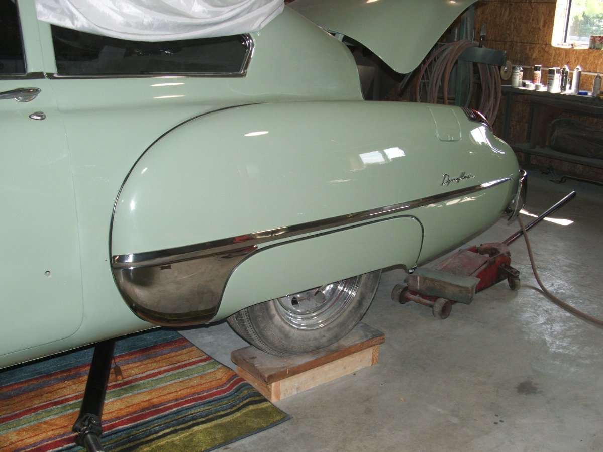

    The local chrome shop finally finished straightening and polishing the rear fender SS strips. They were rough to start with and I hoped they would come out a little better than they did but they should be OK. I am going to try a different shop for the door strips.

    Started to install the SS back fender trim I had straightened and polished at a shop in Indy and realized that they had either filed or buffed through the metal at the center peak in several spots on one of them. I didn't catch this when I unwrapped them.You can hold it up to the light and see through it from the back side. Pissed. Trying to support a local business in this instance didn't work out. Luckily I had a spare and I only took them two pieces so I could see what kind of work they did. Now I know, but I'm out one piece of SS and some $. The other piece is p***able, but I will replace it if I find another one.
    Thought about going back and raising hell, but what good would it do. They aren't going to replace the piece, refund the $ and repair is out of the question. But I will let the local Hot Rod community know how the work turned out.

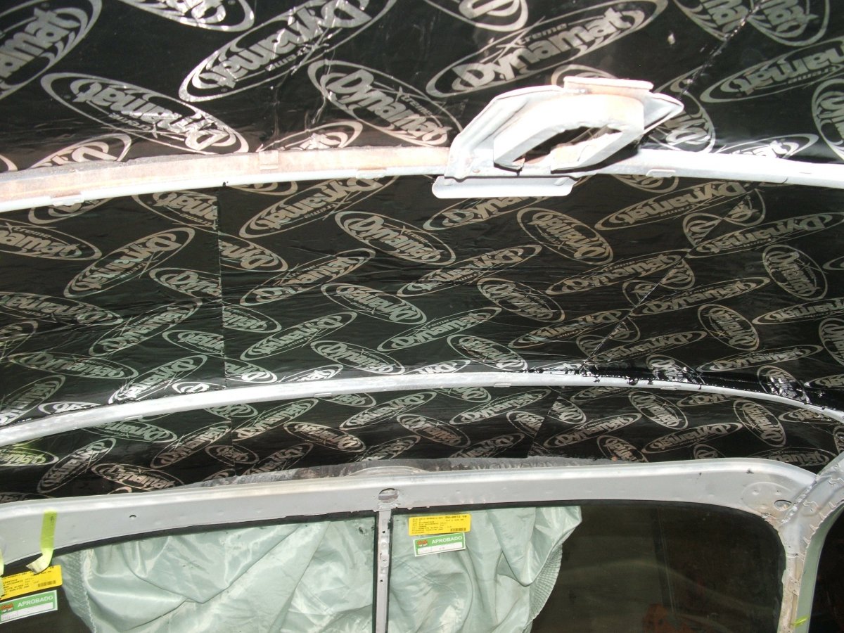

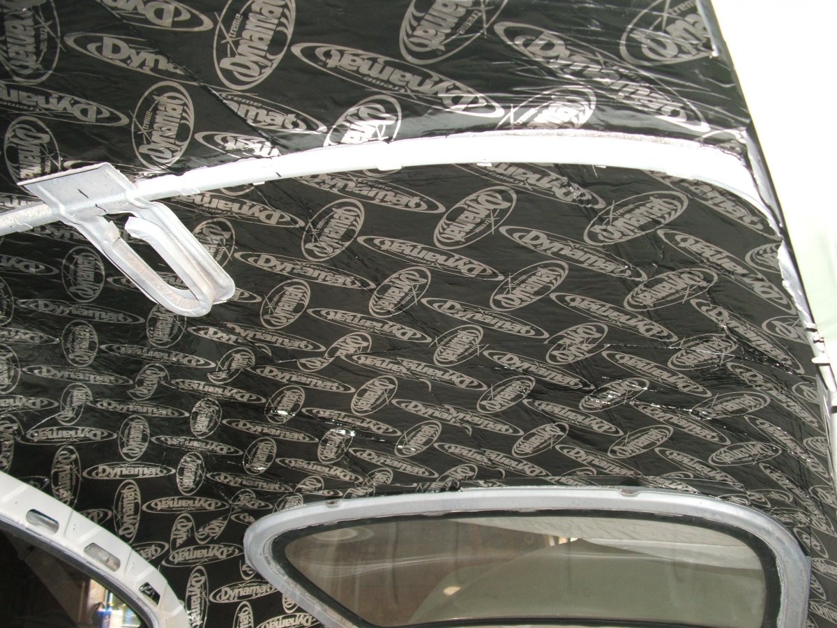

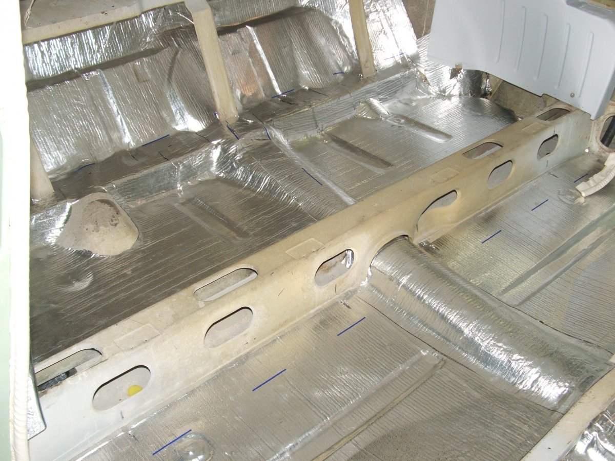

    While I normally use Flexclad 400 or Peel and Seal for sound deadener/insulation on the floors and doors, the local manufacture's rep. said he wouldn't recommend it for the roof. So, I used Dynamat extreme.
    Looking towards the rear window.
    Looking toward the WS.
    I priced it at several places and Amazon.com was the cheapest. Any where from $50-100 less than the various rod venders plus free shipping.

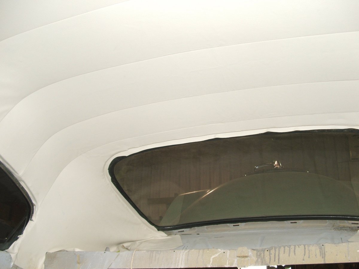

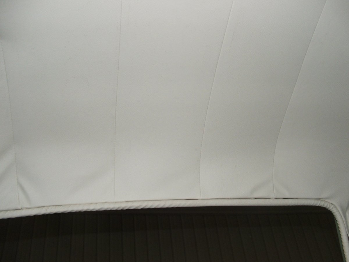

    DSCF1928.JPG Headliner is in, seats are completed and rest of car is insulated. Lots of smaller things done. Upholsterer was supposed to be back three weeks ago to finish interior. Haven't heard from him since. Will contact him this week and try to post picture updates later.
    He will work out wrinkles over the door when he comes back.

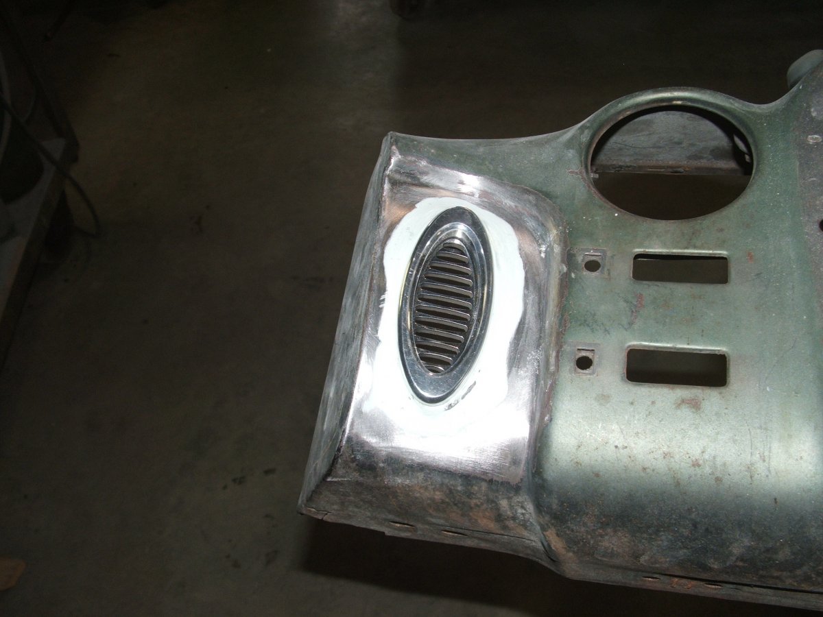

    Finally got ahold of the upholsterer. Must have called 25 times. Does great work but not the most responsible or punctual guy. Luckily I pay as I go so I'm not out $$$$. He is backed up with Christmas rush projects and promised he would be back after the 1st of the year. Meanwhile I started on the dash upgrades. I picked up these AC vents from Yogi's.

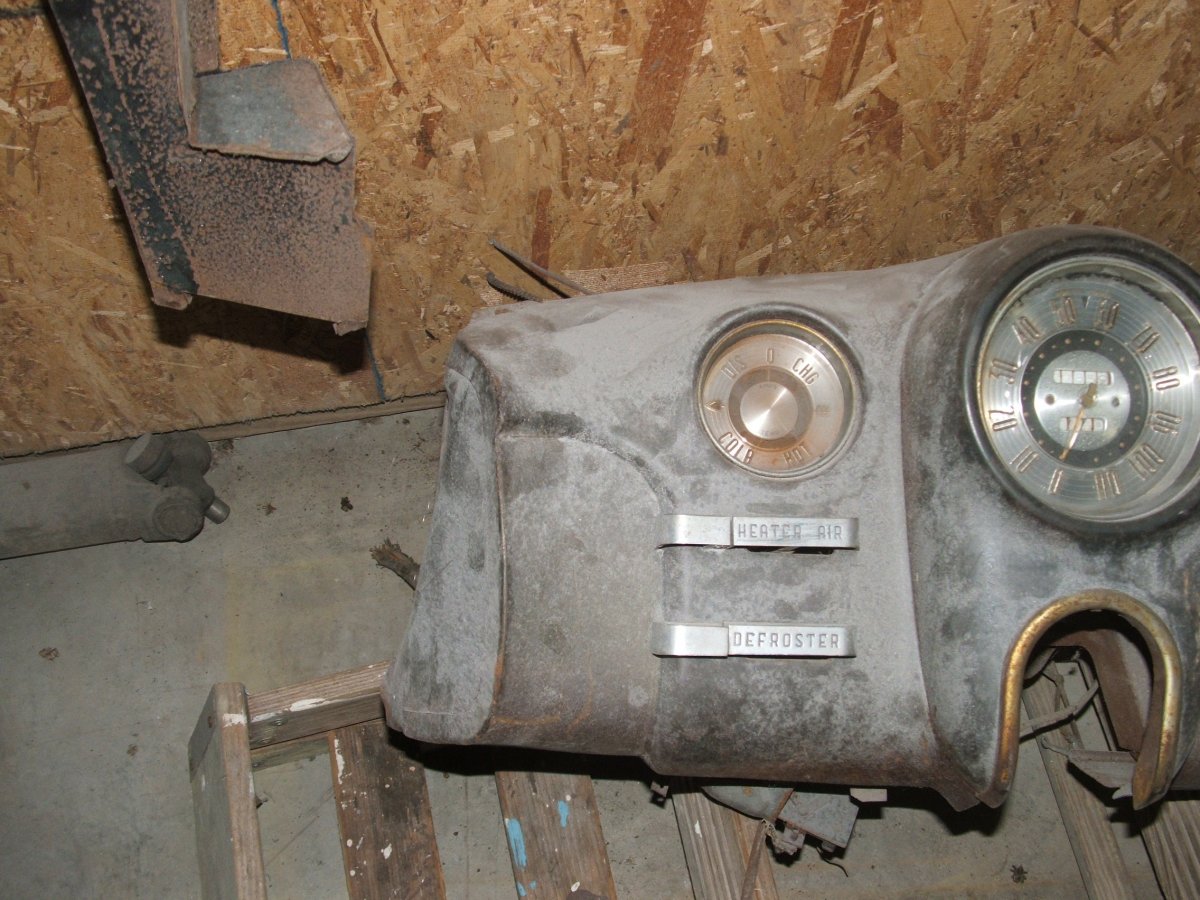

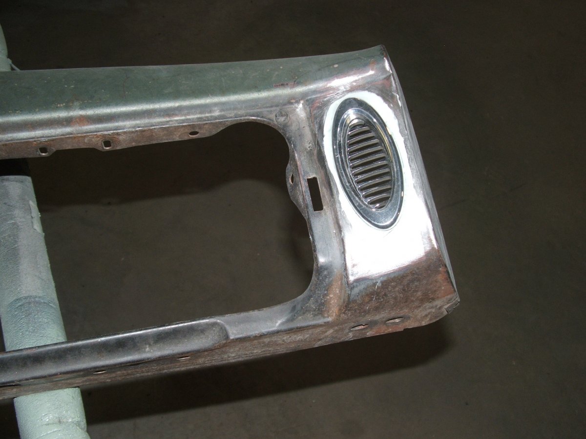

    Decided to put one of the smaller ones on each end of the dash.
    The problem was the dash is curved from top to bottom and the backs of the vents are flat. I needed some spacers to take up the gap. So I cut four pieces off some 1/4" thick steel stock I had laying around---1/4 in wide and about 4 in long. Some 1/4 in rod would probably work better but I didn't have any laying around and I didn't want to make a trip to the supplier in town. I bent the pieces into a basic horseshoe shape and then ground down the ends to give me a taper. I went ahead and cut out the opening for the vent and then welded a spacer at the top and one at the bottom. Then a little body filler to smooth out the lines.
    I'll do some finish work on the vent housing this week.
